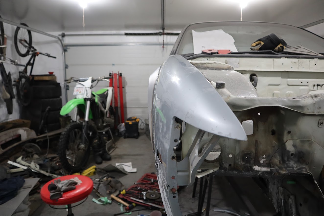

Hey, so I just want to share my progress with this build....
Originally from Ontario, Canada. I used to own this black 240sx with an sr20det back in 2012. My first 240sx ever and I love 240sx ever since. It's still being spotted somewhere in Mississauga. Some kid has it.
So due to certain reasons, I sold the car in 2012, left my dream job as a autobody prepper for Acura body shop and moved to Alberta, Canada to chase that oil and gas money. Ended up getting my foot in the door for welding. Here's some welds.
Since I haven't owned a 240sx for some time, had some extra coins to get another one haha. IN 2015, Picked this up for $5000 cdn at the time, it had no rust from what I can see, so I paid the extra money for it. It was bone stock except for some OLD School NISMO NEW-8 Rims. They were made by Enkei. There wasn't much information on these rims.
Bought some HSD Coilovers and SPL Hicas delete from Varun Contractor @ VHC Performance.
Sparco Steering wheel set up from my homie Tom at Nextmod.
Saw some kid parting out some OEM TYPE-X exterior parts, SO I bought it asap.
Bought the full type-x tail lights as prices for them been going up every year.
In 2019 I was able to buy a house with a decent size garage and first thing I did put up the dry walls and an outlet that will be used by my welder. Immediately right after I built a car rotisserie with the welding and fabricating skills that I have acquired. I have a very long and boring video step by step on how to build one if your interested.

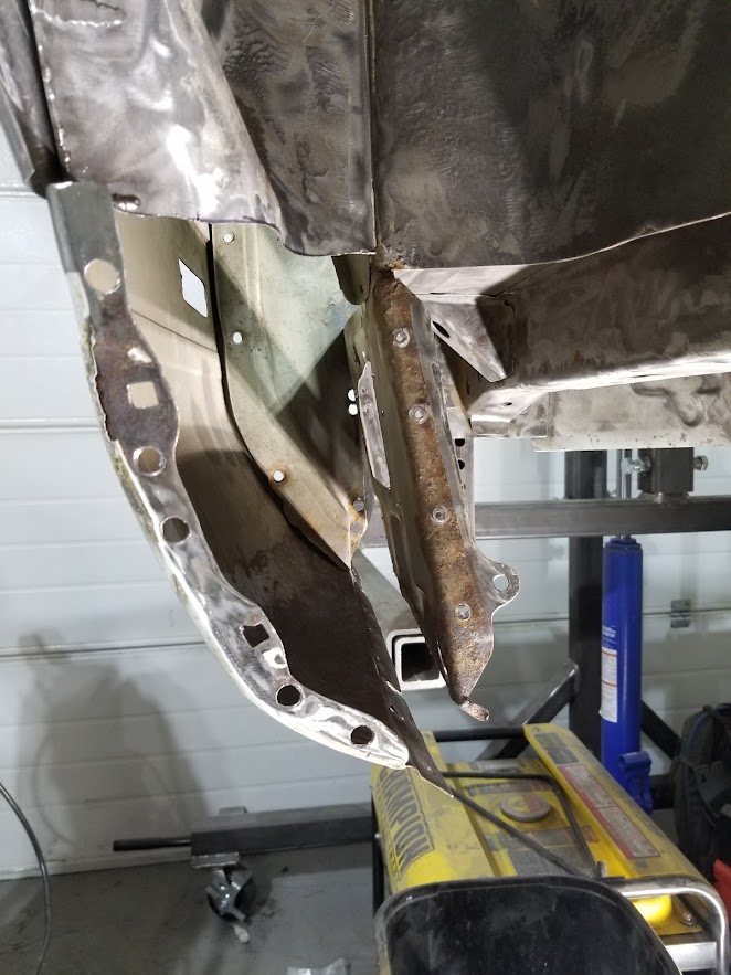

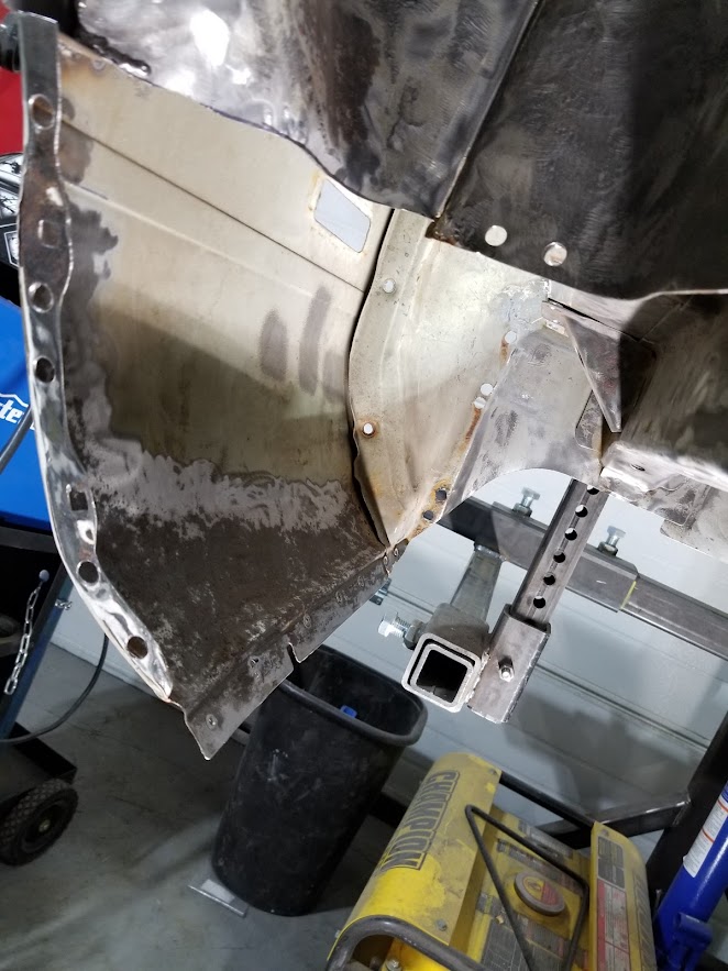

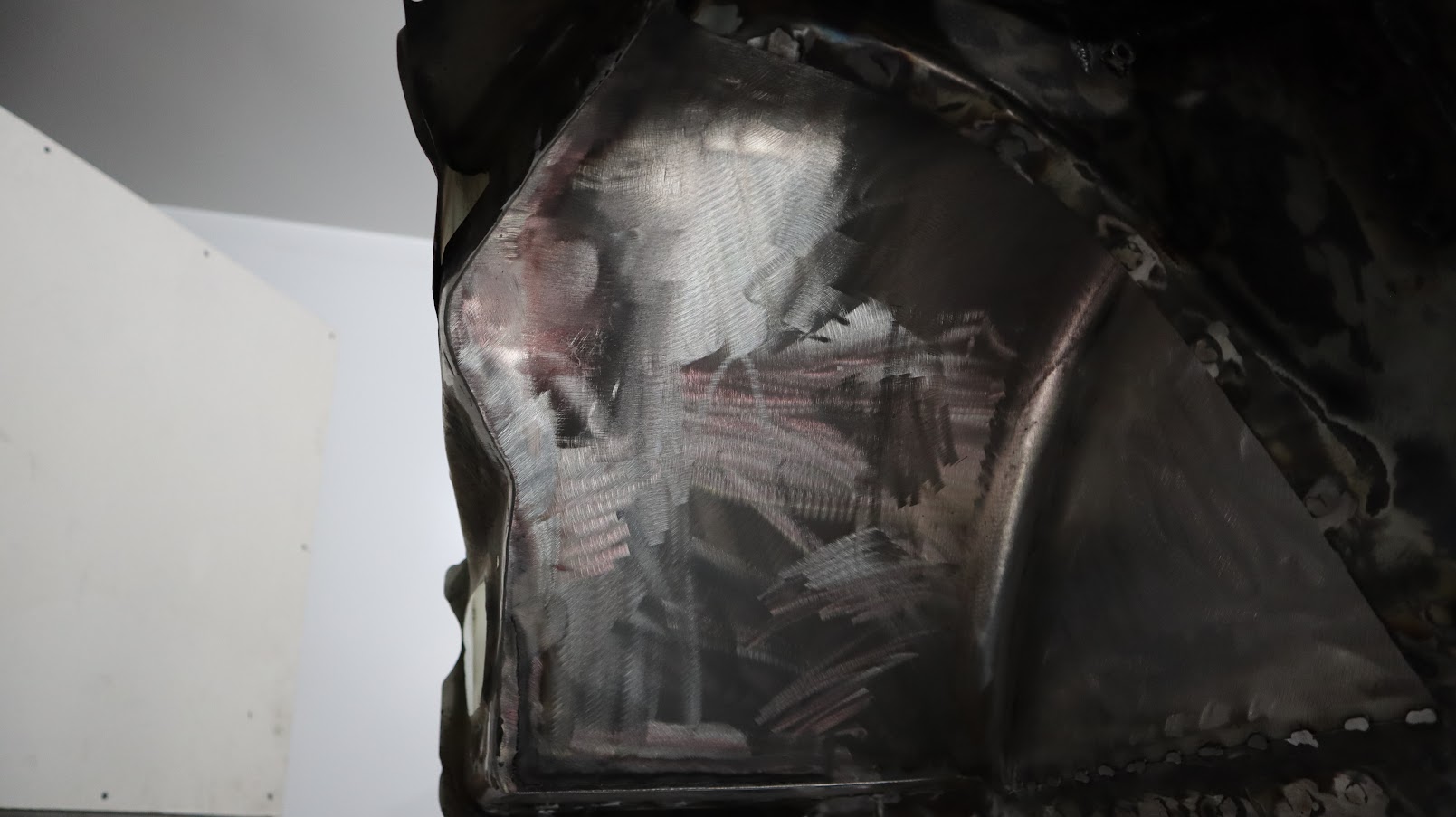

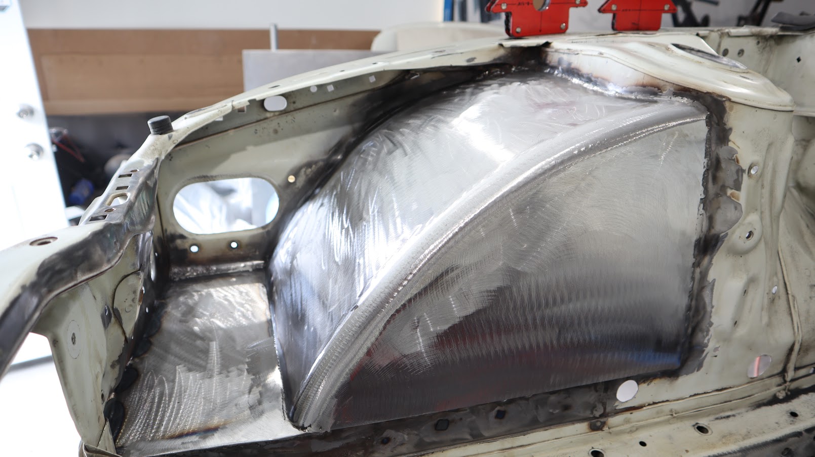

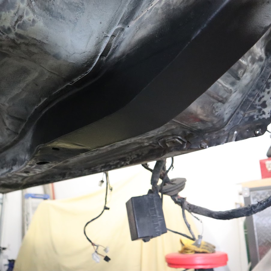

s13
Sorry, but for whatever reason, the bottom bunch of photos are not showing.

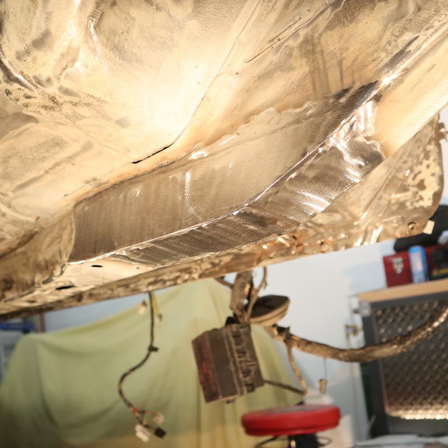

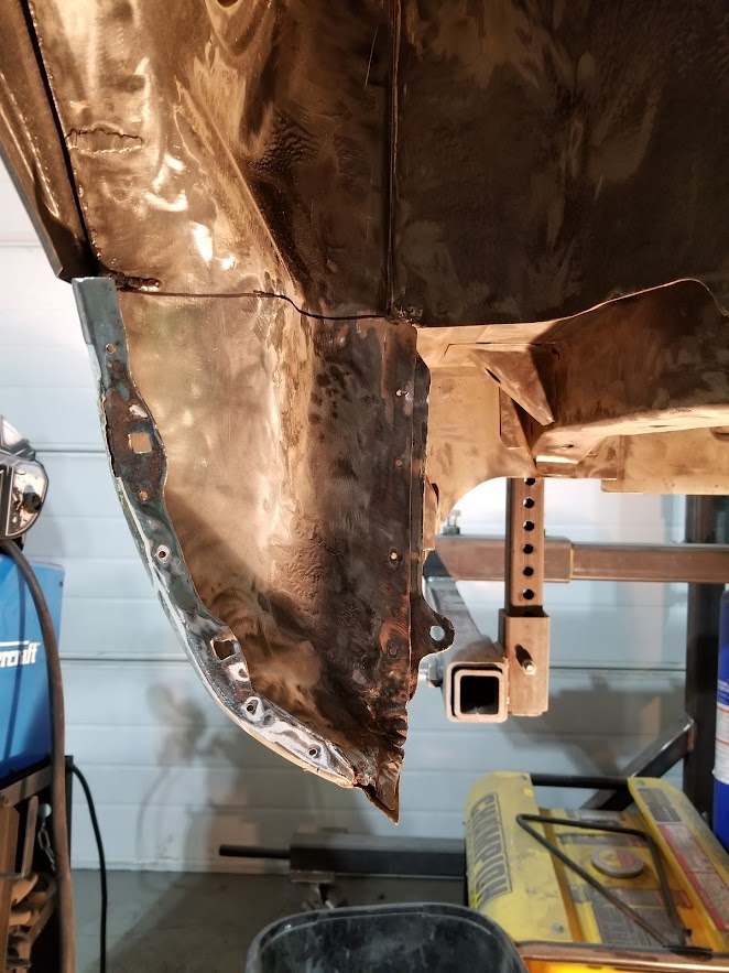

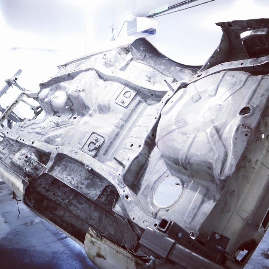

I put the car on the rotisserie and started removing about 90% of the undercoating to see what was up.
Upon inspection, there wasn't really much rotten metal except for the common spot, driver side frame rail. I ended up cutting the side that was bulging and on the inside was just surface rust so I wire wheel the surface rust off, then treated it in Eastwood Fast Etch acid, after I neutralized and clean it with Eastwood paint prep. Then I applied Eastwood platinum rust encapsulator on the inside. Applied some Eastwood weld thru primer and welded the two plates back in. Later on when I'm done welding everything, all frame rails and rocker panels will be getting treated in Eastwood internal frame coating. I don't wanna sound like I'm a promoter for Eastwood products but apparently this shit works good.
So I plan on going with the old 2jz-gte, and I was told that it would help to move the radiator forward. After some googling, I went for it. I added some metal to the top rad support so later on I can put some foam there for my radiator to rest on. The bottom will get two more triangle pieces to strengthen the lower rad support.

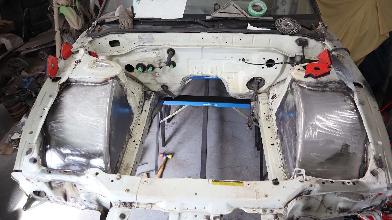

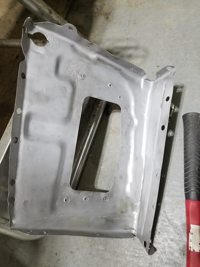

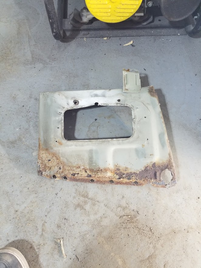

I wanted to put some tubs in the front, never done it before, after some helpful threads on Zilvia, I went ahead and did it. I think I fucked up because I should of angled the tubs outwards to get some extra space inside the engine bay. The tubs width that I went with are 13" wide. Also I didn't want to put those plates on the outsides like how people usually do em, I went with the painful trimming until I could get it to line up perfectly with the OEM panels.

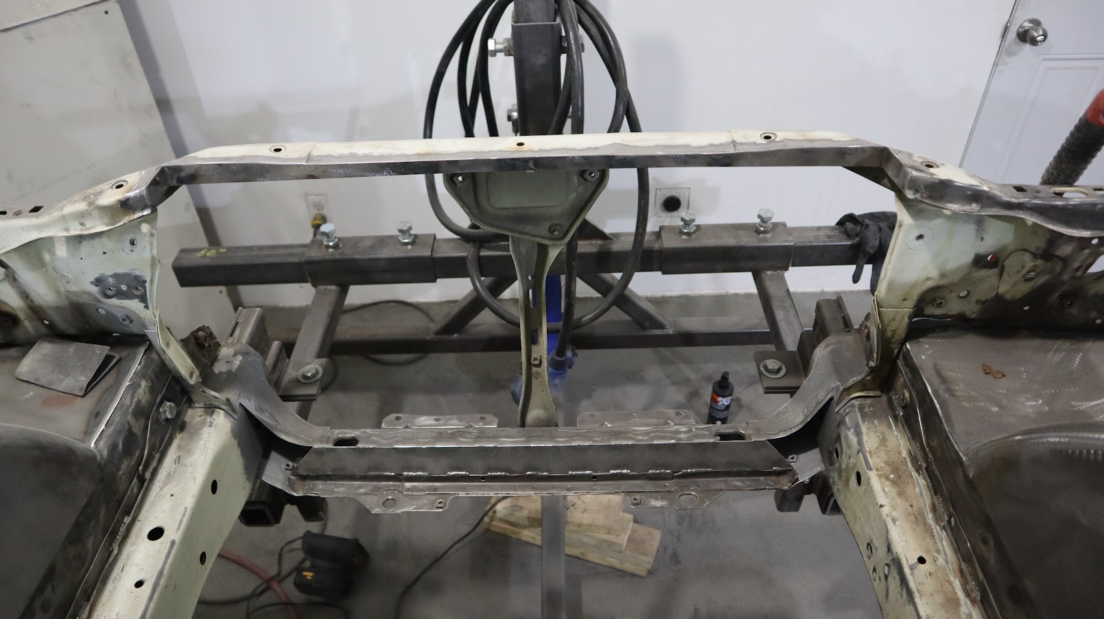

Luv how u "boxed" back in the upper core support. Thats doing it properly!

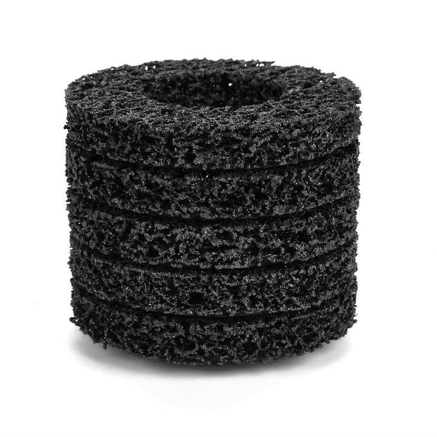

This is good. I plan to do the same to mine in a couple of weeks.
What did you use to remove the undercoating?

Thank you S14rebuild for the comment, I appreciate all comments!!
As for dluevanos01 "This is good. I plan to do the same to mine in a couple of weeks. What did you use to remove the undercoating? "
I literally used a angle grinder with a wire wheel but it takes forever!! I didn't know there was a better option until I discovered this . You want to be using a Poly Strip Wheel Disc Clean Tool Removal Rust/Paint, Example :
So this particular type of pad, they come in different style for like angle grinders, or 2-3" pads for die grinders. It's a bit more expensive but they fucking remove that undercoating, paint and rust off so quick, it's not even funny.

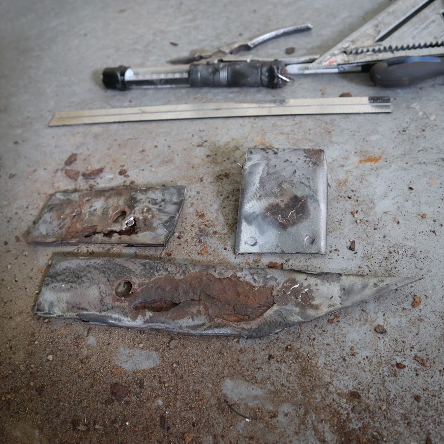

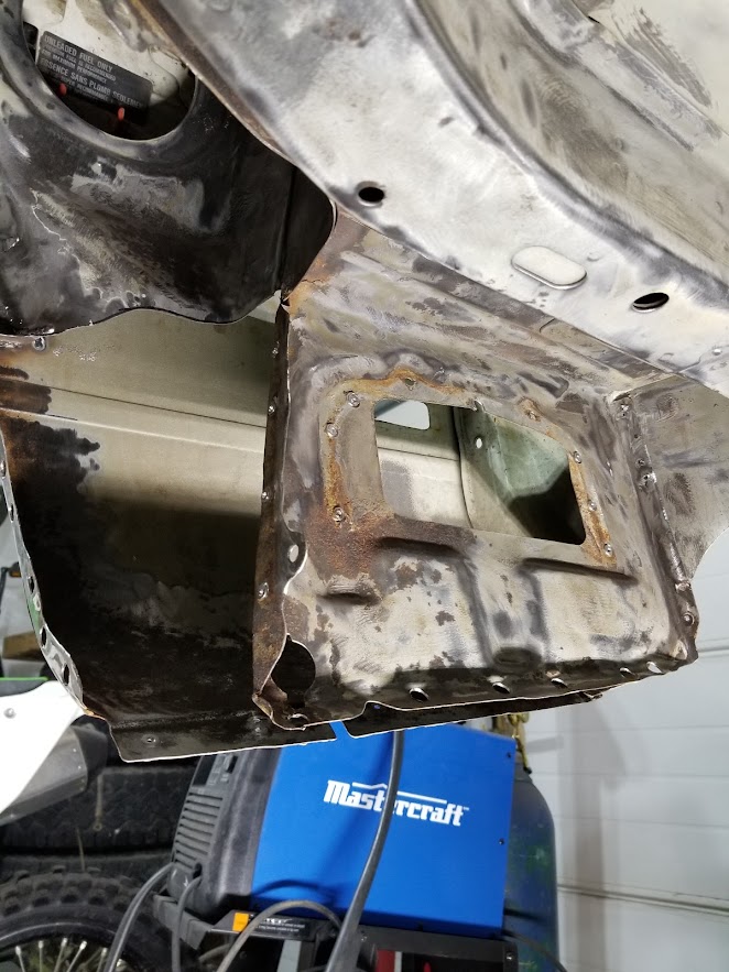

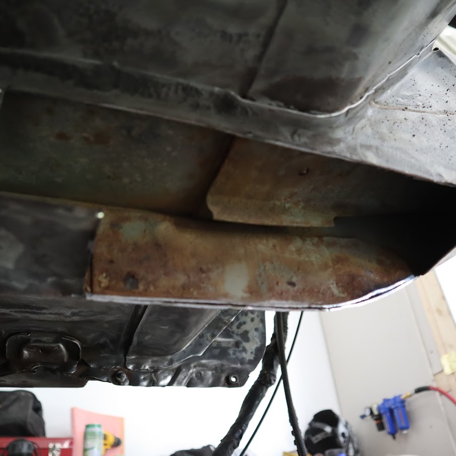

After poking around, I noticed some surface rust on the passenger side rear wheel well. It was around where two panels meet. I noticed that a lot of rust starts where two panels meet, or where there is some old ass crusty 27 Years old seam sealer, or frame rails that been getting rubbed up on speed bumps. Anyhow, I found that the best way to deal with this rust that was on the passenger rear wheel well, was to cut where that black line is and drill out all the spot welds. That way I can go in there, remove all the rust , sand blast the pieces that I was able to take out, then treat all rusted area and the pieces that I took out with Eastwood Fast etch, then prime it with Eastwood weld thru primer. Weld it back into the original spot and then later on coat it with Eastwood Platinum Rust Encapsulator. At this stage in the project, no rust can escape. I'm the RUST HUNTER Also, there was a opening here, not exactly sure what used to be here but it was letting water into that area, so I just cut that piece out and welded a plate here.

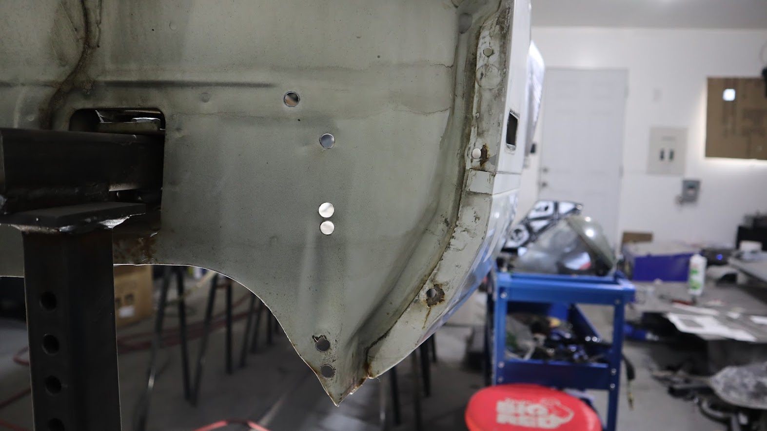

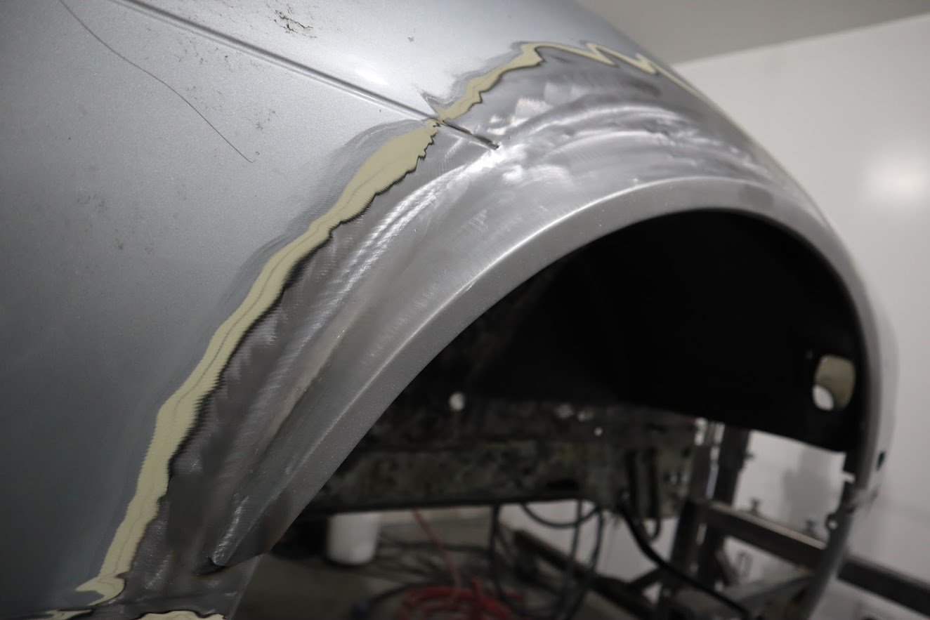

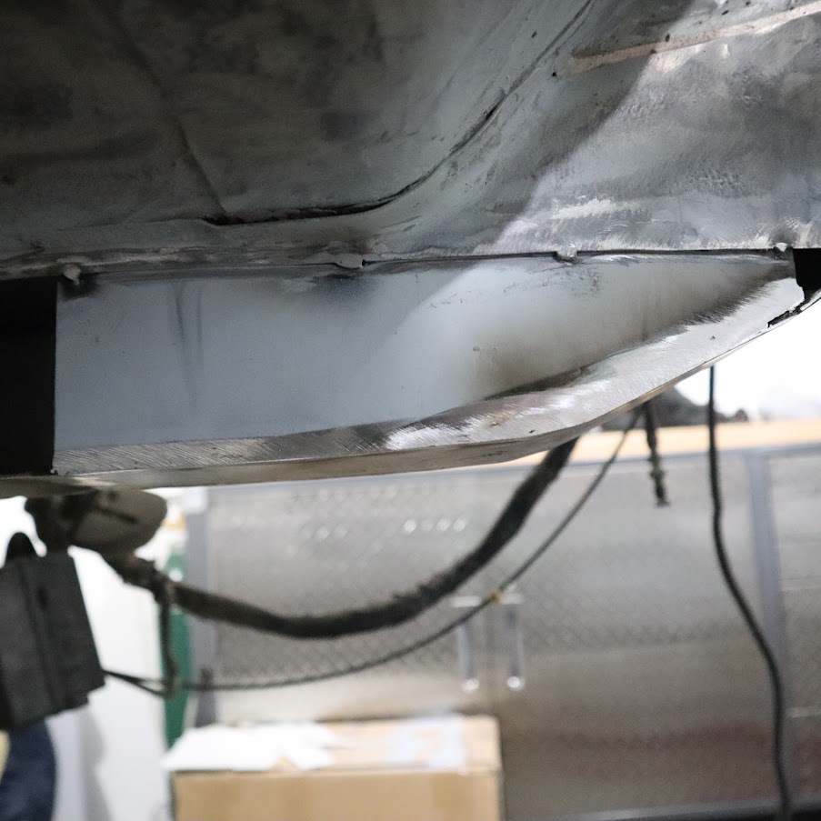

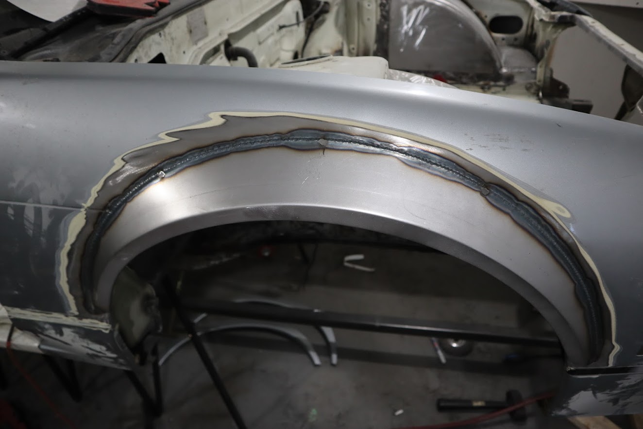

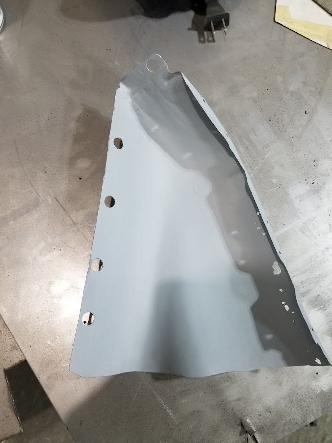

So after a few more surface rust repairs, I got a chance to work on the rear quarter panels. I never modify any rear quarter panels before for over fenders or fender flares. Anyhow, did some research and then I did mine.
Also mocked up some 295 tires to see how she would fit behind these ulterior motive fender flares.
I seen videos where guys would just hack up their rear quarter panels, tacked the pie cuts and then just slap a bunch of silicon on it to "seal" it.
I guess that would work if it's a drift missile. I have seen where guys have done that and sometime later on, the silicon just droops down and is no longer sticking to that area properly. I wanted my car to last for a long time, hopefully still good long after I pass away one day.
Here is a detail video on how I pie cut my rear quarter panels and tacked it on, FULLY welded out so it's sealed up so no debris or moisture can get in.
http://www.youtube.com/watch?v=GV3e5WtHL7A
And here is a short video on me welding the ulterior motive fender flares on and how I went to grind the welds down for a smooth surface. Of course, it will get some body filler so I can achieve that smooth curve. Thin metal will always distort especially when there is a lot of heat being put into it.
http://www.youtube.com/watch?v=D0v6_OoxC1Y

You could go in there with a paint stripper pad only for the rubbery undercoating and paint but it wears the paint stripper pads down quick which is expensive while the wire wheel last longer for removing the undercoating.

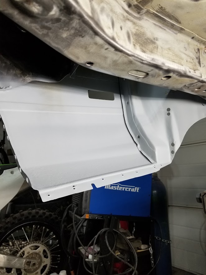

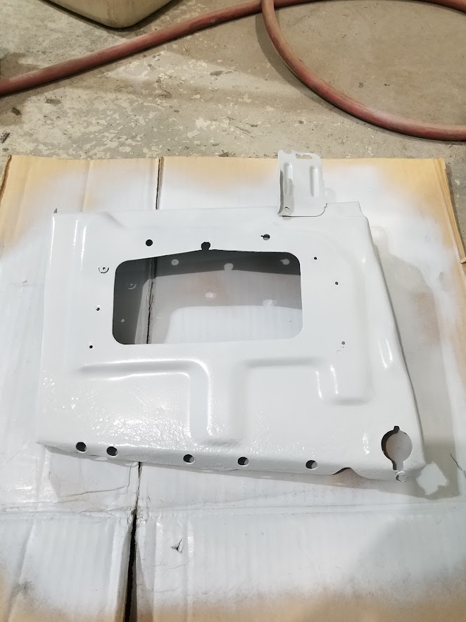

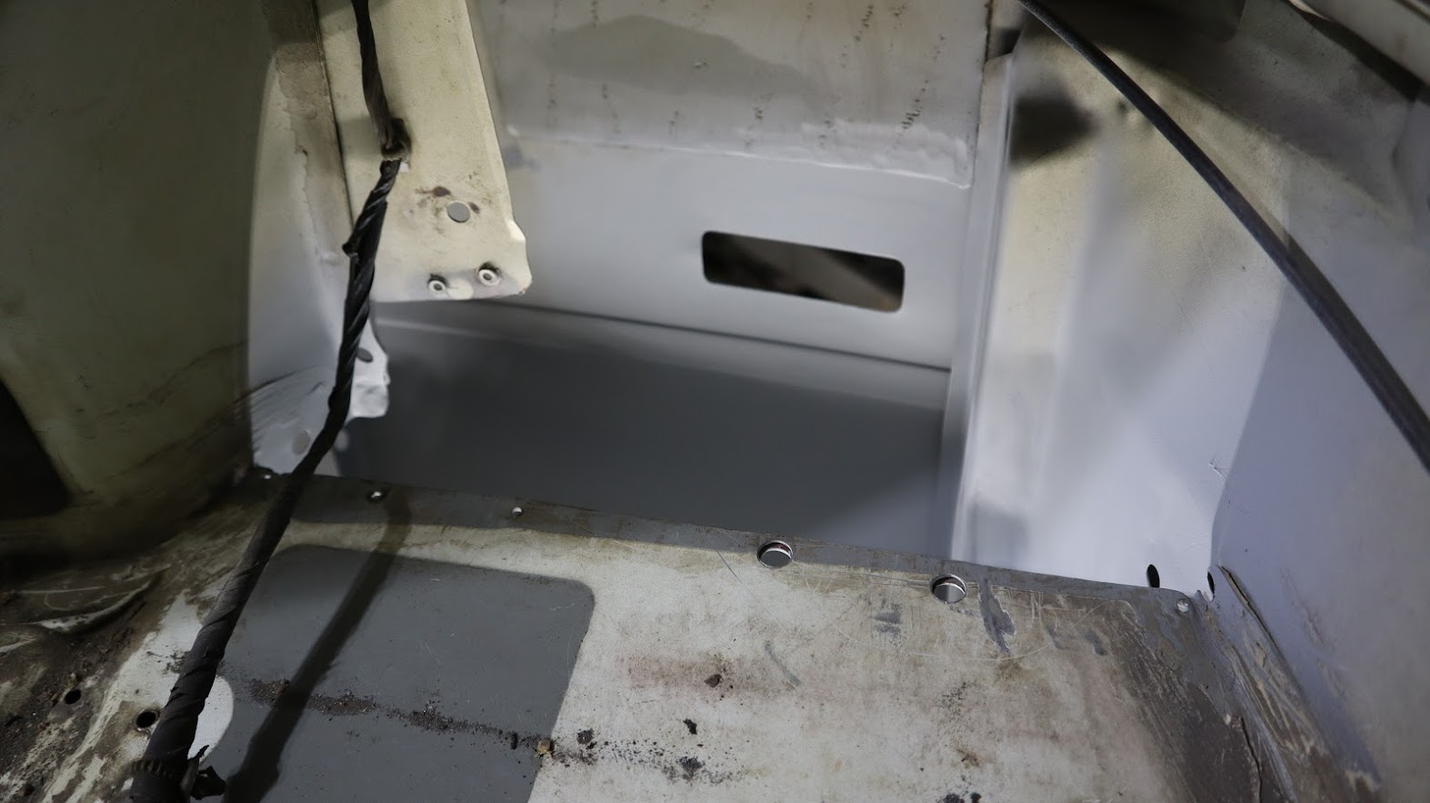

Finally got to lay down white epoxy primer. I decided I'm going to use the WHITE Upol Raptor Bed Liner on the underbody later.
I think @Wooster on IG used diesel to remove it I am planning on giving it a try and see.
Same thing I plan to use if I don't have the underside painted! This is going to be good!

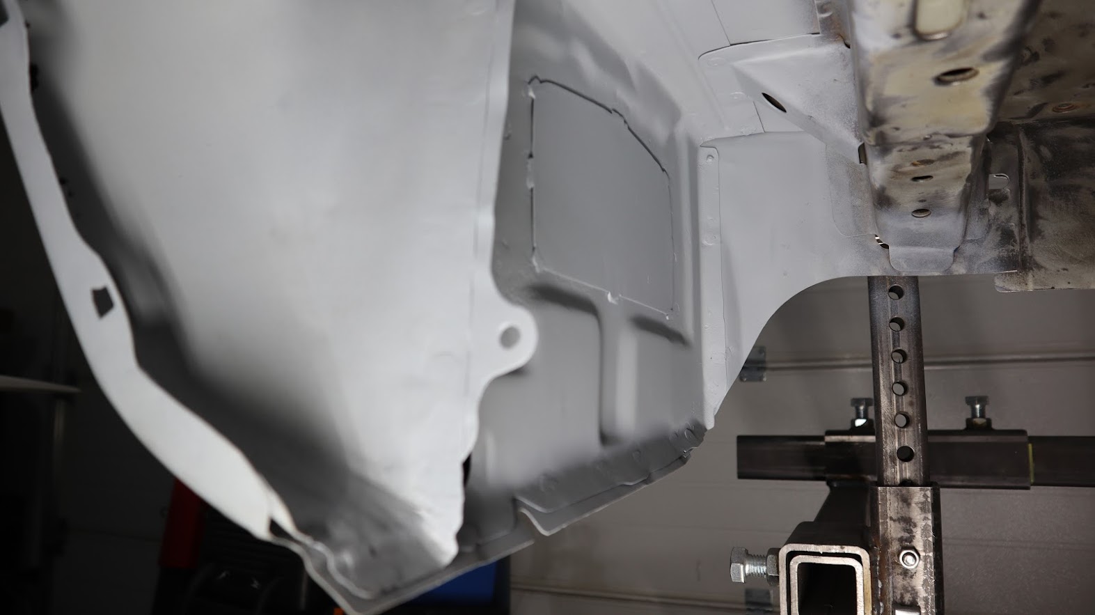

I've been working on the engine bay. Light skim of evercoat body filler where the wheel tubs are, front struts and also where I deleted the holes for the AC .
Then the next day, I laid down some DTM White Epoxy Primer.
I will be applying some white seam sealer all around, followed by Toyota Super White Base coat and clear coat. You will see no flaws.... Hopefully LOL!
