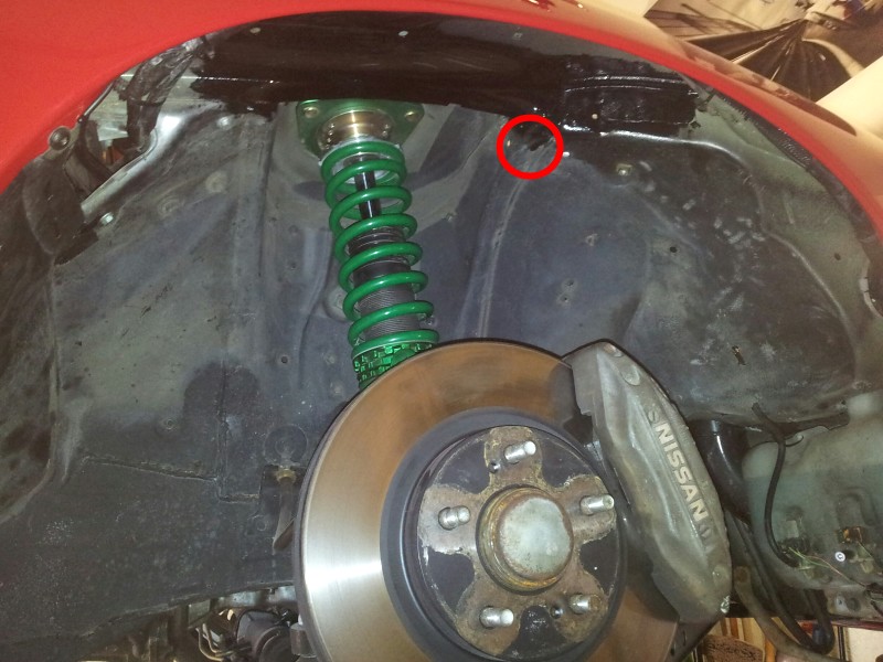

Hi,
I got a Tein Flex on my S13 but the springs are way to soft. The tyre is rubbing on the inner fender wall as soon I turn fast into Corners. From what I've found the Springrates are 5/4 or 7/7. Is there any way to find out what spring rates I've got? front says: V050-LD4 rears: M040-LD3 I'm considering to mount springs from superdrift (10/8) in the fronts. Did someone did this before and how it drives? Would I need a revalve? :/ Last edited by a13x.; 04-30-2014 at 02:36 PM.. |

After reading all of the posts here, a couple of solutions that weren't mentioned:
1.) Ever thought of raising the car? You found out the hard way and it's evident after purchasing while coming to find that you're rubbing. --Assuming you don't have suspension correcting suspension bits, raising the car will aid the car's handling more than your current/desired height. Now if you have raised the car and the dampers still compress and rub or if you did not want to raise the car, here's a cheap (maybe free) alternative: 2.) A large hammer. Surprised nobody has suggested this. --This option is if you really don't want the car to rub while wanting your dampers to be utilized for its intended purpose, the only way to go from there is to make room. Based on the picture you post, you may want to take this cheap route (assuming you own a big ass hammer) If you raised your car and/or if you chose to hammer the inner fenders/tubs out, you could even lower the car back down to your current height and see if it rubs. It shouldn't. Worth noting: With all the free space just know that if you decide to remove a collar or two, you may find yourself back to needing more space. Who needs inner fenders anyway? The German air helps cool the engine bay and helps get water and dirt in for cooling--like elephants in the safari. Cool, huh? |
