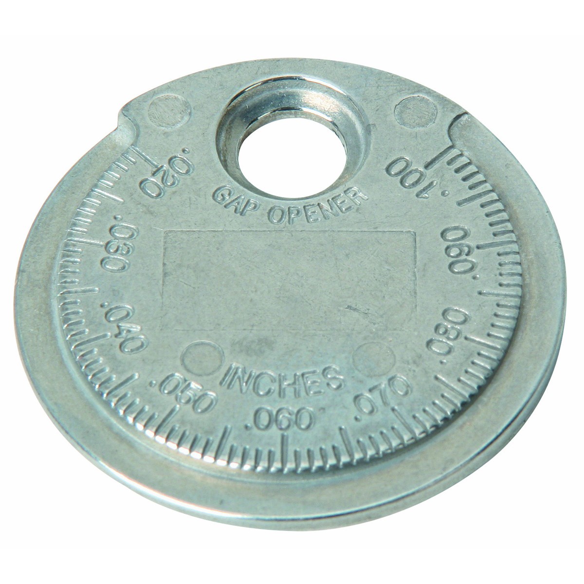

Don't use coin gappers. They're bad:
Do use star gappers. They're fucking the best:
In that picture there are notched parts on the left and right side. Use that notch to adjust the gap this way:
Don't ever touch the tip of the plug! And when you go to check and see if it's gapped correctly, don't press too hard to get the wire through, or the tip will break. If it's too hard, you need to open it up a little more. If it's too easy, try to narrow the gap.

Im on iridiums not gapped as well, dude that gapper looks epic ive never seen one of those in my life and ive been around cars for a while.
Cant say i have exactly payed much attention to plugs until now though.
where can i get one of those ne way? Im sure my pops would love one.

i never really noticed those gappers until recently either, and never had a need for a gapper anyways....
...but, theyre in the tool aisle of pep boys, oreilly, and autozone.

Ya those gapers go for $2.49 a piece at O'Reillys they are a great investment
