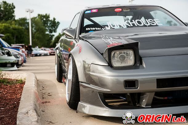

Sorry it doesn't show the whole thing just a pic I snapped tonight. Couple hours of fitting, sanding/primer. Still needs a third round of primer, one of the mounting tabs at the top by the door broke off (shitty excess I had to trim to get it to initially fit caused it to be weak) door gap is mediocre, wheel sits too far forward. Bracket must be made to push the front of the fender off the wheel or it will break like last time while turning
