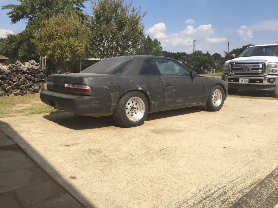

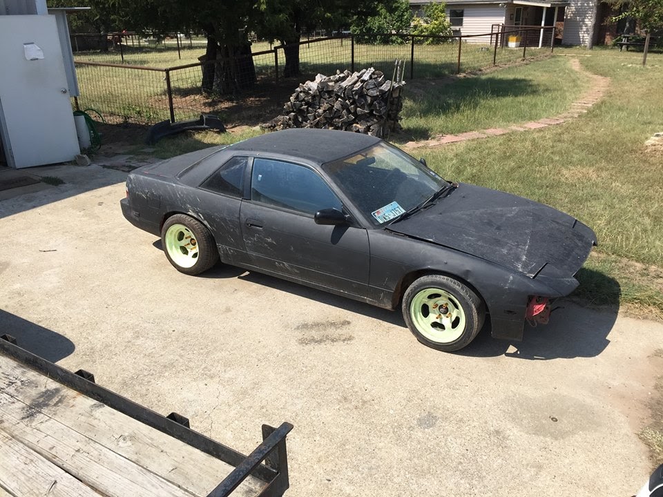

I wanna share my 240sx build with y'all.
I drag race, street race and cruise. Last year I ran an old 1979 ford fairmont with a 80mm borgwarner and a bone stock 5.3. The car wound up being too fast as it had no cage and it was really too rusted out to spend the time to put a cage in it so when I blew the 5.3 up I decided to get something in a little better condition and put my drive train in it.
This new build is a 1990 nissan 240 sx(my first non american car), 6.0L (valve job, hone, new rings, and custom cam all done by me), my glide and converter for my fairmont, ms3x and 76mm/T4 borg turbo. I've done some research on swapping a 9" center section into the car and I will probably go that route. I talked to a guy that was running pretty quick at a local track and he gave me a bunch of info on what to get. The cage is a 25.5 SFI spec good to 4.50 1/8th. My goal is to drive the car to the local meets and race in no prep and limited 8.5. I've been running 26x8.5 for a long time and like them plus they fit and look pretty good on this car.

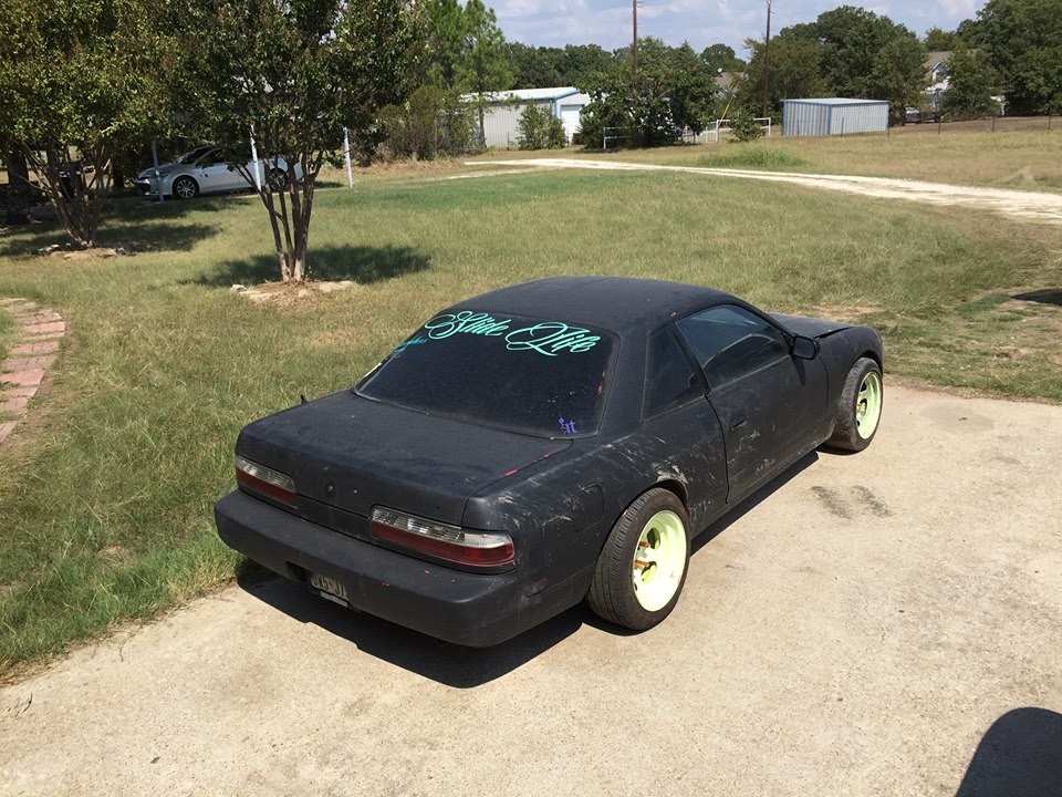

Anyhow let me get you guys up to speed with where I'm at now.
This is the car when I first got it. It says "Slide Life" on the back window.
