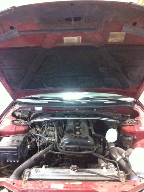

My life pretty much changed when I've bought my first S-Chassis (1996 240sx) in 2013 from a buddy and the car was in excellent shape.
This is how she was sitting when I bought it

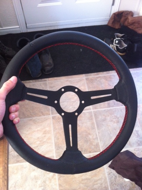

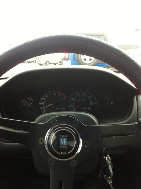

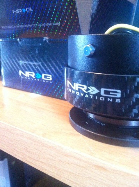

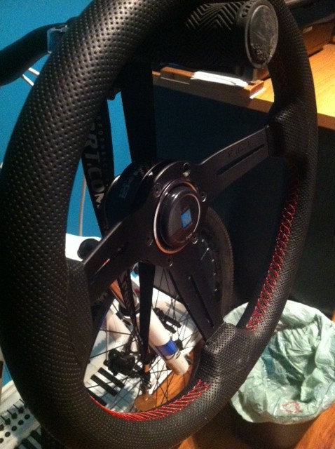

NRG Quick release and Nardi Steering wheel

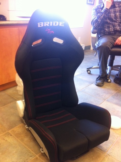

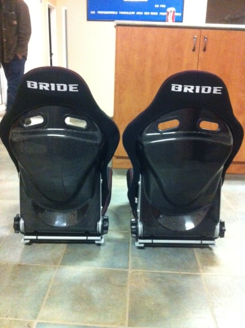

Next was my Bride Carbon Low max seat

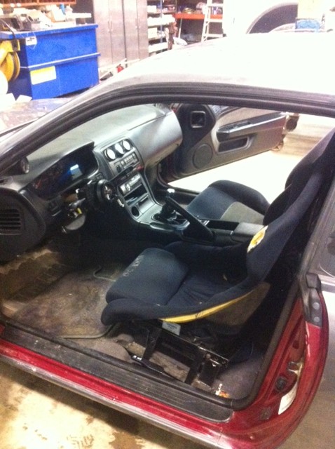

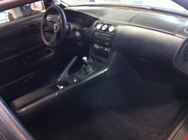

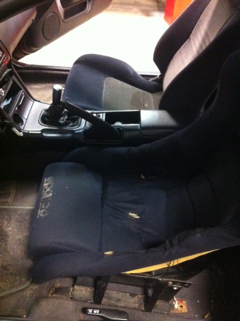

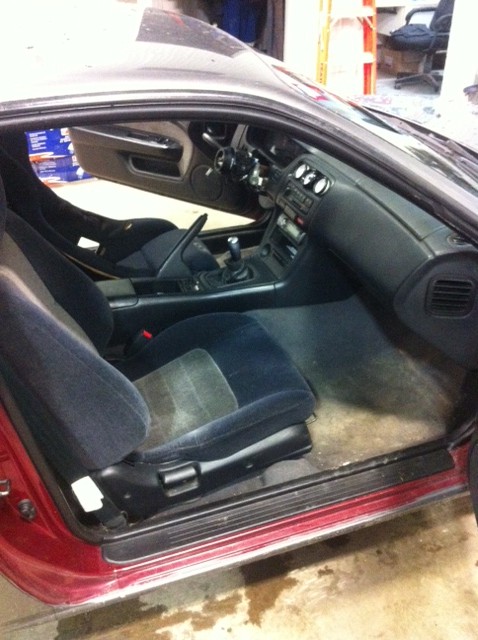

The interior of the car was the only thing that was realy bothering me so I've put a little time to make it clean by changin the carpet, seat, streering and a couple of other stuff. This is how the interior were before.
This is the new carpet with the old one.
And the new carpet installed with the new steering and quick release

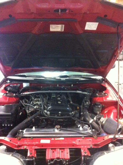

Once the interior was finished, the engine bay needed a little cleanup
Before
And after

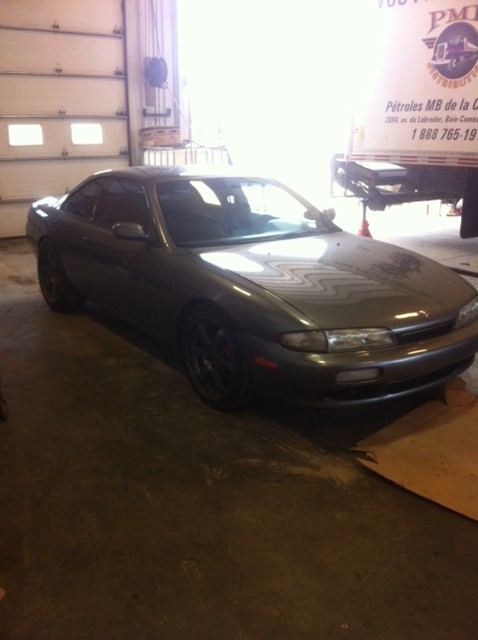

I've take the time to wash the exterior and change the tires
And new tire need some test to make sure they are safe lol

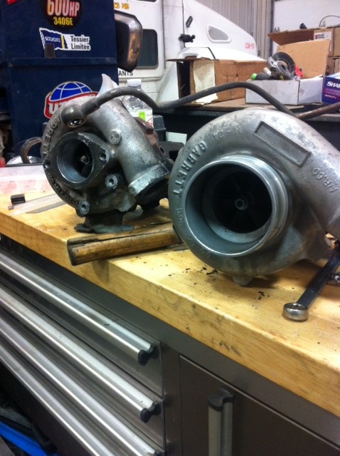

A couple weeks later the stock turbo said the has enough so I've bought a Garrett GT28 for a good price

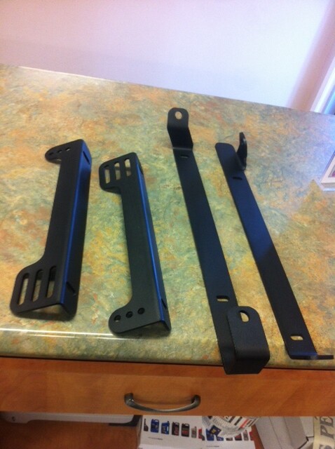

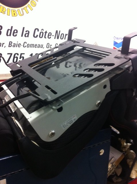

At the same moment we took the time to change the seat mount for better one

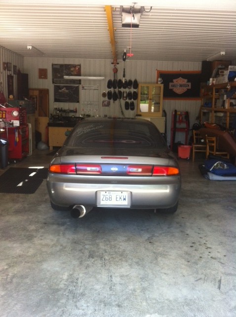

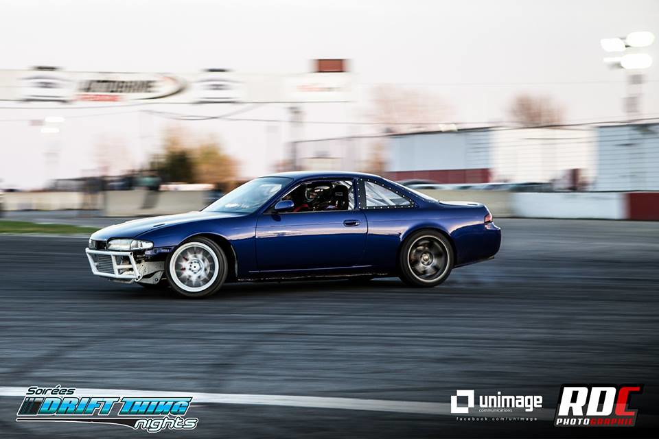

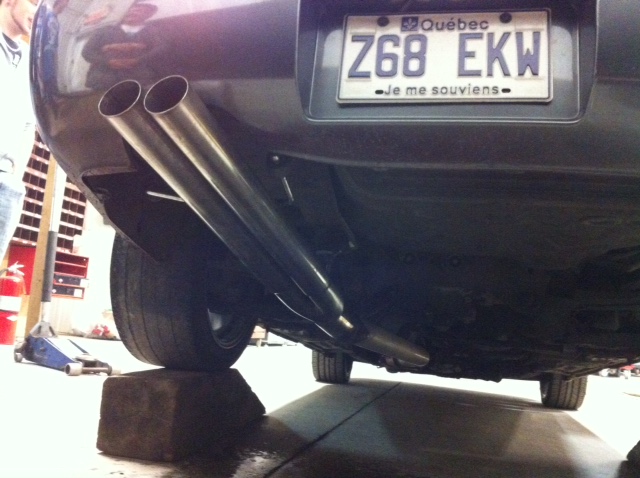

We made a custom shotgun exhaust and put some new Stance SS+ Coilovers
At the end of the summer we said "Hey, why we don't go to a Drift Day instead of getting the police in our ass all the time". So we borrow an enclosed trailer to a friend, take a shitload of tire and hit the road !
To make a short story of the Drift Day, we were a Montmagny Race Track and the car didn't have enough power to take the banking easily until I have to give him a little push by taking the turn in 3rd gear full throttle and bashing the clutch pedal... BUT! I was able to drift and have fun like a kid in a McDonald parc for around 1 hour before the clutch had enough
This is the only picture i have from the DriftDay...
It was the autumn 2013 and I began to go full retard by taking a clean ass 240sx and build a race car.

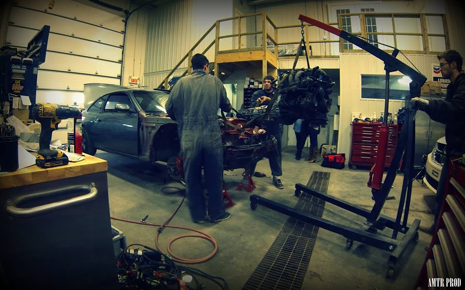

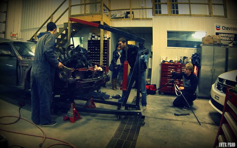

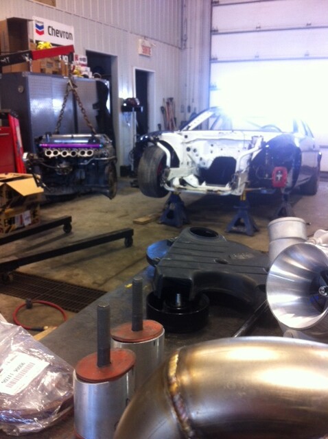

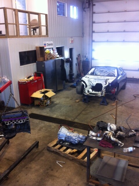

First step was to put the Sr20 out and sell it
The motor was gone and the complete tear down was starting

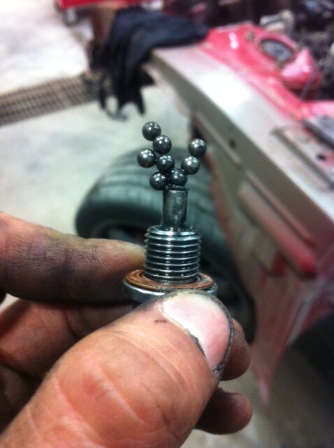

Took a funny picture of an oil drain plug

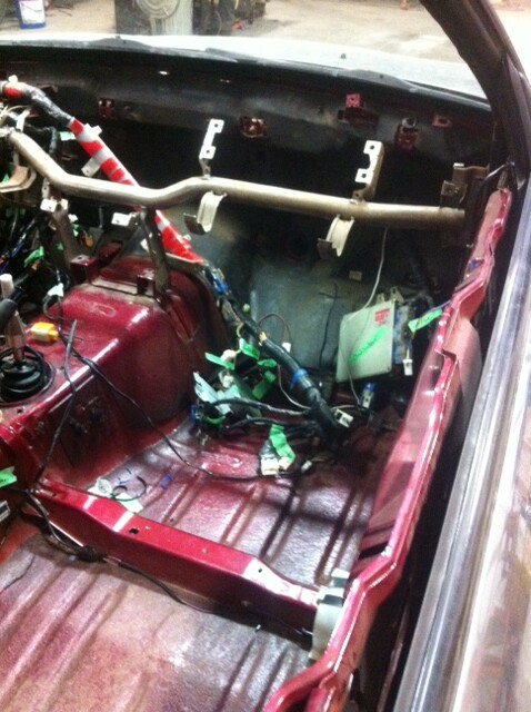

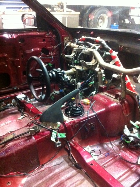

Now the car was pretty much naked and it was time to remove the sound deadening with dry ice, but first why not go outside and put yourself in a bad situation
Okay, back to the build, the sound deadening was removed and the subframe was removed too

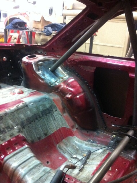

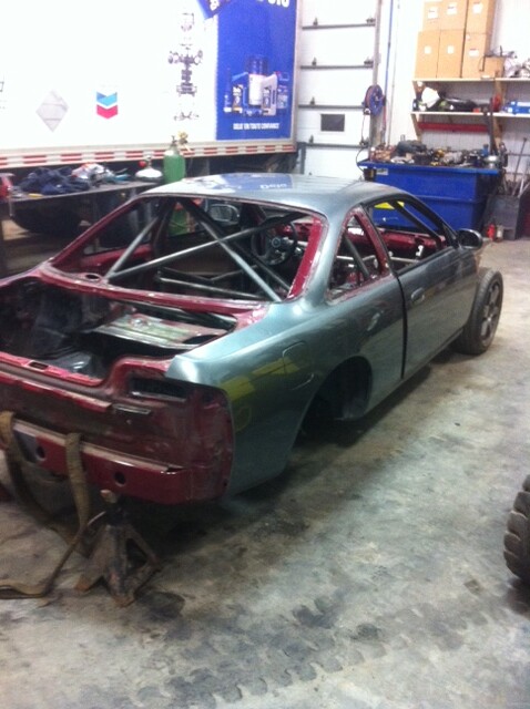

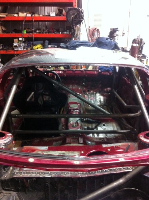

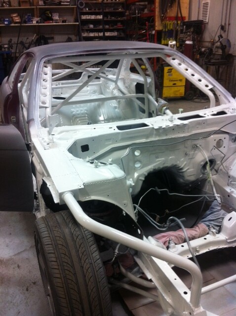

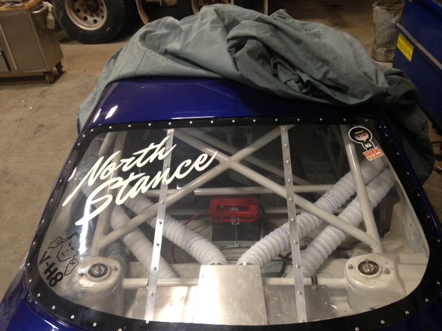

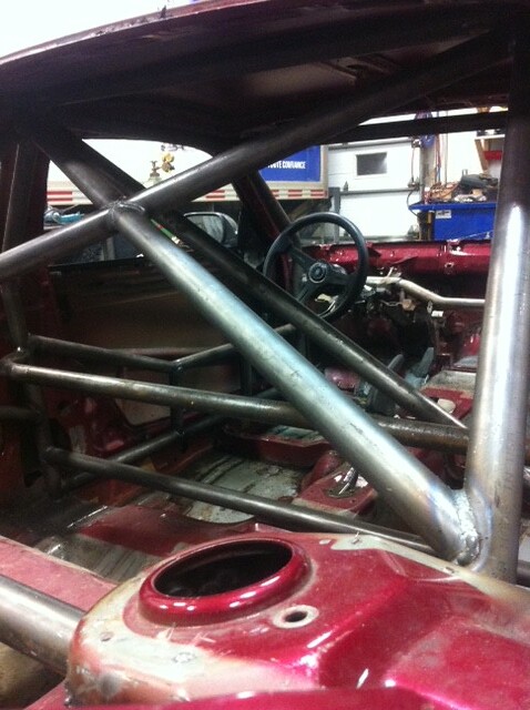

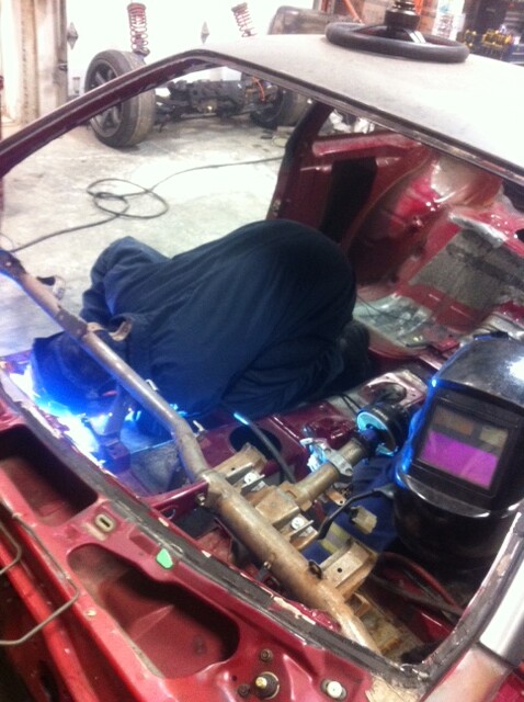

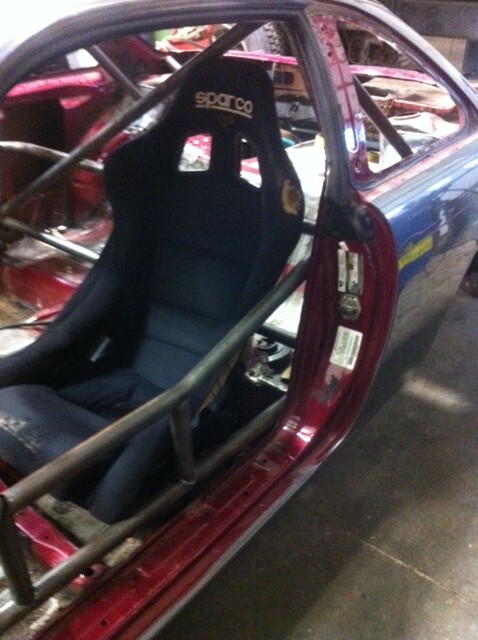

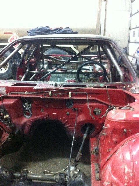

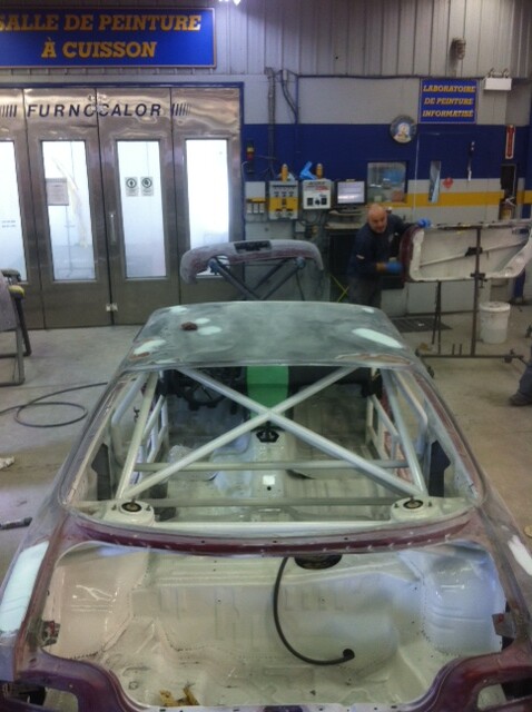

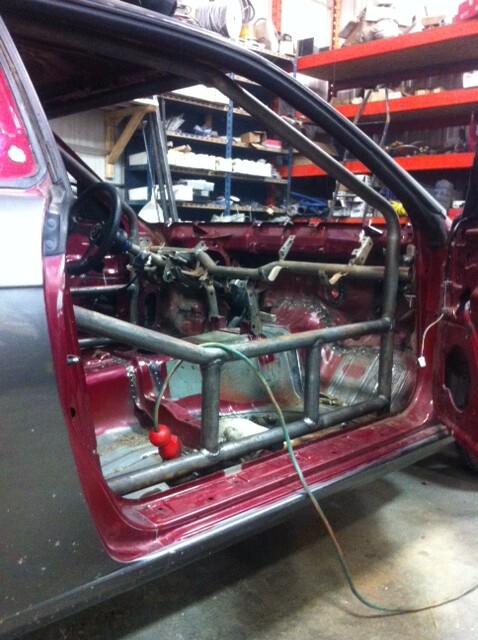

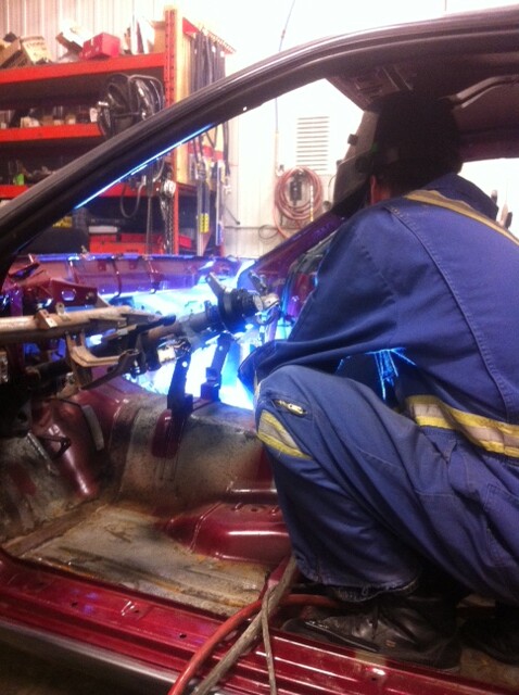

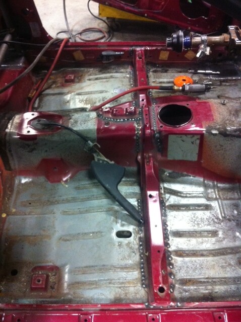

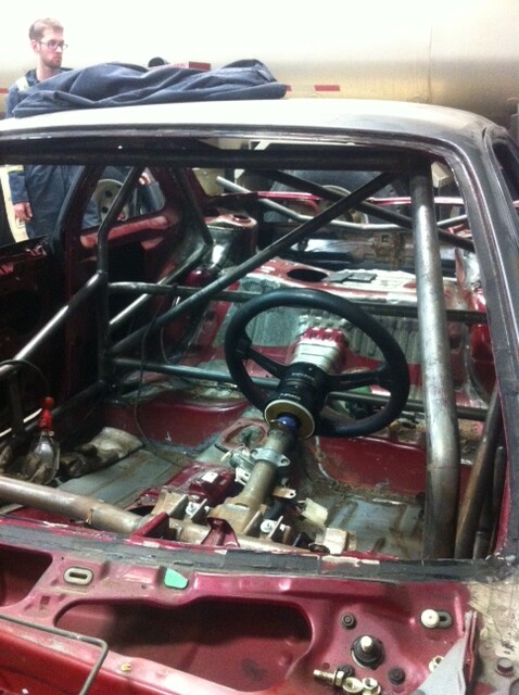

First, we stitch welded all the interior and after that we started the cage
Main hoop almost done
The cage is starting to take place in the car
I took an old seat to take the perfect measurement of the angle of the seat belt and door bar
After a couple days doing fabrication the new 2Jayz came to my door

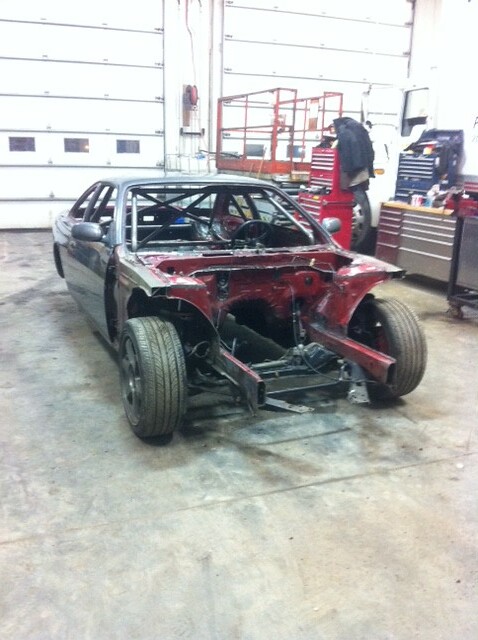

Cage almost finished

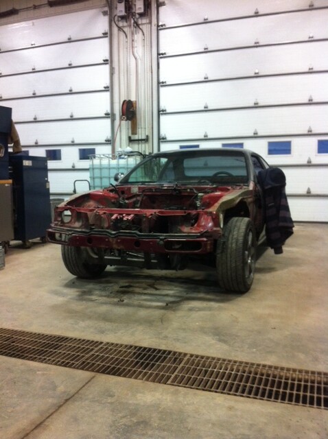

Cut the front end to take the measurement for the new tubing front end

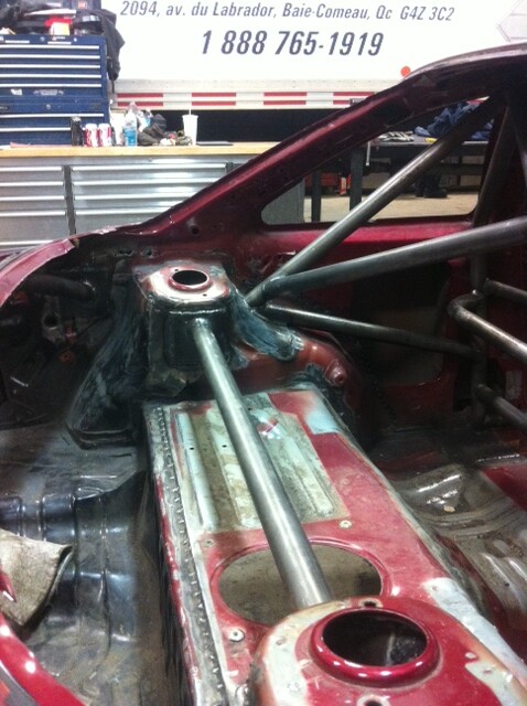

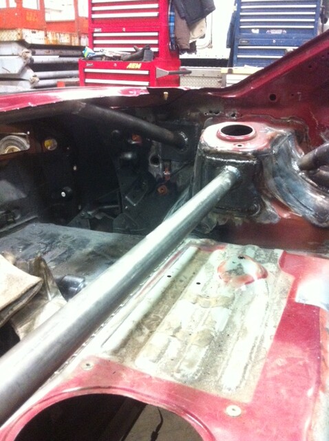

The x-brace and shock tower bar is done and instaled

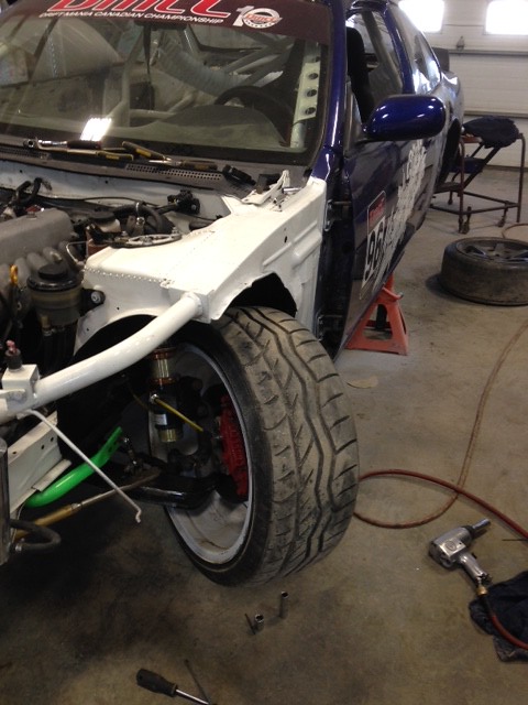

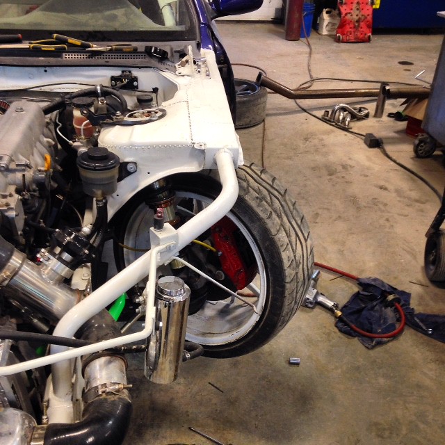

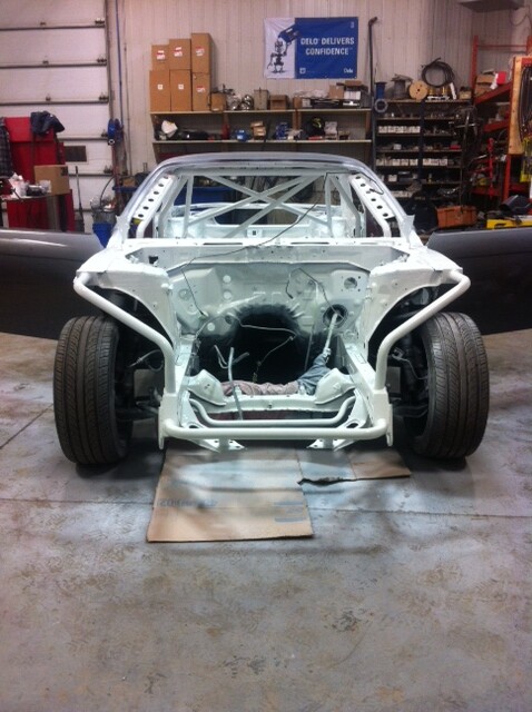

Now the cage is pretty much done and its time to make the new front end and prepare everything for the paint

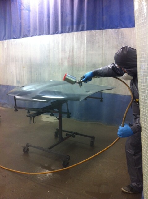

Primer is on, time to paint has come !
Now the interior and engine bay look cleaner than ever, so it's a good reason to take a break and go stuck my truck in the mud haha

Not tying the A pillar bars together?
Yes they are

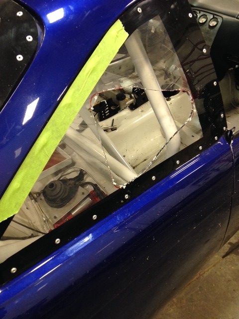

First, we installed the Aerocatch

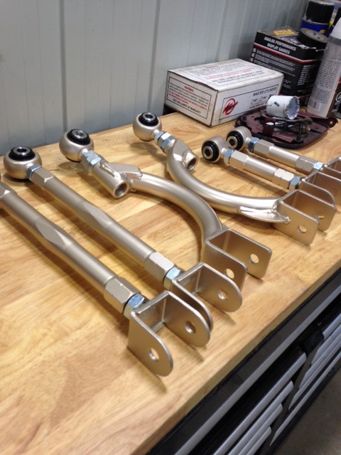

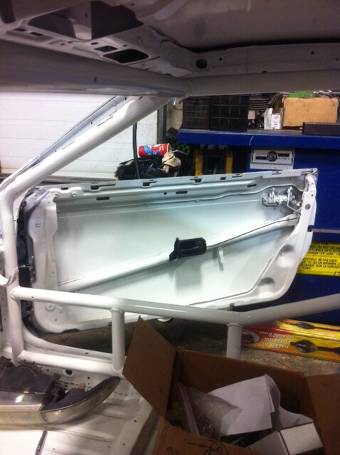

Making new doors handle

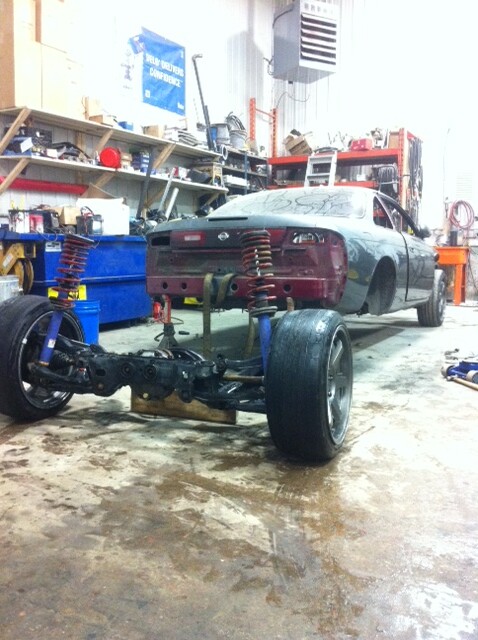

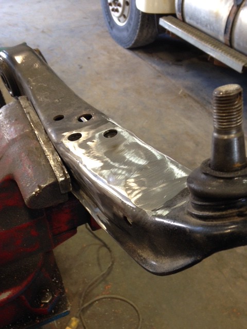

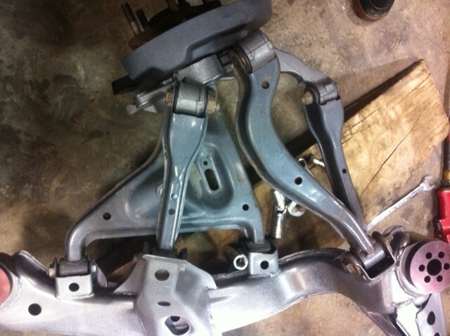

The subframe was put back on the car, we put new arm and bushing, inspected the bearing and the differential (Its a Nismo 1.5way), paint it and install it back.

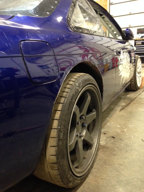

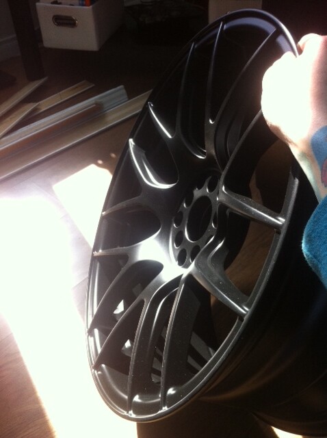

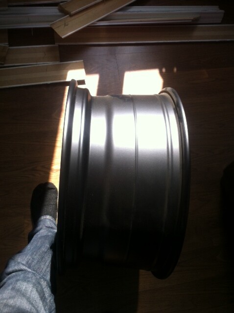

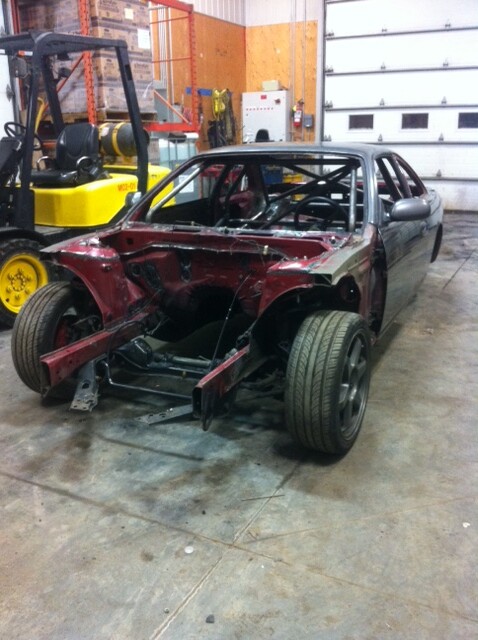

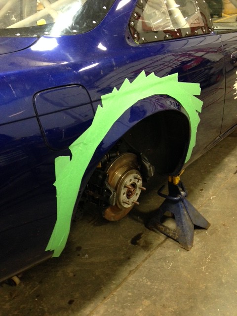

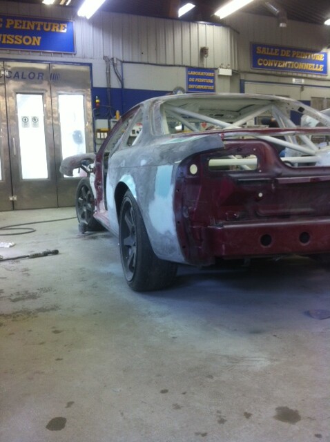

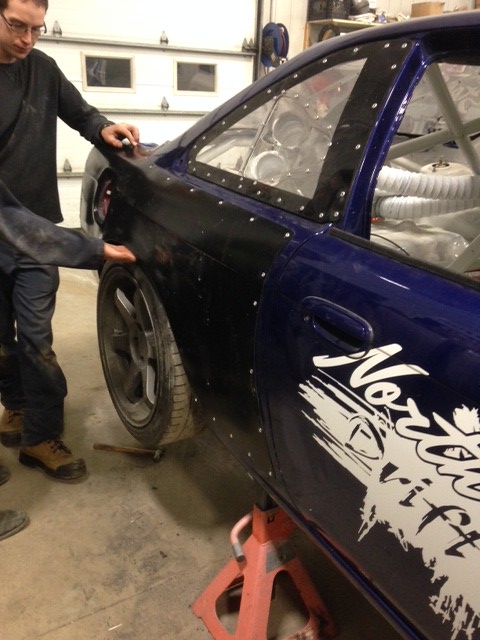

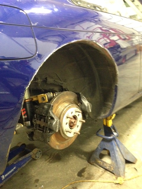

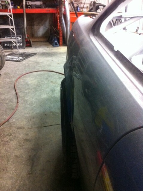

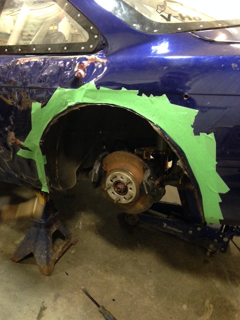

Then the new wheels came in so I took the measurement to know how much I needed to pull the rear fender because I didn't have enough money to buy over the fender

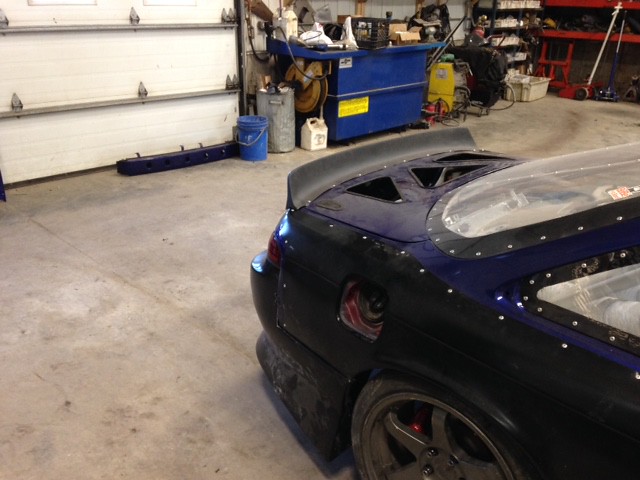

I know I know... It look like sh*t but after the body work it's gonna be perfect
The tow truck came to deliver the car to the body shop

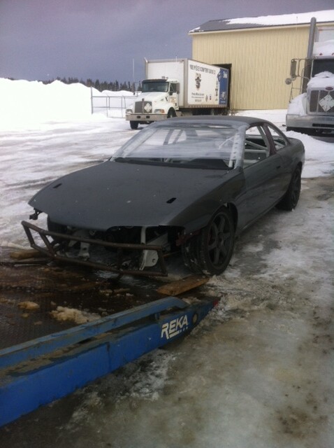

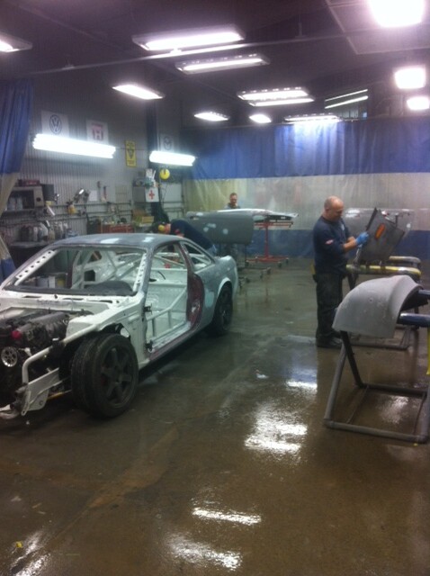

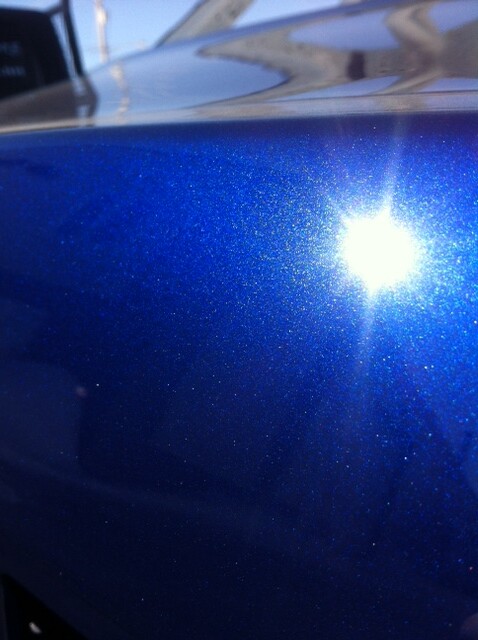

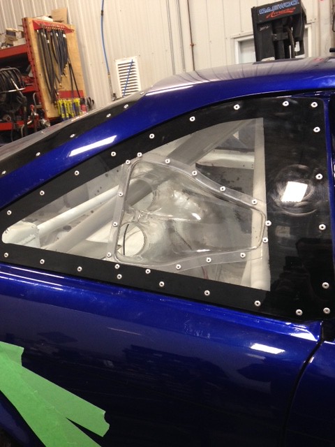

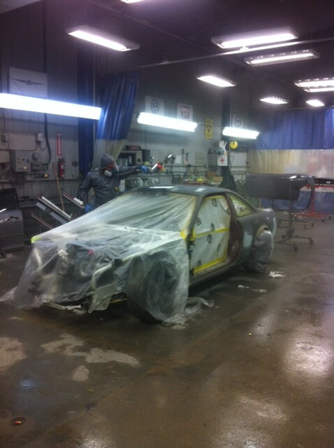

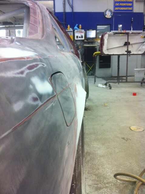

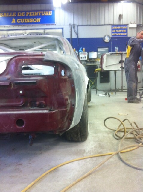

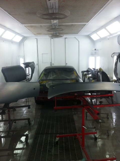

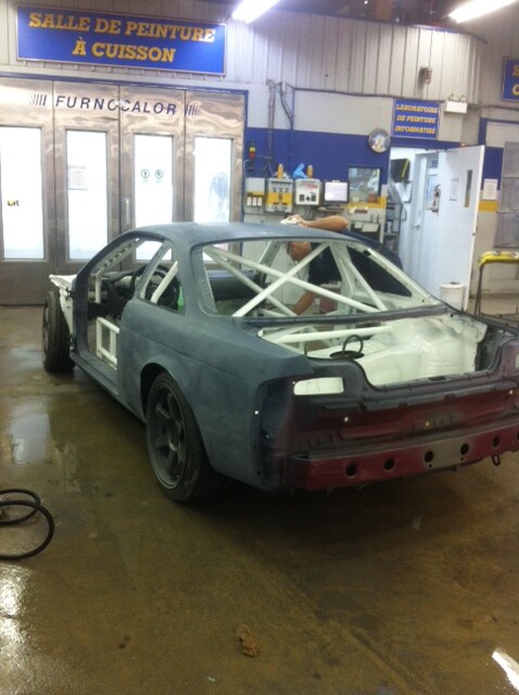

Now it's time for the body work! I could describe what they were doing, but the picture will talk themselves.

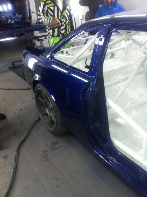

Are you ready to see the final result
It's a Lexus LFA blue and I was very happy with the result (of course with a shitty cell phone picture)

did you just pull those rear fenders or was there any welding involved?
can't image pulling them out this far :-O
htc.zenit is offline   Reply With Quote
Old 12-11-2015, 06:00 AM   #11
Paulfir
Paulfir's Avatar
Join Date: Apr 2013
Location: Canada
Posts: 23
Paulfir is an unknown quantity at this point
Originally Posted by htc.zenit View Post
Nice work!
hahaha yeah they were only pulled, it took a long ass night to do it but it's doable :P

FYI that Nardi is a fake.
Old 12-11-2015, 09:54 AM   #13
Paulfir
Paulfir's Avatar
Join Date: Apr 2013
Location: Canada
Posts: 23
Yeah i didin't know when i bought it but I've bought another one this past summer

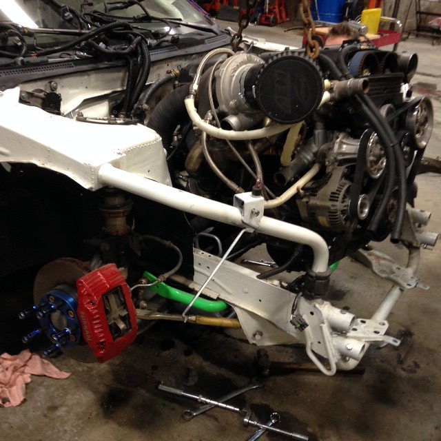

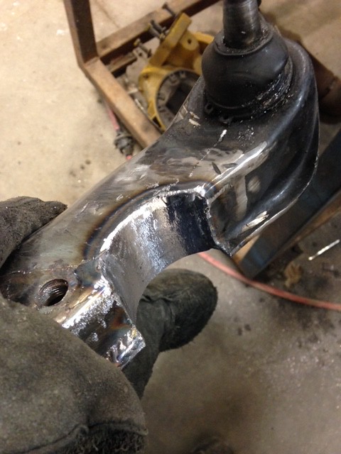

First, we have removed everything we didin't need on the engine to refresh it. Remove the AC, New Water pump, new pulley, new seal, new timing belt, new hoses etc.

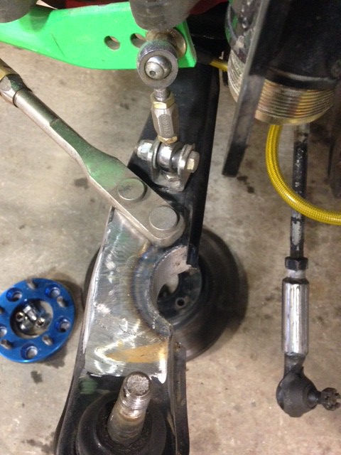

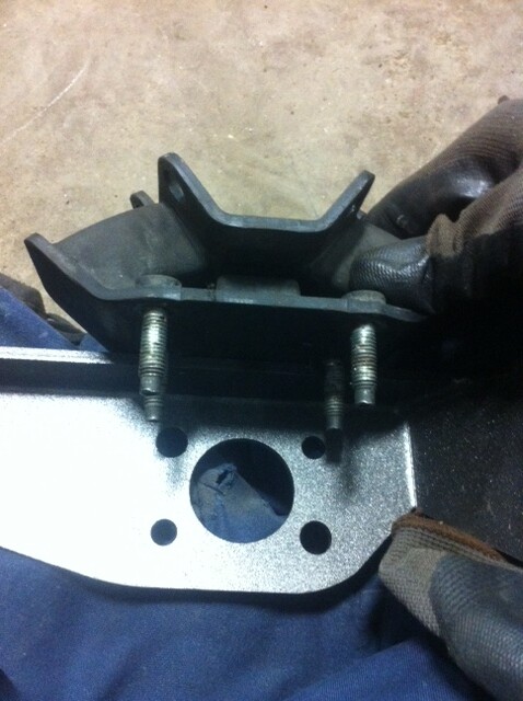

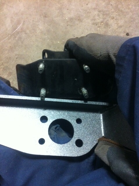

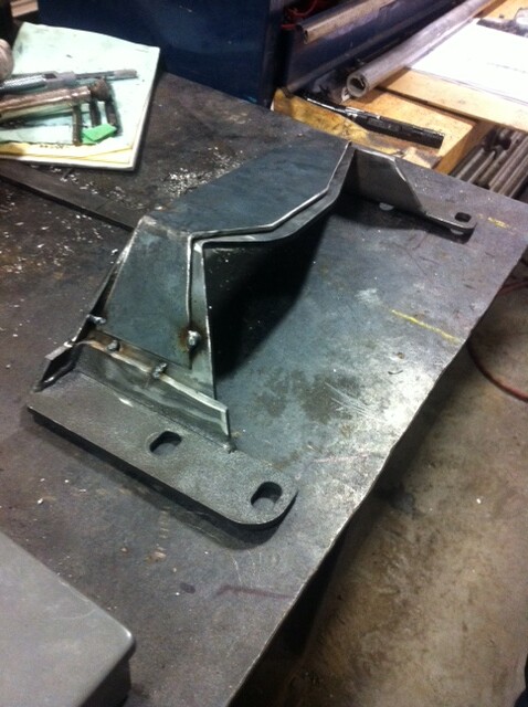

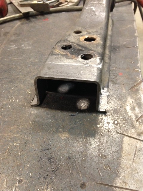

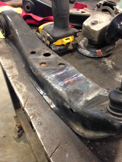

One problem that we were having was the transmission mount. It was a R154 from a 1jayz and the support we bought didn't fit, the holes wasn't at the good place, so we managed to build one...
This is what we build, once it was fully welded and painted, this mount looked like brand new and stronger than ever.

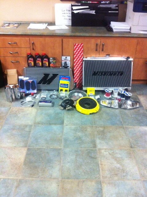

The parts were starting to come in. Sadly, I don't have the half of the parts we put in this build in picture...
P.S. Don't buy this in-line filter, not because its a bad brand, it's just very to small..

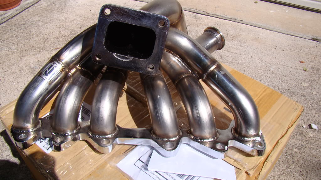

QuickSilver Manifold

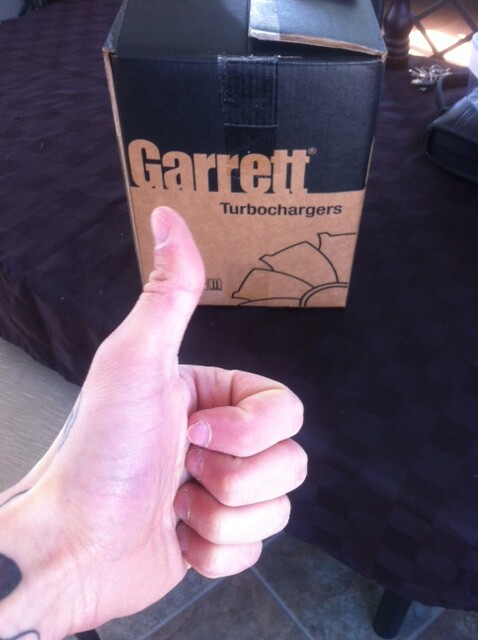

Garrett GT30, Hold on, Hold on.... I know its too small for a 2jz BUT seriously by using this little snail I have almost no lag and because I use Sunoco Race Fuel (116) I was able to have around 500Whp and a little more Wtq and hit full boost before 3000Rpm !

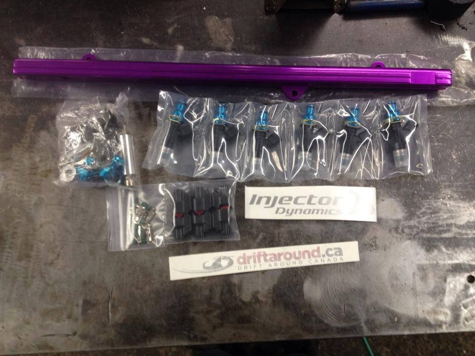

New fuel rail and ID 1000
New seat and mount came in

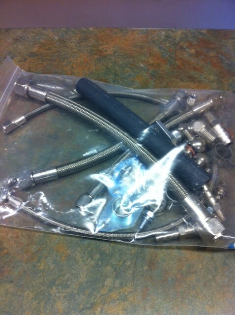

Turbo oil line and fitting

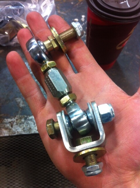

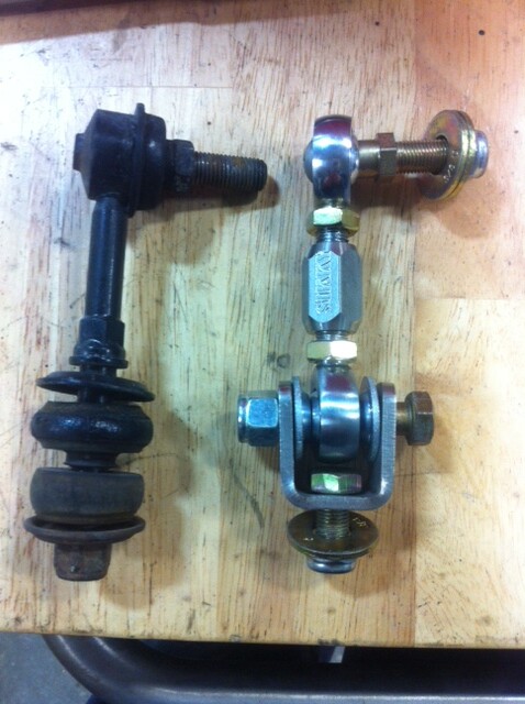

I have bought a sikky sway bar and I don't have pictures of the sway bar, but look at the difference between the OEM and the Sikky Link Kit

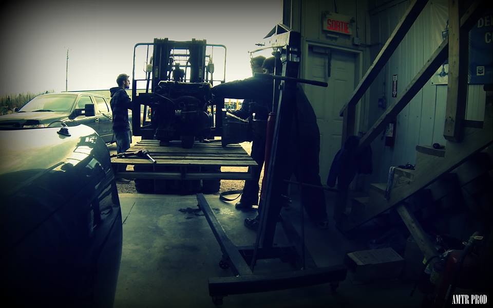

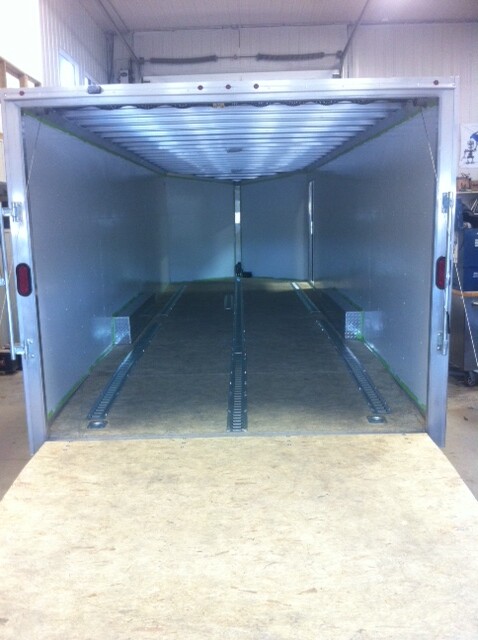

This was probably the biggest part that came in hahaha, 30feet enclosed trailer

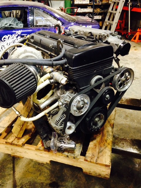

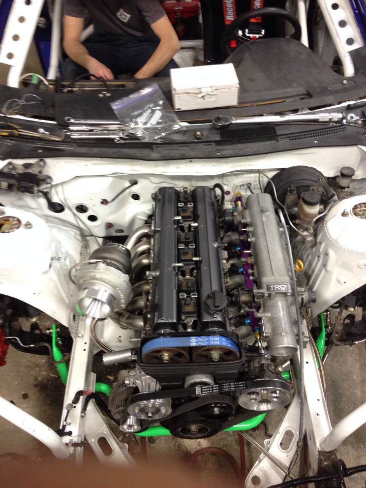

Now it's time to put a heart on this car !

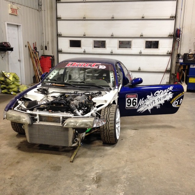

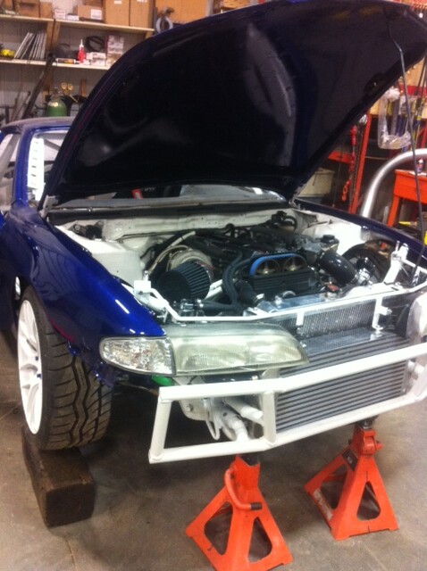

The engine is now fully dressed!
The rear wheel fit great with the fender pulled

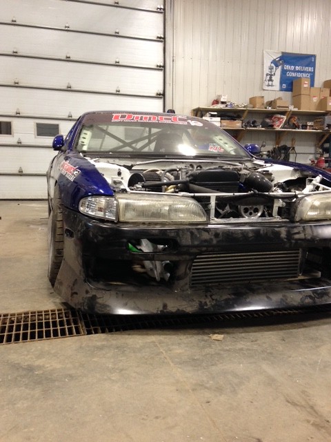

Now the engine bay and wiring is almost ready
And the final result for 2014

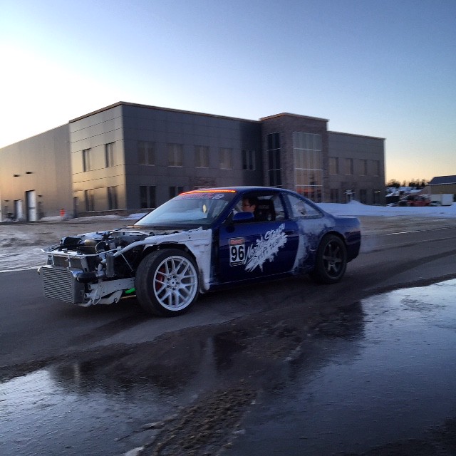

Okay now the first round of 2014....What the **** i was doing there haha
no seriously I wasn't ready to be there, it was the second time i was driving the car and at this point the car was still driving me. So to make a short summary, we didn't qualify but it was another day to learn to drive the car...But not a good place to learn lol.
Here's a couple shots from the day

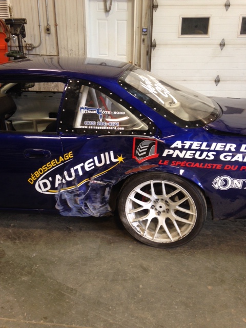

This was the first event of the 2014 season and after this round my wallet was empty so we didn't have the choice to skip a couple rounds and try to learn how to drive the car.

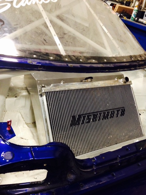

Update #4
UPDATE #4
Sup guys ! It's been a couple weeks since I updated this thread. In this update i'm going to show you the 2014-2015 winter build who was mostly about improving a couple of things on this car like the over-heating, not enough steering angle and give him another look for 2015. Once again, sorry for the picture quality.

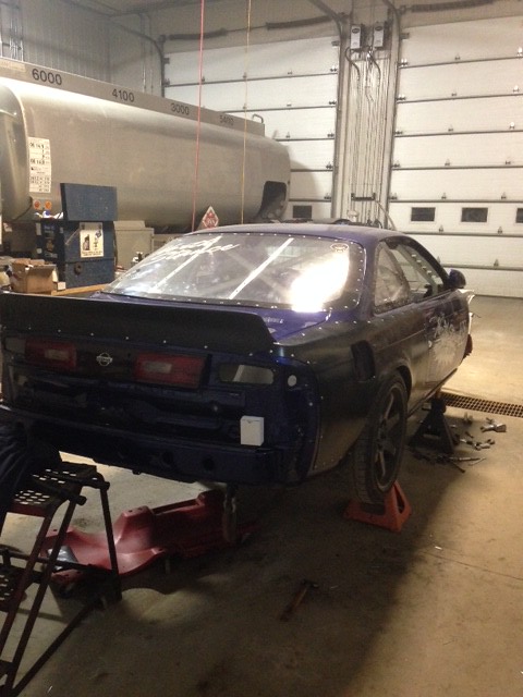

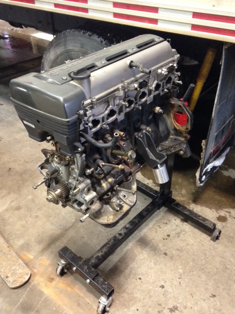

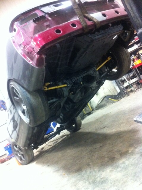

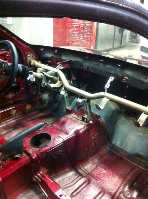

First, we put the car back in the garage and it was time to tear it down.
Once the engine was out it was time to go have fun with the missile.

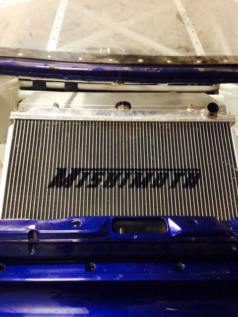

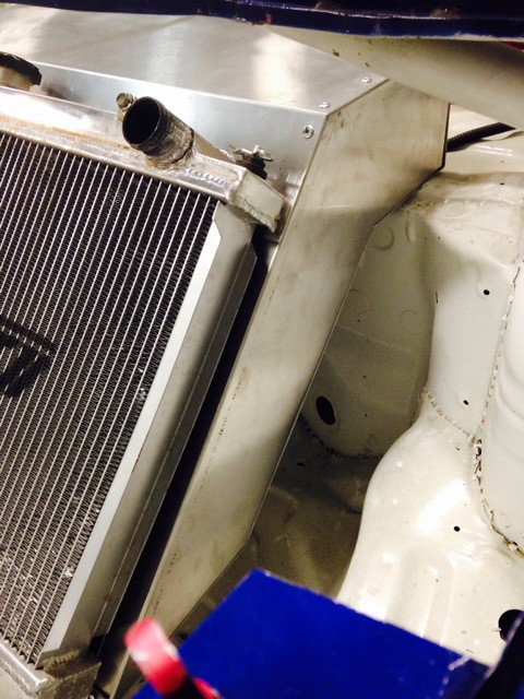

The first thing on the list was to put the radiator in the trunk to solve our over-heating problem.
First, we build an air box to put the radiator and the fan on it.
Then we put some twin air duct to make the largest amount of air go in the box.

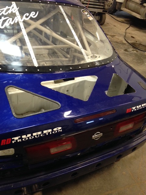

After that, we made holes in the trunk to vent hot air out to keep the radiator the cooler possible.
When we were going to take my new body parts from good shop located in Quebec city I came across this beauty.

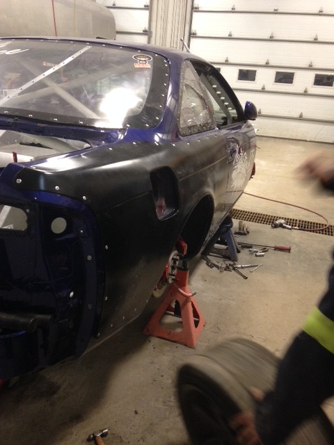

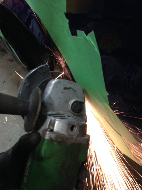

Another night in the shop ! It was now time to start the measurement for the new Overfender and start to install all the new body parts. FYI its all "drift quality" body part so it was a pain in the ass to install.

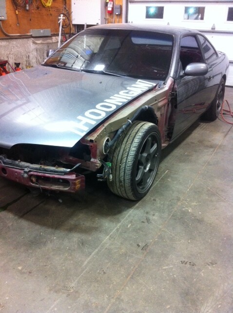

On this picture you can see how much the body of the car was damaged by the old accident, but its only body panel damage, the frame and everything else are straight

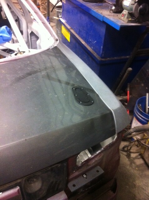

Then the Rocket Bunny Ducktail
What's better to come to your home more drunk than ever and see your pickup like this...
We did a little refresh on the engine bay paint and we put the motor back to start our extended LCA and knuckle. I didn't have enough money to buy a best perfect shiny maximum yolo angle kit so we made it custom to improve our steering angle and keeping more money for the season.

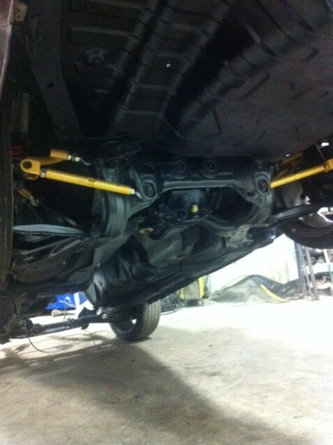

First, we cut the LCA to make an extension. I can't remember if it was 25mm or 30mm.
Since we were extending the LCA we thought it was a good idea to reinforce it.
Like nothing happend

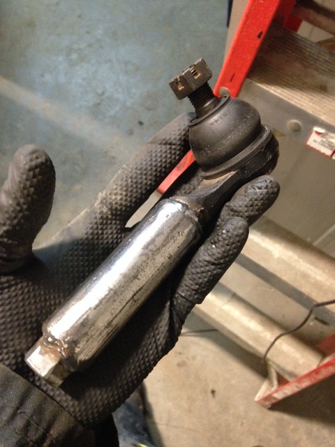

And we made some custom tie rod ends
After the first test fit, we made a notch on the LCA to reach a little more angle.
And we were pretty much happy with the result

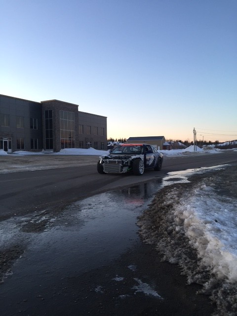

A little paint job and it was the time for a test drive
The car was running great!

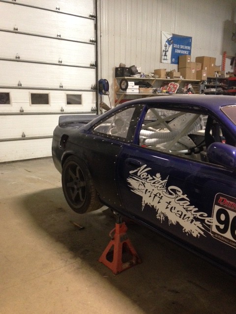

The last thing was to make a new bash bar, finish the body and prepare ourself for the first round
New bash bar finished
The rear body was fitted and we put some new rear control arms
The body was fitted and it was time to prepare the car for the track test and sadly we didn't have the time to wrap the car for the first event...
Once again... I don't have any picture of this day, but I have a video that I will upload tonight. One of the best drivers in Quebec city was very nice to come give me a little training to improve my driving skill.
I will post my season recap in a couple hours !
Thanks !
