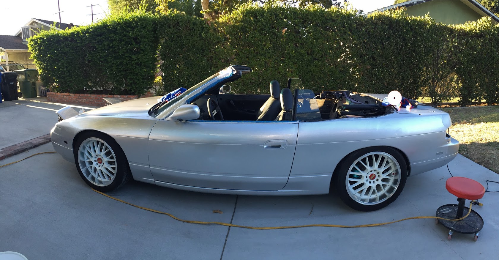

Alright, this is my 1992 Nissan 240sx Convertible (some of you may know this car from prev owner)
i bought it on February 2016 and start to get her beauty back
This is my first time working on a car, (i was focusing on restoring old school BMX bikes) so everything here was new to learn.
Believe it or not all this is on a budget, from tools to engine parts
trying to spent LESS possible without compromising quality
DO IT YOURSELF...to save money and LEARN in the process (and that's priceless)
Google and YouTube will be your best friends from now on
if you notice i post too many part prices is because i want you to see that you dont have to be rich to do all this.
This is not about being cheap... is about to being Smart

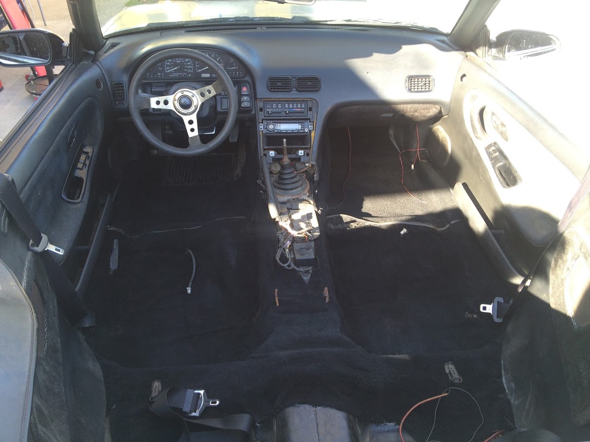

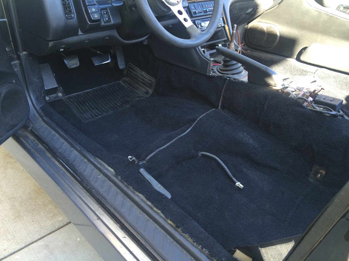

i receive her like that...
and you will see the whole transformation step by step
1st day at home
and the archaeology starts...

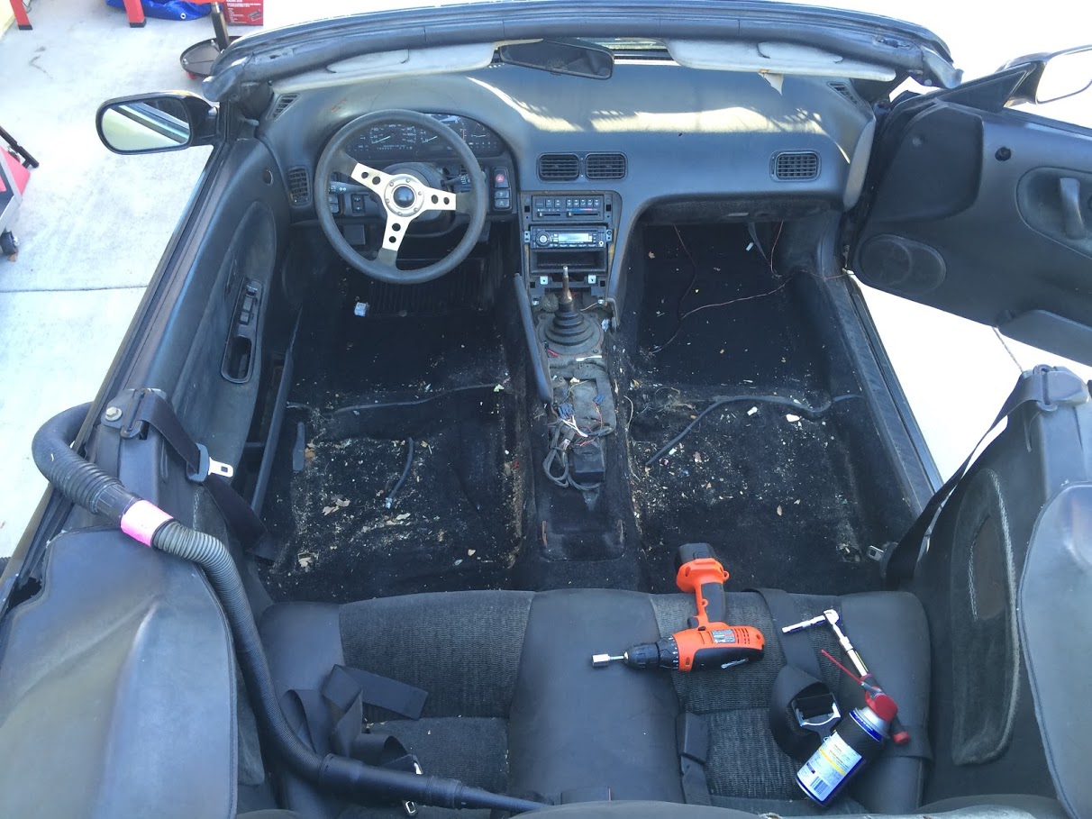

Cookie somebody?
Hey u forgot your Bra here!

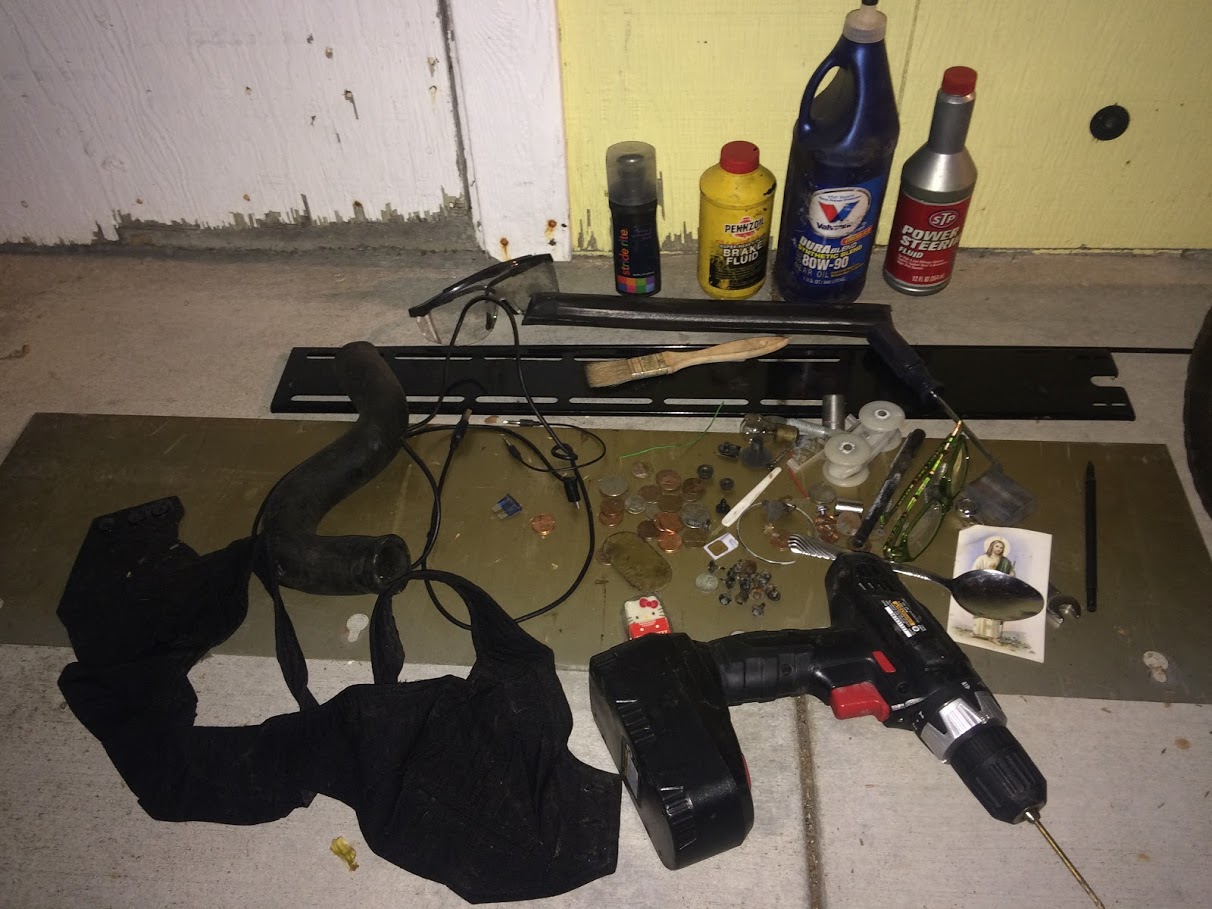

All what i found in this car... (yep, even the drill)
After some cleaning

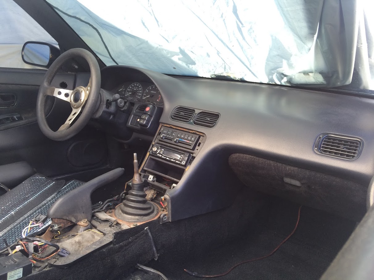

And started doing a detail checking... finding whats really on this car

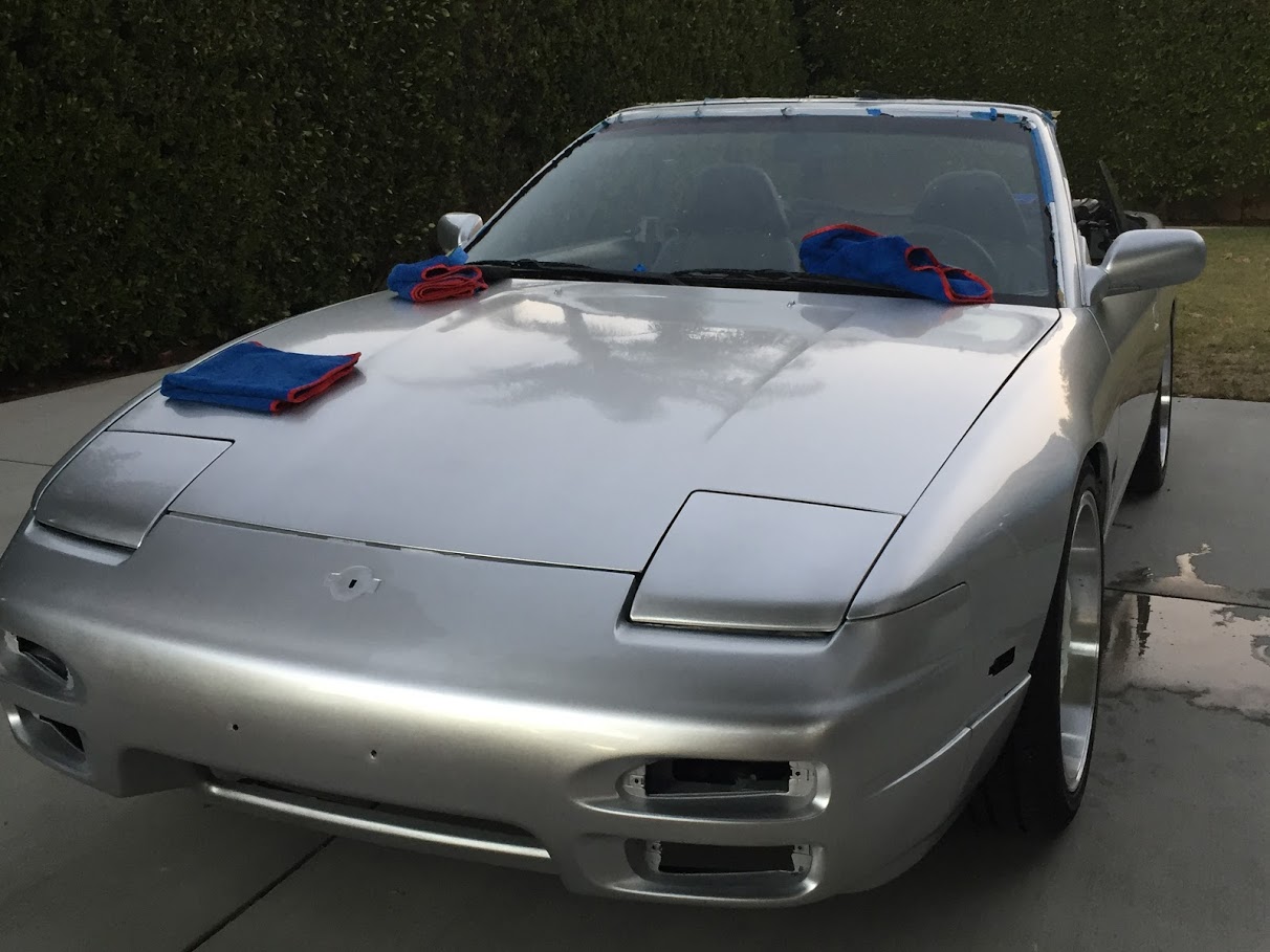

Got her a Cover

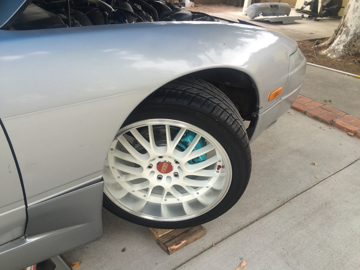

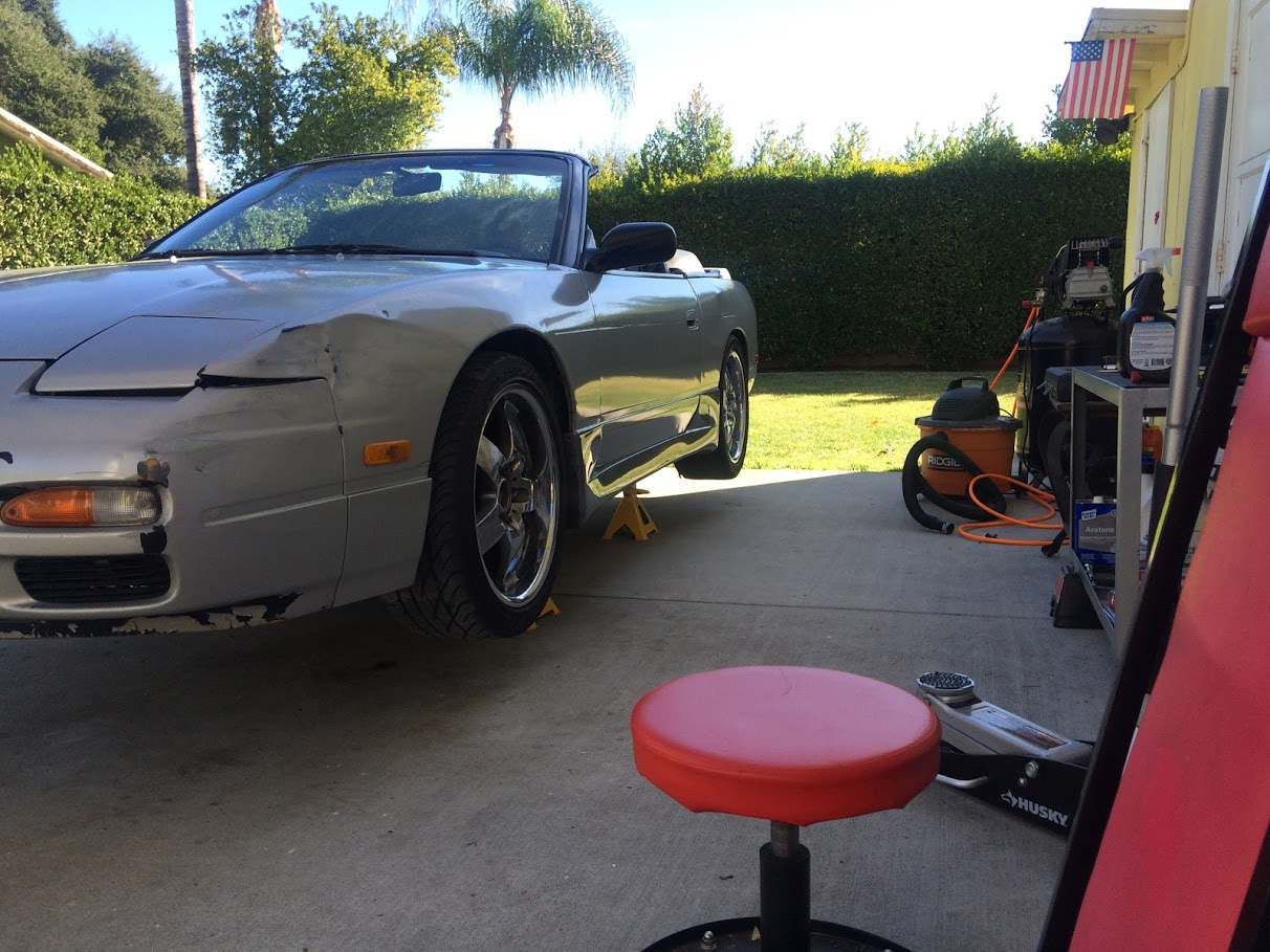

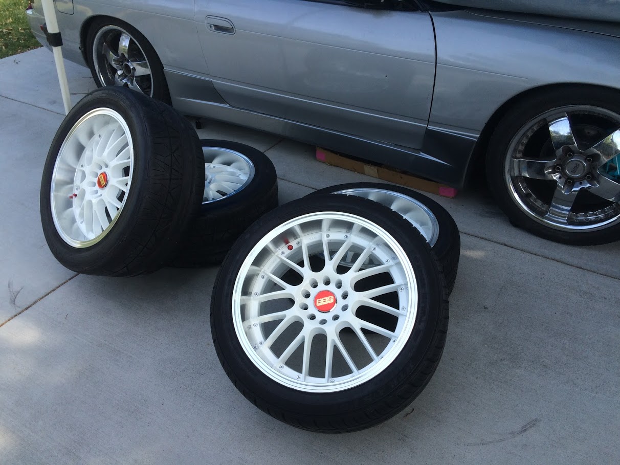

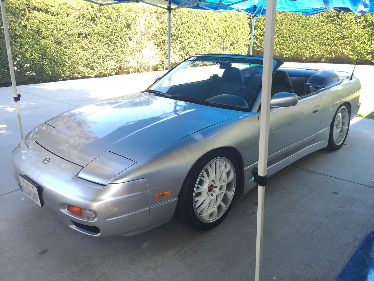

Found some good looking and really cheap wheels on Craigslist, will work for a start
checking fitment

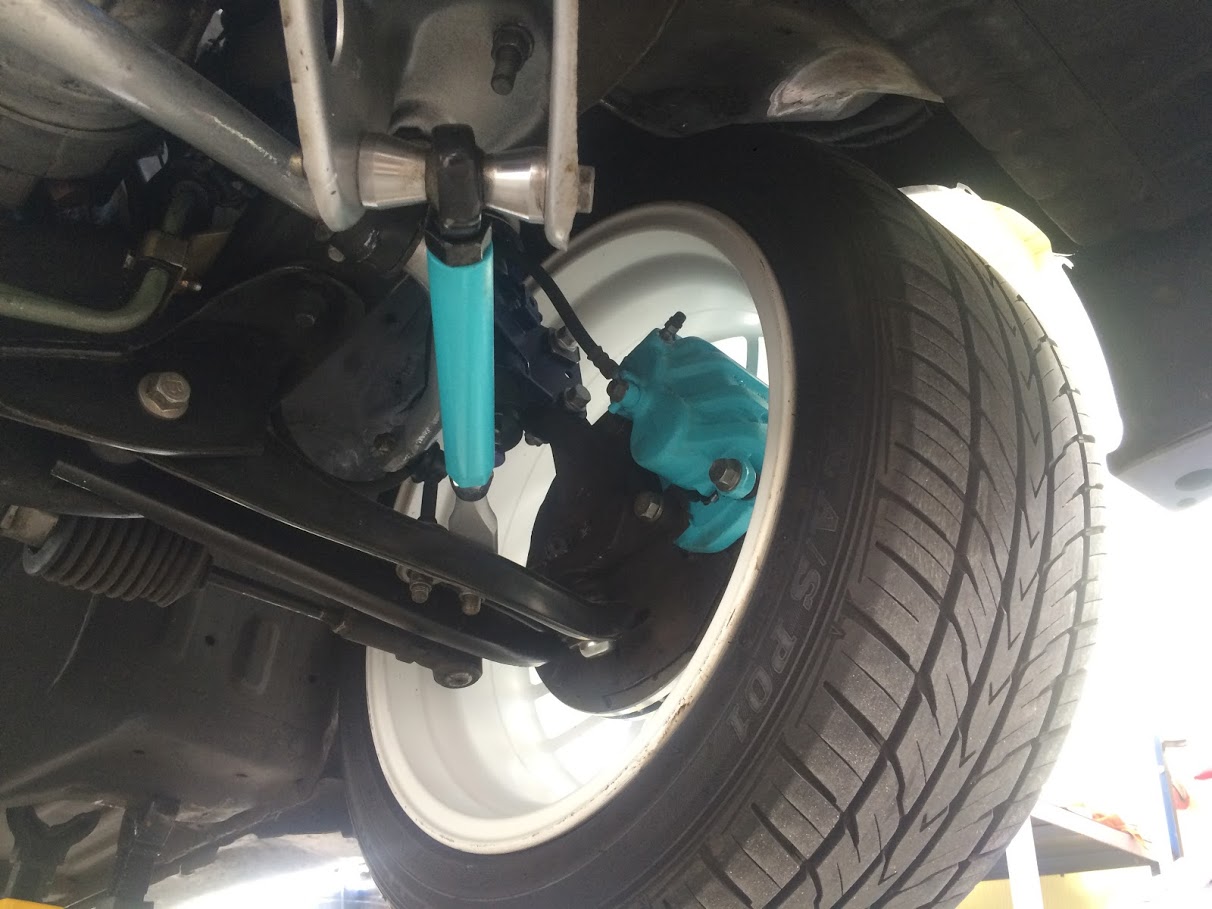

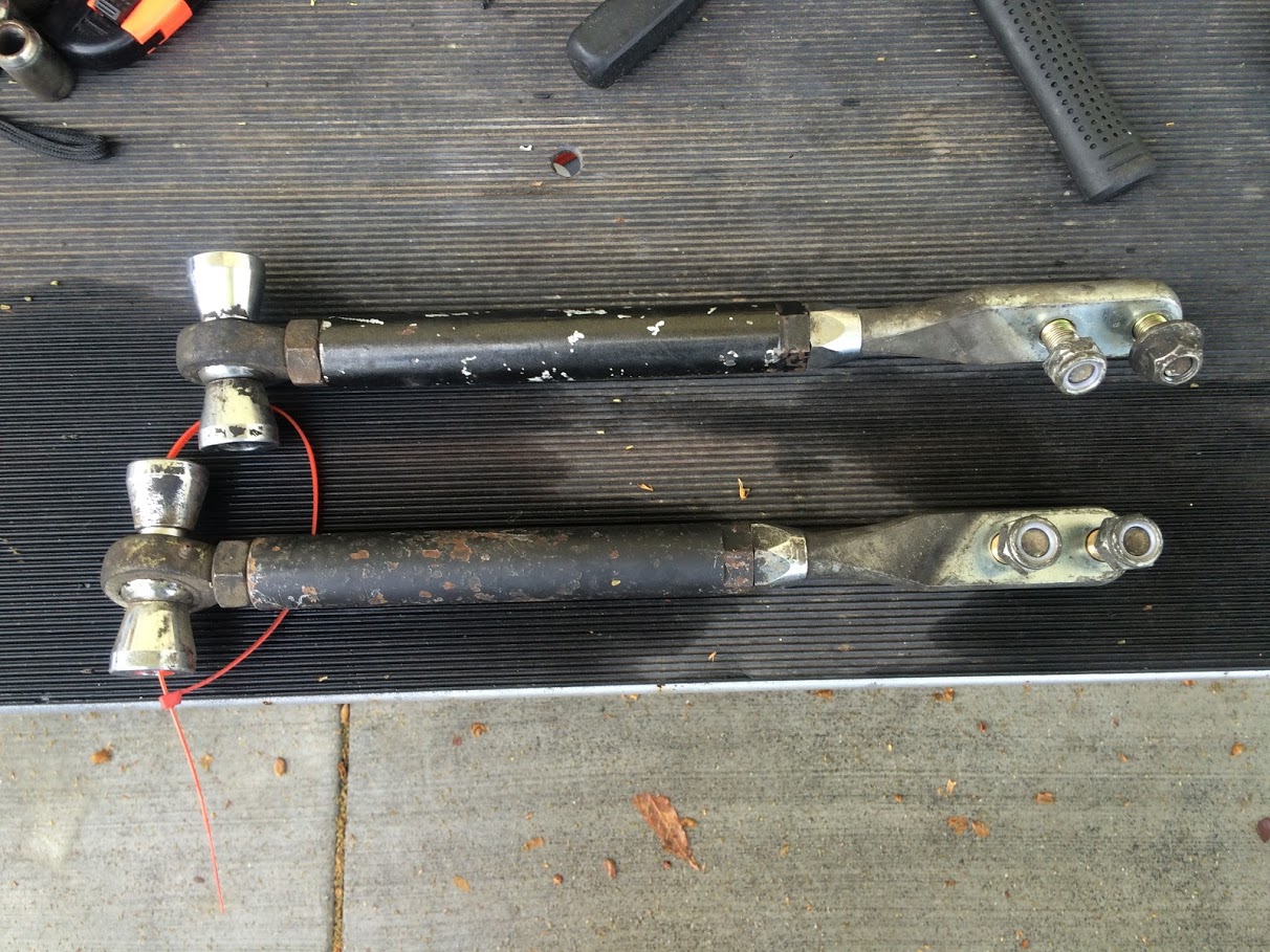

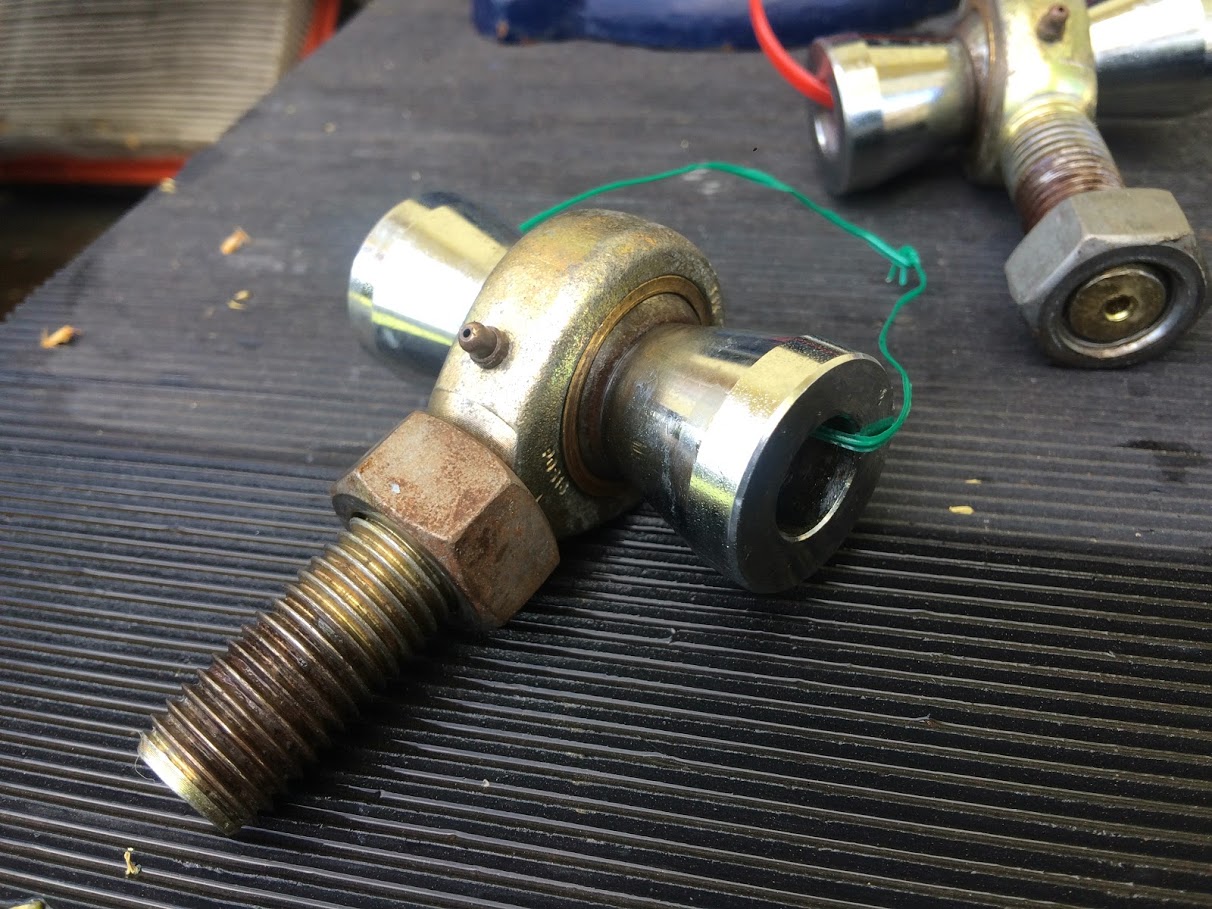

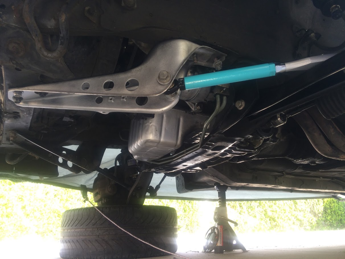

Engine mounts are dead

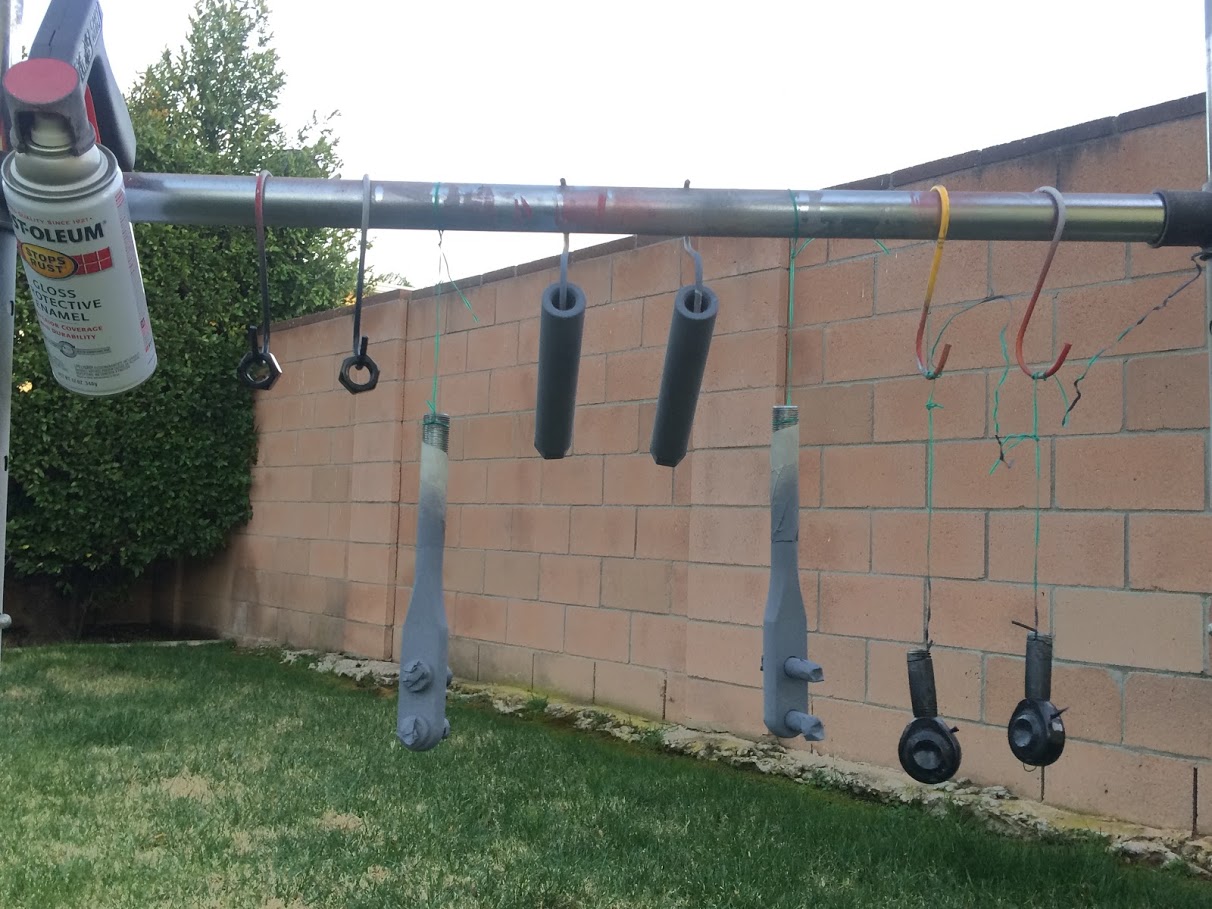

aswell the tension rods
Found a good pair of Tension rods on Craigslist for $10 ...but i need to restore them
Alright..lets see which color i will use on them..
Done

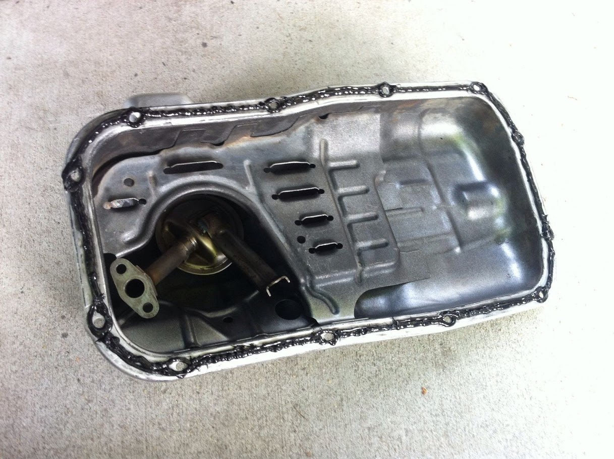

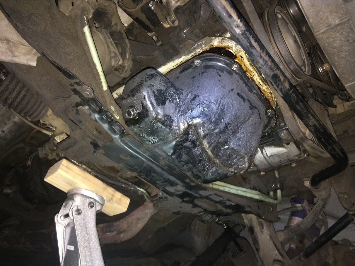

Oil pan was in really bad shape and leaking
Found one on Facebook for $20, just needed some TLC
All together looks like that now

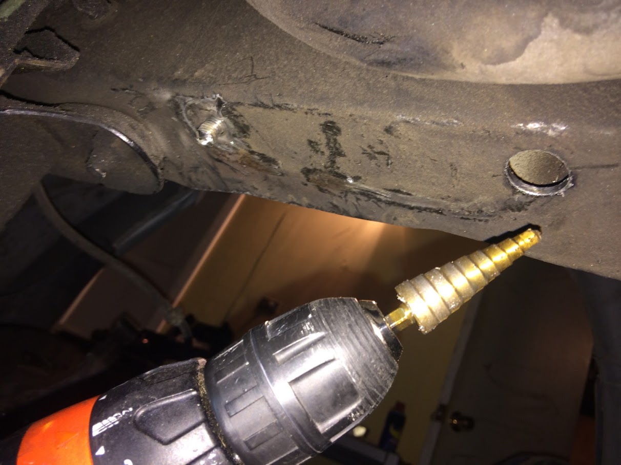

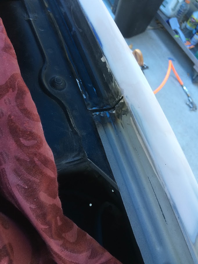

There was an unwelded bolt from Power Brace inside chassis arm, so i had to work to remove it and make it work again

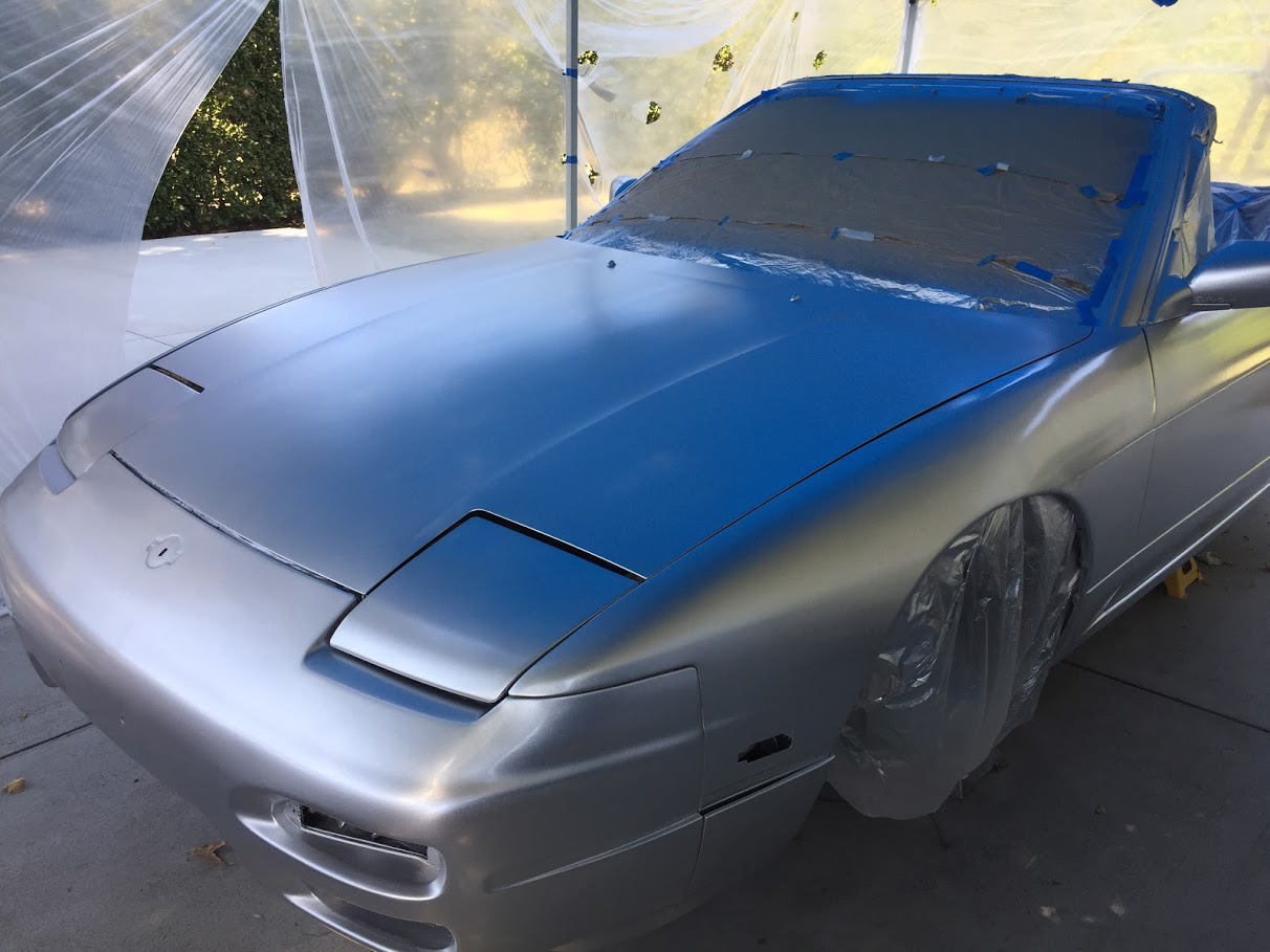

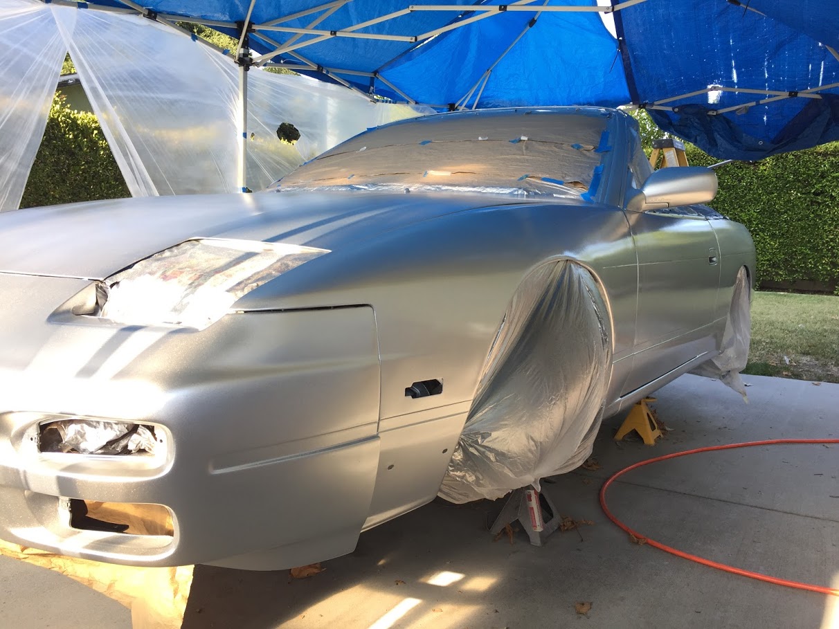

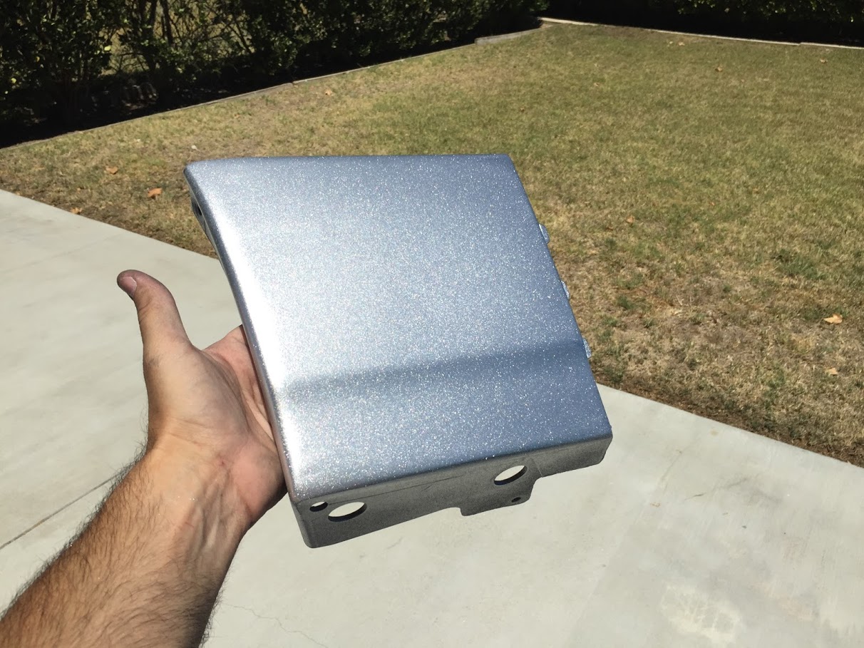

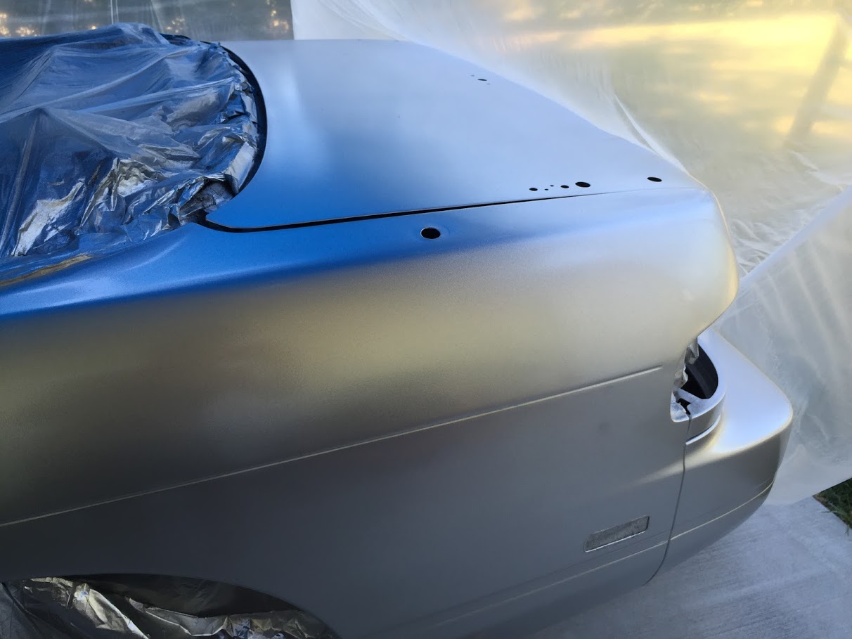

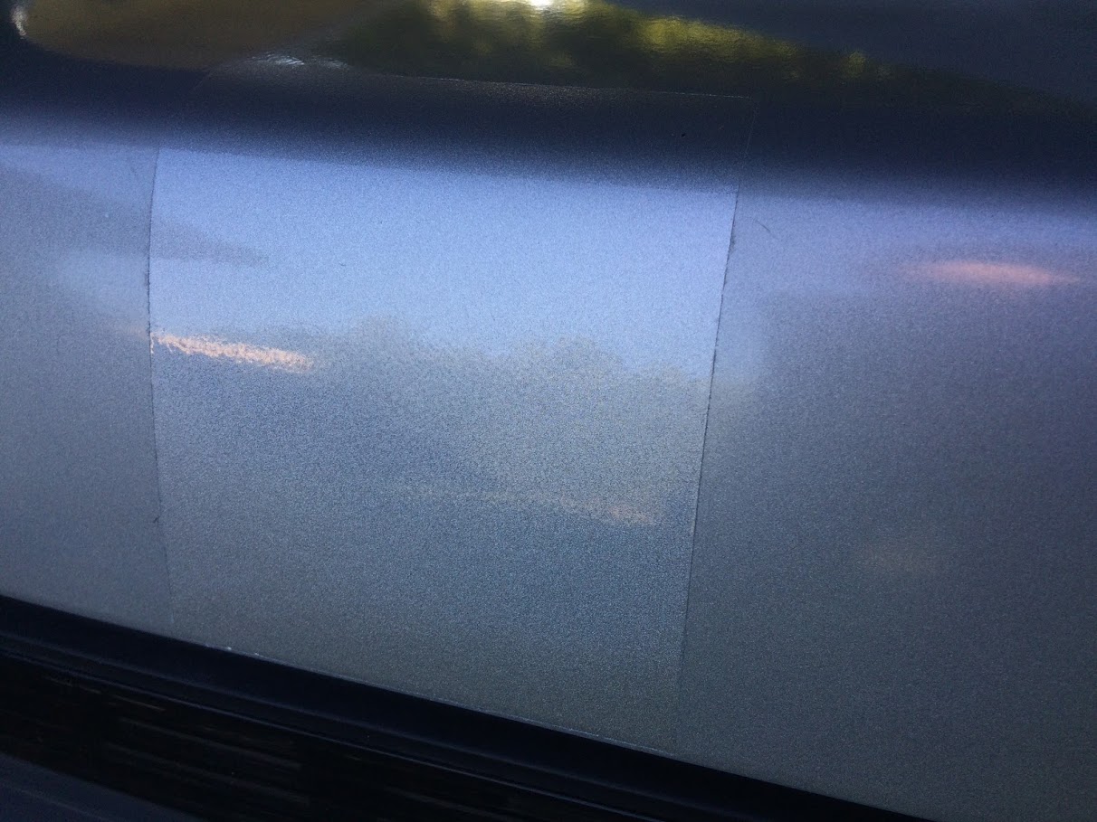

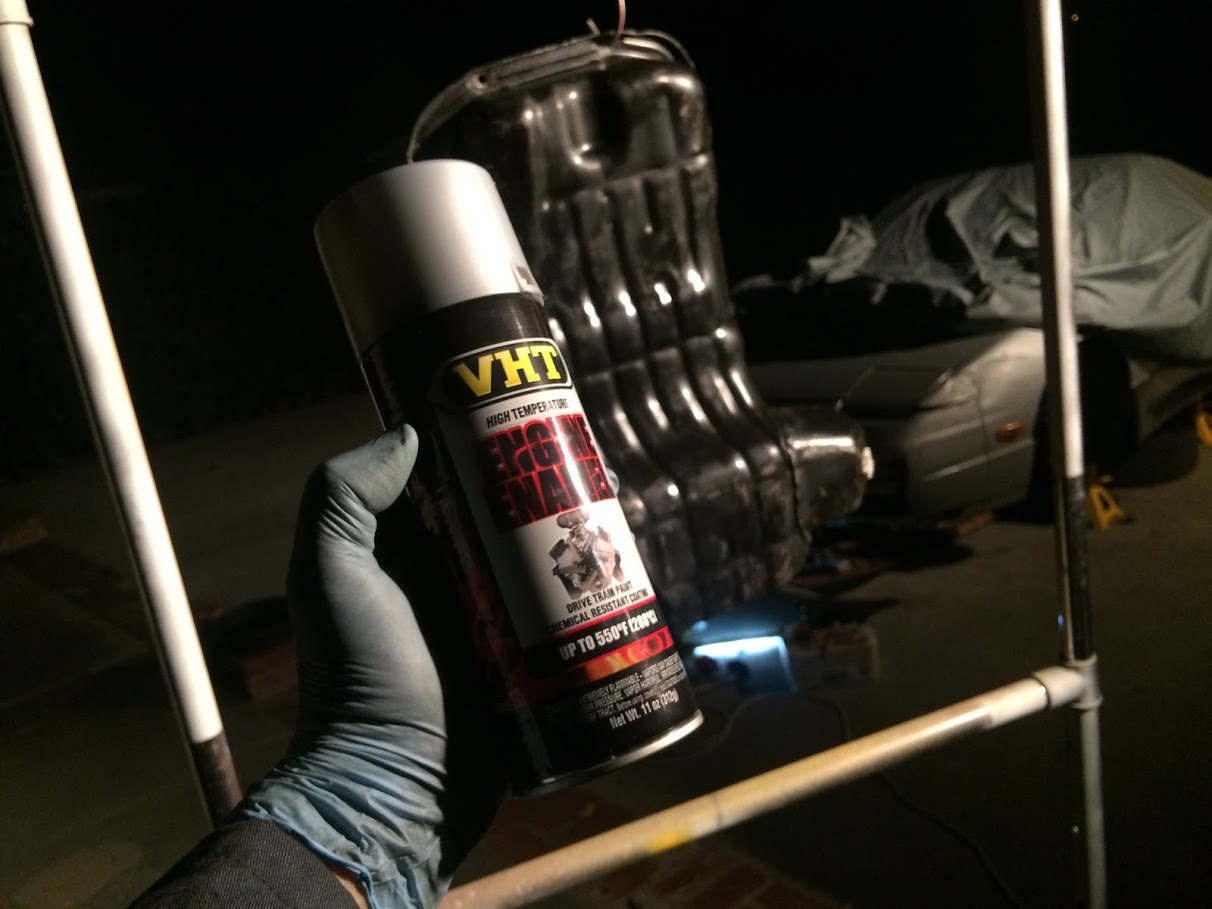

Ok, the idea was painting the car with Spray Can, i choose a Metallic paint because is better for those who doesnt know how to paint
metallic gives u a smother finish than flat colors
so i start Testing for Silver match color, but found i really like this VHT Cast Alum color

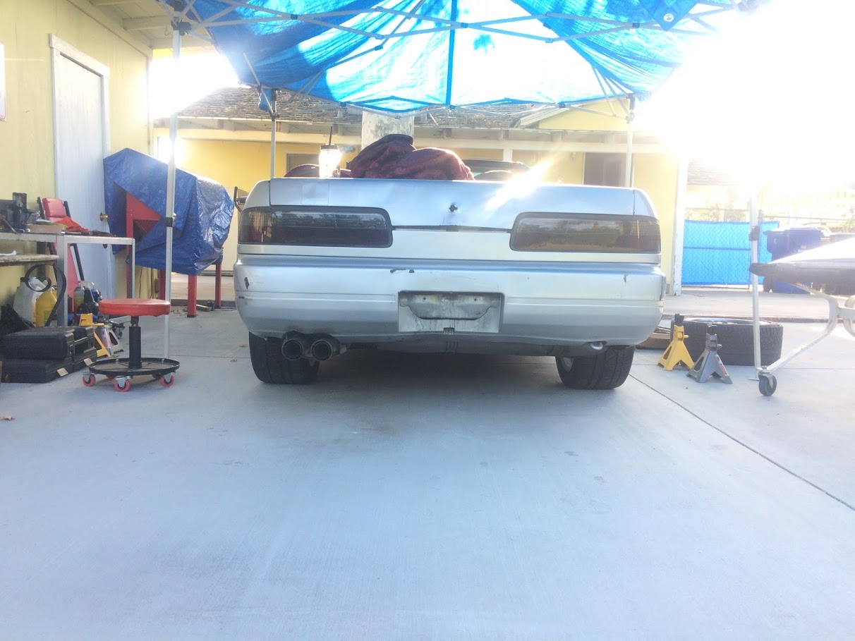

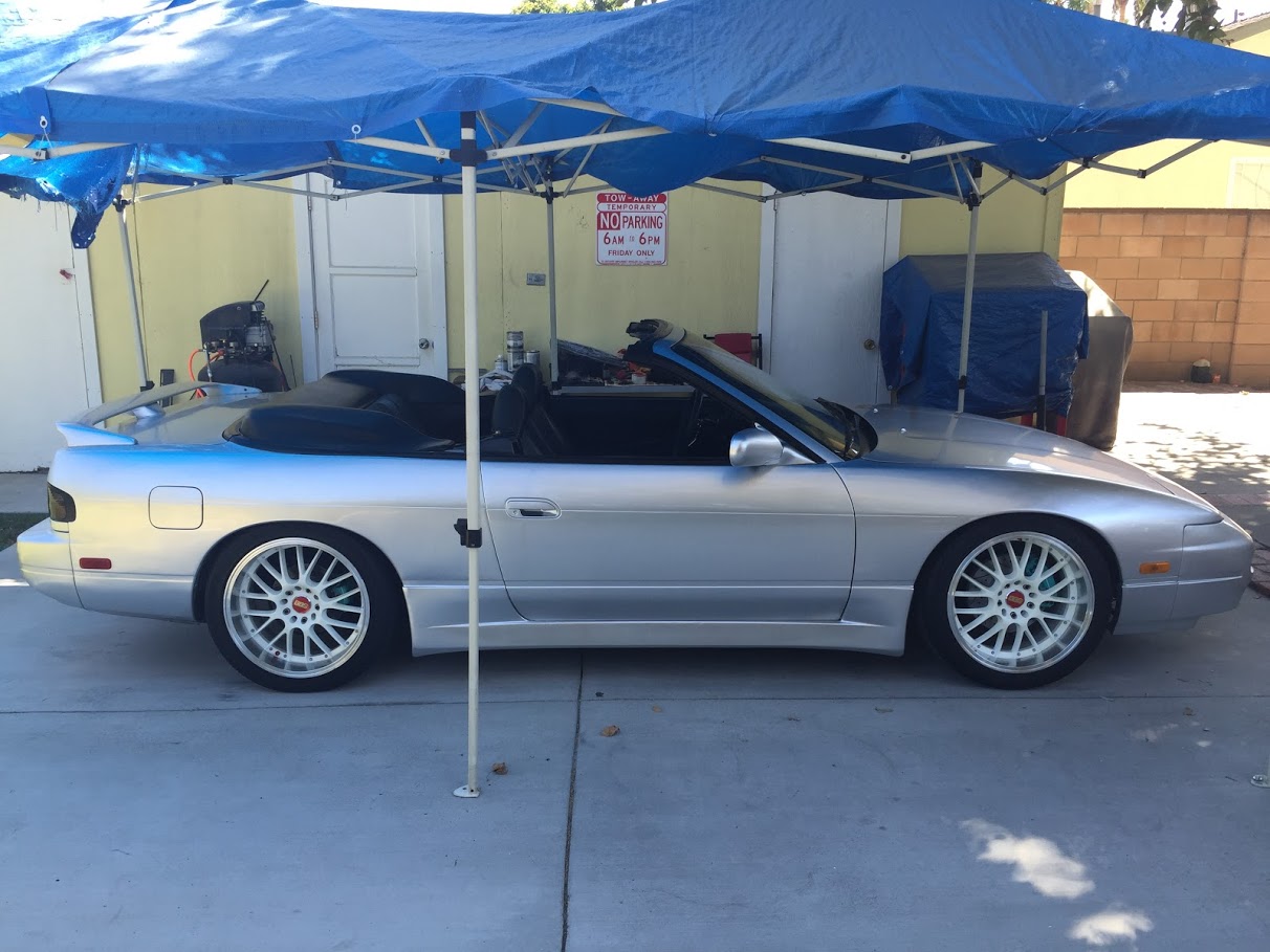

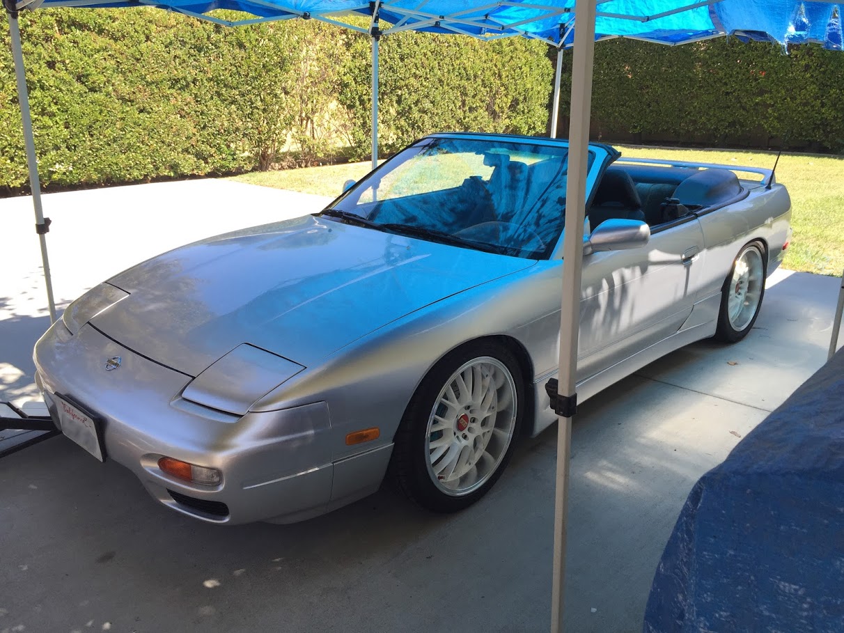

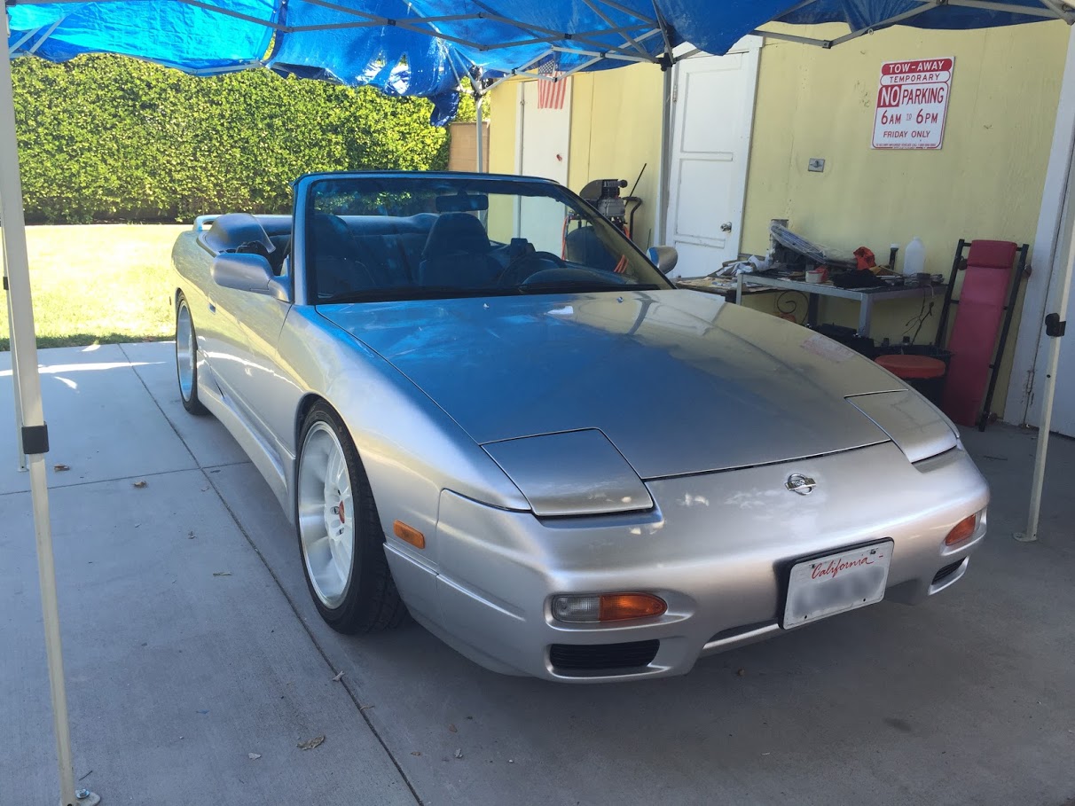

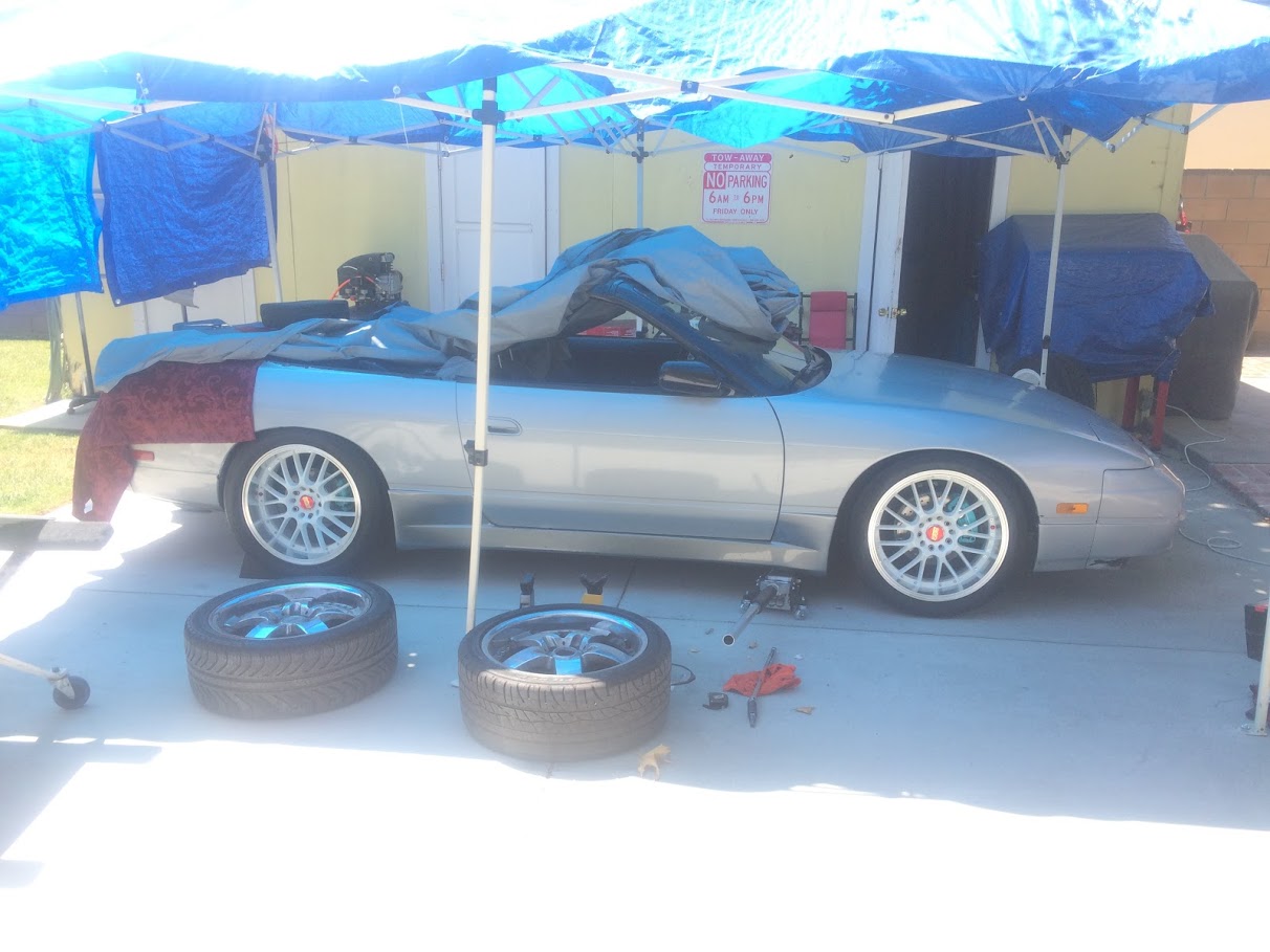

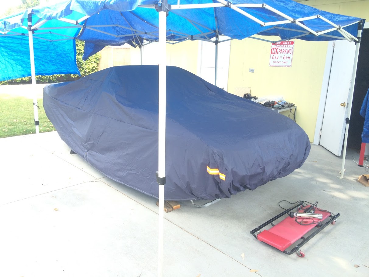

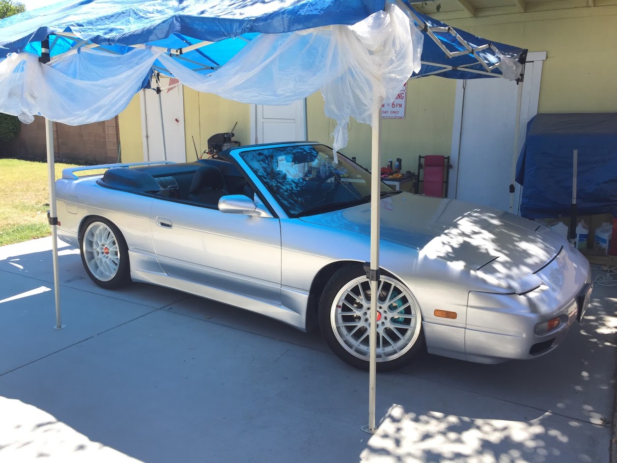

Things are getting pretty serious here so i better get a Canopy to work under
So..i found this Canopy FRAME on Craigslist for $30..i went for it
just need some Free Harbor Freight tarps to make a roof and voila!

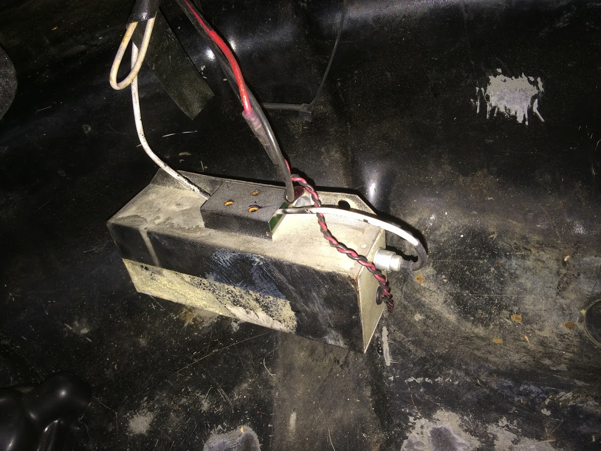

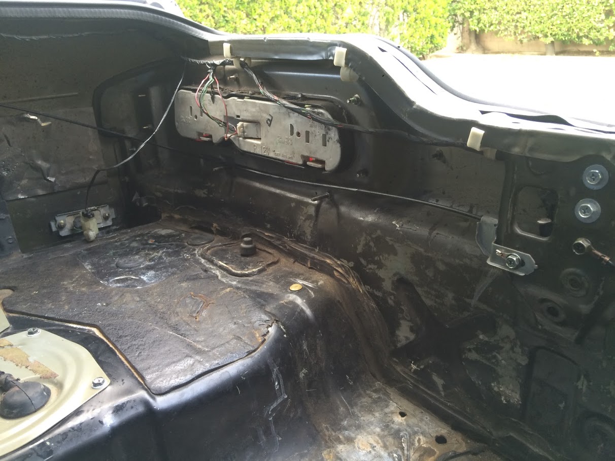

Trunk bay was pretty shitty
It was a Lo-Jack GPS receiver hidden at the Trunk

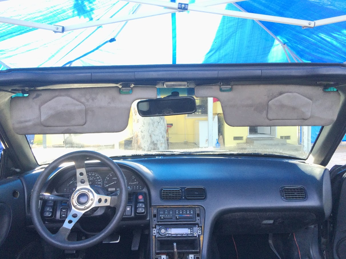

Visors had some dirt

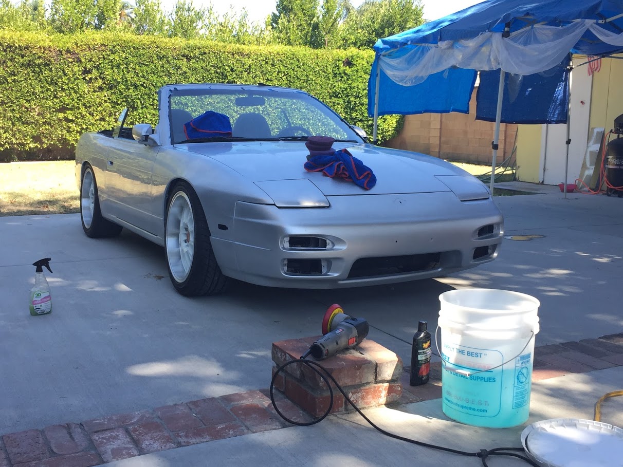

This was the best cleaner i ever used, i use it for everything, even cleaning engine grease
u can find at 99cents store
It worked, but it had sun marks

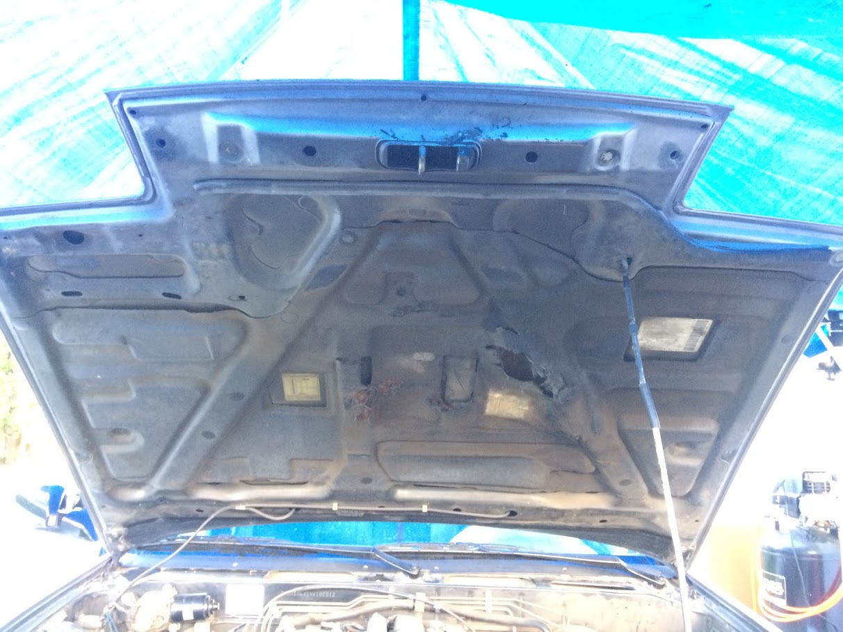

Inside engine bay is all about Dirt
i found a hood insulation cover in better condition at the junkyard.. so i grab it

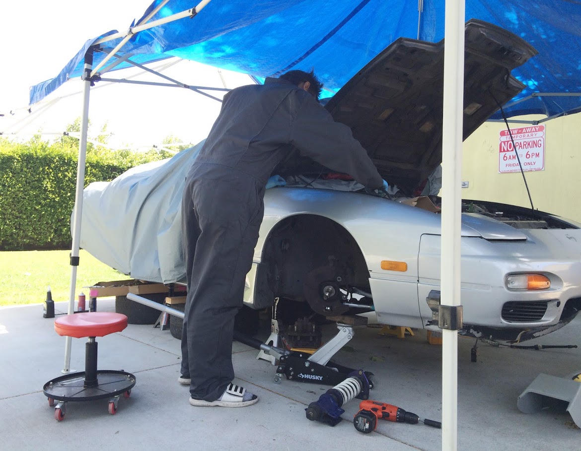

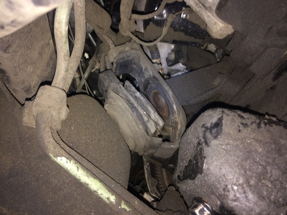

Right side wheel had a blown bearing, it feels like lose
so start to taking all apart
Because real mechanics wear Chanclas (?)
got an Impact gun from Craigslist for $15 (with 19/21/24/26/27/31 sockets)
Ordered from RockAuto a new TIMKEN bearing #510031 (inside came an NSK Japan bearing)

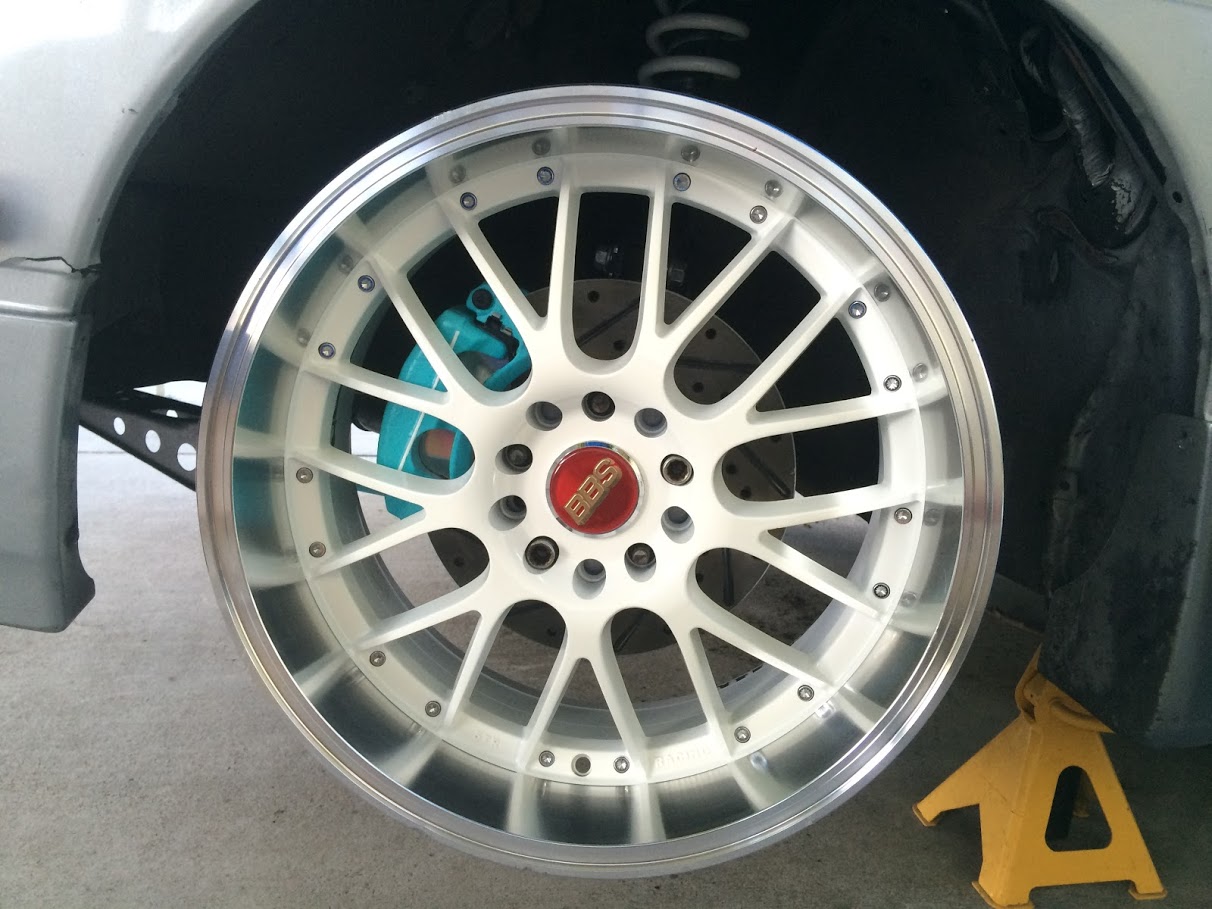

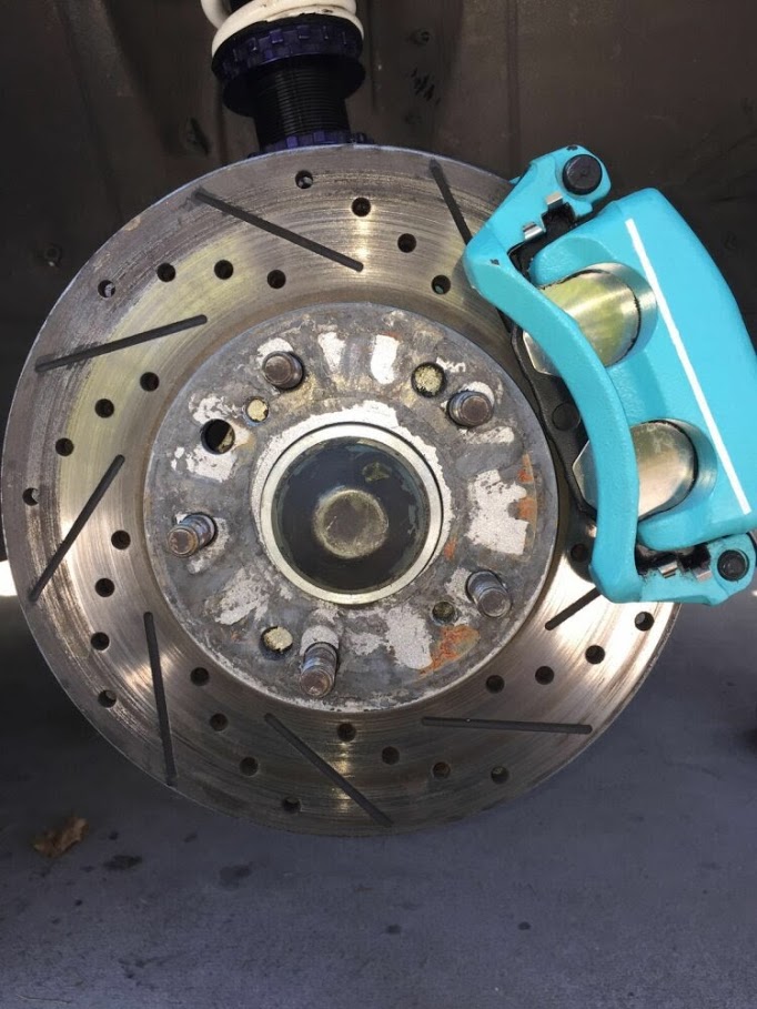

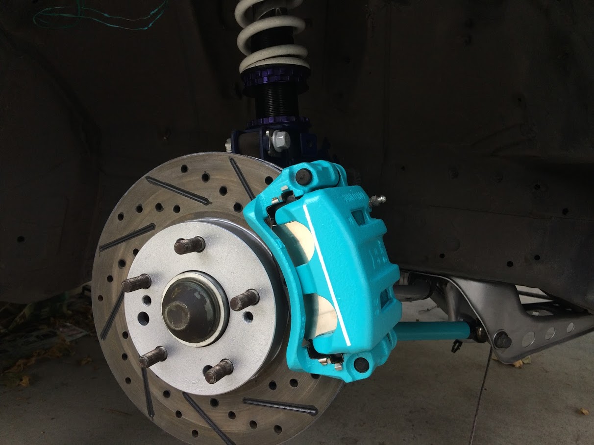

Wheel Fix continued.. (Q45 Calipers)

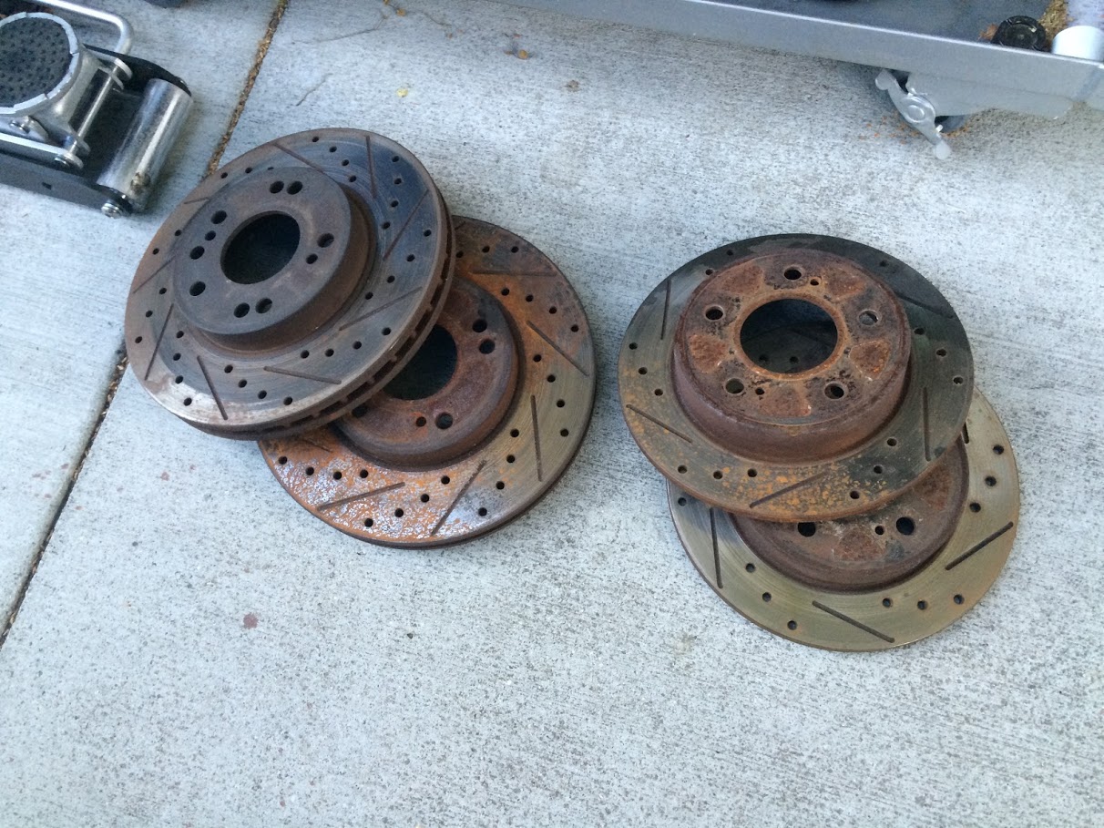

Ok, RUST and Metal are not best friends, so if you want to know how to remove rust FOR CHEAP
Watch my How-To video
http://www.youtube.com/watch?v=aa3MCmuff5g

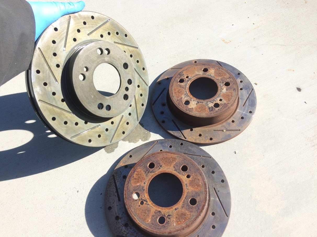

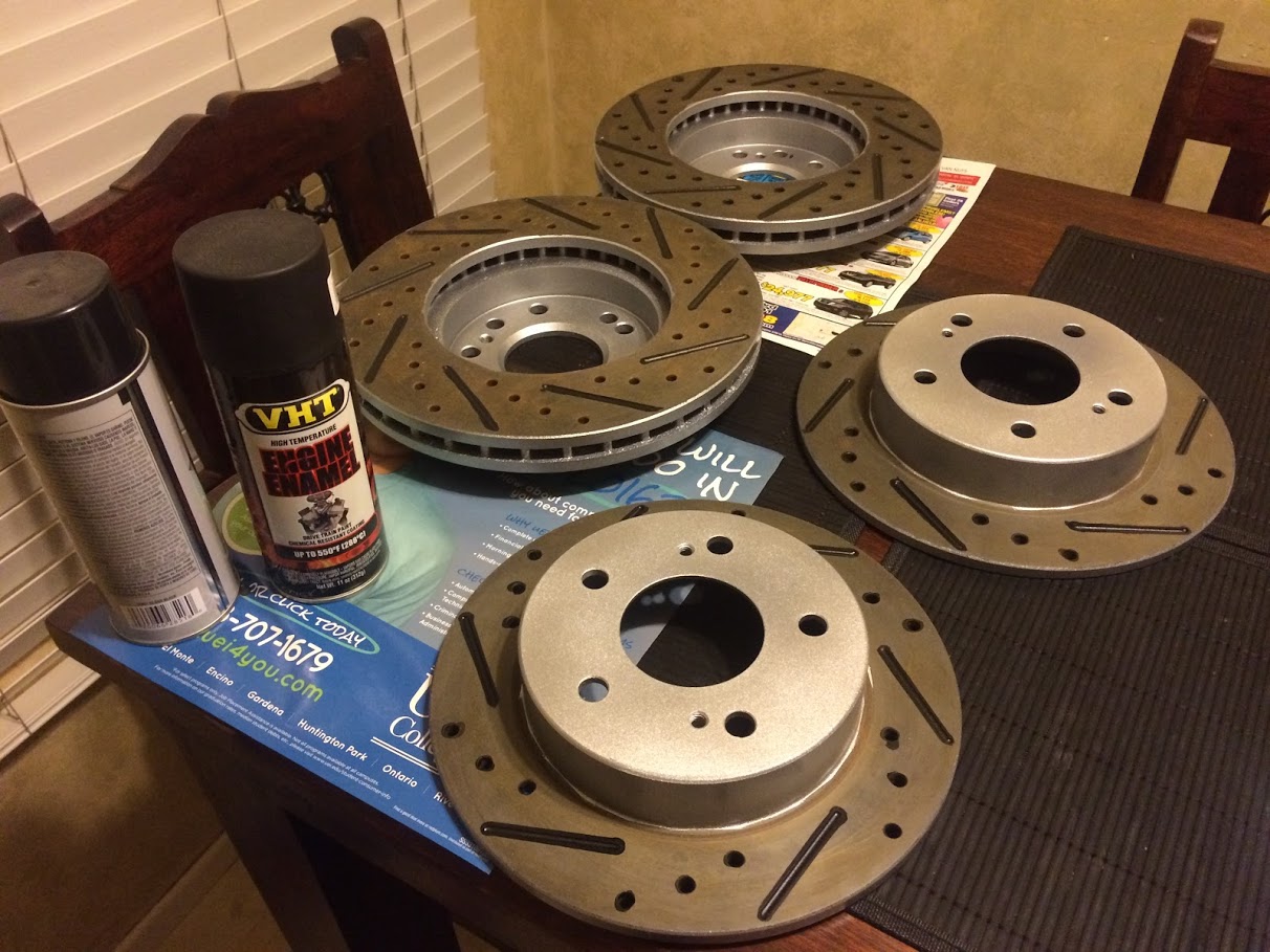

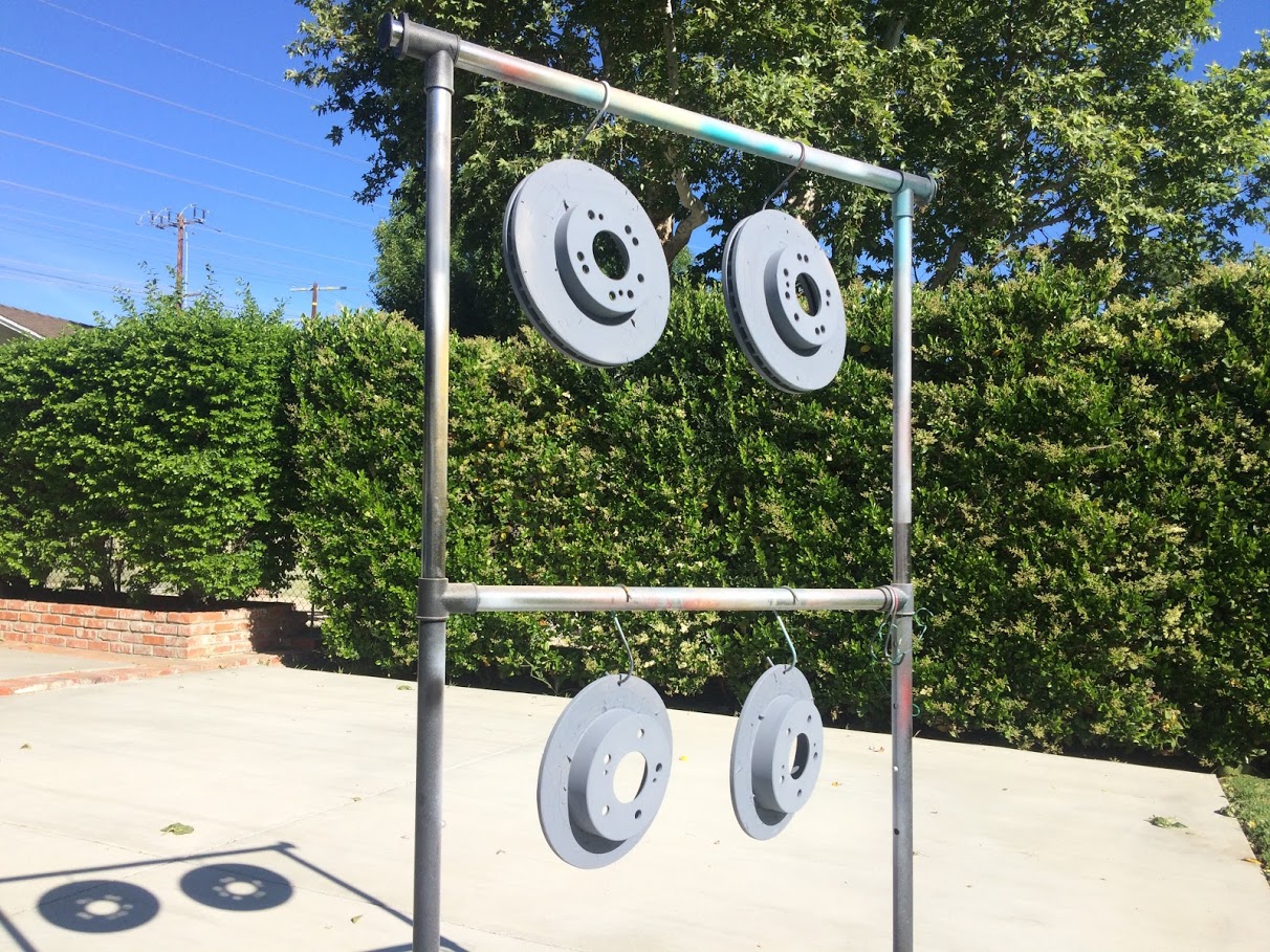

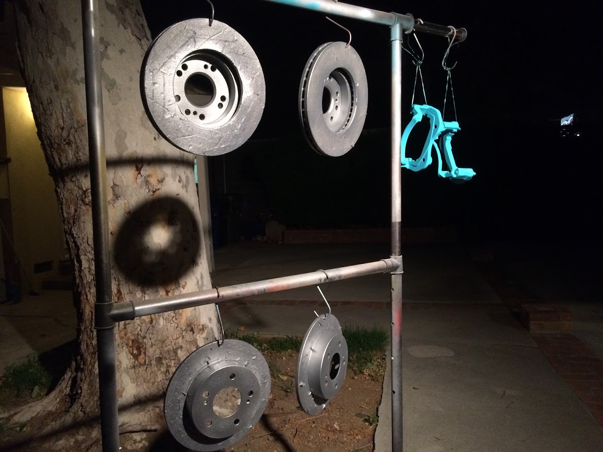

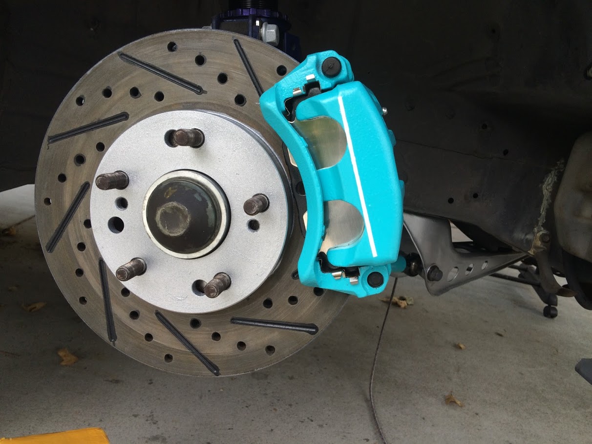

Rotors had too much rust and i wanted to get all parts a Refresh start
so i remove all rust from them
Then some Primer and Paint

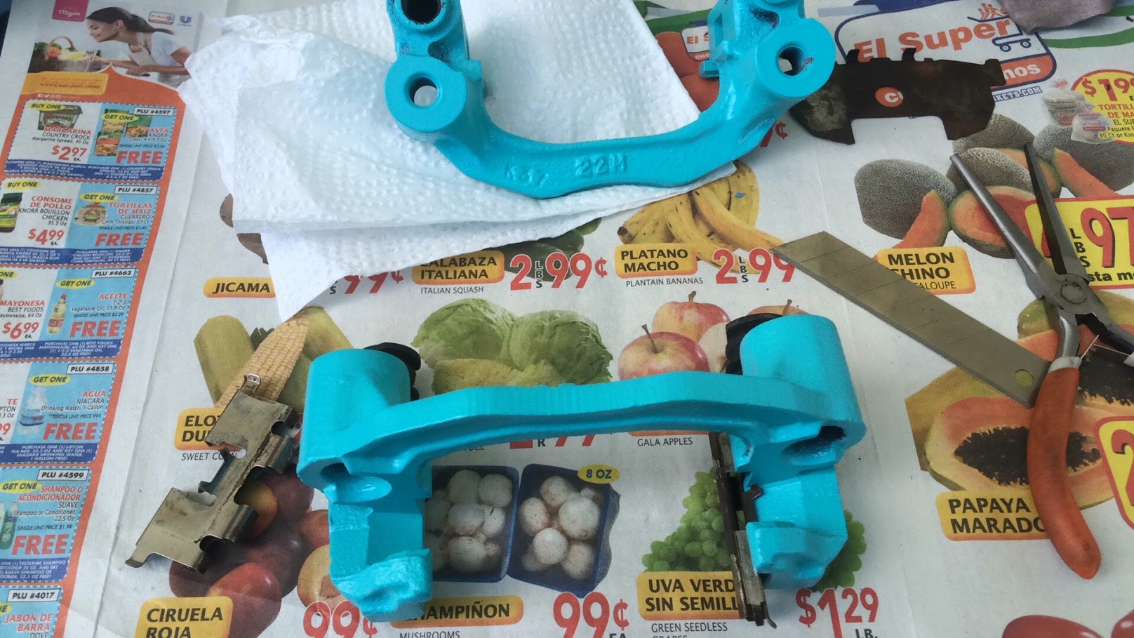

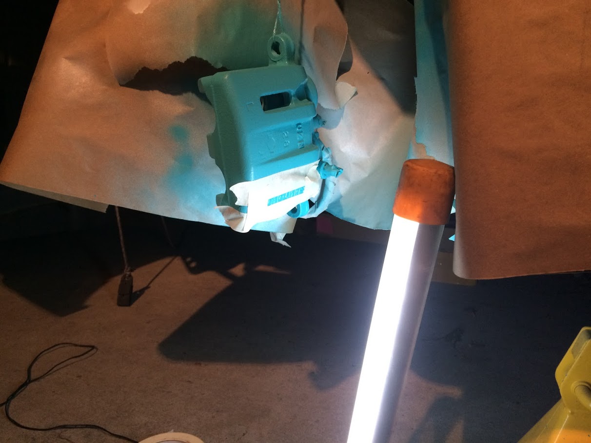

And started to clean and paint calipers
MEFISTO is offline   Reply With Quote
Old 01-02-2017, 04:22 PM   #4
MEFISTO
MEFISTO's Avatar
Join Date: Mar 2014
Location: Los Angeles
Posts: 49
MEFISTO is a glorious beacon of lightMEFISTO is a glorious beacon of lightMEFISTO is a glorious beacon of lightMEFISTO is a glorious beacon of lightMEFISTO is a glorious beacon of lightMEFISTO is a glorious beacon of lightMEFISTO is a glorious beacon of lightMEFISTO is a glorious beacon of lightMEFISTO is a glorious beacon of lightMEFISTO is a glorious beacon of lightMEFISTO is a glorious beacon of light
Ordered some ceramic Q45 pads (low dust because white wheels)
Assembly
Looking gooood to me
After i changed bearing and put all together feel some PULSE when braking
saw rotor disk had uneven marks when braking so i did a rotor resurfacing (shop did)

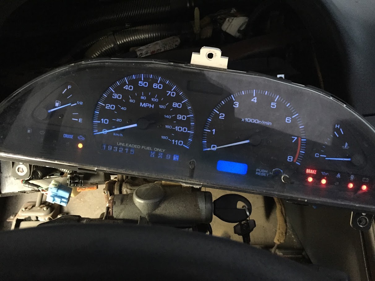

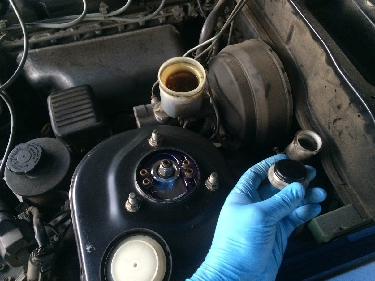

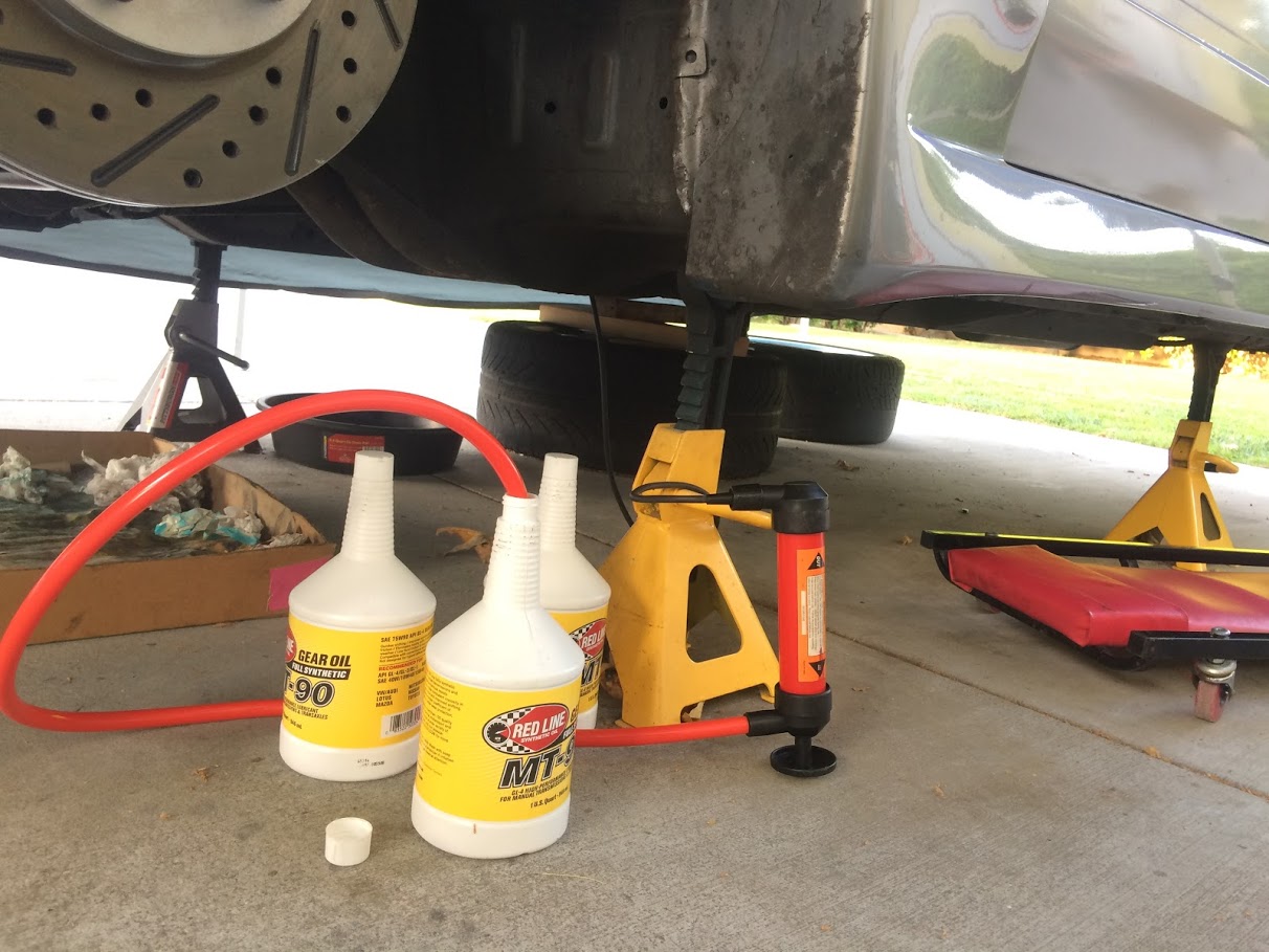

when i got the car was misfiring, idle was bad and had no water, oil or any other fluid into it
i add some but it was so dirty that i had to flush everything from engine
This is how FUEL looks into my fuel lines

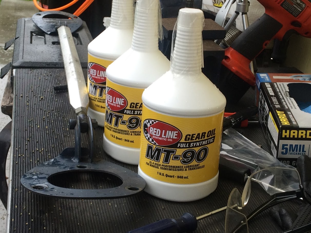

Gear Oil
Got this pump from harbor freight ($6) and use it to remove any fluids from car
Pumping oil back to Transmission (easier than removing shifter)

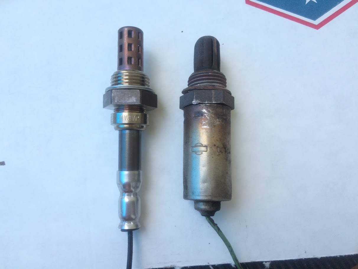

Ordered a new oxygen sensor from ebay $12 (Denso Japan)
for that price i prefer to get a new one instead cleaning old one
And new NGK BKR5EGP spark plugs (ebay $11)
Car starts and runs GREAT after all those things

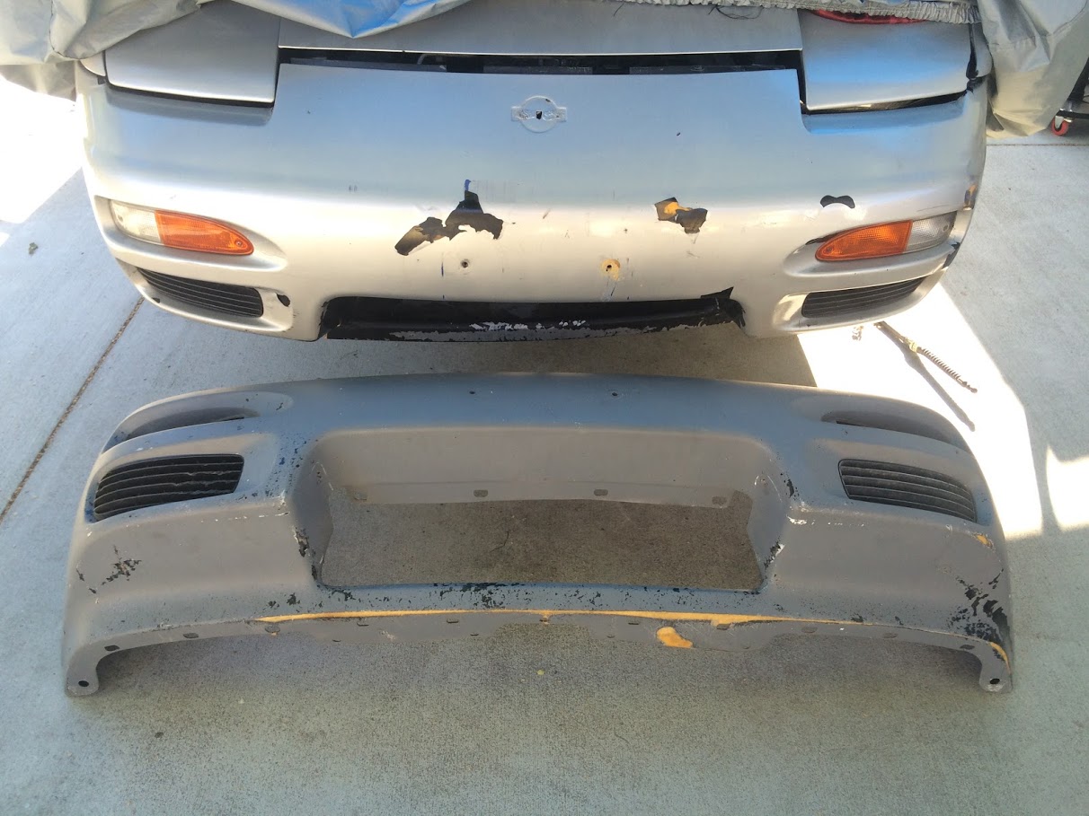

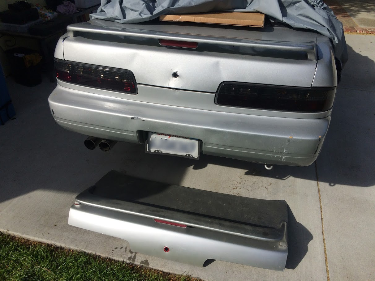

The car was stolen from prev owner and they bent the trunk/garnish to open it
i got a trunk and wing for $20 from Facebook
Also from FB rear garnish and front bumper
Mine was cracked and the one i got it was worst actually, prev owner did holes all over that i had to cover somehow

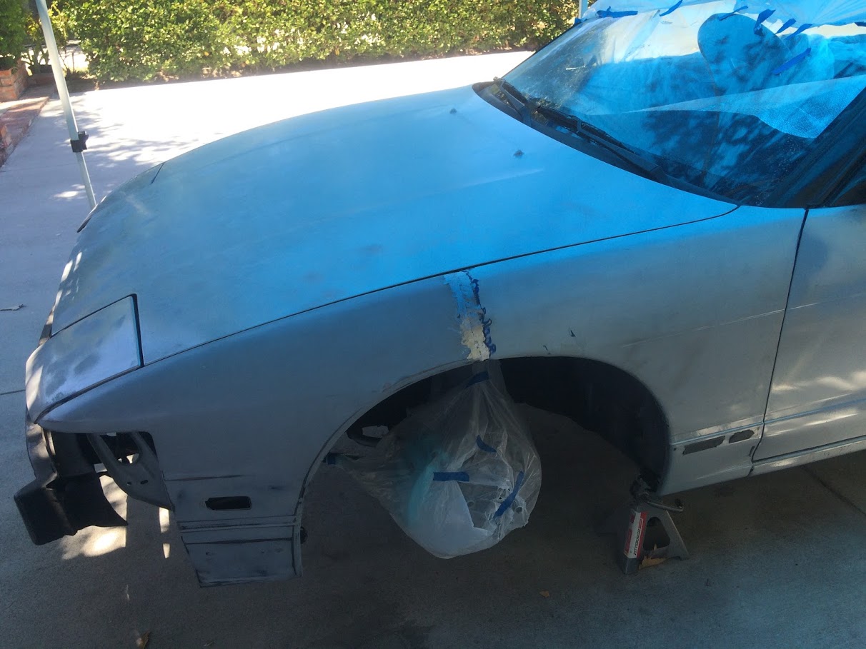

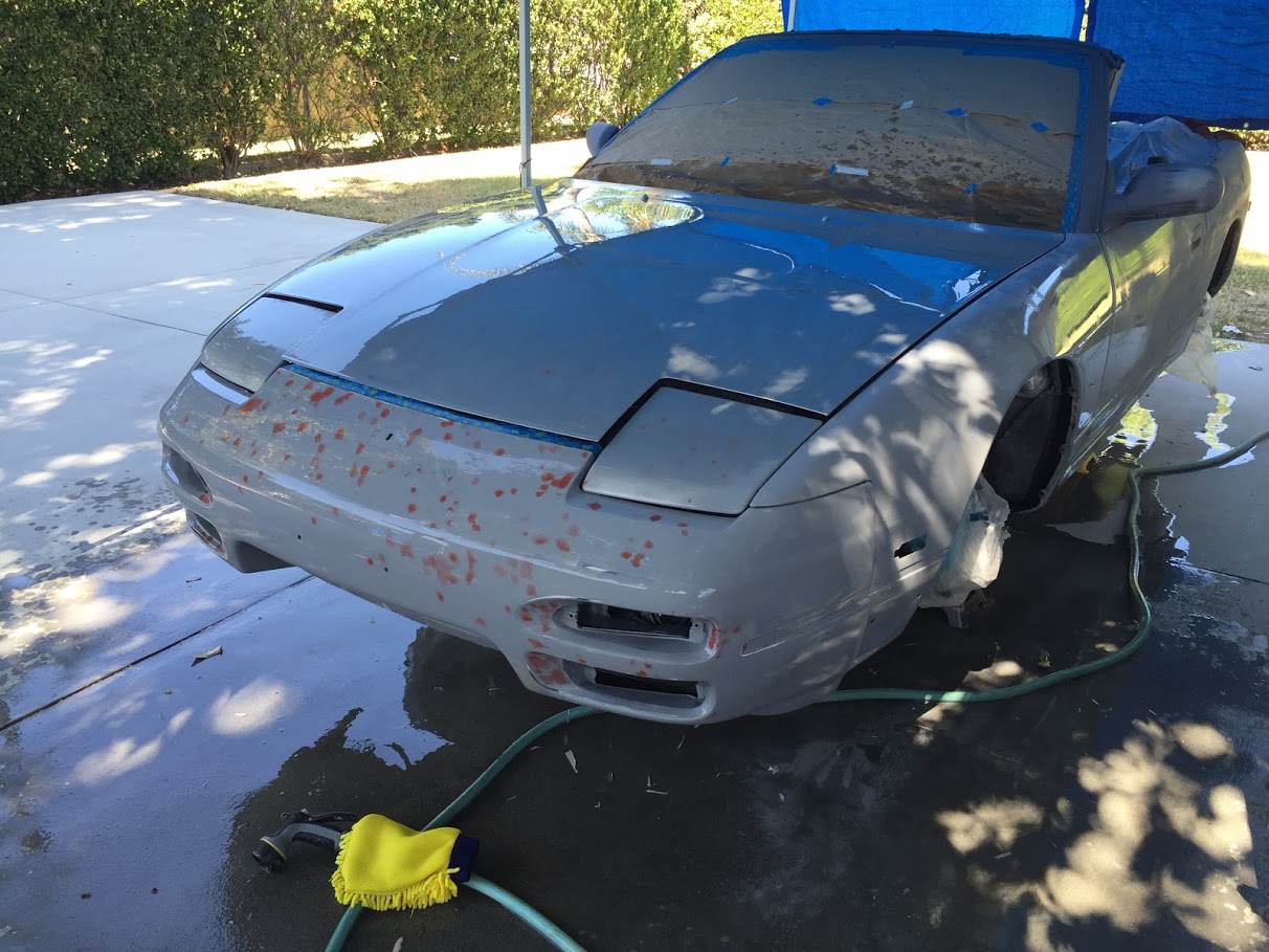

After peeling the paint i saw it had some dents on it..
So i decided go ahead and try to do some BODY work

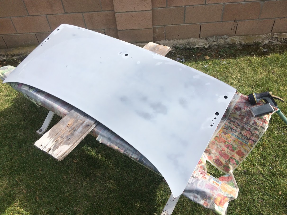

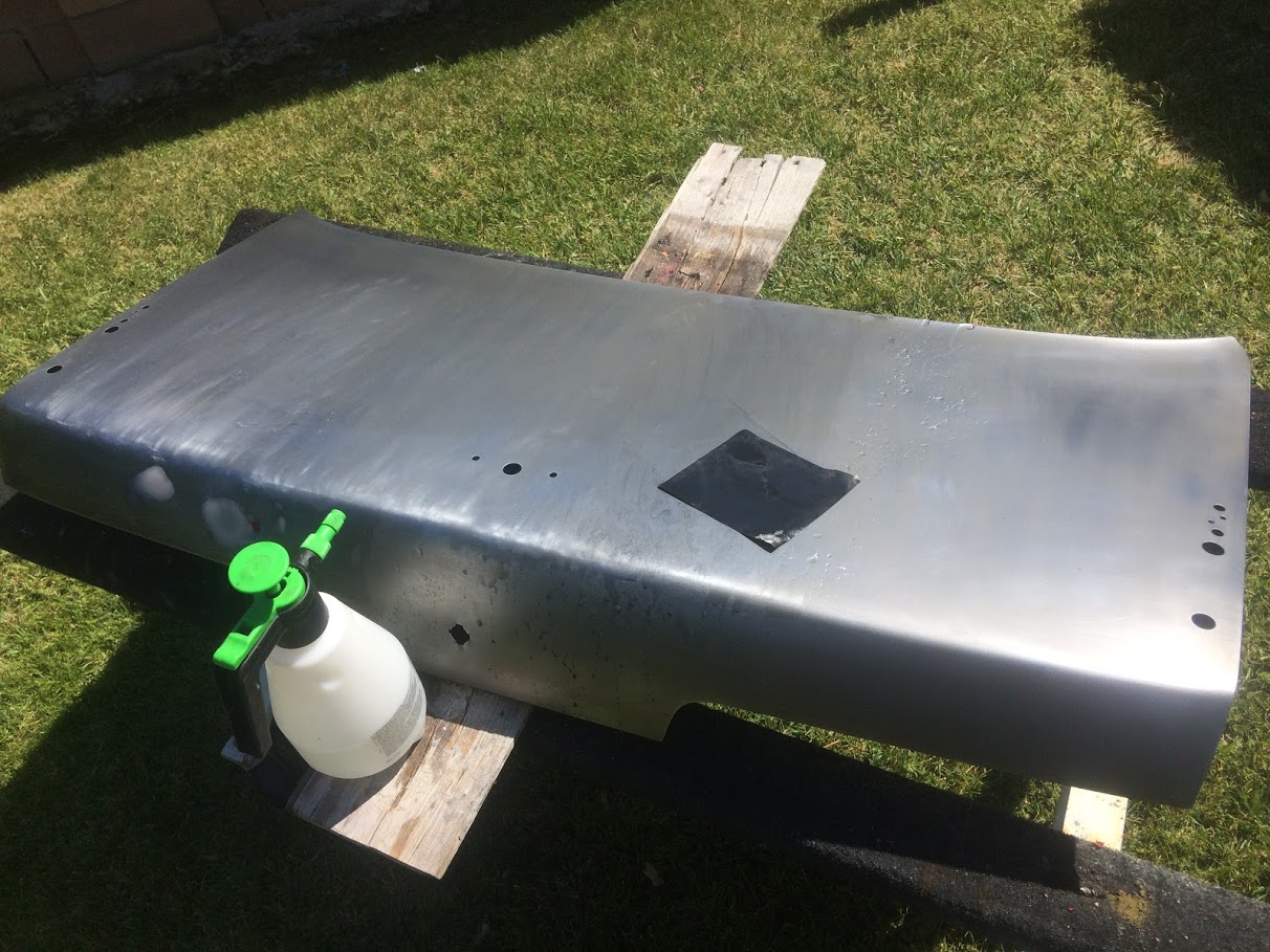

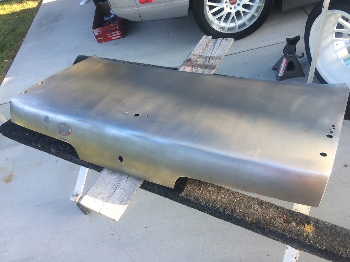

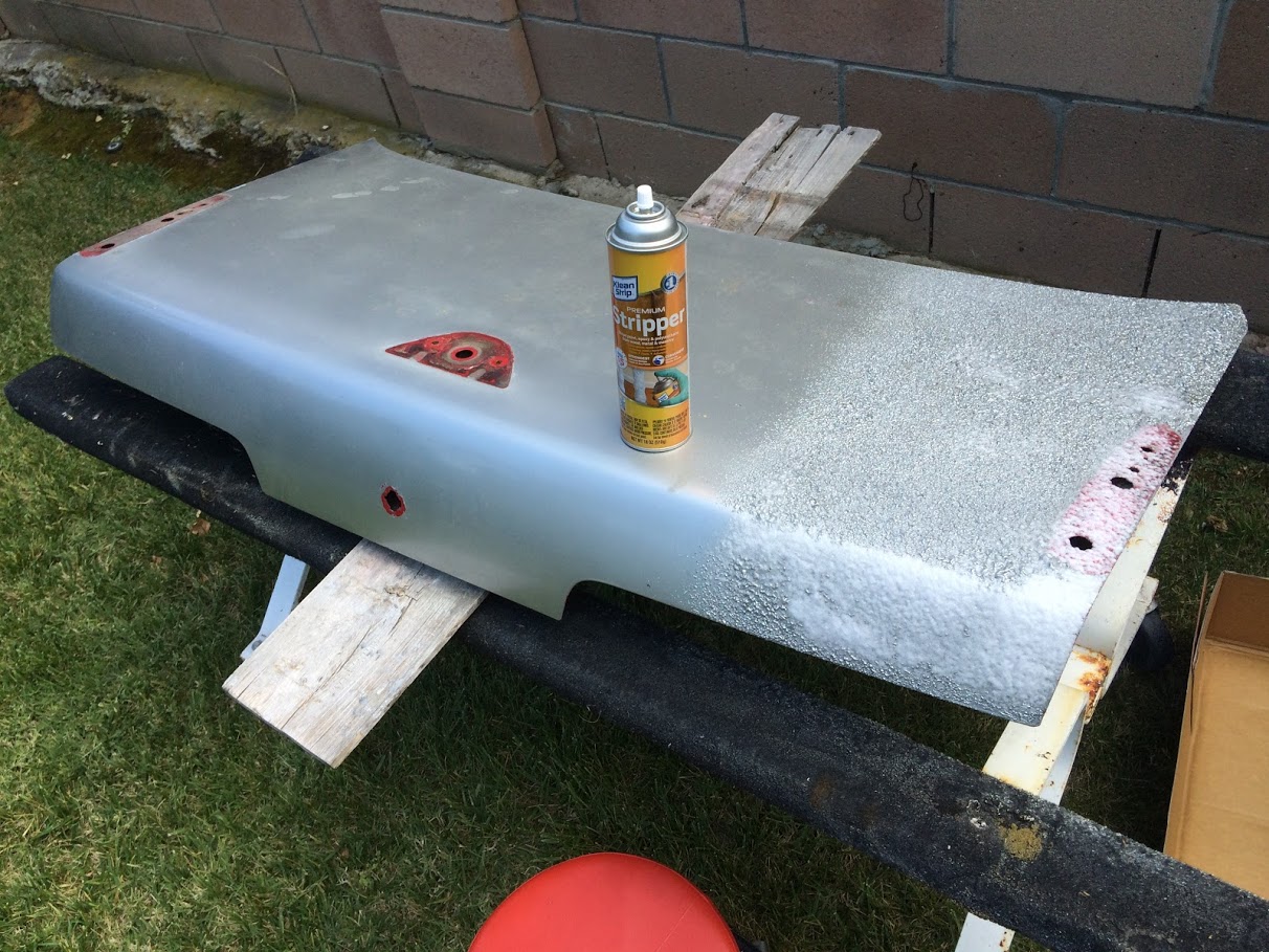

Removing Paint from Trunk
that is the best paint stripper i ever used, it goes all thru core surface, trunk had 3 layers)
Klean Strip Premium Stripper (Strongest)
get the one NON-Sprayable, spray lost presion after a few wheeks

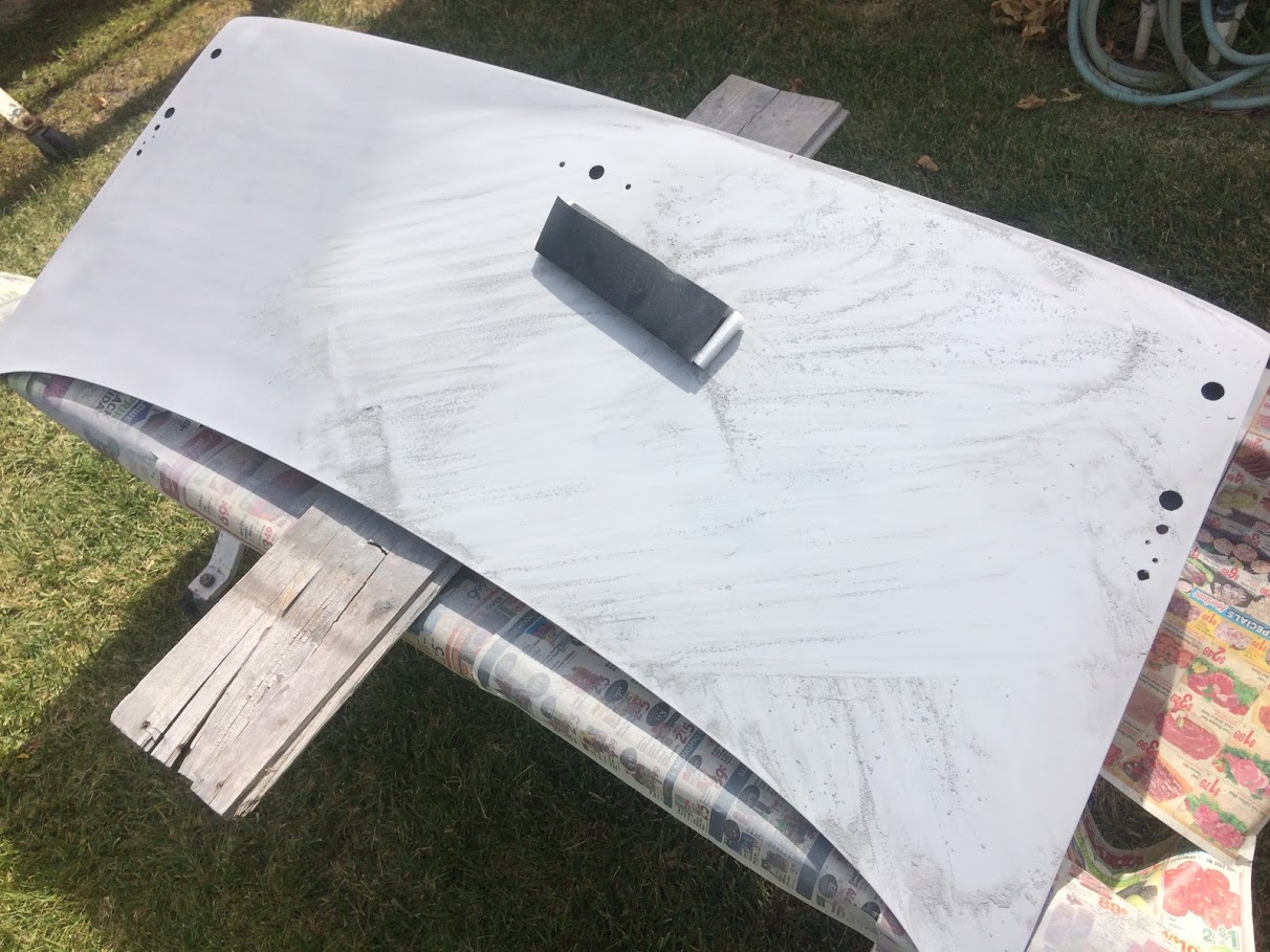

Primered
Sanding

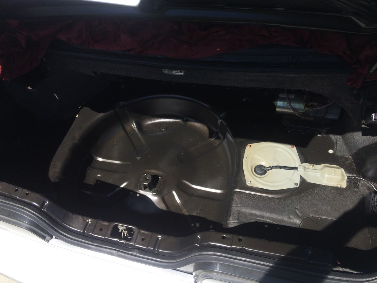

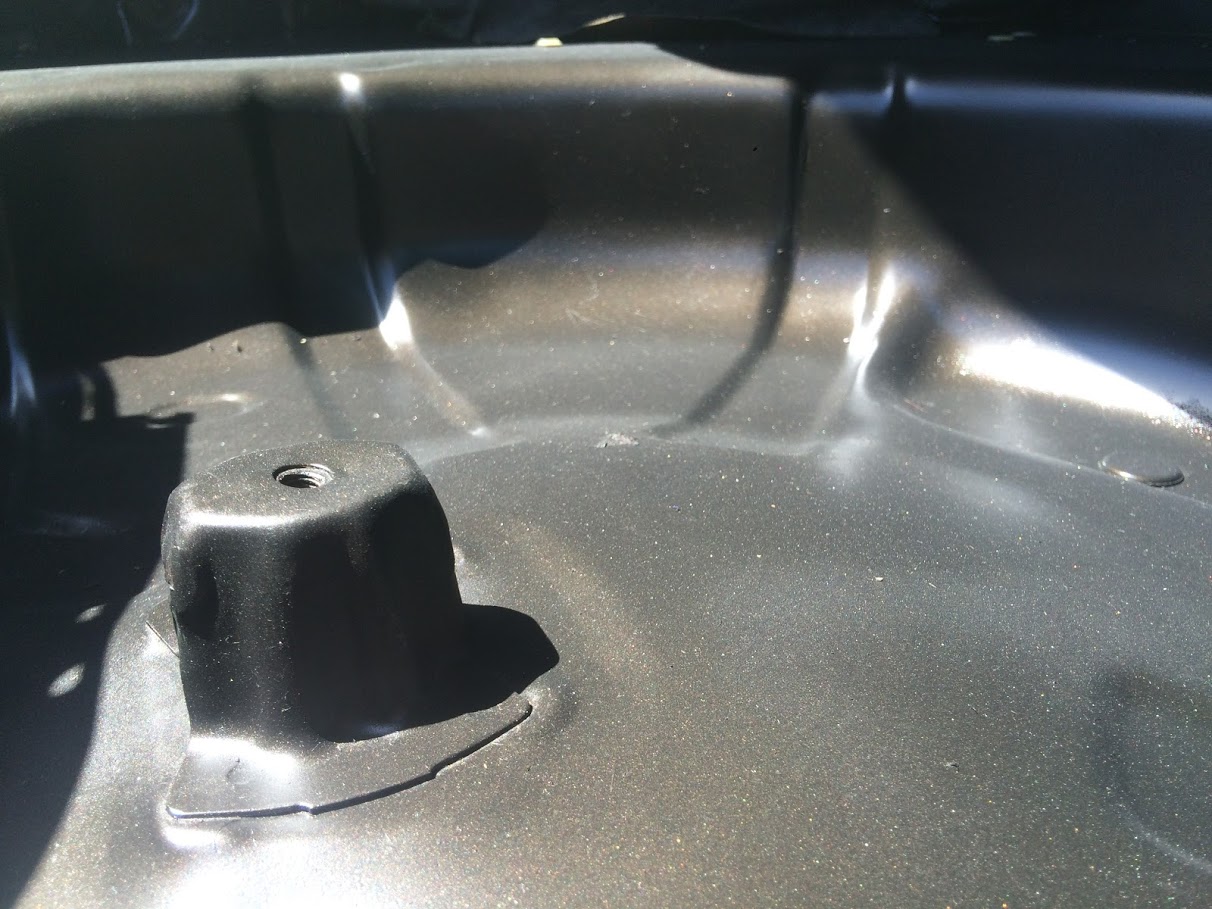

Refinishing the Trunk interior
New key lock i bought online

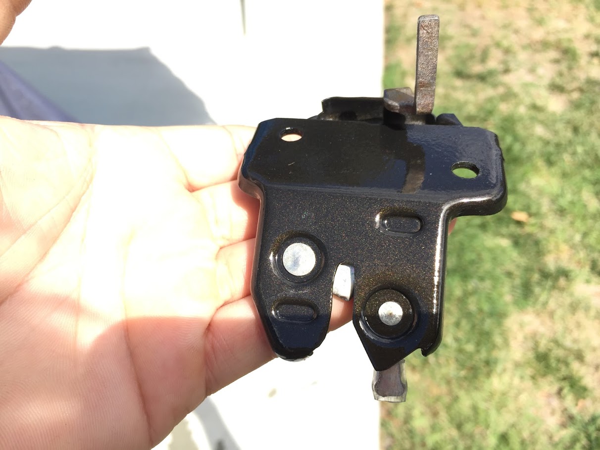

Painting old trunk lock

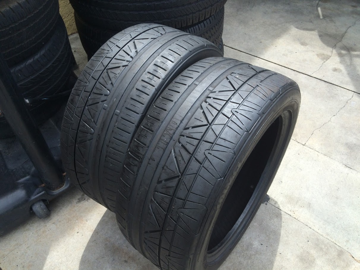

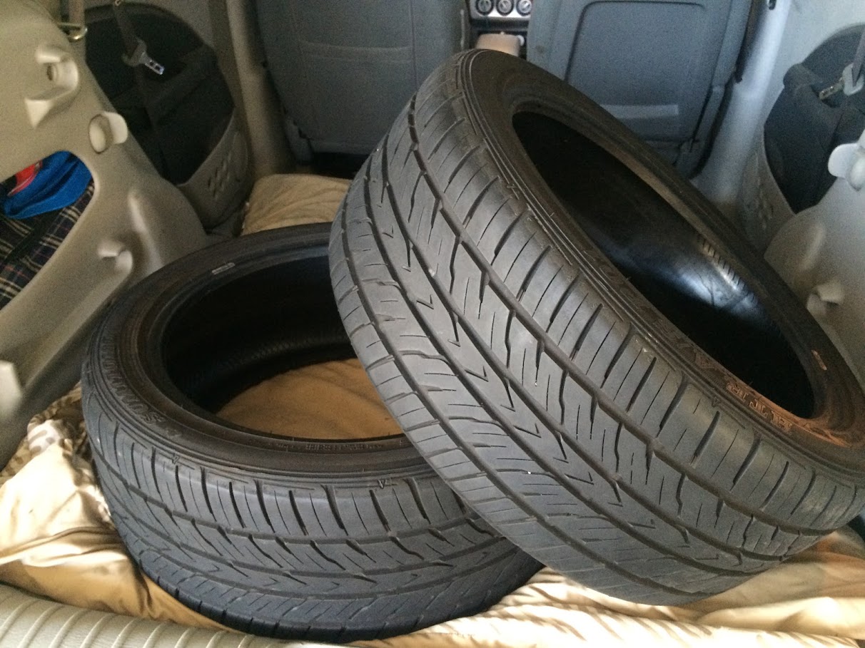

i found some rear tires, NITO INVO 255/45/18
that i later changed for some lower profile 40
Testing fitment.. all OK
later i changed rear tires for a pair of Bridgestone 255/40/18

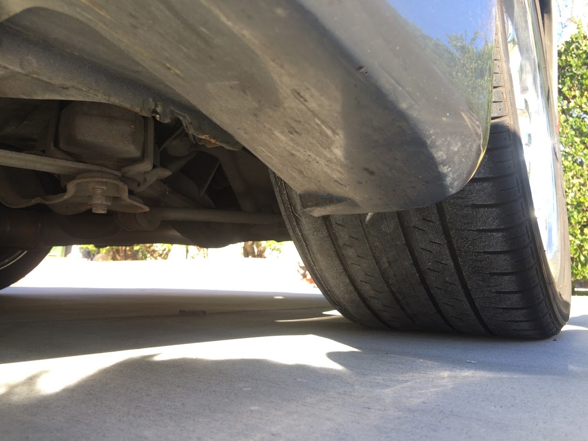

How underneath the car looks..

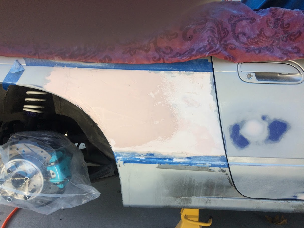

so i count how many dents/imperfections the body had:
38 small dents / 4 big ones
Trunk and garnish were bent
Front left fender had a crash

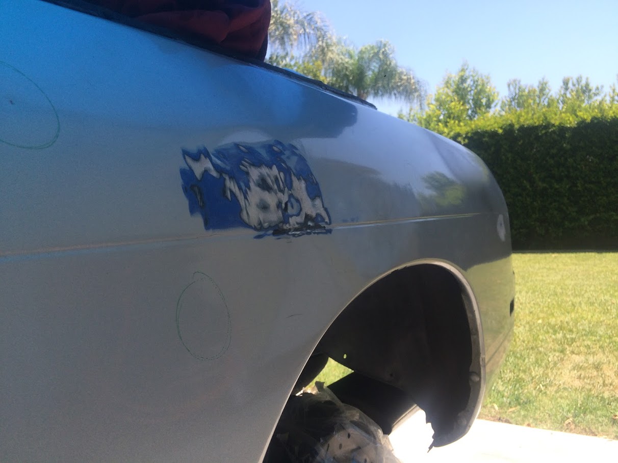

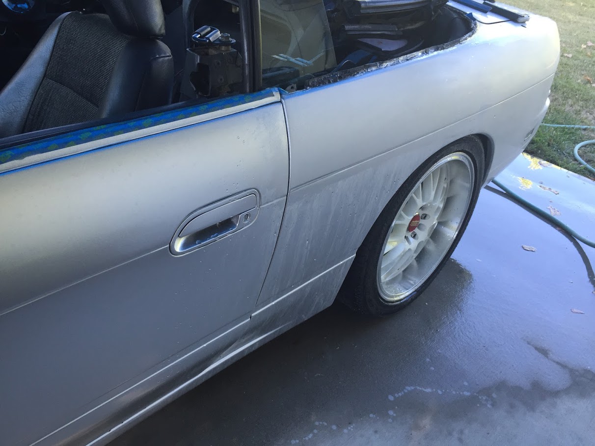

Left quarter panel had a Kick
Right quarter panel had.. another kick lol

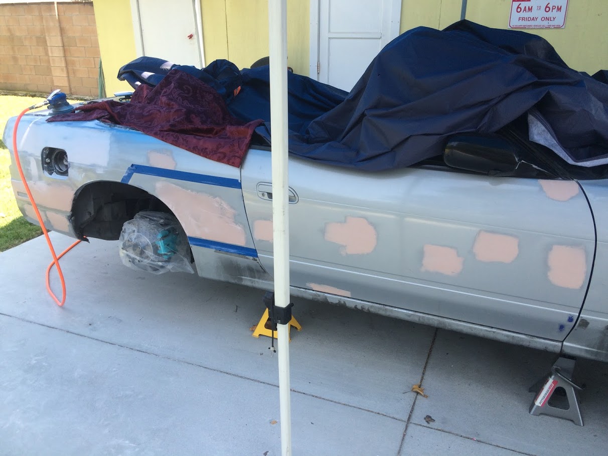

So.. From now on all about this car its gonna be Body Work

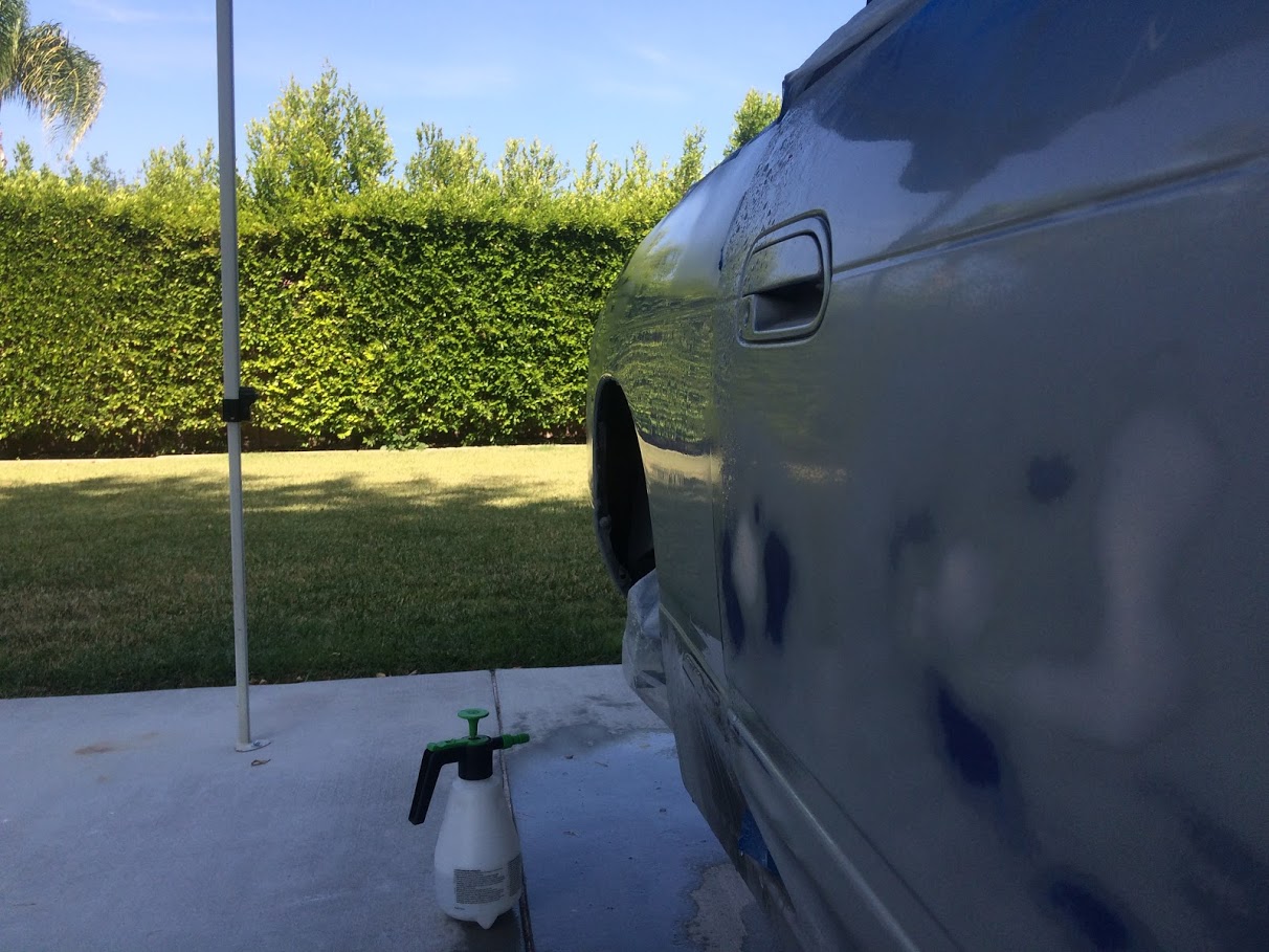

Left 'kicked' quarter panel, picture was after i pop up the big dent
Right kick

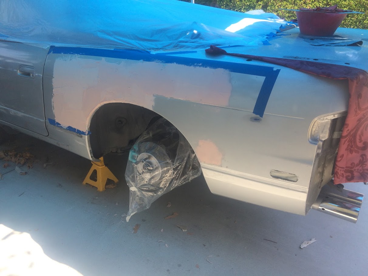

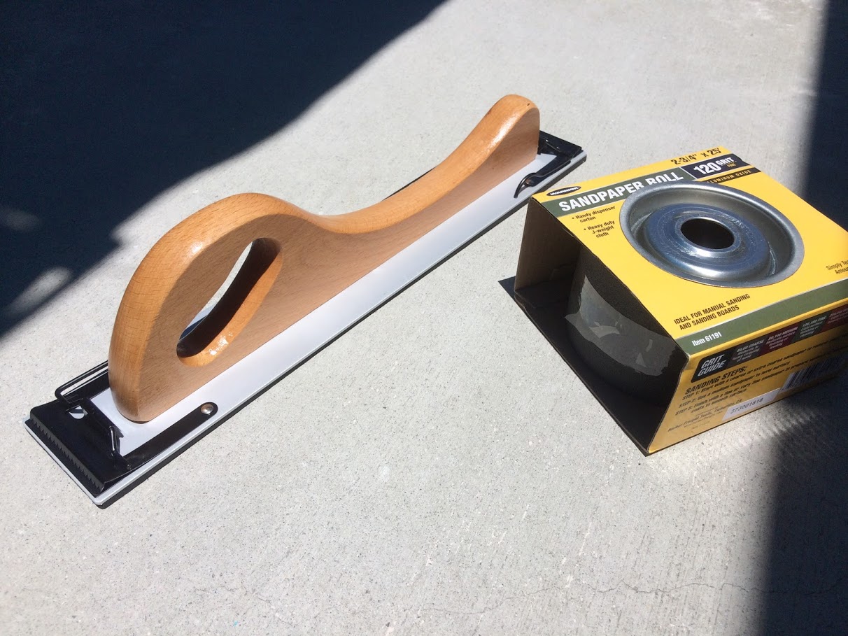

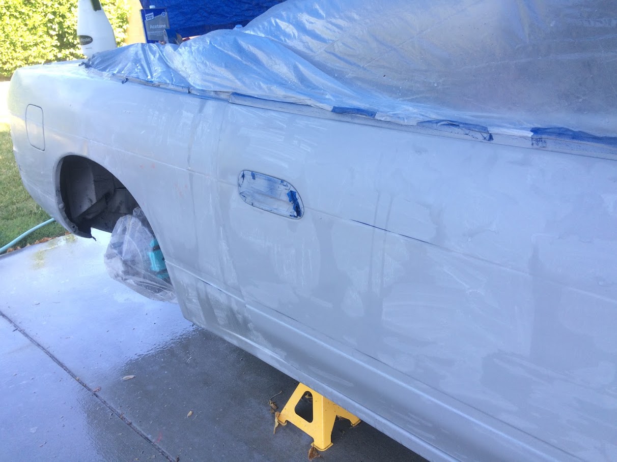

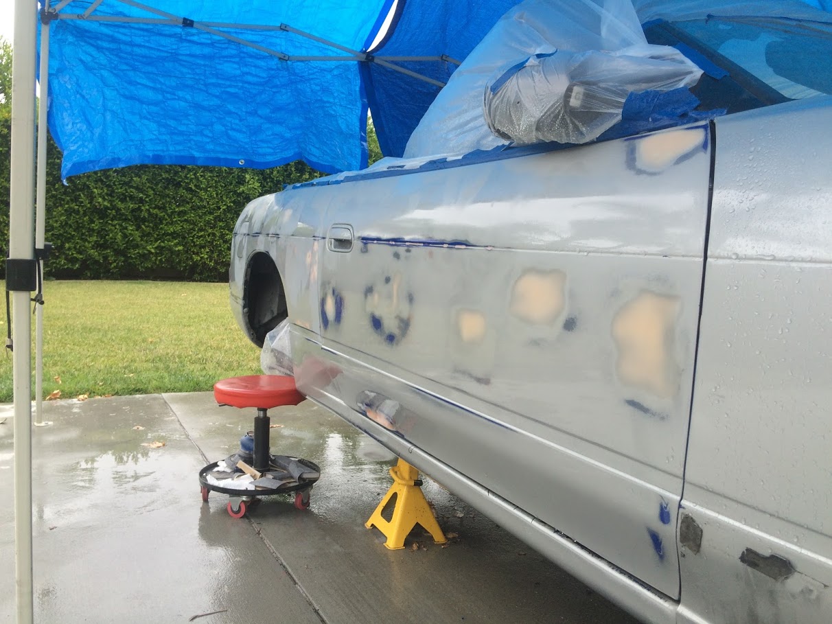

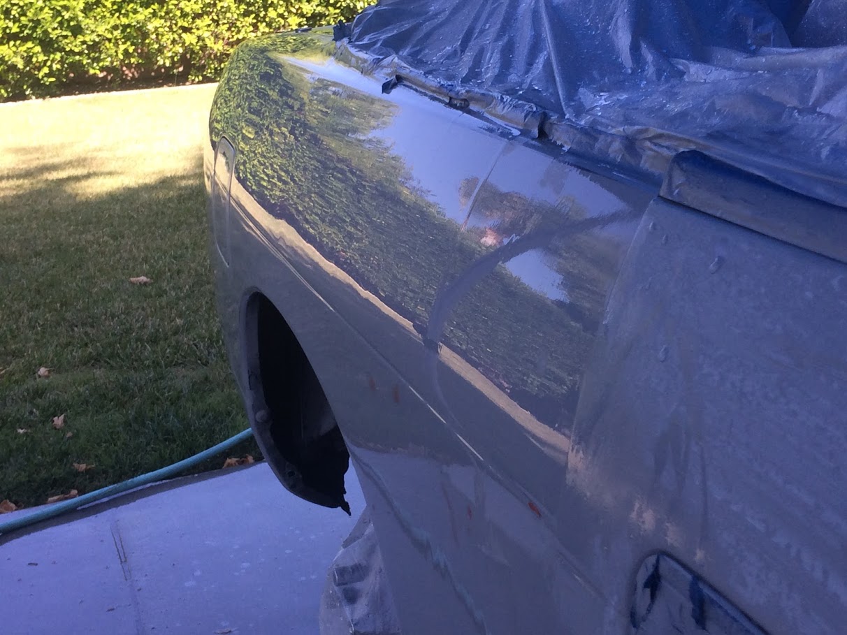

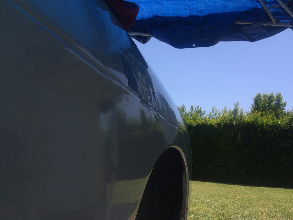

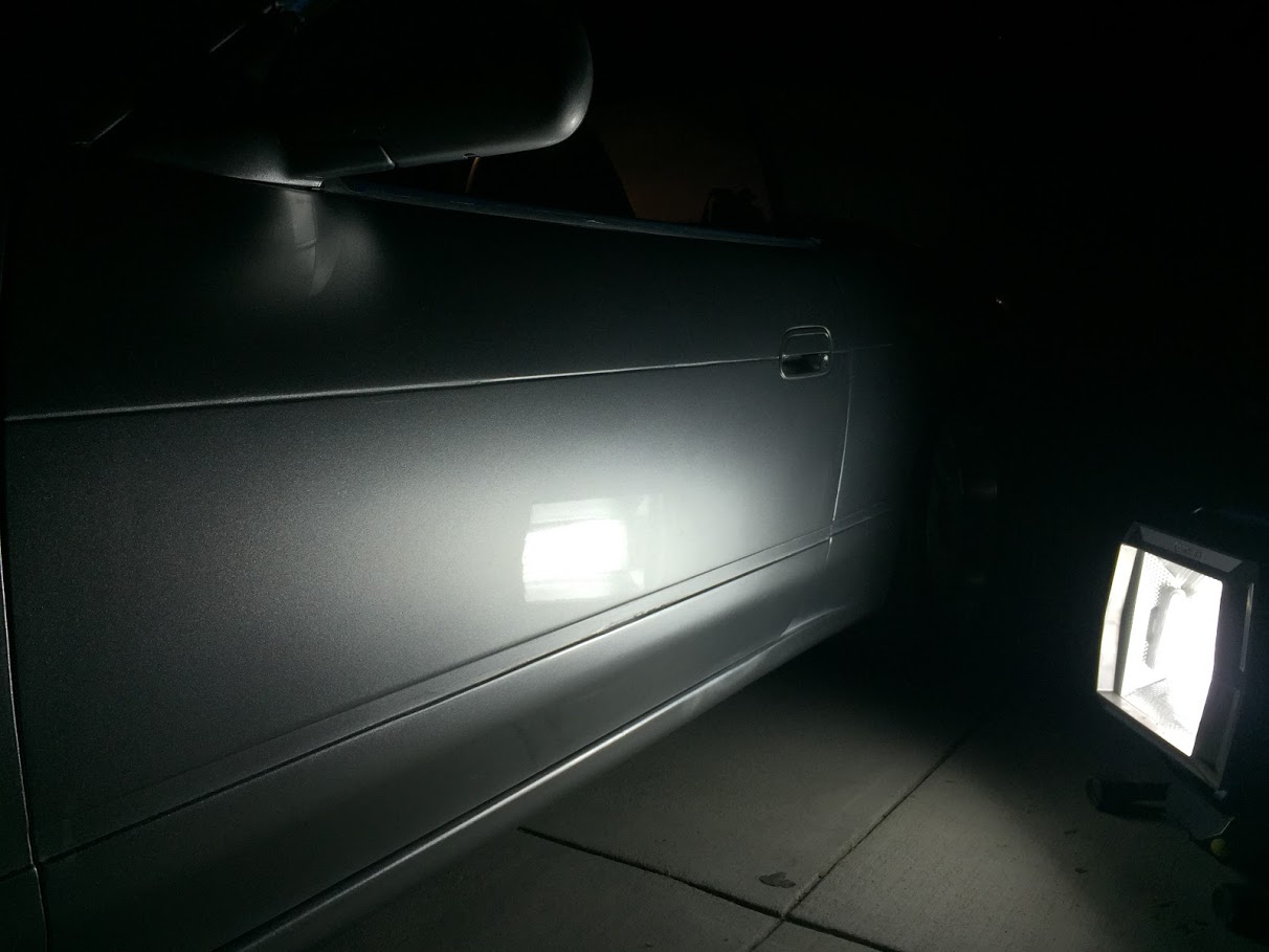

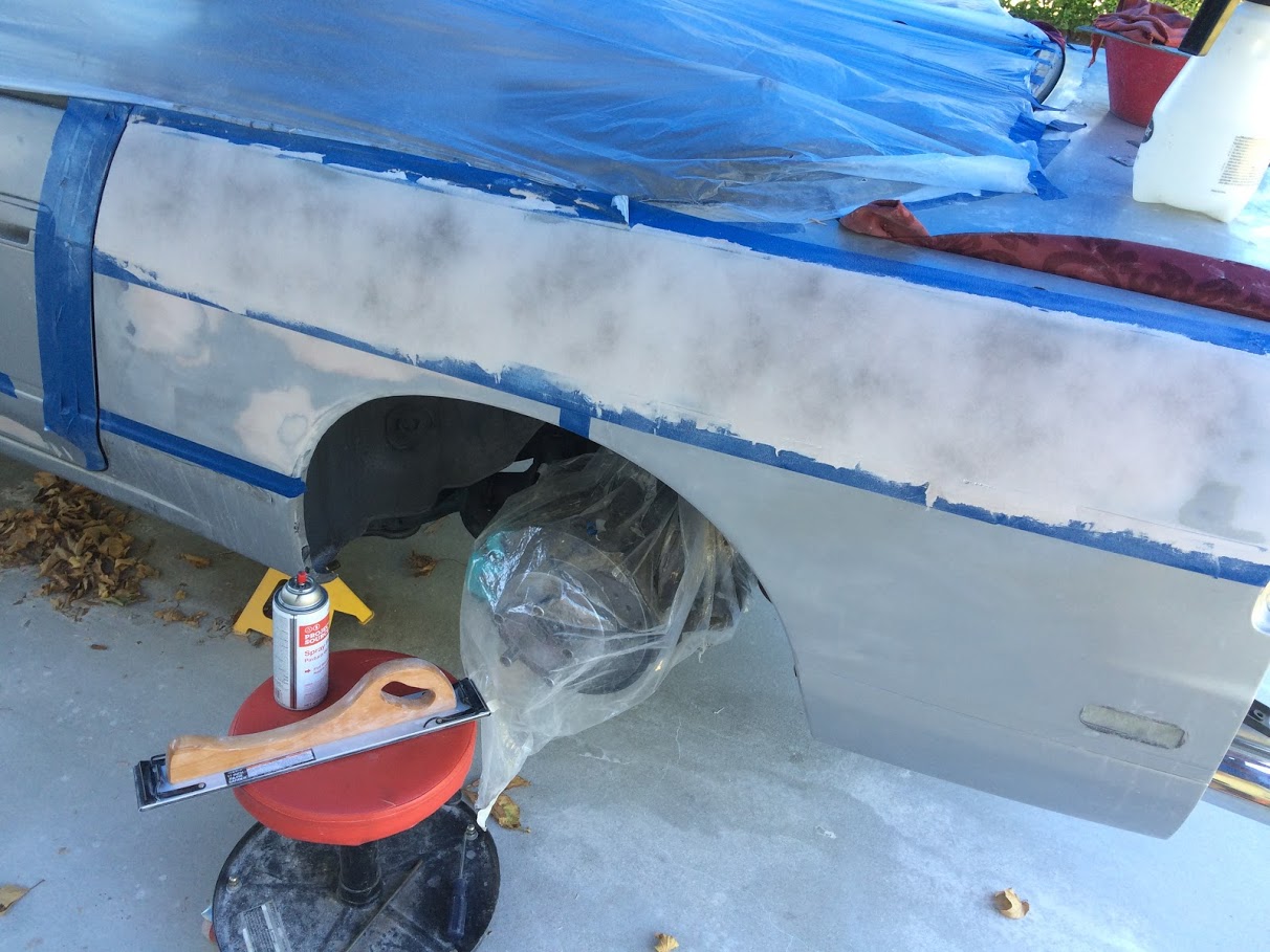

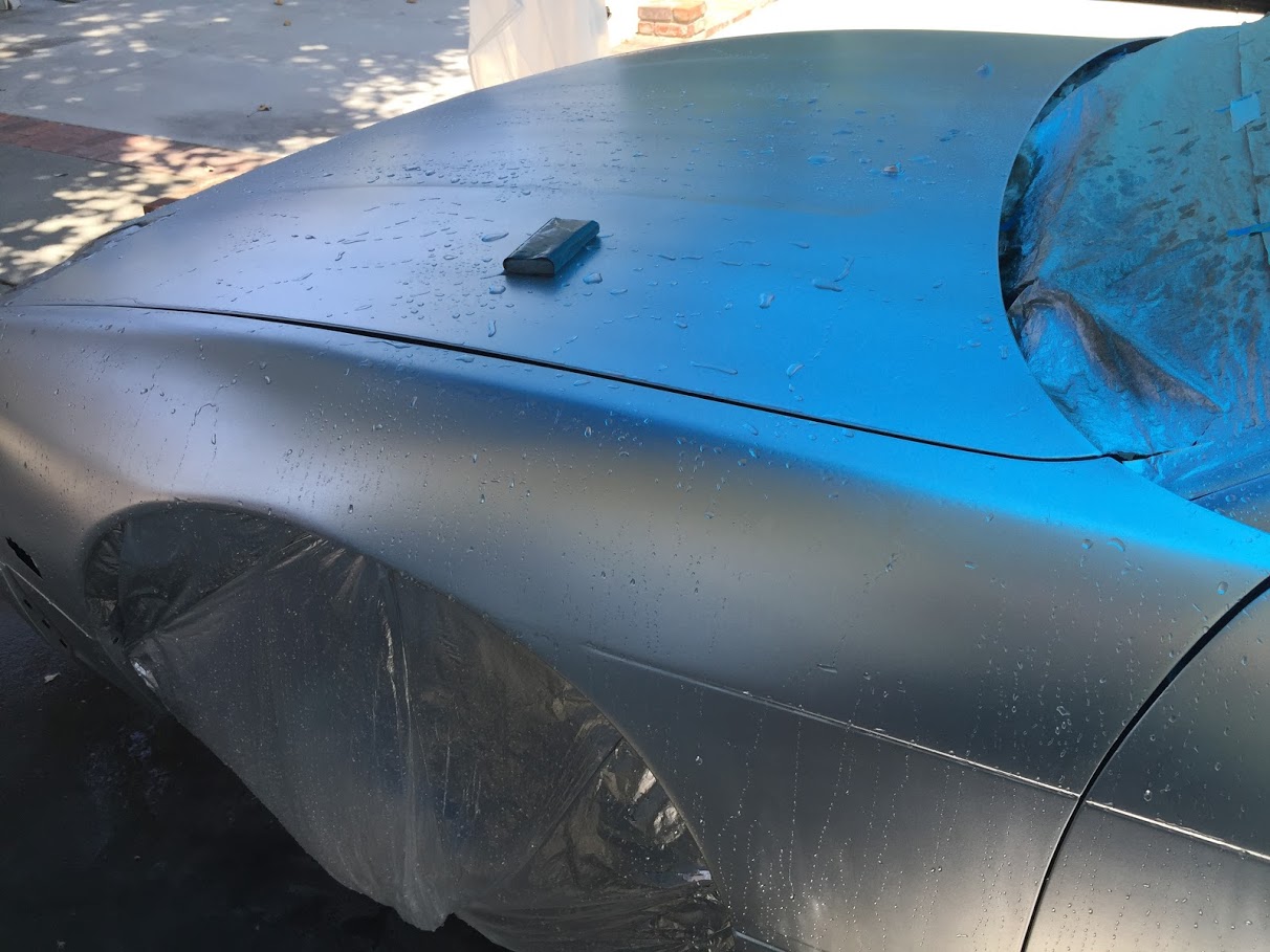

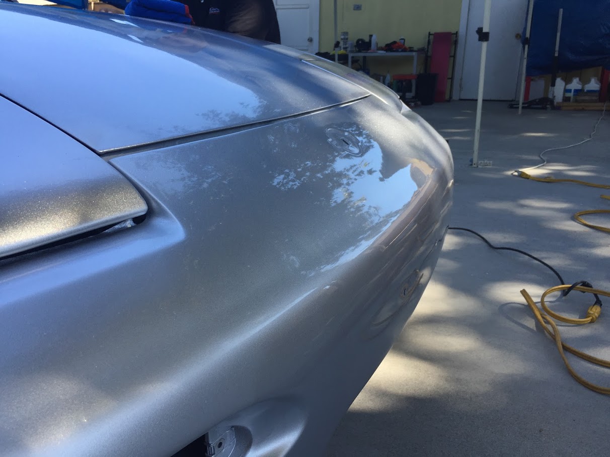

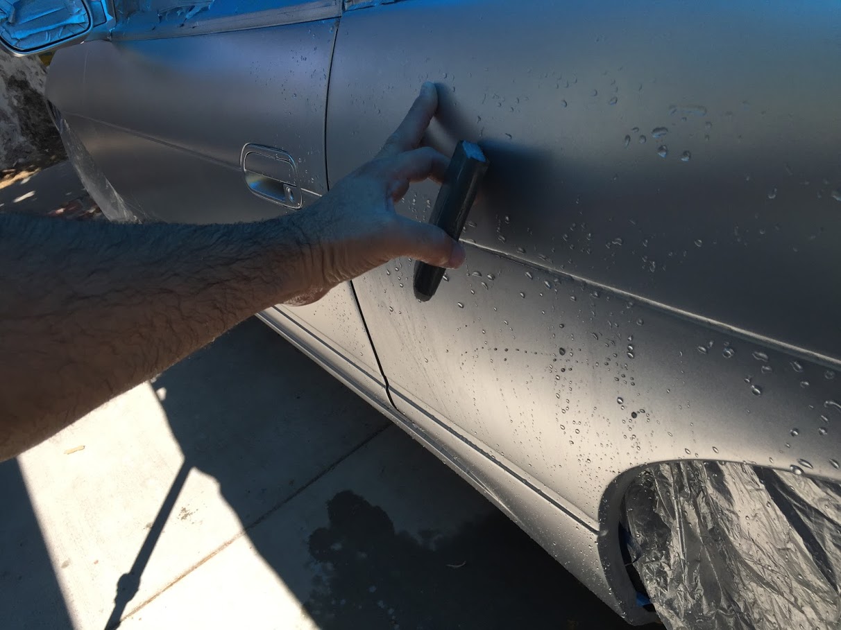

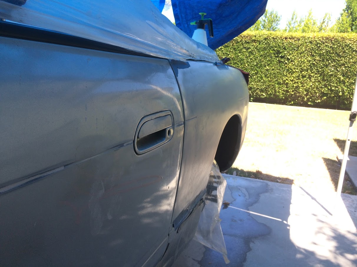

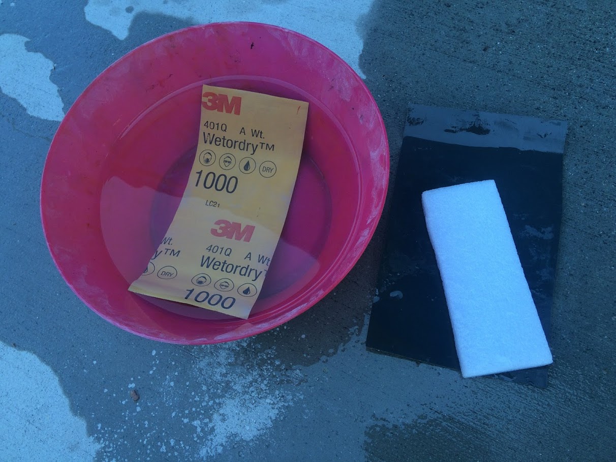

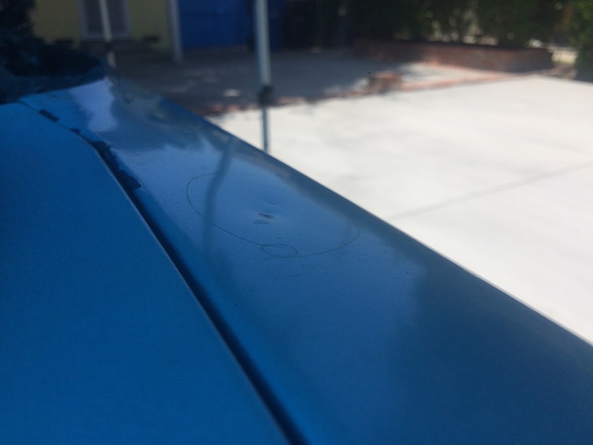

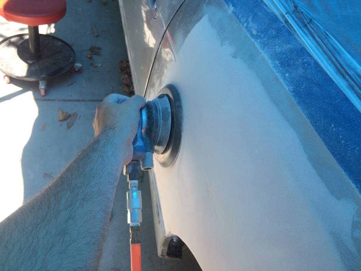

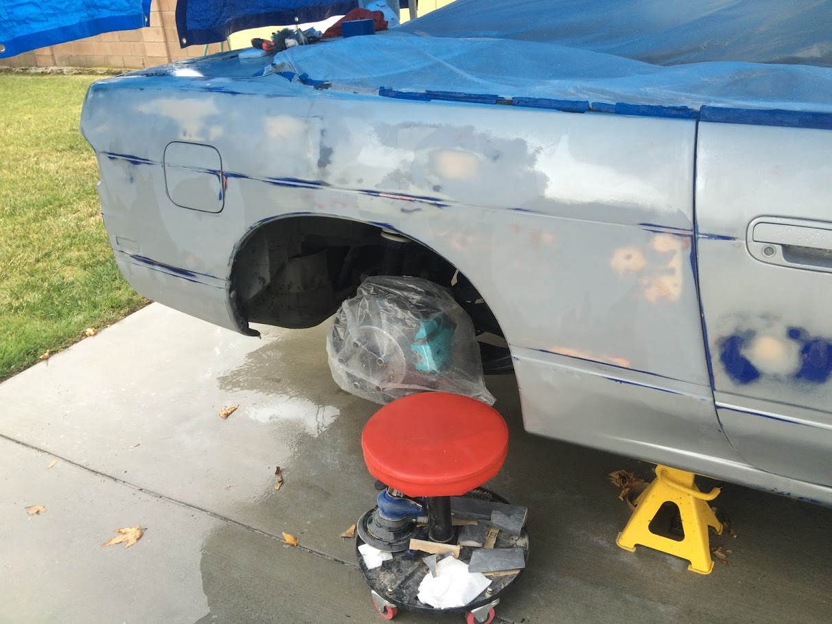

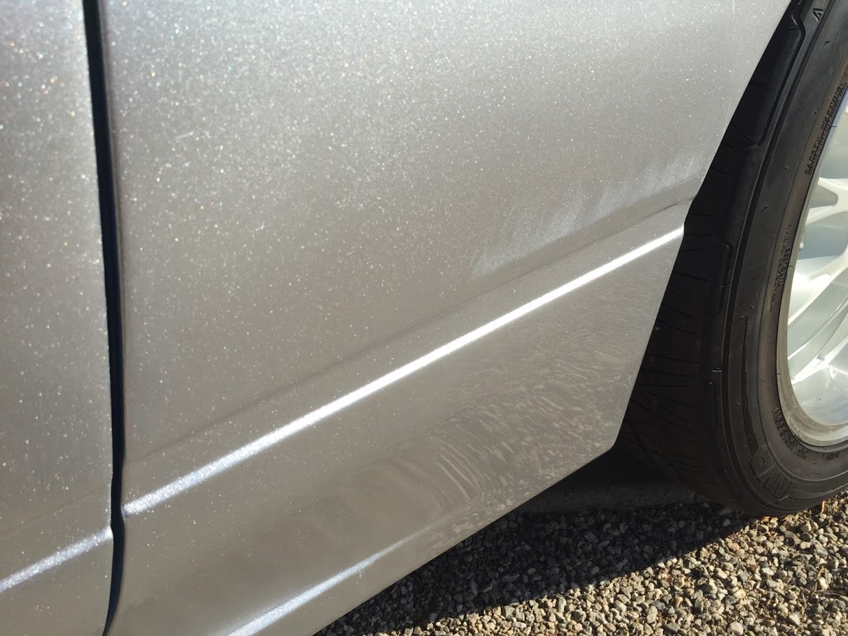

To see if you are doing a smooth work u have to wet and follow line reflections (turns into a mirror after wet)
If you see distorted image...keep sanding and making it smooth

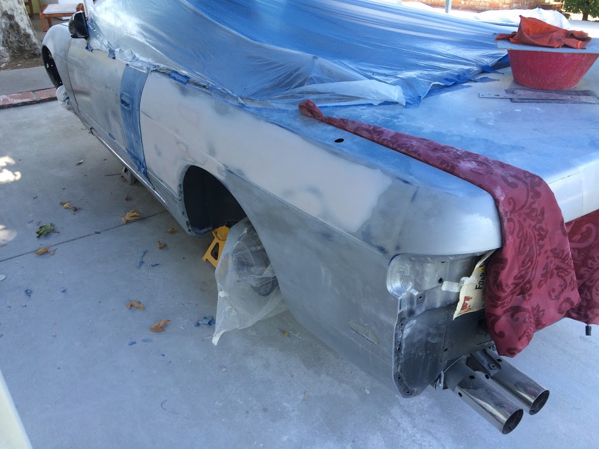

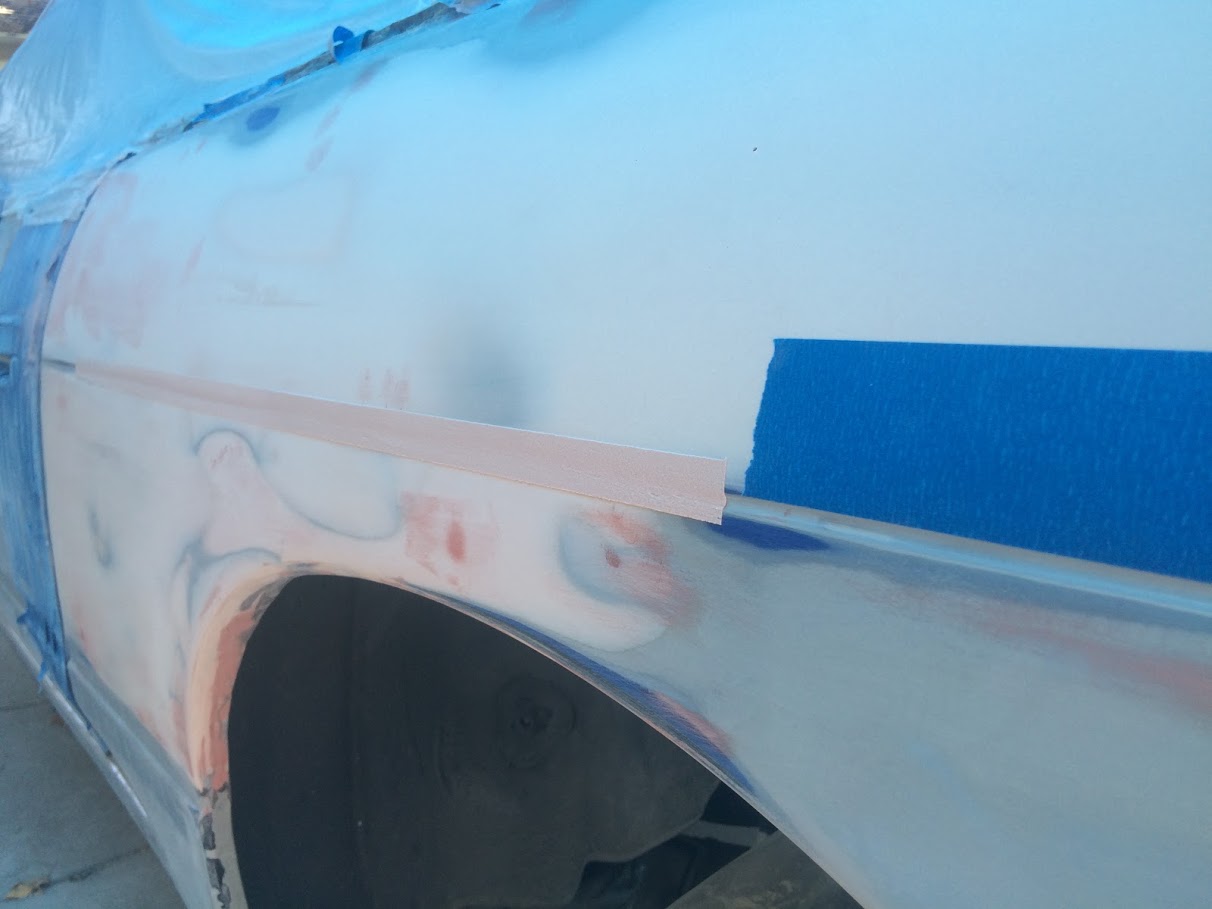

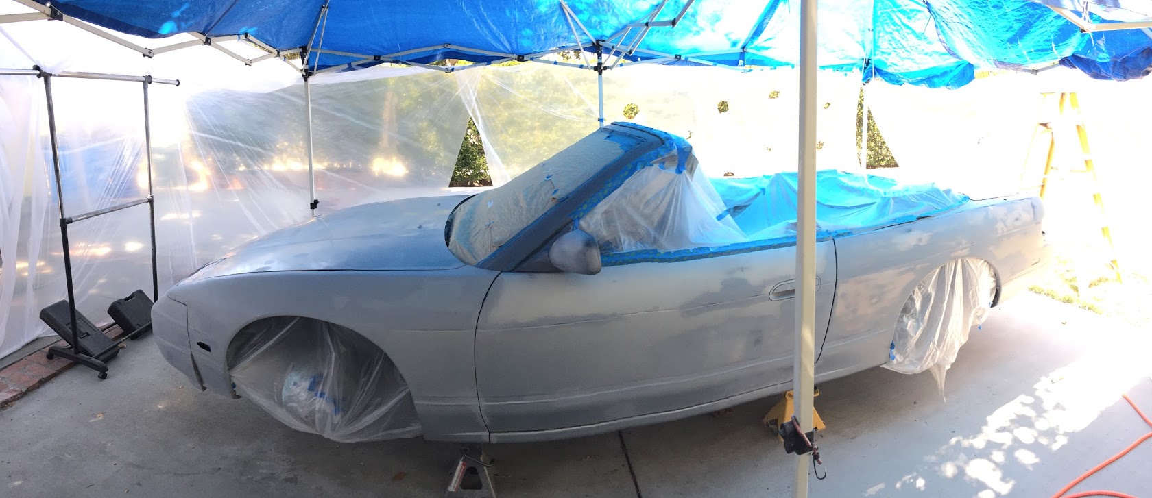

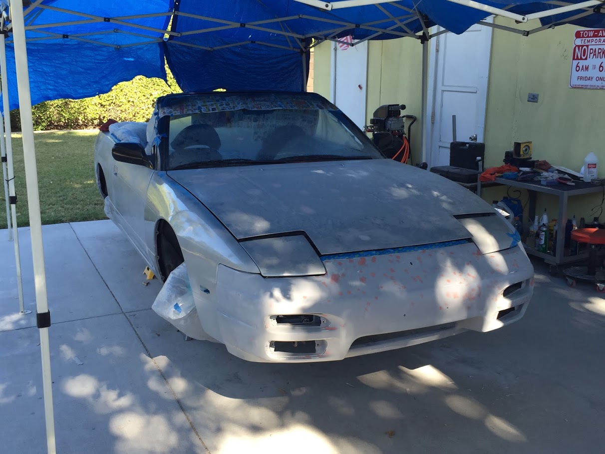

All Primered with Primer Filler, need to wet sand it now

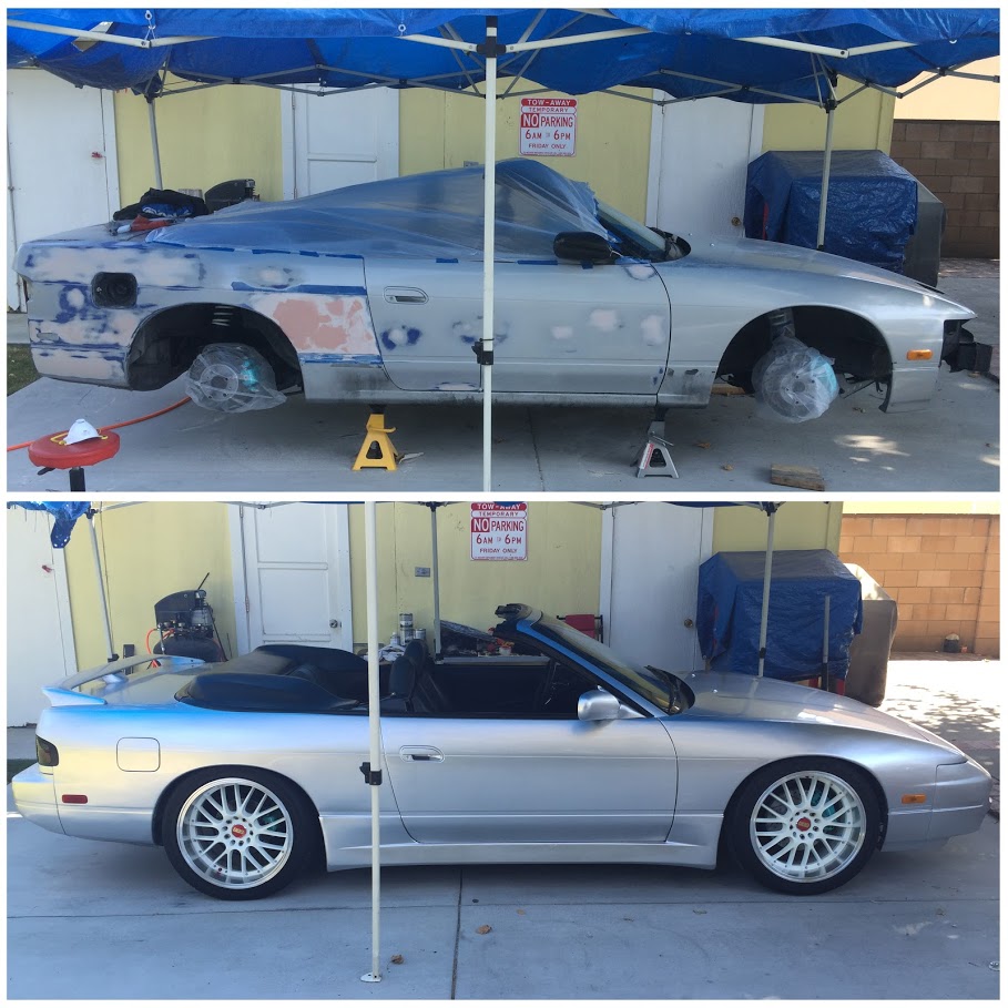

And now the image reflection is getting better
after this.. right side is DONE!
Now lets move to the Kicked panel #2 lol

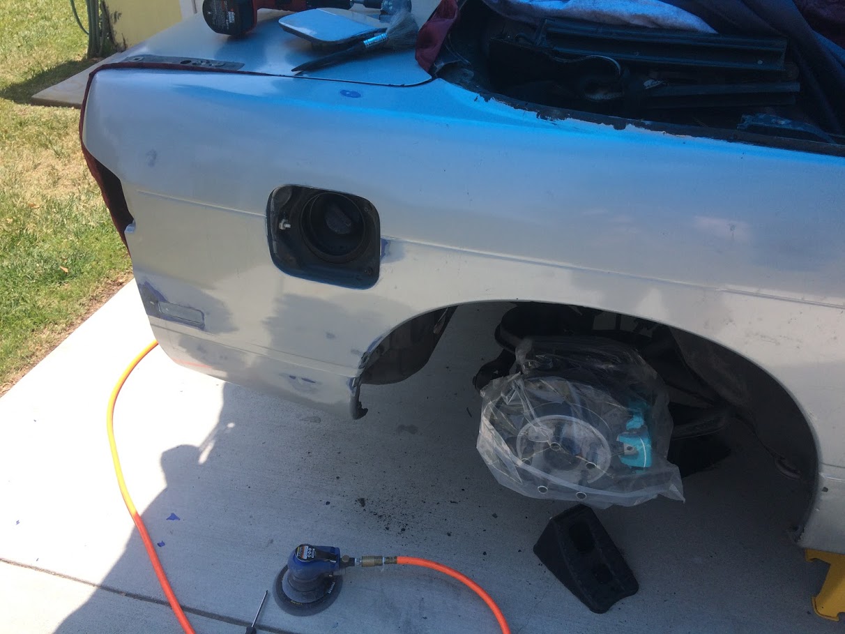

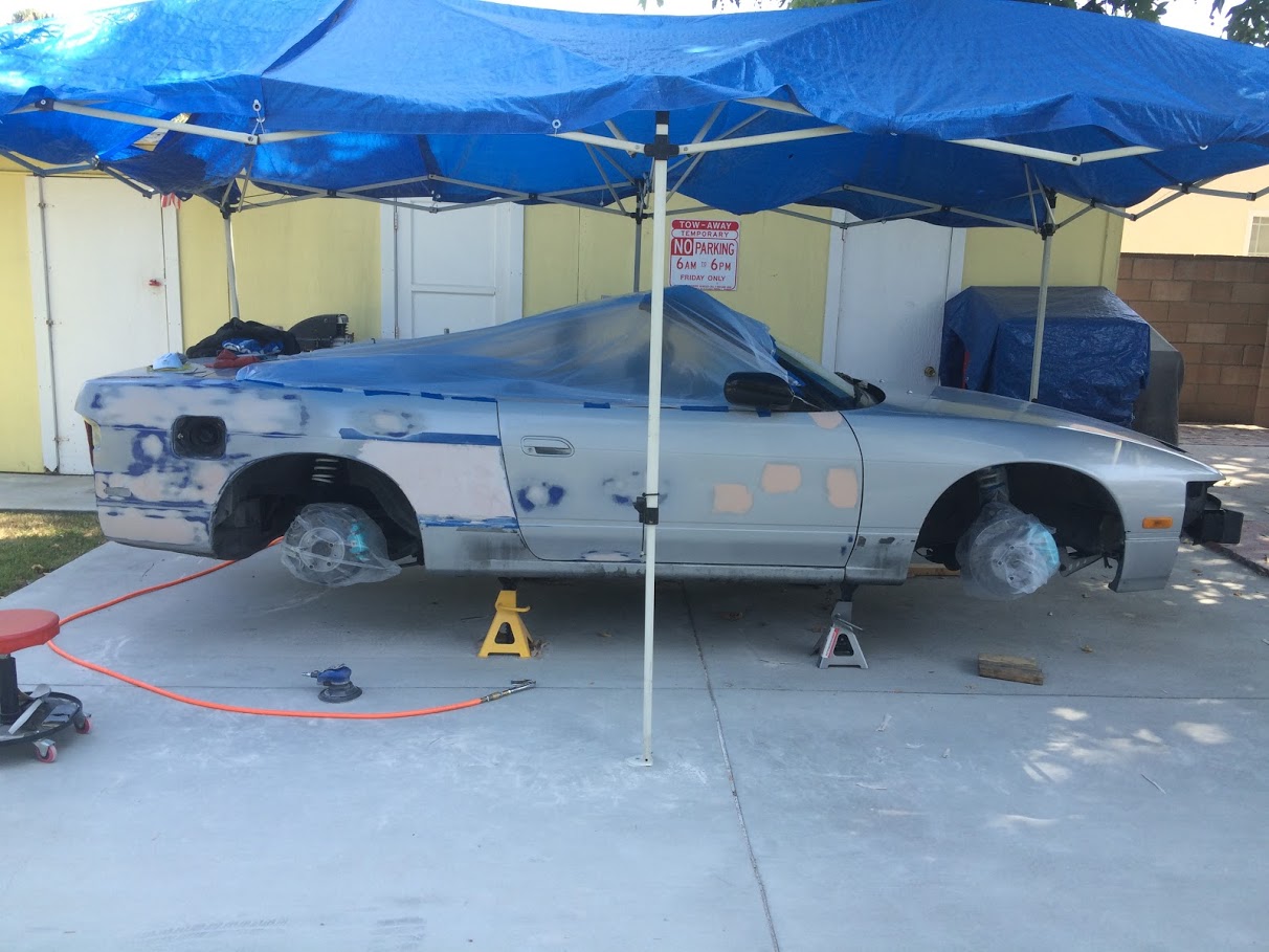

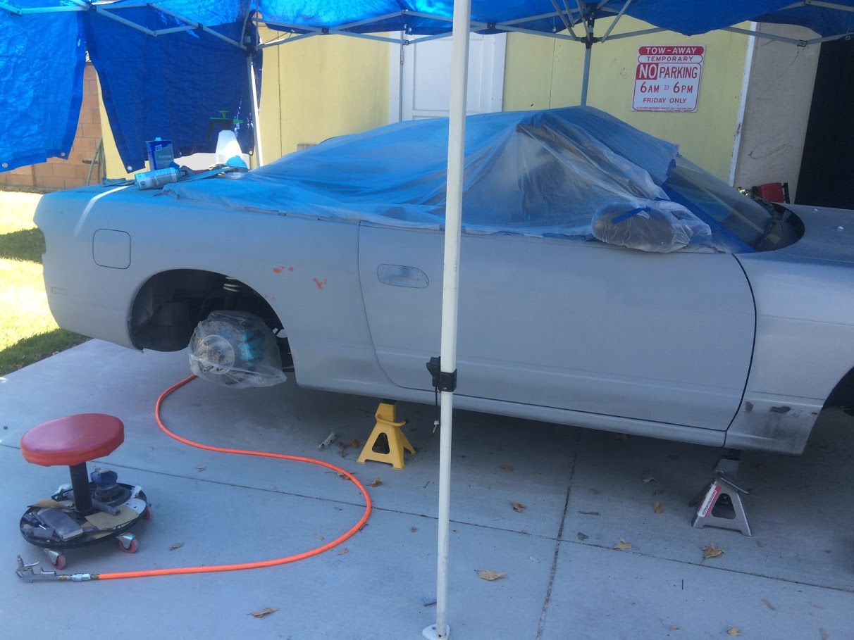

Body work extended a lot on this quarter panel so line was out.. i had to make it again with bondo
Redrawing side line

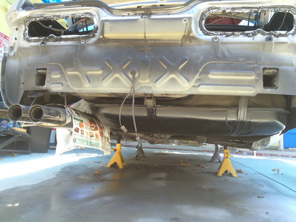

i Painted gas tank semi-gloss Black because i like to hide it from eye view
i hate when car lines are good but u see a silver gas tank there
Now is better
Sanding sideskirts with scotch pad so i can paint over it

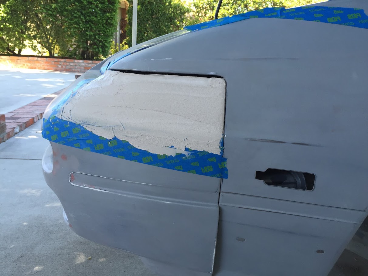

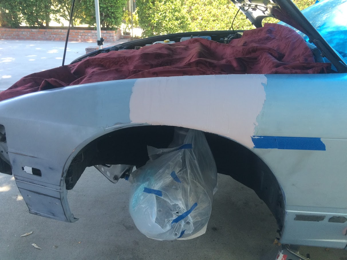

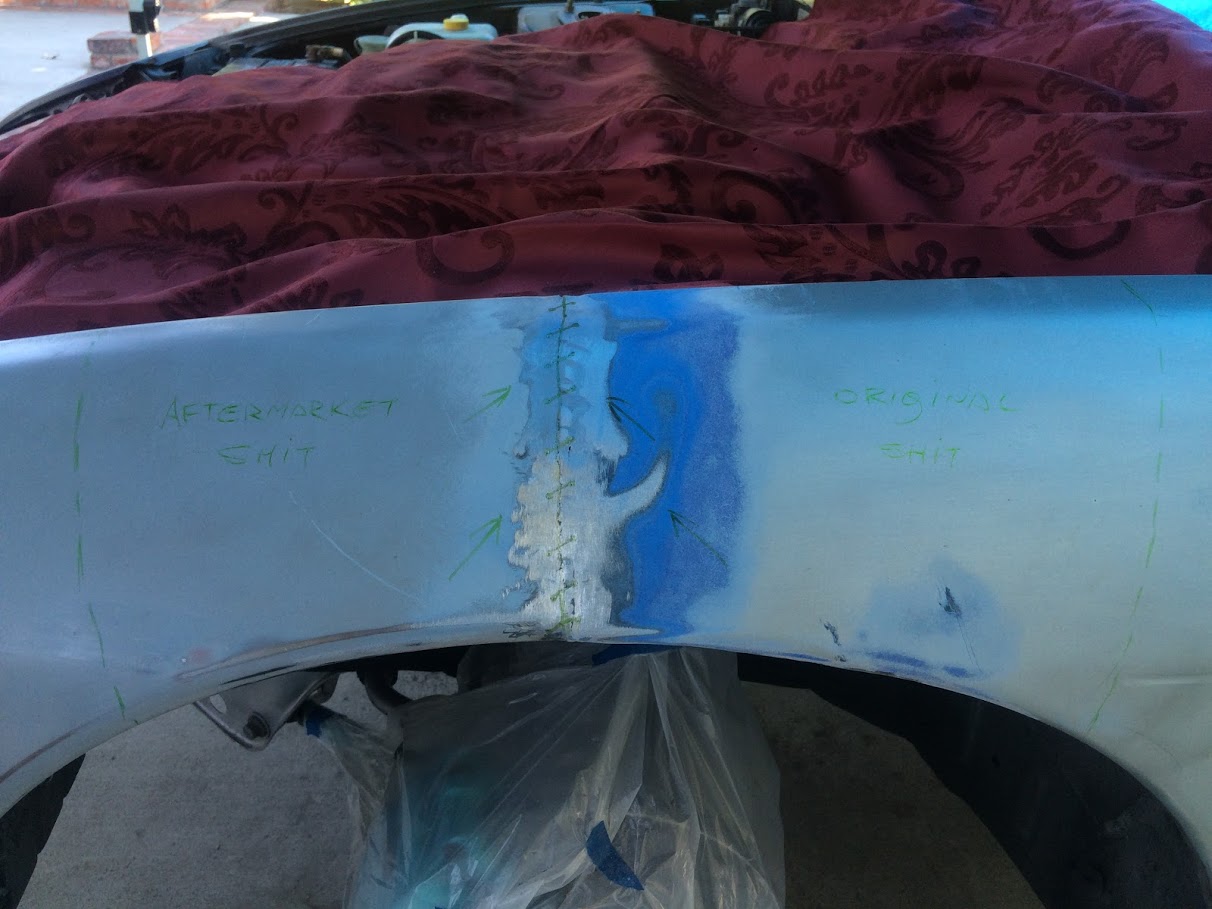

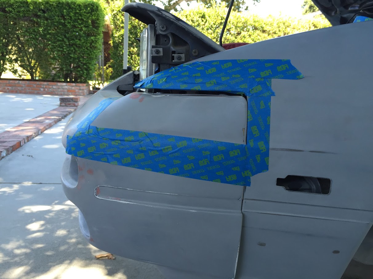

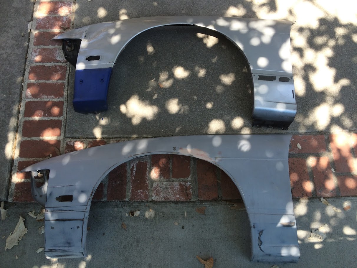

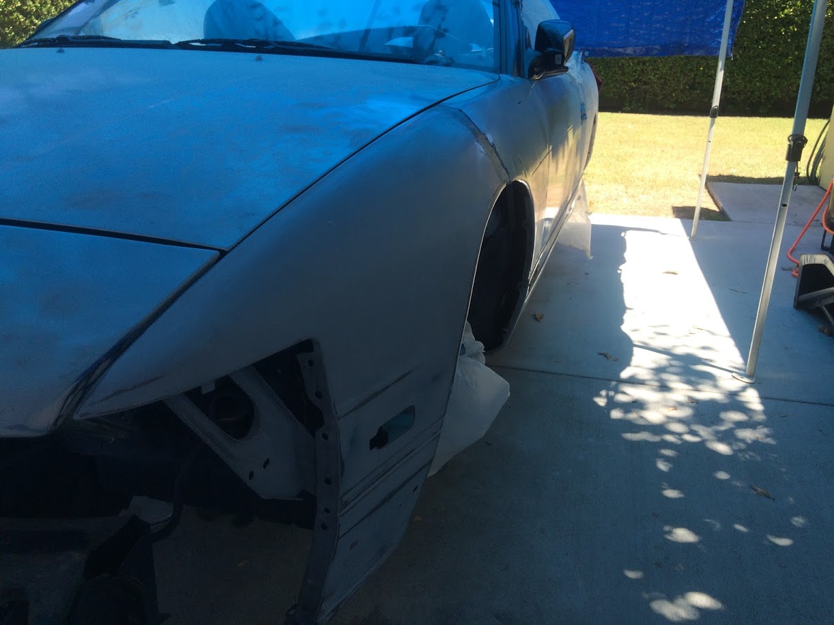

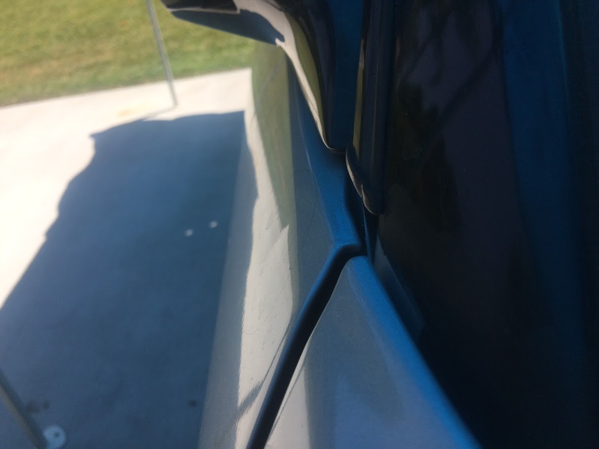

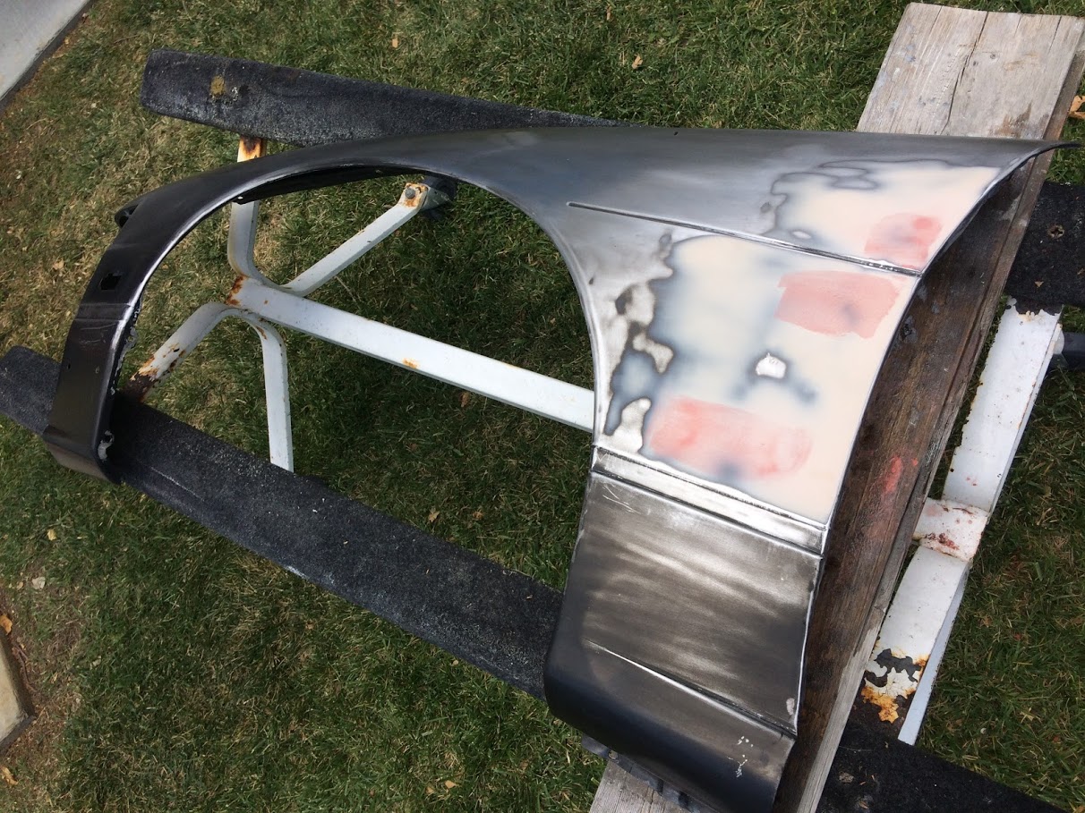

The left fender i got from Facebook was Aftermarket...so fitment sucks really bad
so i had 1 OEM crashed at nose fender and 1 good aftermarket one that doesn't align at all.
The only solution i found was mixing both

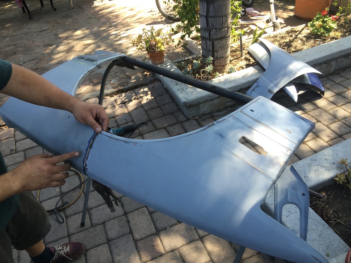

Cut both and use the Aftermarket nose welded with the OEM rear part
because OEM fit perfect at door line!
so this is what it happened...
Because i didnt had (now i do) a Welder, i had to ask somebody (and paid) to do that
work wasn't good at all so i had to cut and make if fit
Then.. hide the welding marks with bondo and make all smoth

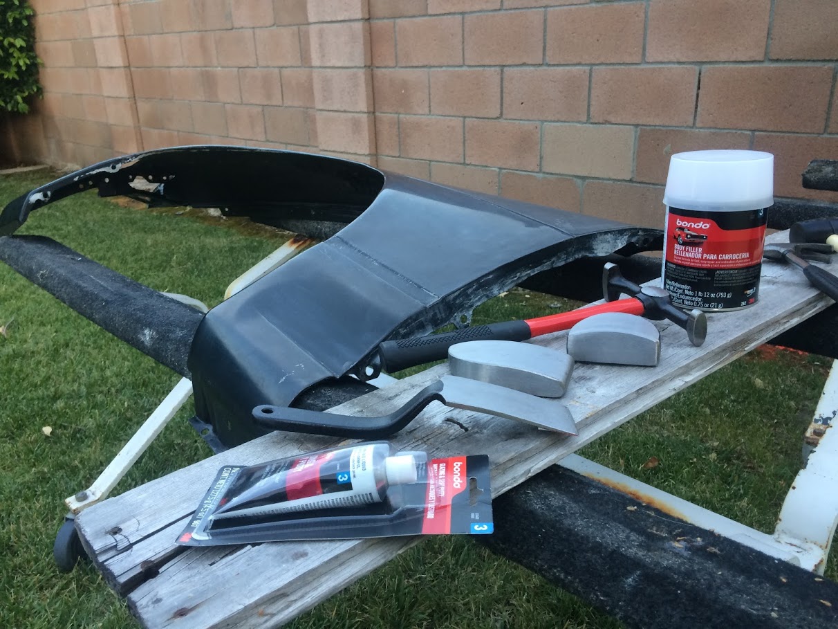

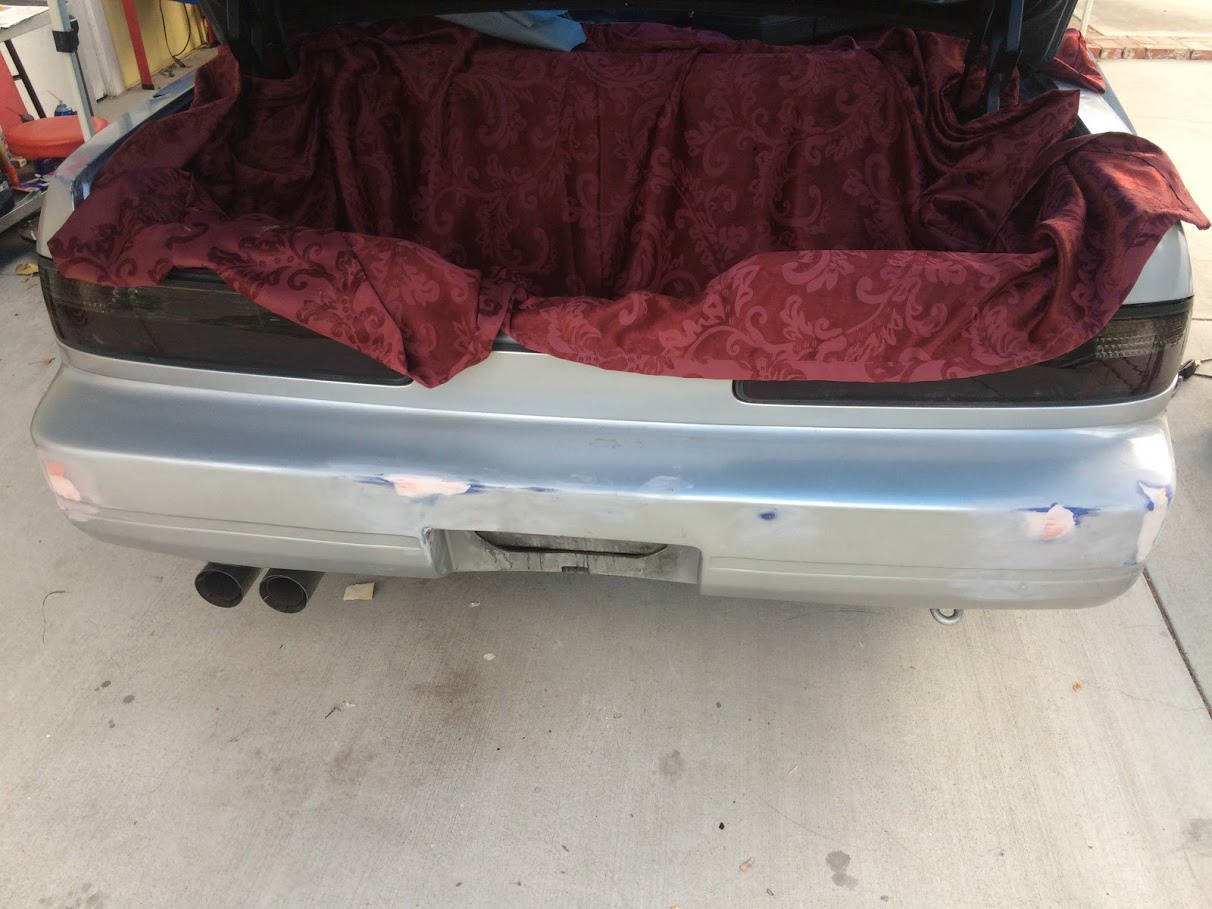

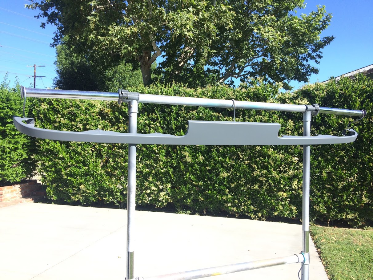

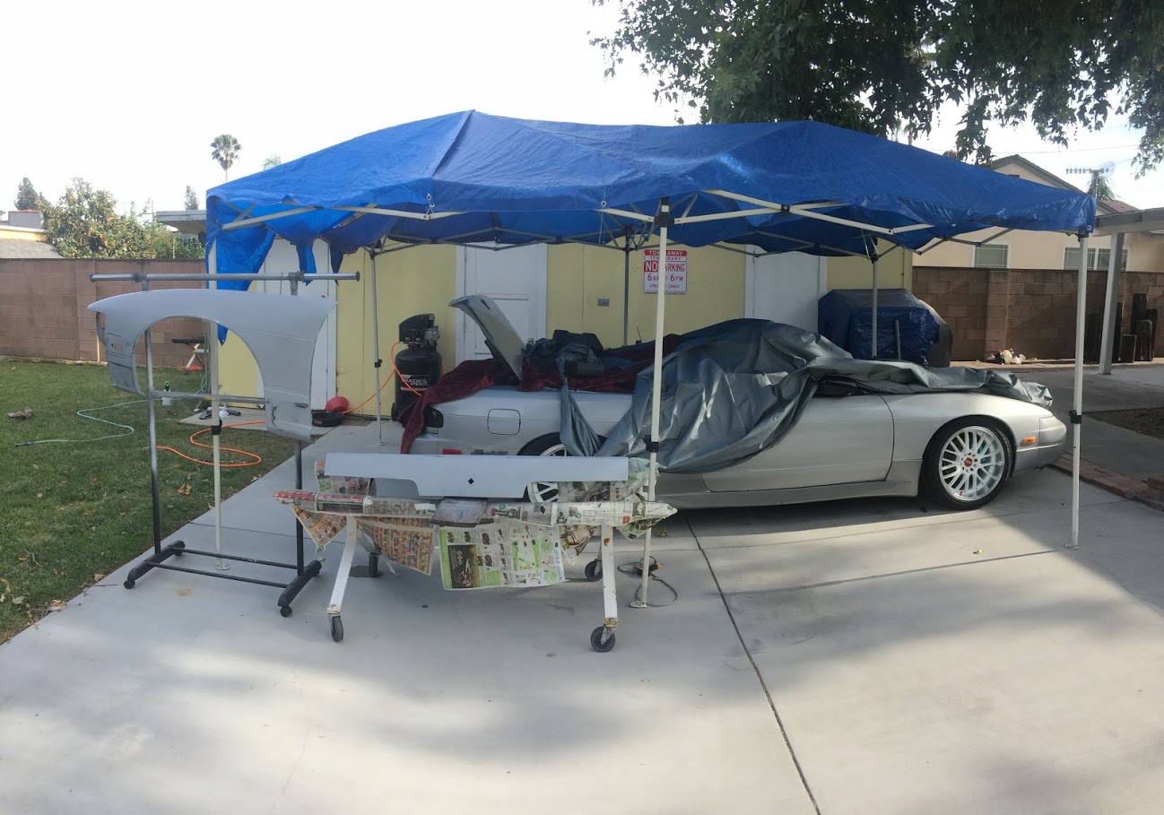

Bumper had A LOT of imperfections and holes to cover
changing the frame from old to new
Ok.. back to the Aftermarket Fender
Because Aftermarket is shit sometimes.. and this was not exception
for some reason nose was SHORT so i had to make the bumper longer with bondo to fit

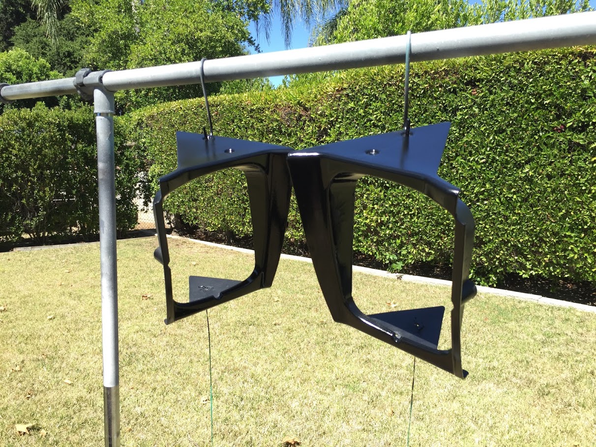

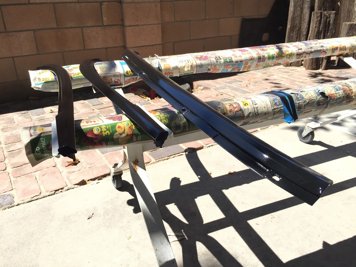

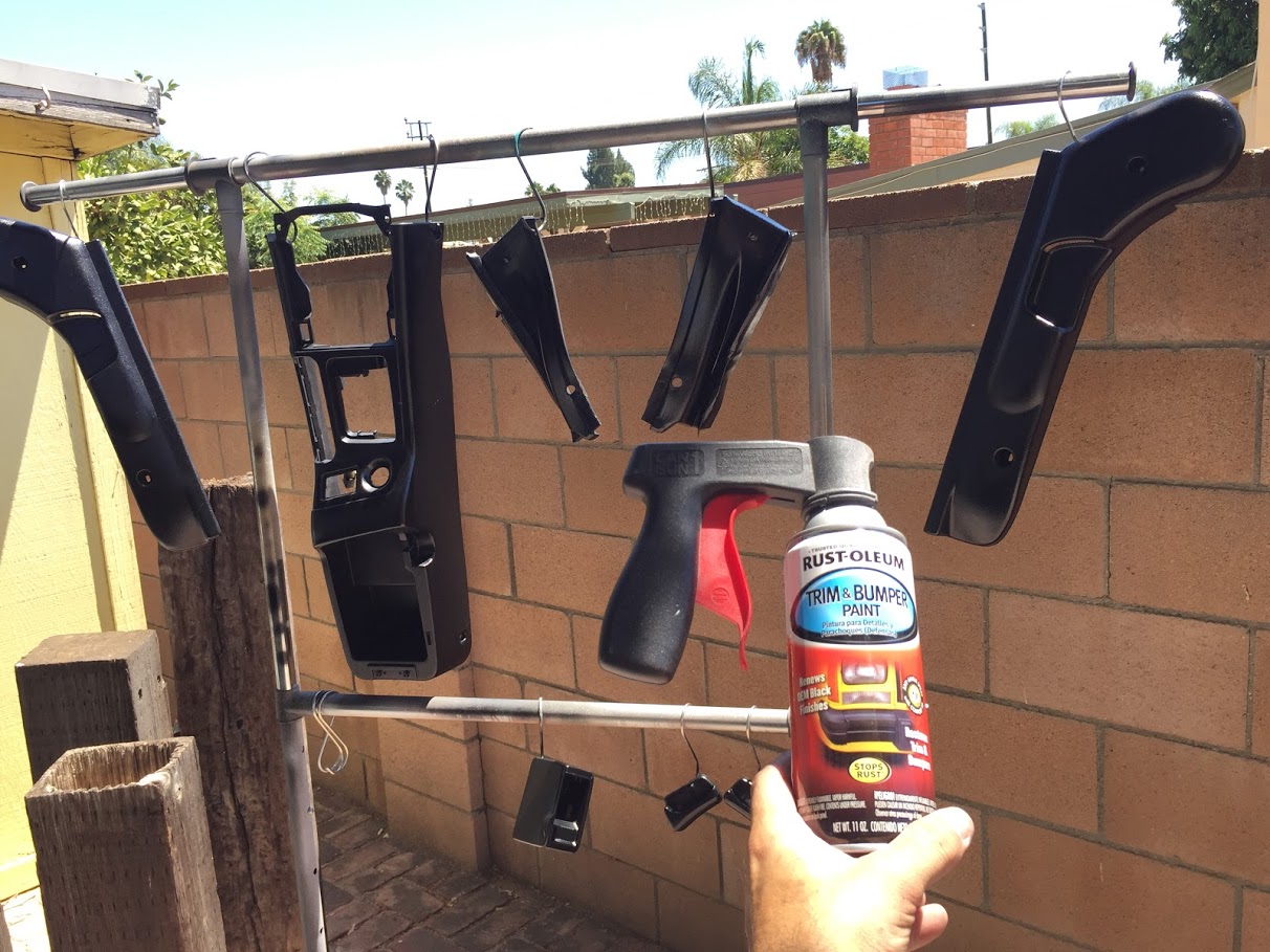

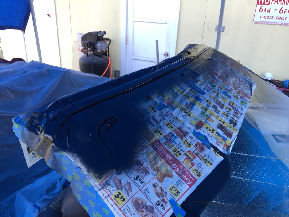

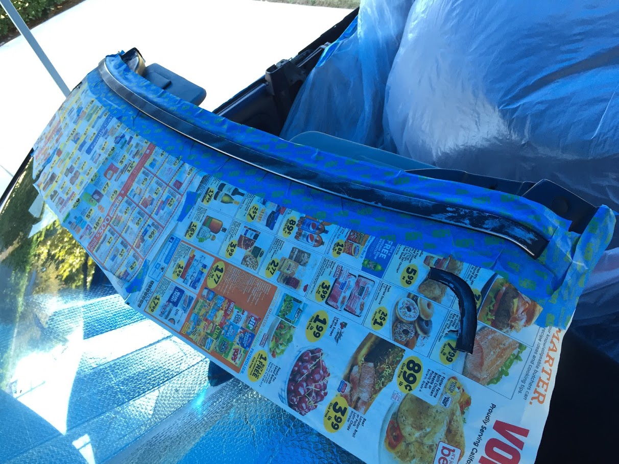

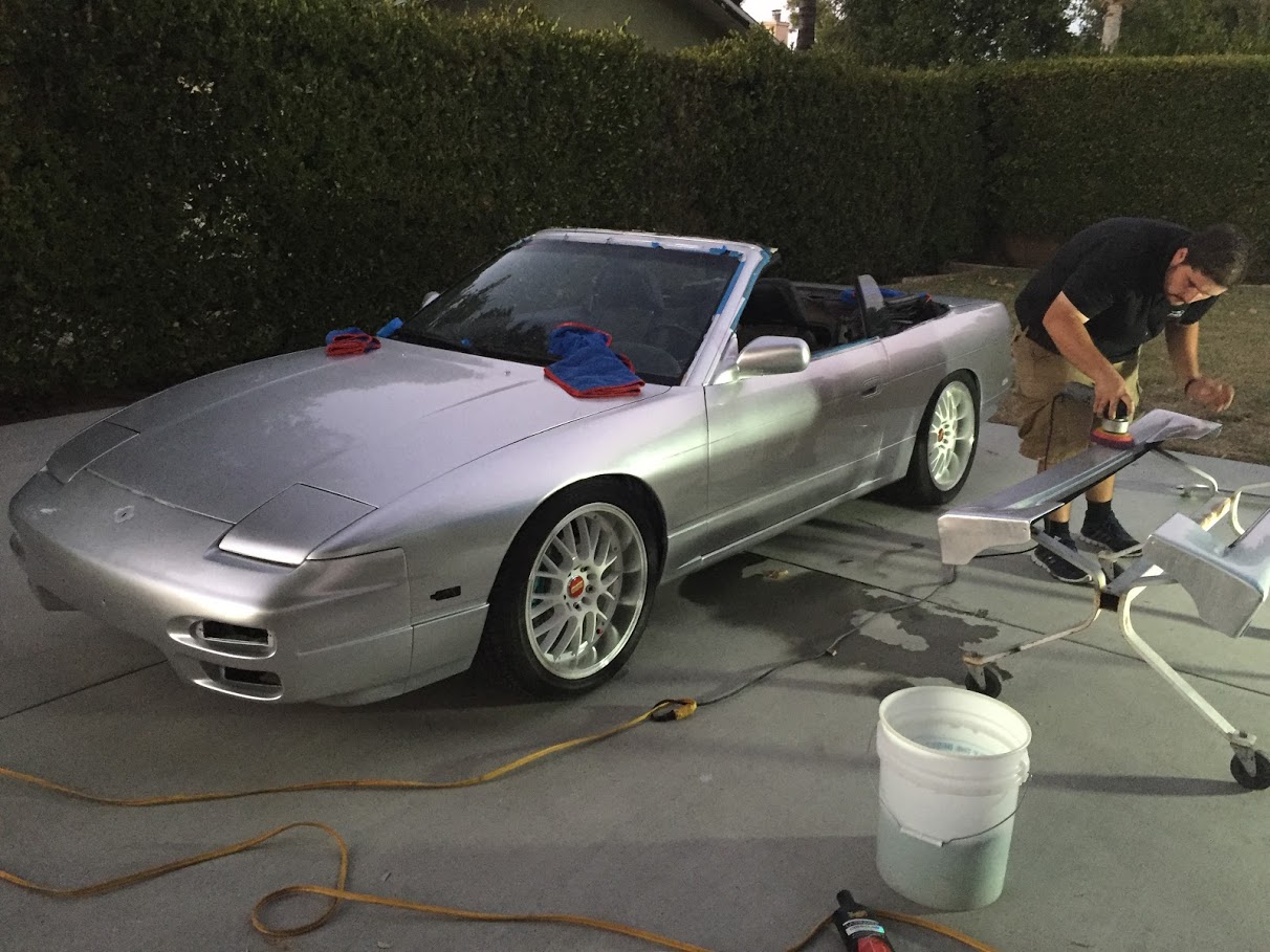

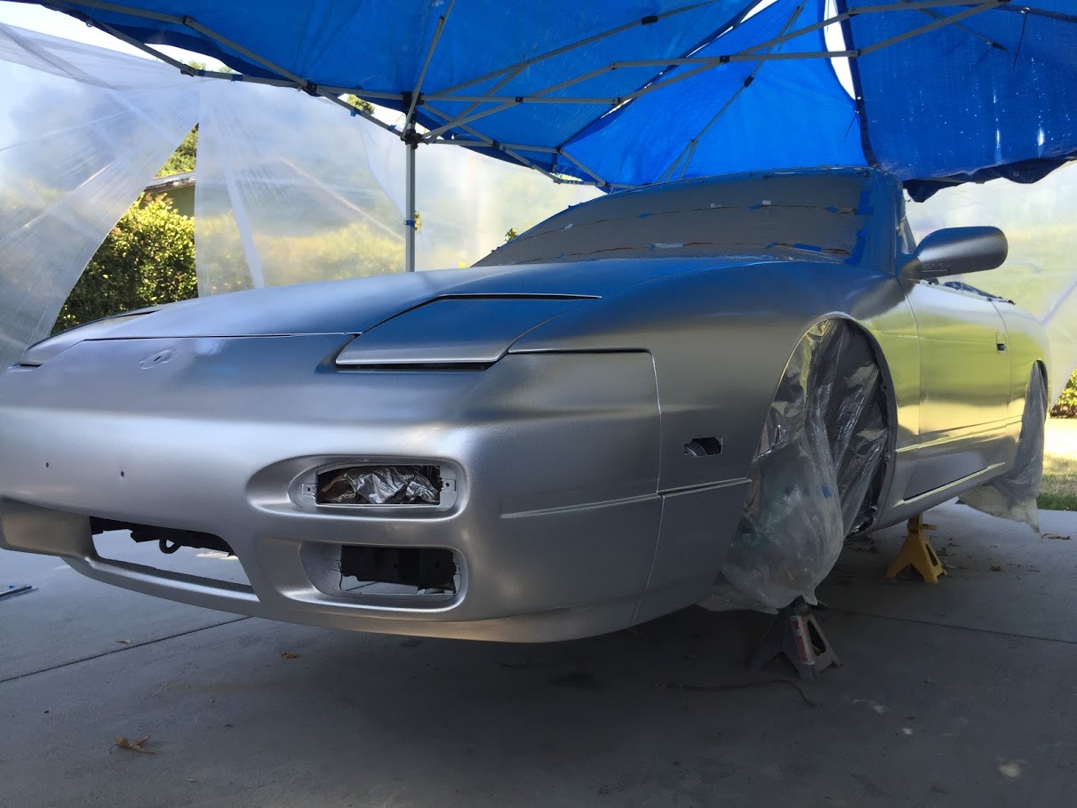

Painting trim parts

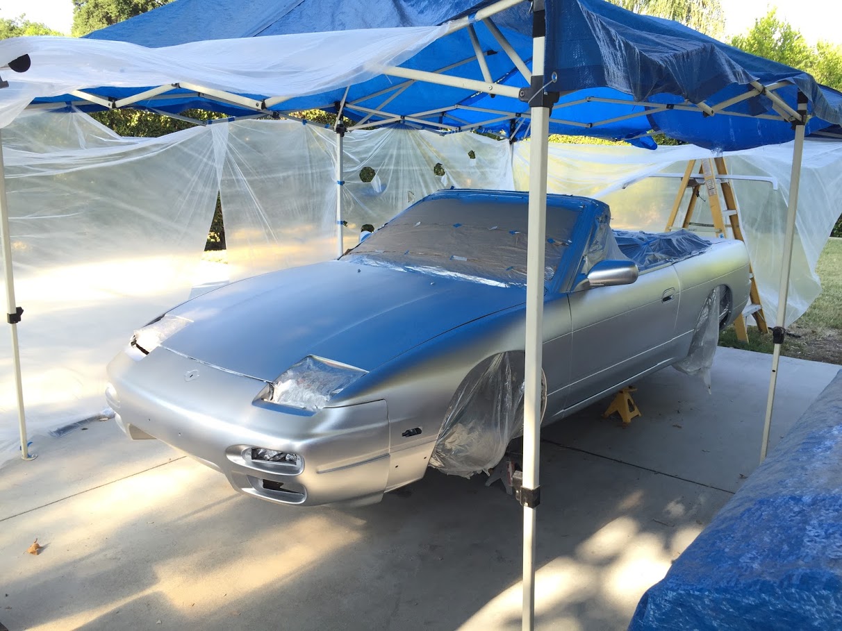

Puting all together and masking.. .YES, is going to be complete painted

more trim parts
Before:
After:
Let me tell u something about this product
i purchased a couple of this and for some reason it ended looking gloss black
and other can semi-gloss (which is the look i wanted, Original trim finish look)
maybe fabrication Date was due..don't know, next i went to a different shop and got a good one

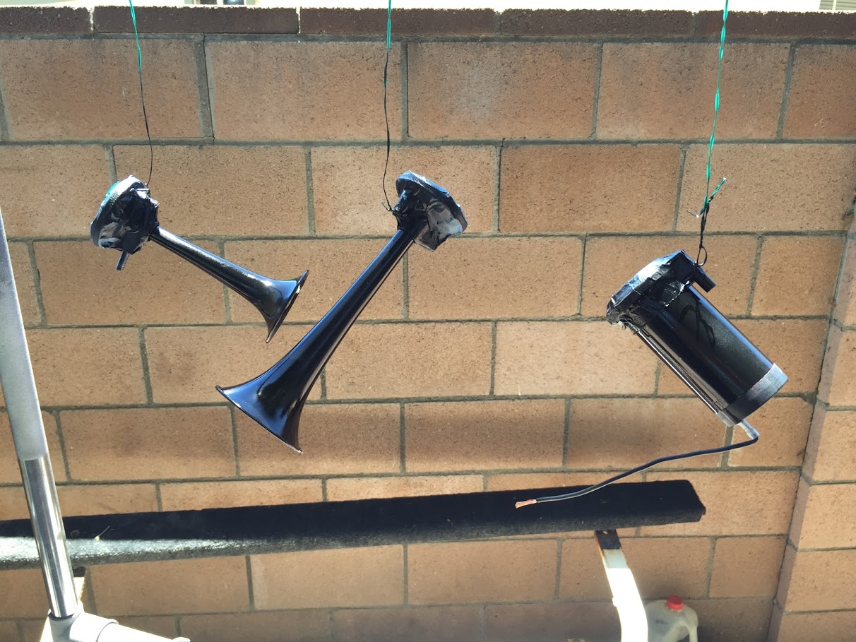

Horn tone
my love with this horn it comes from my dad, he used this horn in every car he had back in the day
(is the same tone from 70/80s Ferrari Daytona and Lamborghini Countach horn)
As i cannot pay for a original FIAMM horn, found that this Hella is cheap and most accurate tone
BUT.. because i never liked the ''look my horn'' thing
i paint it Black and hide so nobody can see it

As i really like the Silver on this car, i wanted to keep the same color but with more 'spark' (because California sun bro)
But i dont know how to paint as a PRO and have no idea how to MIX and all that shit..
so i did a research and found this Duplicolor paint, its Lacquer and READY TO SPRAY (like old school hot rods were painted)
it was cheap and reviews told me it was good enough ($25 x 1L can)
i used 2 cans on this car
This is the paint used as BASE (then u apply color), thats why is Candy Base Coat, but my plan is use it as a final color
and after that adding same brand Clear Coat, (same price) i ended up using 5 cans because i fail on the spray settings and too much wind blew it.
(u may ok with 3)
Complete Paint was around $170 <--- No excuses to still have your car missile look
1st Test
This is a GO !!
and after months of work...im ready for it

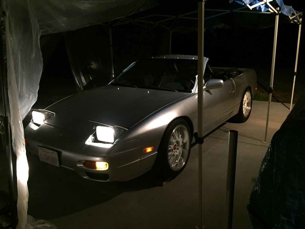

The day is here...let's paint this lady
i went to the 99cents store and bought 3pc drop cloth (12x9ft) to close the canopy
floor getting some wet so paint will not fly
it took me many hours but its DONE!!
so i did some celebration lol

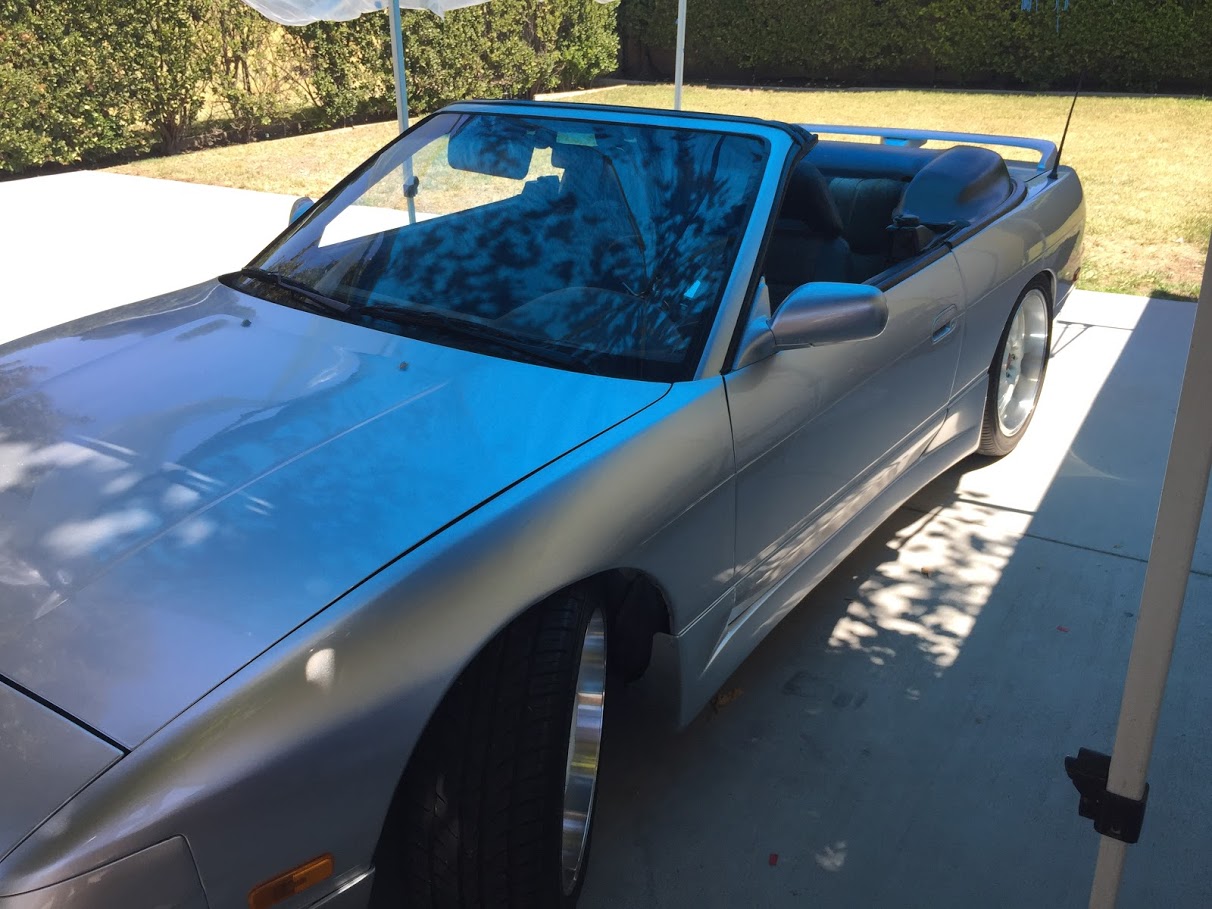

And after i woke up i found the real color.. WOW
And start dressing her back again!

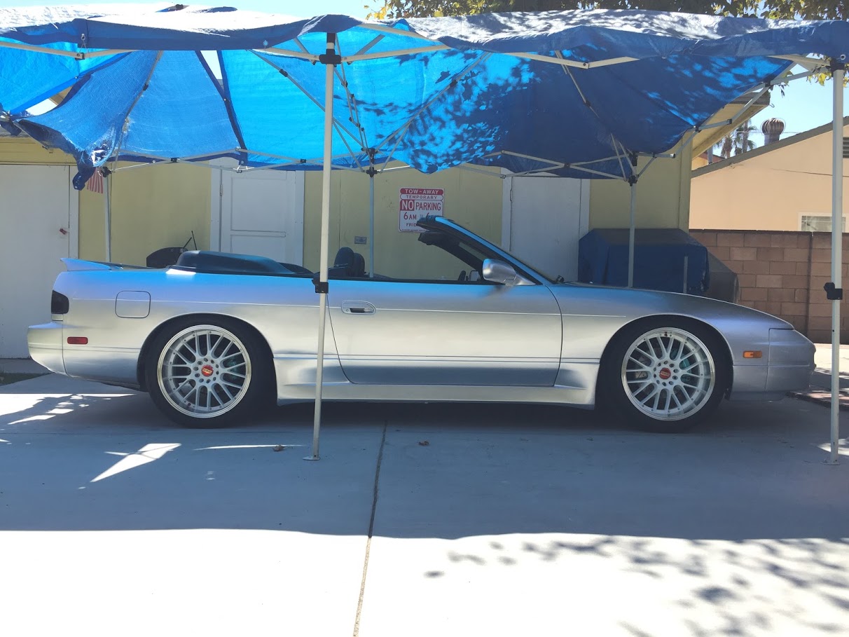

1st time under sun
But there was one thing that i still have to deal with..
CALIFORNIA SMOG
Yes, after 6 months working on this car now i have to smog it so i can register
i did a test and fail because to much carbon into AIV/EGR/Manifold and had broken/worn hoses
so i take all appart and clean it, then added some CRC Guaranteed To Pass Emissions additive to gas tank and 1/4 full tank
took my car to a very late night ride (3am) 2 days to empty tank
and then...
SMOG PASSED !!

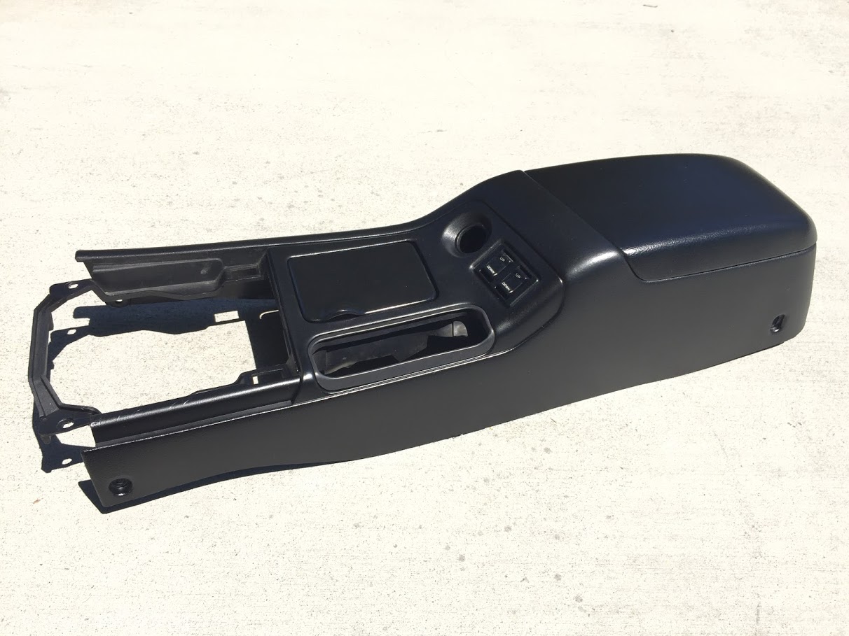

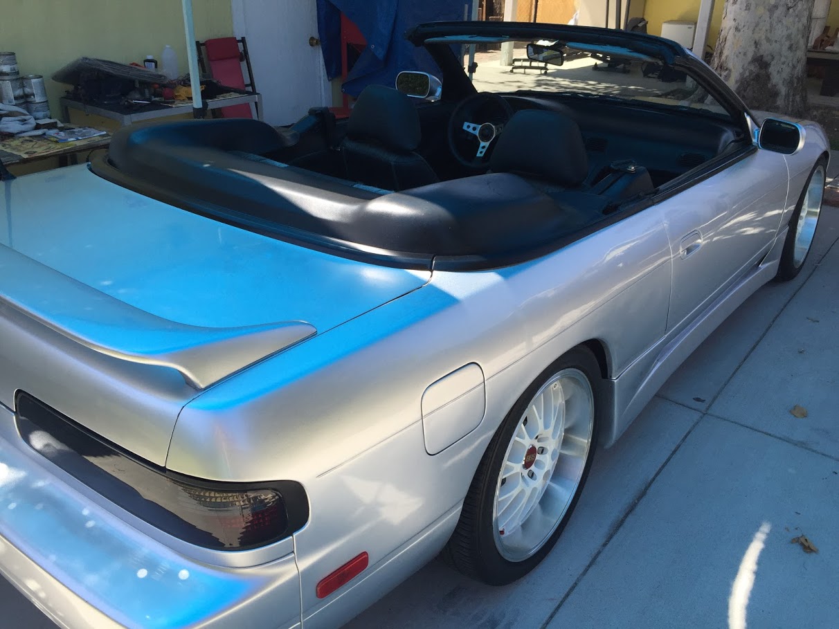

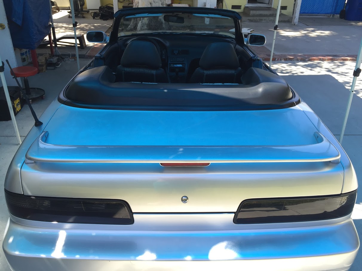

Next thing change ugly blue cluster lights for white leds
Give the boot cover a better look
vinyl was pretty dry, Back to Black from Mothers works pretty well on this and the whole interior
Alright.. paint came out good but null
that was because too much wind when added the Clear coat
and gun had to much or low presion (i dont know, i told u that i dont know how to paint)

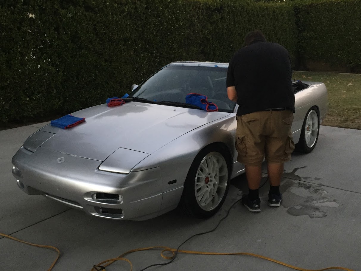

But the clear coat was there...so i contact some guy i found at Craigslist (with FB so i saw his prev work)
he showed up and we 'tested' paint surface, first he did some polished but Nothing changed...
then i Sanded with 800/1500/2000 leaving surface null but smooth and he polish over and.. BAMM!
impressive finish
That was the trick.. removing all the orange peel to then polish over it and the mirror shine appear
So next step was sanding the whole car with 800 to remove orange peel
and then 1500 to smooth the 800 lines and then 2000
break
And 2 days after he come back
oh damnnnnn... i started to see some image reflection!
And after that i manage to put all parts together because everything i did had a Redline date..

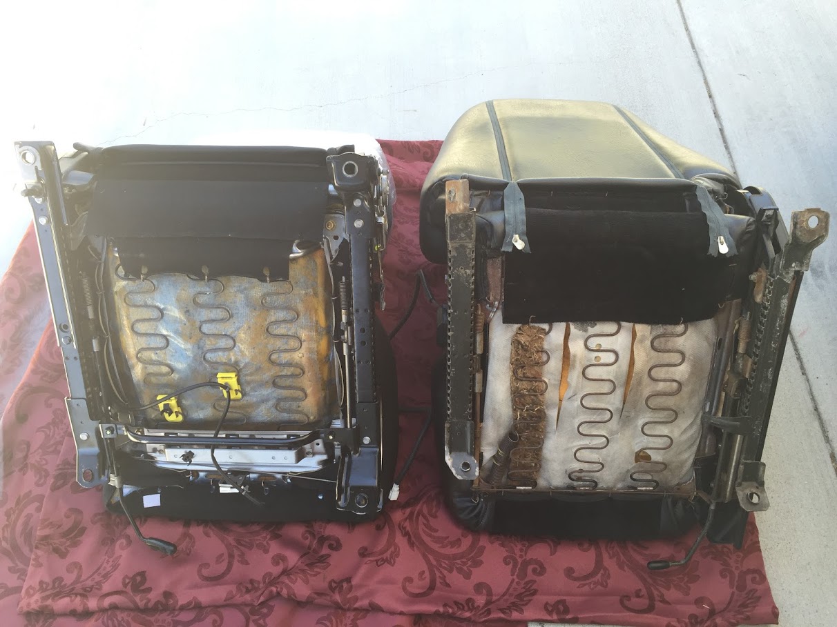

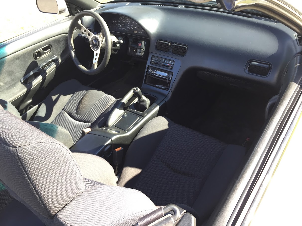

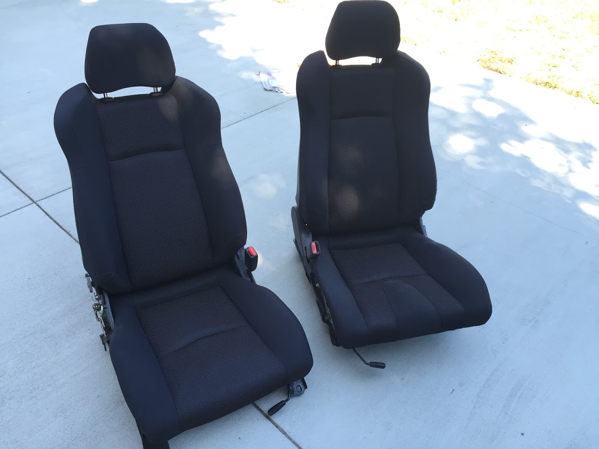

I found some Seats at the junkyard
wooohoooooooo!!
After some TLC
Comparing these seats is impressive.. make old ones looks like a joke
checking what i need to make them fit into my S13

Done.. Cut & Paste
Testing Fitment... ALL GOOD !
