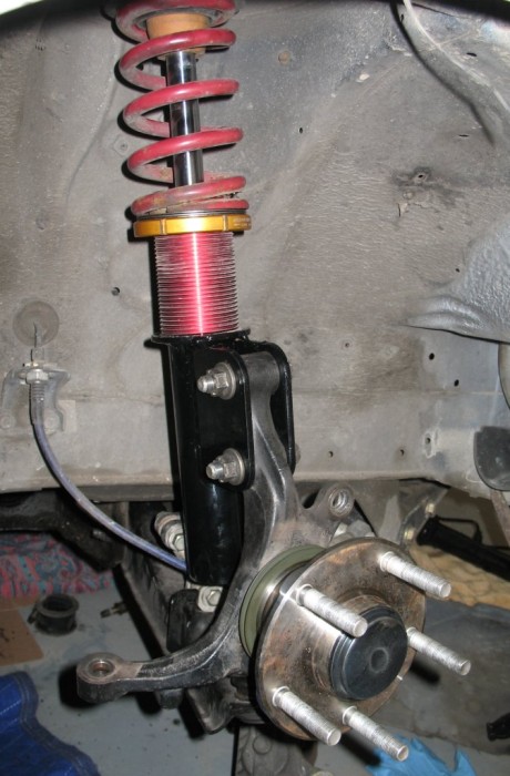

heads up for people putting the GC sleeves on
GC supplies some rubber bands that you wrote around the housing and create friction between the housing and the sleeve to hold it in place. Not the most technologically advanced system.
On one side, the rubber band has slid out of place so my sleeve is moving a bit. I don't think it's a huge problem, but I still have to get around to fixing it. I'd have to crack open the locking nut on top which means taking the whole thing off the car.
That and i need to get around to getting helper springs

Just use a few wraps of electrical tape until it's tight. Adjust your springs down and you can do a wrap of tape by lifting the sleeve up.

Like this... these are richards housings with Koni 8610's in them.
The two caveats with this setop (IMO) are lack of separate lower perch adjustability, and the clunking issue due to unloading and reseating.
The rears can go pretty low, and with the right spring length you will have pretty good adjustability out back. As for the clunking, I live in a pretty rough area and never hear clunking, even over uneven railroad tracks at speed, so I just don't see this as being an issue.
If you REALLY want to do something about it, just install a tender spring and be done with it.
Those look like the dampers go all the way to the bottom of the housing. Do they? Or can you shorten them up a bit?
Wondering the same thing for the fronts, and how close the bottom of the housing comes to the lower control arm.
yep, the struts go all the way to the bottom.
Here's the best picture I have... they are close to the LCA, but I do have enough room under the housing to adjust compression.

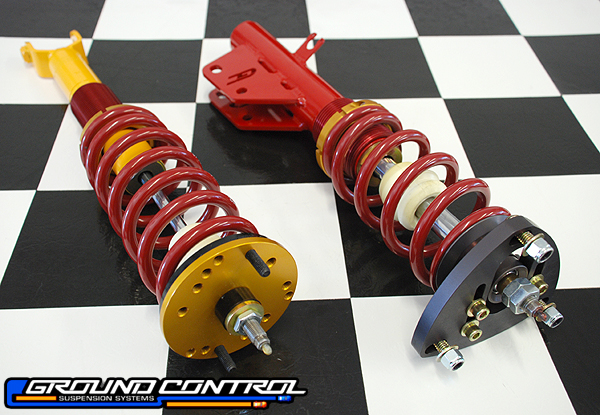

Ground Control complete kit for S14
Sorry for the thread necromancy... I'm still fighting with the crap on my car and I want to get it resolved.
I found this today. I don't know how long it's been around... I checked on GC's site some time before the holidays in 2009 and don't remember seeing it then, so it's relatively new...
Ground Control - Complete Kit - Nissan 240SX (95-98) S14
I see threaded sleeves and height-adjustable lower perches, upper perches, front pillowball upper mounts / camber plates, and an adjuster on top of the rear shaft (unlike my OEM replacement Konis).
It doesn't look like the rear upper mount has any articulation (it can't tilt - ?).
How does this compare to OptionZero's custom setup?
Edit: I just emailed Ground Control for more info, including a list of parts included in the kit, and questions about the upper mounts. I'll try to remember to post their response when I get it.

Wow that is really good find!!! Not much information on this but I wonder if these are the double adjustable 8611s.... because this thread talks about using the correct 8611 shocks... I hope they are....

strange that they would sell it @ 1700 w/out any specs whatsoever.
my guess is that they're just using the ots Koni yellows, & not the nicer, double adjustable 8611's
(which is really more than sufficient for prob 90% of us, including myself).

I am currently piecing together a setup and wonder what you guys think of this coilover-sleeve setup- 90-97 Mazda Miata EURO Style Coilover Kit 331090 : eBay Motors (item 160417693900 end time May-25-10 14:26:48 PDT)
I wondering if the upper spring perch on those look usable? They are flat rather than conical like I see on other setups. And the tender/helper springs? For the rear? What difference between the two? helper only "holds in place" and tender preloads?
Would the spring seperator/perch( between spring and tender-spring) work as a torrington bearing? or I would still need them? Put tender spring above the main spring? and torrington bearing below everything? or?
Have= 9k/7k stance springs in 7inch and front tein camber plates.
Need= shocks, housings, misc (bushings, torrington bearings etc), and coilover kit/upper spring perches, and rear top hats.

We're talking about 2 separate things here: the upper spring *perch* (which keeps the spring centered around the shock shaft) and the *mount*, which should allow the shock to pivot independently of the spring.
Take a look at this.
Autocross.dsm.org - Build Your Own Konis
In case that link doesn't work, here's the first picture hosted on Tinypic:
This is what the top of a coilover *should* look like. The upper perch is separate from the mount. Most coilovers have pillow ball joints in the upper mounts.
I bought an OEM-style set of Koni yellows, and used them with Ground Control sleeves and stock upper mounts. The front Konis are probably trashed; when I raise the front of the car and take the wheels off, I can see shock oil dripping out of the tops. The shock shafts may be bent and/or the internal shim stacks and valves may be destroyed. The most likely cause is the lack of articulation in the stock upper mounts.
Don't do it that way.
If you could rig a real upper perch on top of a Koni yellow, and then bolt it up to a Tein pillow ball mount, that might work. But the Koni yellows, plus the Ground Control kit (sleeves + perches + springs) cost me as much as a set of Stance GR+ Pro coilovers. The amount of frustration that I went through just to put the front shocks together wasn't worth any possible cost savings or performance improvement vs. a set of pre-assembled coilovers.
I would say that torrington bearings aren't required, but they will probably reduce squeaking and they will make the springs behave better.
The upper perches in the eBay auction you linked to are functionally identical to the perches that came with my Ground Control kit. They *might* work if you could secure them to the shock shafts properly (which I wasn't able to do with my setup). You don't want the upper perches to move around on the shaft at all.
Helper/tender springs are supposed to collapse as soon as any force is placed on them. Their only purpose is to keep the (main) springs in contact with the spring perches, so the springs don't bounce loose from the perches if the suspension is unloaded (for example, if the car gets airborne).

I missed the bit about camber plates for some reason. The Teins are fine but you still need some real upper perches, like the Vorshlags that OptionZero recommends in the first post.
Honestly, I would either copy OptionZero's setup as closely as possible... or just buy some coilovers. The only thing I didn't like about my Stances was that even at the max safe height, they were too low for me, considering the roads in my area.
Something else I have realized about suspensions: Don't assume that stiff springs and/or low ride height will cause an improvement in handling. If you want your car to feel planted through corners or while drifting, you should probably look at anti-roll bars (sway bars) and shocks first.
You can use the OEM-style Koni yellows with stock springs. You'll have 4x4 fitment, but your car will ride better than it would with the stock KYB GR2 shocks. However, the Konis don't come with lower spring perches like the GR2s do; you have to cut apart the stock shocks and shove the Konis into them. If you fabricate stuff on a regular basis this would probably not be a big deal for you, but it was a pain in the ass for me. Oh, and the rear OEM-style Konis can't be adjusted while they are installed on a car. Again, either go big (OptionZero setup, Koni double-adjustables with the correct upper perches and mounts) or go cheap and get Stances or something. The middle ground isn't worth the hassle or the perceived cost savings.
