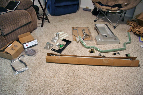

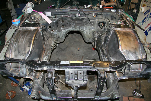

Ok, so here are some of my pictures finally:

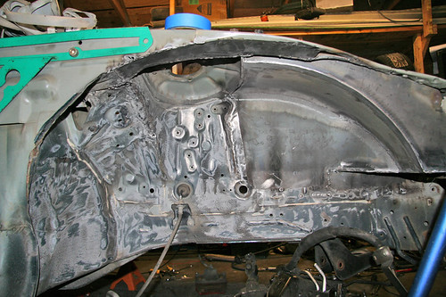

Engine bay before primer/paint:

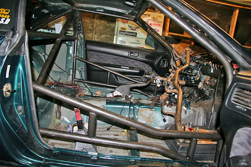

Door bars right after they were tacked in place:
Somethings missing?

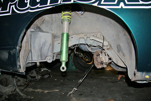

You can see just how much extra room there is in the fender wells now:

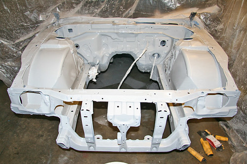

Engine bay after primer/sealer:

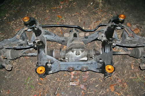

Powered by Max Subframe Risers installed!

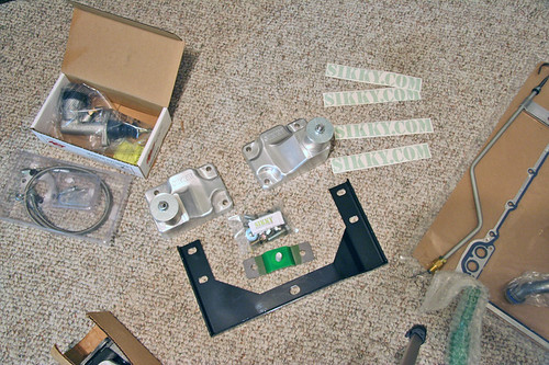

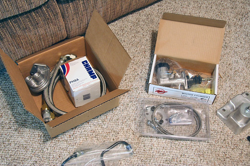

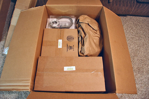

These goodies arrived in the mail about a week and a half ago:
Everything was packed extremely well:
I'm very pleased with the quality of all of the Sikky parts. Considering they they offer CNCed motor mounts and excellent craftsmanship the Sikky kit is extremely well priced and nearly makes the swap a bolt on procedure.
Check out their website here: High Performance Auto Parts :: SIKKY Manufacturing

the dipstick they offer. is it basically a drill and tap affair? nvm their pan has a bung for it.

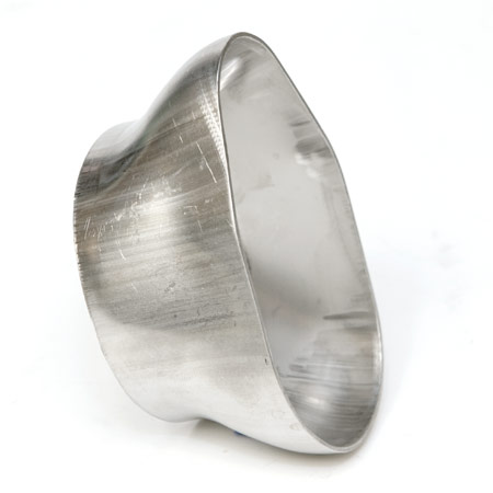

I was hoping I could run the Sikky long tubes, but they hang down a little past the frame rails. I am running some shorty headers they used to mock up for their long tubes though. They're just hooker block huggers with 3" tubes coming off of them that go around the steering column.
I am going to make a 3" oval Y-pipe and I haven't decided if I want to tie it into my 3" Trust DD I have sitting in my living room or if I should sell that and make a full oval exhaust so I don't destroy the DD.

OH and Atpturbo.com has the 3"v-bands and 3"round to 3"oval. WOOT
