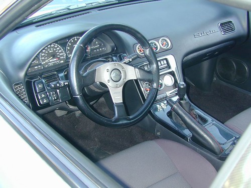

After sitting like this for the last four years, I started following Pstl_Pete's modified magazine articles and then also found Broadfield's build thread here on Zilvia and got the desire and inspiration to rebuild the car and start enjoying it again. The reason it had sat there for so long, was due to many things in life, but the smog and registration issues every year became too much of an issue to deal with. Pstl_Pete showed an easy way to get a hassle free smog legal solution, so I started gathering info and parts a few months ago.
Untitled by gnakata2007, on Flickr

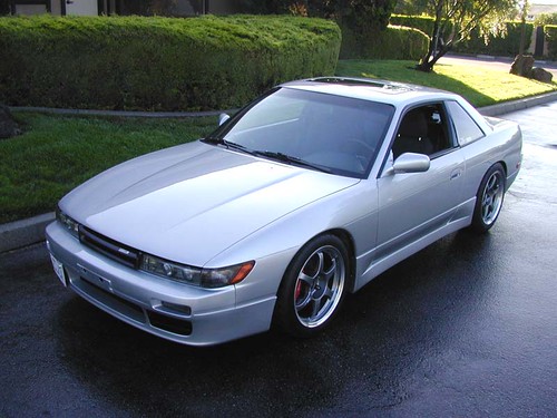

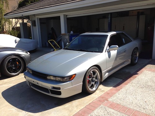

Here is the how my S13 looked before it went into its 4 year hibernation.

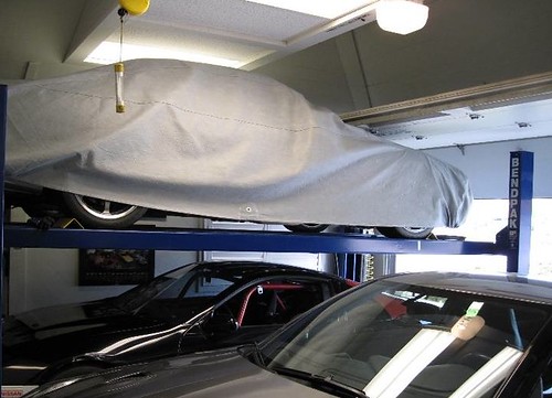

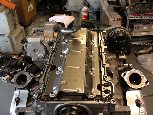

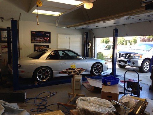

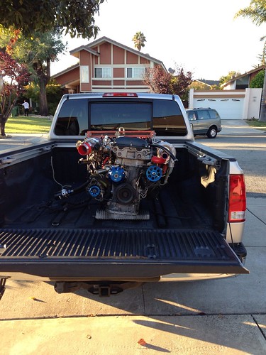

Thank goodness the lift still worked as I installed the lift, put the S13 on it and raised it and did not touch it till this day
SR on its way to my buddy's house to get installed in his Datsun 510.

Nice to see the light of day after 4 years.

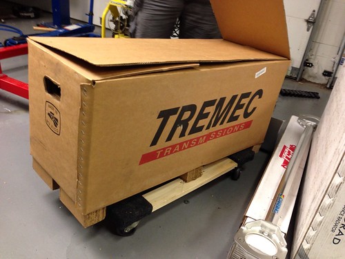

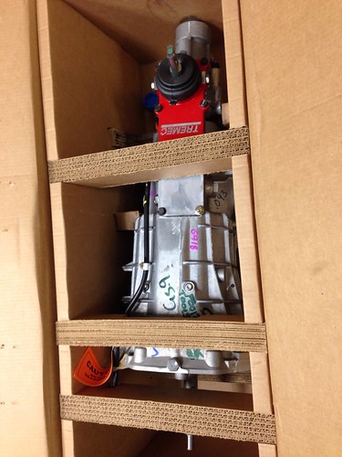

Got a new T56 Magnum for a good price from a local guy here in NorCal.
[IMG]
Untitled by gnakata2007, on Flickr[/IMG]
I have to figure out what shifter to run as the T56 Magnum shifter sits 4" forward of a normal T56. Maybe a Sikky or one that the guy who sold me my transmission is using in his FD.

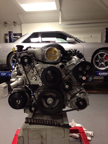

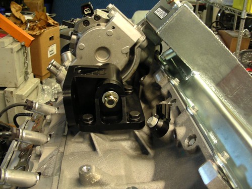

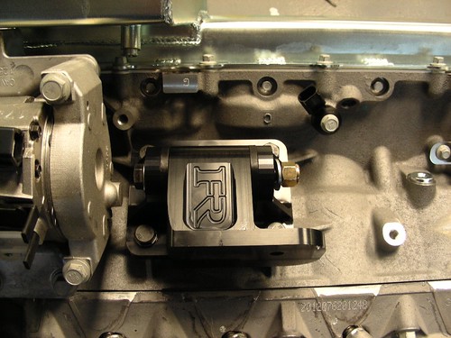

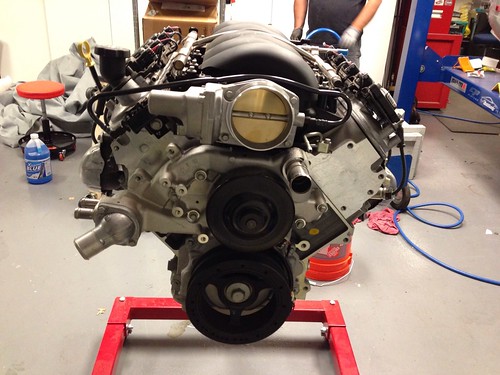

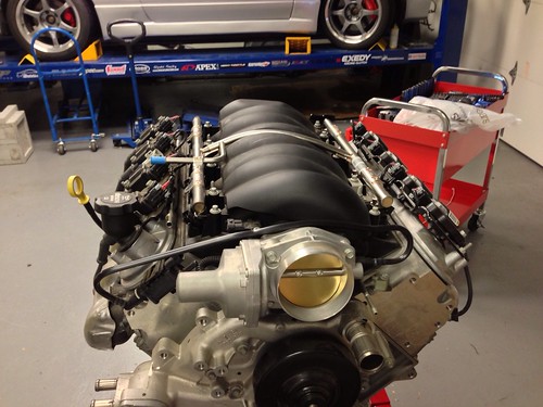

Got the LS3 Erod on the engine stand.
[IMG]

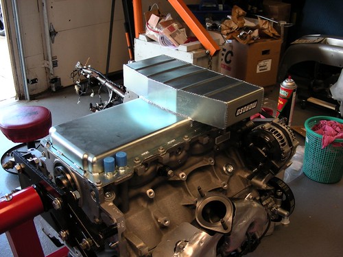

Flipped the fuel rail 180 degrees so that the fuel line has a straighter shot to the fuel rail. The guys at Fueled Racing suggested this for their kit.
[IMG]

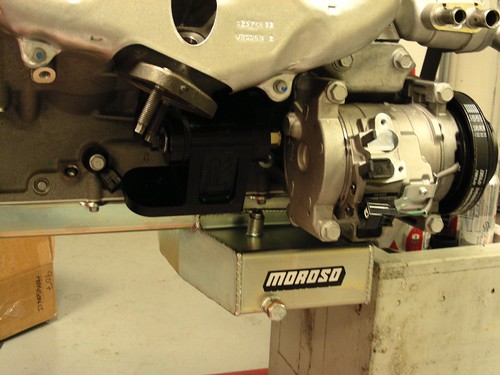

Using the same CTS-V accessory setup as Pstl_pete

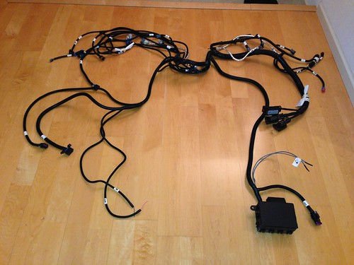

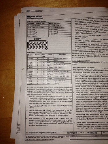

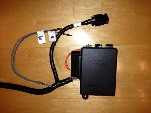

Engine harness and fuse box that comes with the E-rod crate motor. Everything is labeled for each connector.
[IMG]
One wire for the fuel pump and one for the electric fans. That bulkhead connector is to integrate into the chassis harness.
[IMG]
Bulkhead connector pinout.

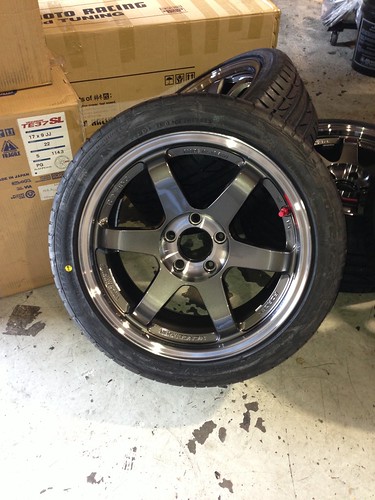

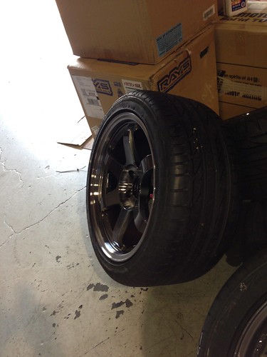

New 17" shoes for my baby. Very conservative size and fitment.
[IMG]
[/IMG]

A little update from today.

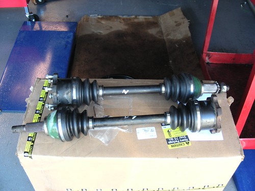

I had new boots installed on these Z32TT and Q45 axles for my Q45 diff swap. I made a mistake last time when I first built the car. I just installed the axles and after a few thousand miles, the boots broke and there was grease all over the underside of my my then recently cleaned and painted chassis.

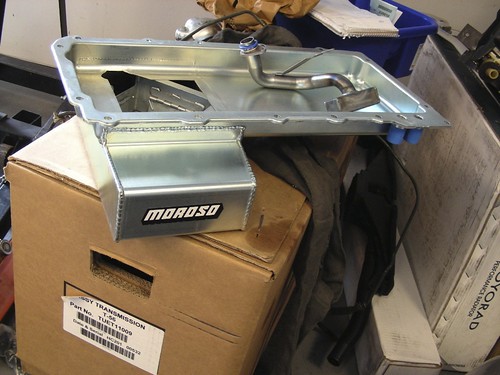

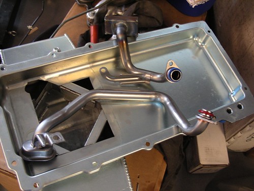

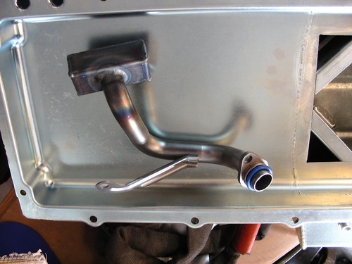

Moroso pan and modified oil pickup from the Fueled Racing swap kit
Moroso oil pan from Fueled Racing Kit

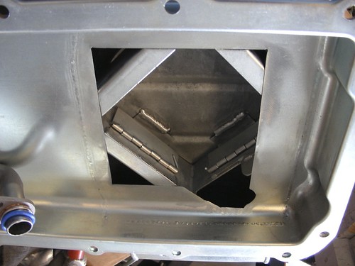

Moroso oil pan baffle doors
Here is a comparison shot of the stock versus modified Moroso oil pickup
Stock vs Moroso modified oil pick up

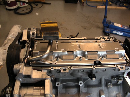

Moroso oil pickup installed
Modified Moroso oil pickup installed
Oil pan installed and buttoned up
Installed Moroso oil pan

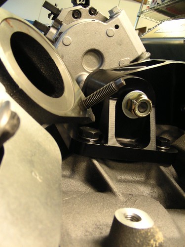

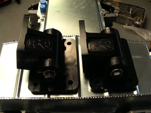

Motor mounts waiting to be installed

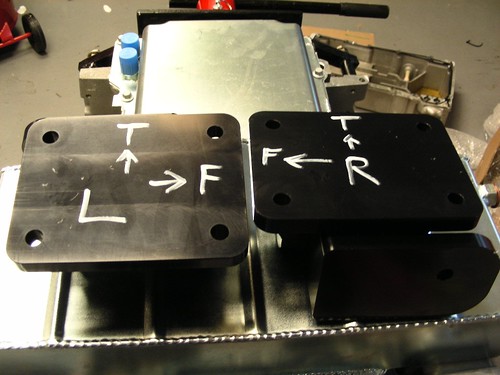

Fueled Racing adds a nice touch by putting labels or reminders on all the parts to make sure they are installed correctly. These are some reminders on the bottom of the motor mounts. All the fuel and oil lines have labels on the connectors to make sure they are installed correctly.
Passenger side motor mount
I had to remove the stock manifolds to install the motor mounts. I also ended up reversing the nut and bolt on the motor mount to be able to pull out the bolt later if needed while in the car.
Close fit between the motor mount and manifold exhaust flange on the passenger side. I actually had to do some minor grinding of the manifold and motor mount on the driver side. Nothing major.
Tight fit of motor mount on passenger side
Oil pan and motor mounts installed.
Motor mounts and oil pan installed

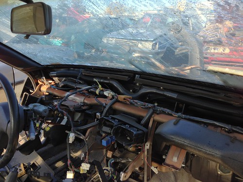

A few weeks ago, I found this 240 in the junkyard and removed the entire HVAC system so I can install in my car. I literally took everything against the interior firewall except for the steering column.
