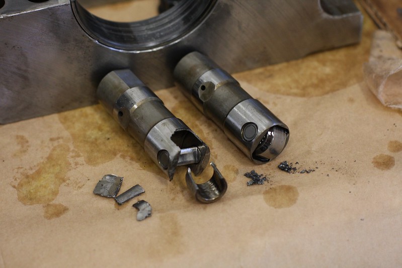

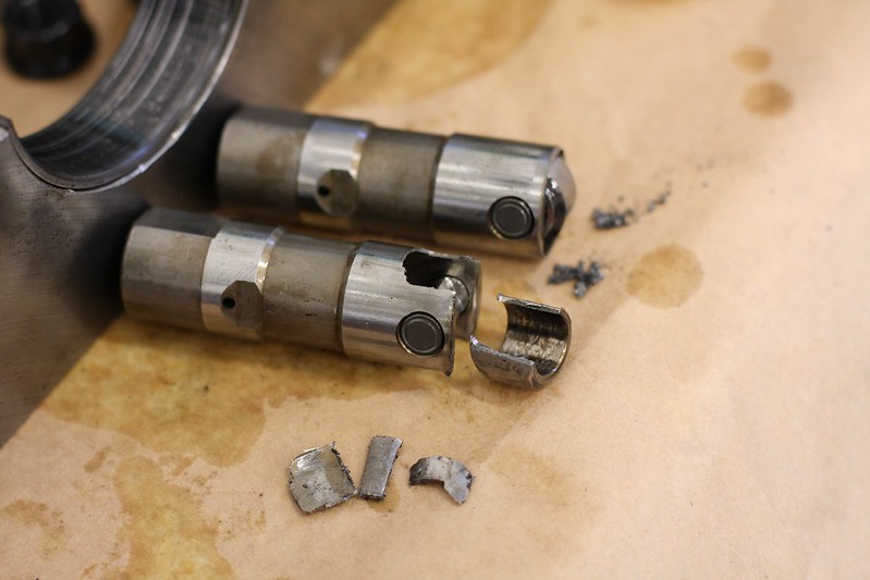

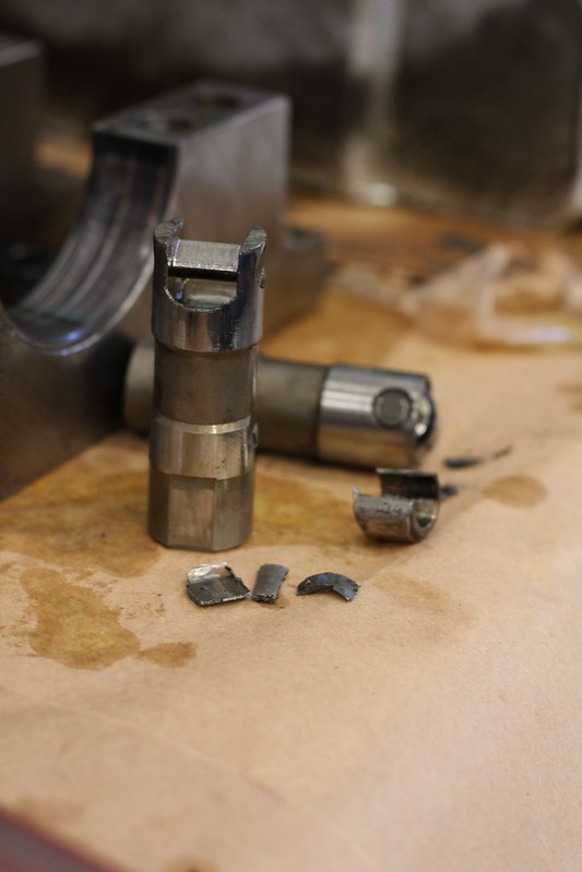

Which lifters are those? If LS7, throw them in the garbage.
This is one of my LS7 lifters that was paired with a Comp cam. And I was not alone. Multiple threads on LS1tech with the same lifters. Hopefully you used something different but if not, I would swap them out.
