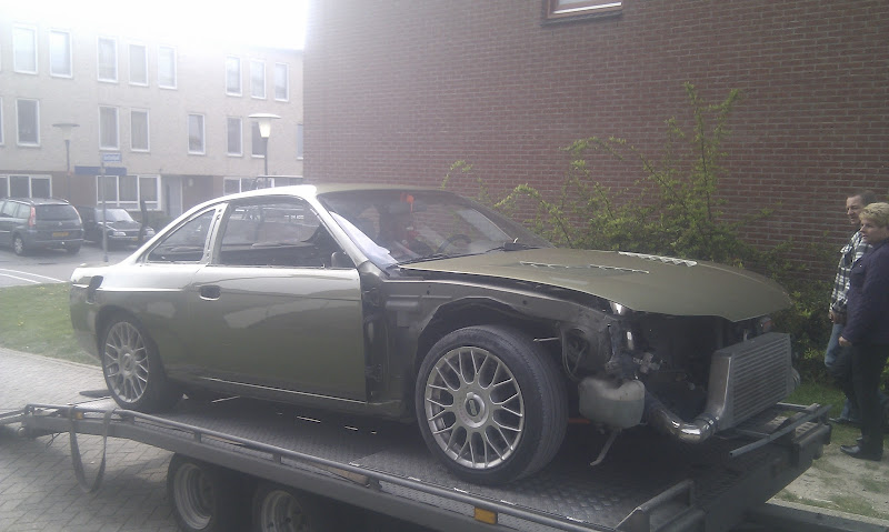

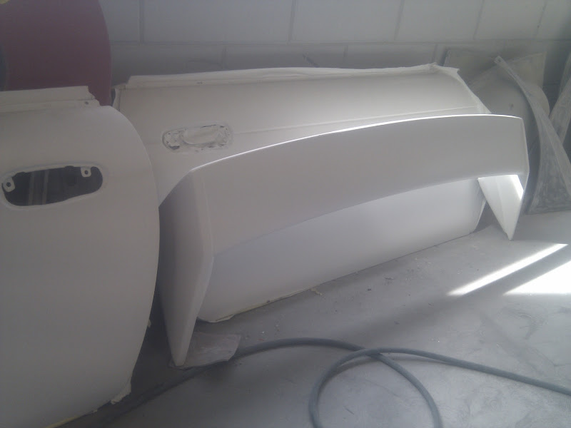

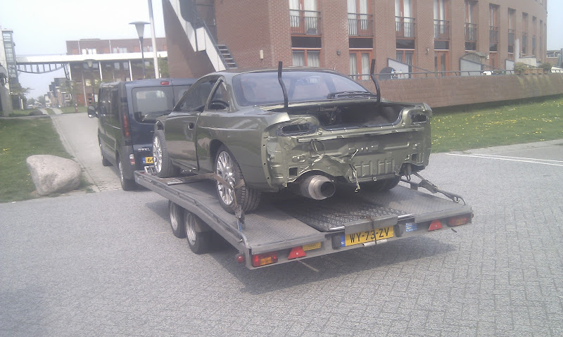

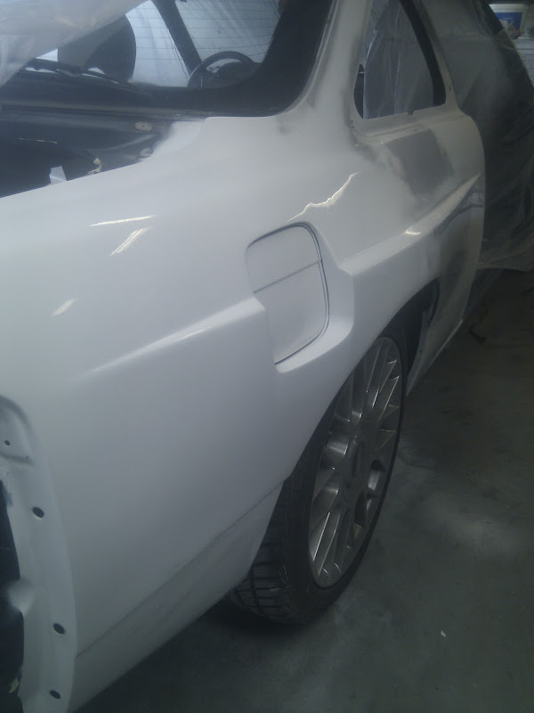

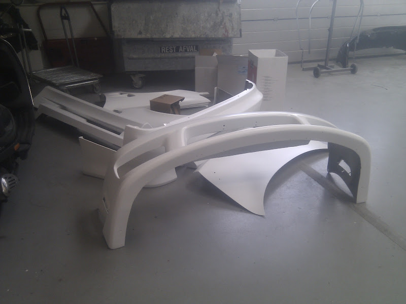

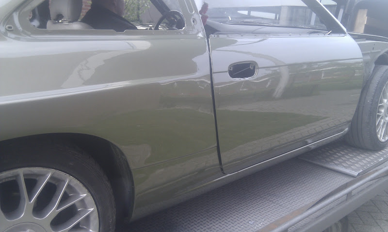

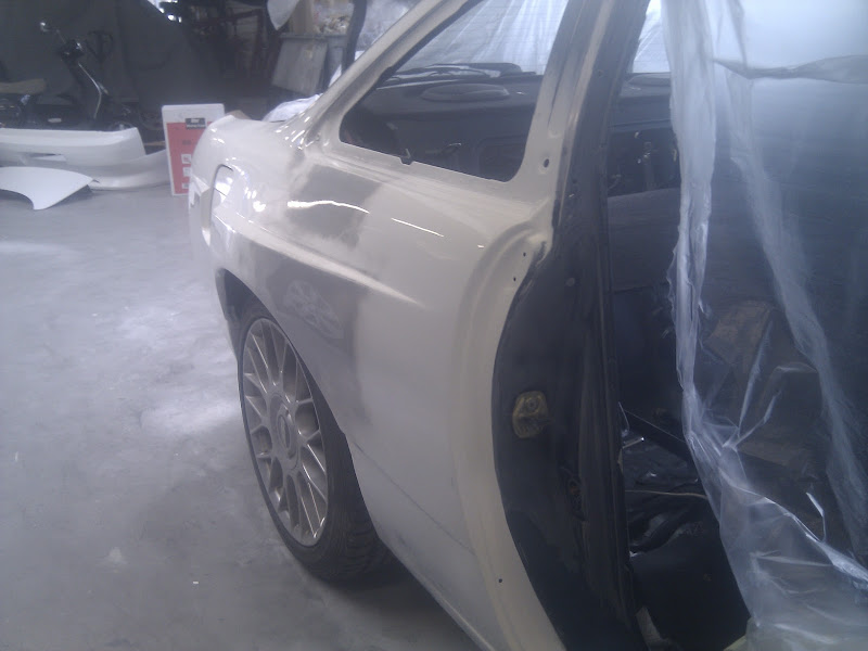

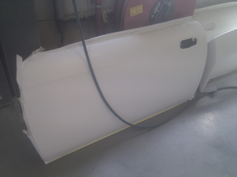

Finally a small update. I bought Origin fenders but they seem +20mm. So they're the same width as the Chargespeed ones. Oh well...
I also had S13 lower arms fitted as they are 10mm shorter than the S14 ones. Camber bolts were also fitted to increase camber even more if necessary. And last but not least my Drifworks toe rods were installed. And my car is at the paint shop right now: ![]() ![]() ![]() ![]() ![]()

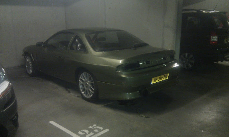

I will eventually, but not right now. I still have to find one I really like, but it's nog top priority right now. I still want the handling to be sorted and perhaps a power upgrade with larger injectors, etc.

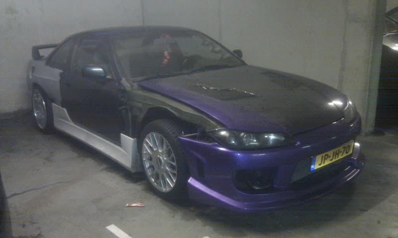

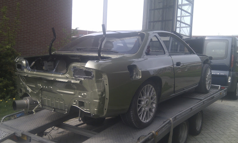

I finally received my car yesterday. ![]() ![]() ![]() ![]() ![]() Today I started rebuilding my car. I've fitted my front windows, trunklid, rear bumper, front fenders. Unfortunatley I only have a pic of the car in the dark. Didn't think of shooting one while the sun was shining... ![]() ![]()
