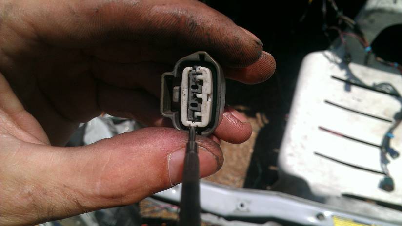

Anyone know if the qr25de and sr20det share the same coilpack connector?

Looks like it, quick google search shows us
SR:
QR:

I agree they look identical

Left is qr

The connector is the same for VQ V6 engines as well. It's probably a safe bet that all Nissans use the same coilpack connector. Pinout may differ slightly, but its the same connector.

You can use VQ coilpacks on SR if you switch two wires in the plug. They won't bolt down though but are better.

If you're going to go through the hassle, mind as well just go with LS coils.

It's not much of a hassle to move two wire pins.
LS coils require the hassle.

Agreed, flipping two wires on a connector is pretty simple. Plus don't have to fool around with dwell settings, etc. LS coils aren't some magic bullet, any modern coil-on-plug is an upgrade. VAG coil packs seem to be gaining popularity, and available for cheap.
