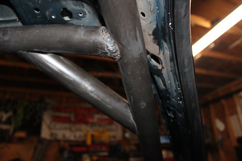

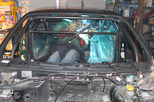

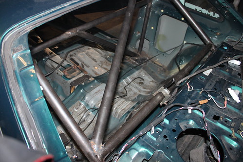

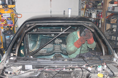

Some updates from my friend Danny:

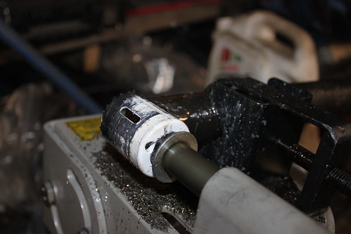

Cage is done, now waiting on my dimple dies to get here.

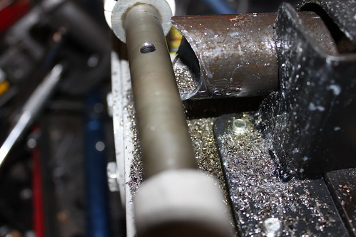

Harbor freight Notching. Not the best but it works well after a little touching up with the grinder
Plasma cutter doing werk

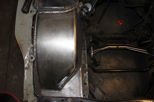

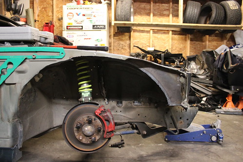

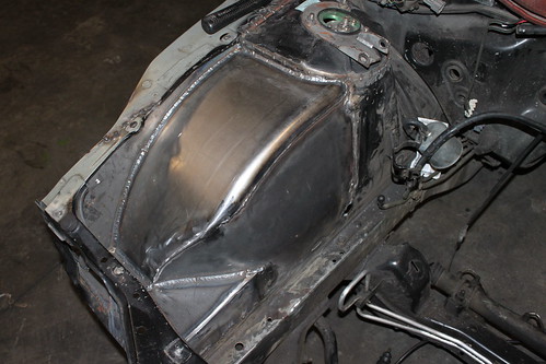

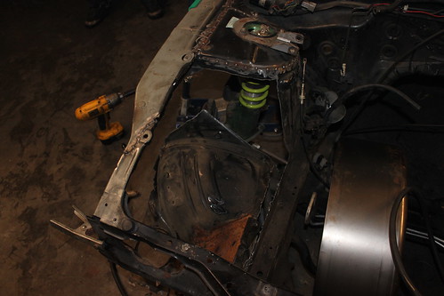

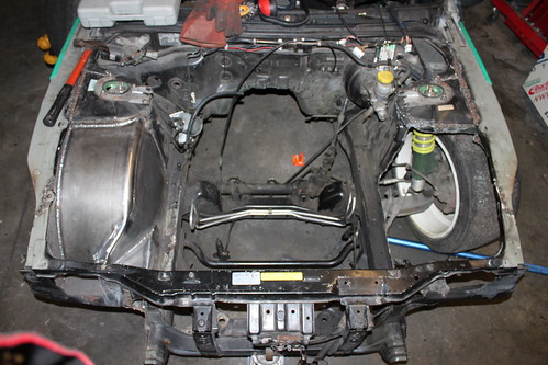

Put about 4 hours into one tub today. Damn that was a bitch. Now I have to make the other side match......
Im not done underneat, but you get the idea. Stephen plans to run this car super low on some rediculous size wheels and tire set up next year. We planned ahead and made up some clrearance to fit dunk ride rims on here.

wow that came out really good i bet it must have been easy with the plasma

I got to see these in person tonight, I am extremely pleased with them (they came out exactly like I wanted).
Big Big Big thanks to Patrick (sonomadrifter) for meeting with me at VIR and letting me steal his tub design . We used different dimensions to allow for a little more clearance, but the shape stayed the same.

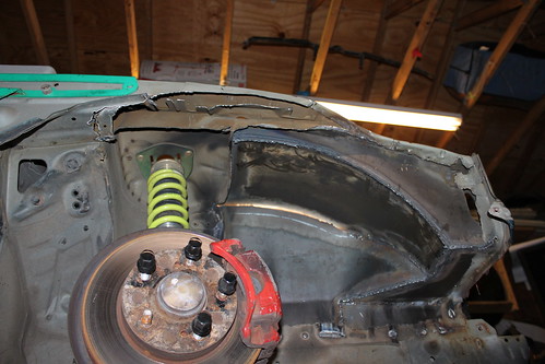

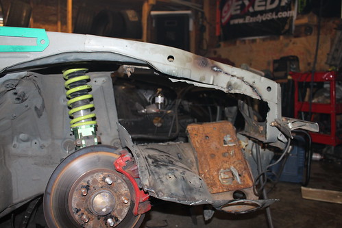

I see you actually are notching out the upper frame rail to allow more tire clearance. Thats the exact same thing that i was wanting to do to my car. What gauge metal are you going to use to reinforce it?

Im putting in 14ga plate back in. Im working on finishing that today.

Drill press on special from Harbor freight $59
Harbor freight hydraulic press $129
Ebay 4140 .75 dimple die $40
Dope Status Dimples

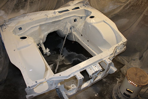

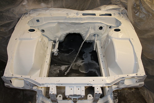

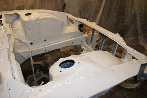

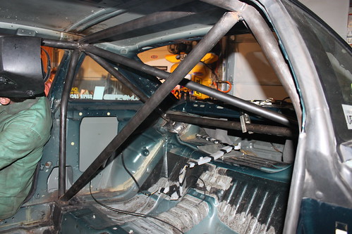

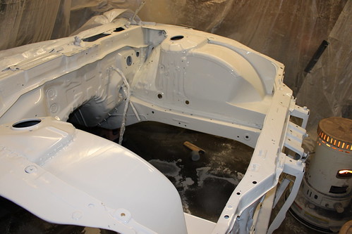

Bringing this bitch back
Toyota brilliant white.

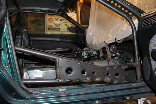

Cage Done for the exception of the inner gusset on the door bar
Engine Bay done
Suspension mods will be this week.
