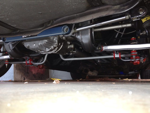

Not sure if you are looking for input, or just posting your work. Either way, here is the turnout on my rear end:
Had it powder coated for durability.
Member: Silver vein
Traction rods, LCA's: Titanium silver metallic
If anything, maybe it will spark an idea or color choice... and your booth is awesome!!!

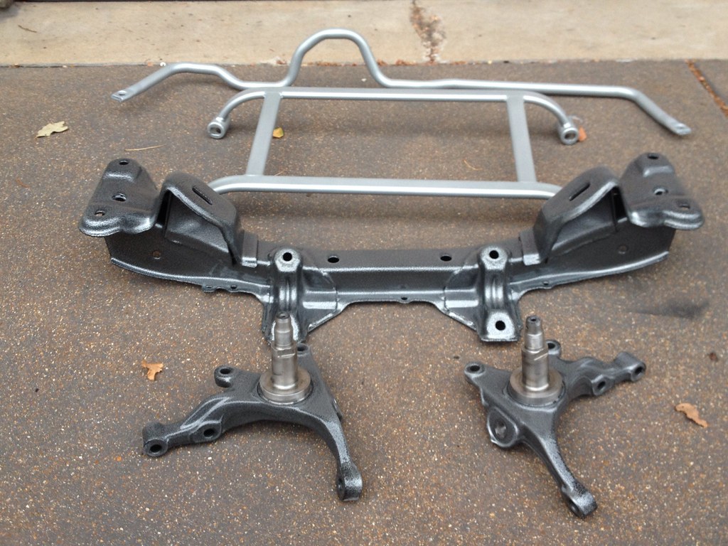

Oh, the powder coating cost me about 300 for the rear (8pcs) and about 200 for the front (5pcs). Expensive, but I love the way it all turned out~
The Front:
