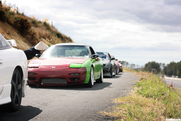

So I just realised I haven't actually done a proper build thread on here.
I used to drive this CA18DET piece of trash.

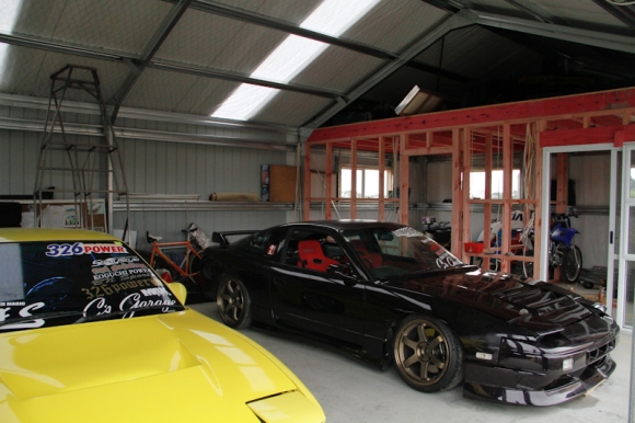

And just as I was about to finally paint it, this got parted out.
So I parted out my green car, snapped up the new rolling shell, along with a few other parts.

so you bought the c's garage type-x????

Yup. As a rolling shell.
