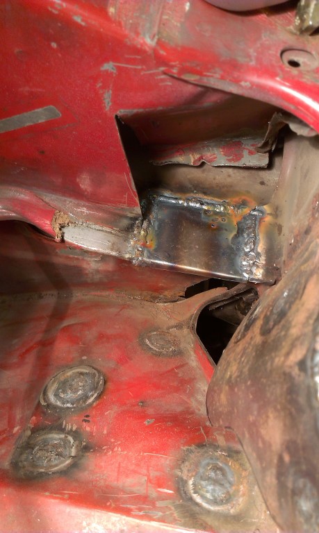

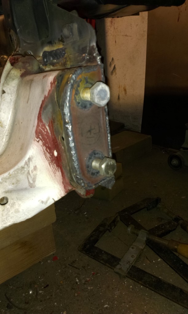

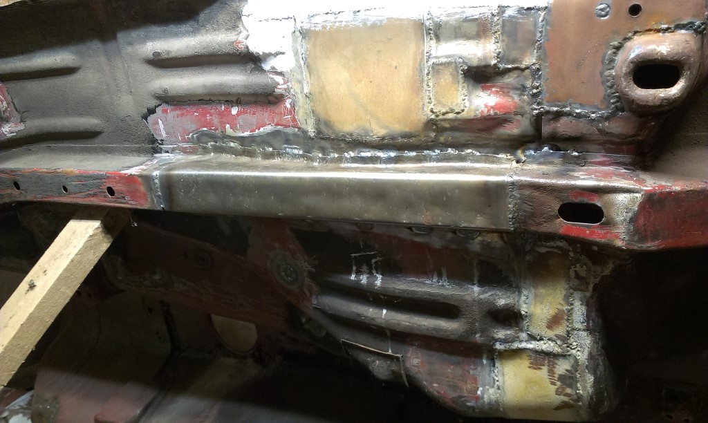

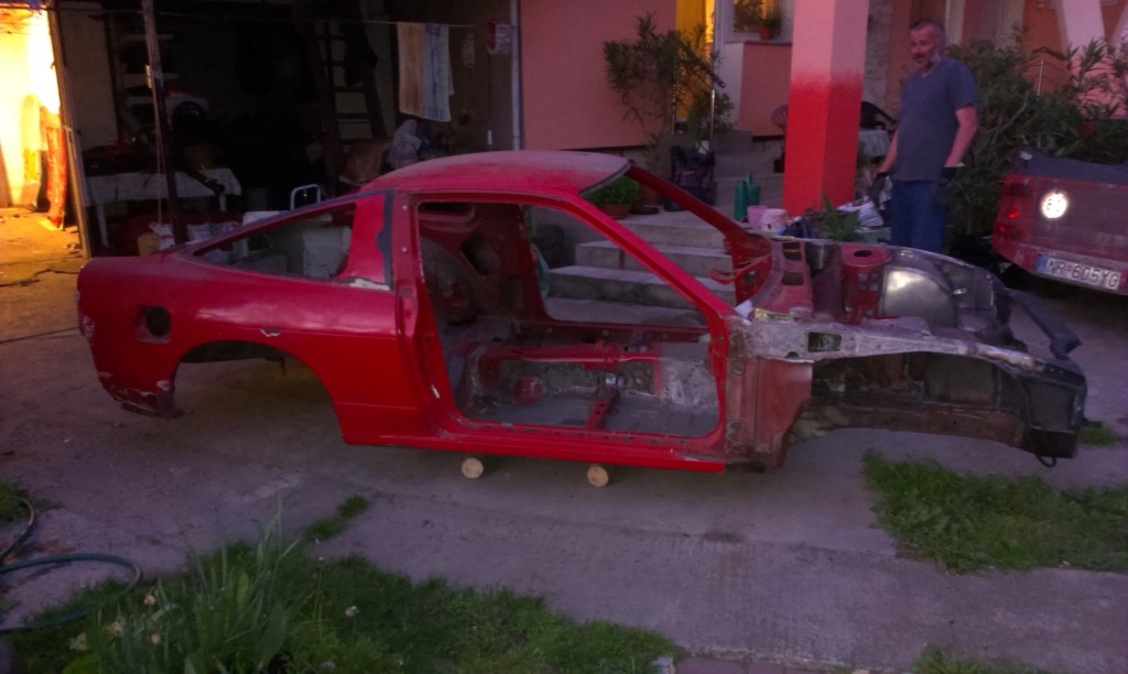

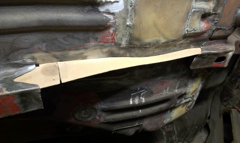

Fixed missing chassis rail

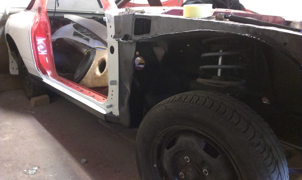

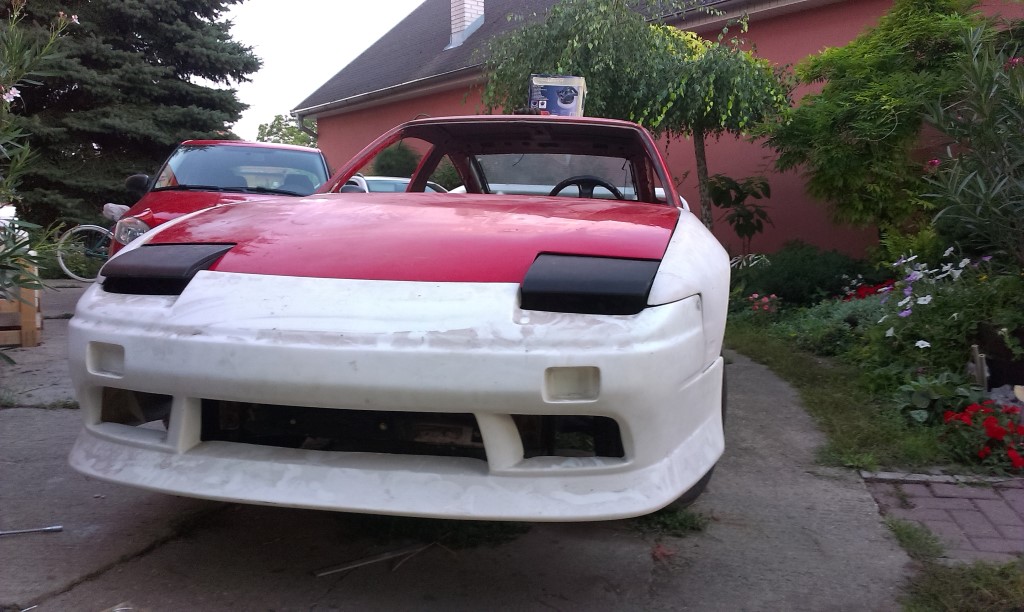

Change the front wall
The one side of chassis rails are pushed inside, so I fixed it.
And the new front is on the right place.

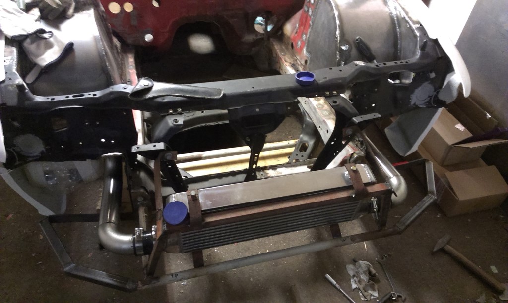

Old 04-23-2015, 02:20 AM   #71
TSSS22
Join Date: Feb 2014
Location: Slovakia
Posts: 83
TSSS22 has a spectacular aura aboutTSSS22 has a spectacular aura aboutTSSS22 has a spectacular aura aboutTSSS22 has a spectacular aura aboutTSSS22 has a spectacular aura aboutTSSS22 has a spectacular aura about
Originally Posted by brianglawson View Post
Great work as usual!!!!
Thanks

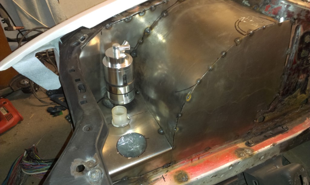

Fitted oil catch tank and relocated screen washer reservoir
Mounted custom hood springs from VW Polo

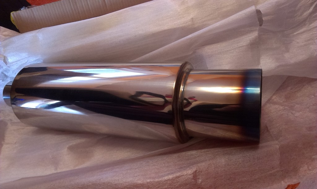

Apexi style exhaust

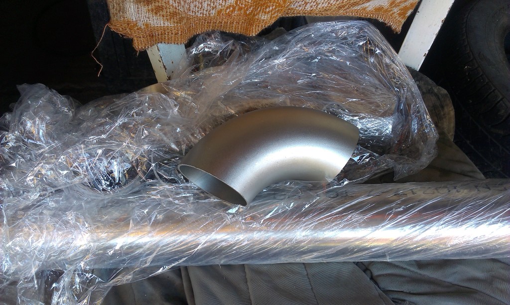

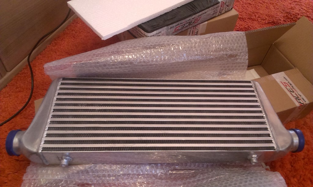

New stainless steel tubes for FMIC piping, I am using stainless steel because I have only DC TIG welder. Welding aluminium with this is not impossible but is more difficult especially with scratch start.
Purple lug nuts from United States
FMIC and other things
TSSS22 is offline   Reply With Quote

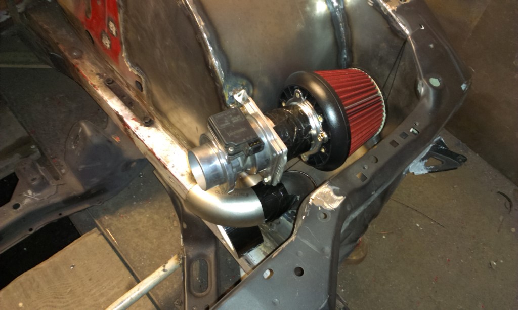

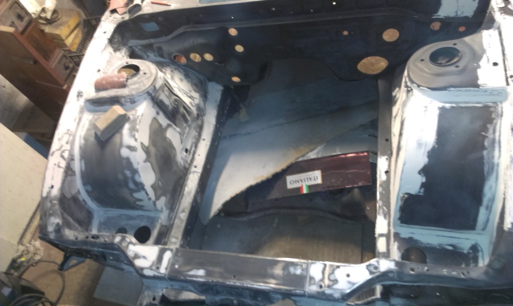

Works on enginebay are finished.
Airfilter holder
Tube fronetnd fabrication
Rear bodyworks

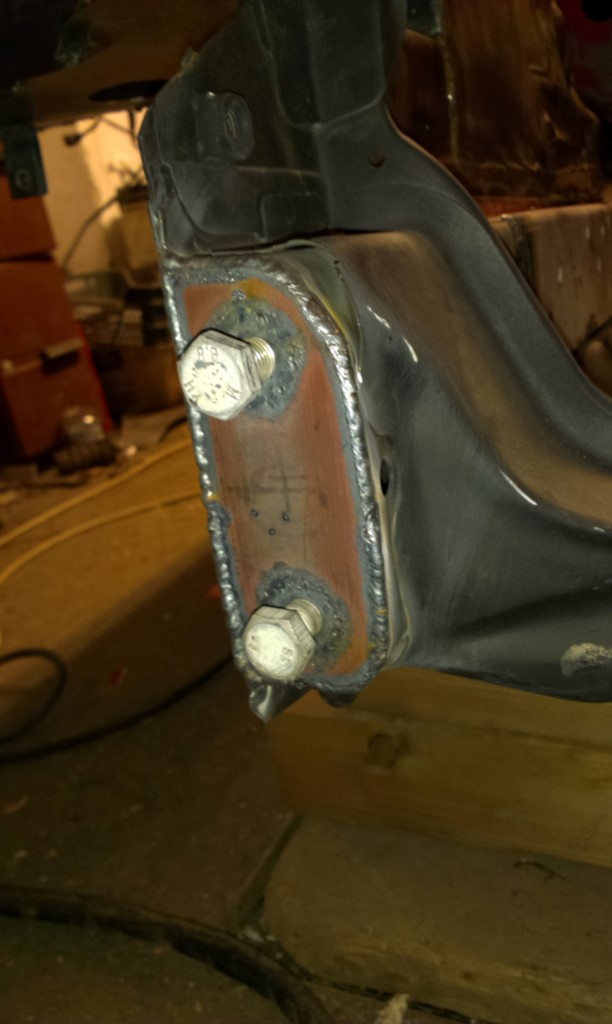

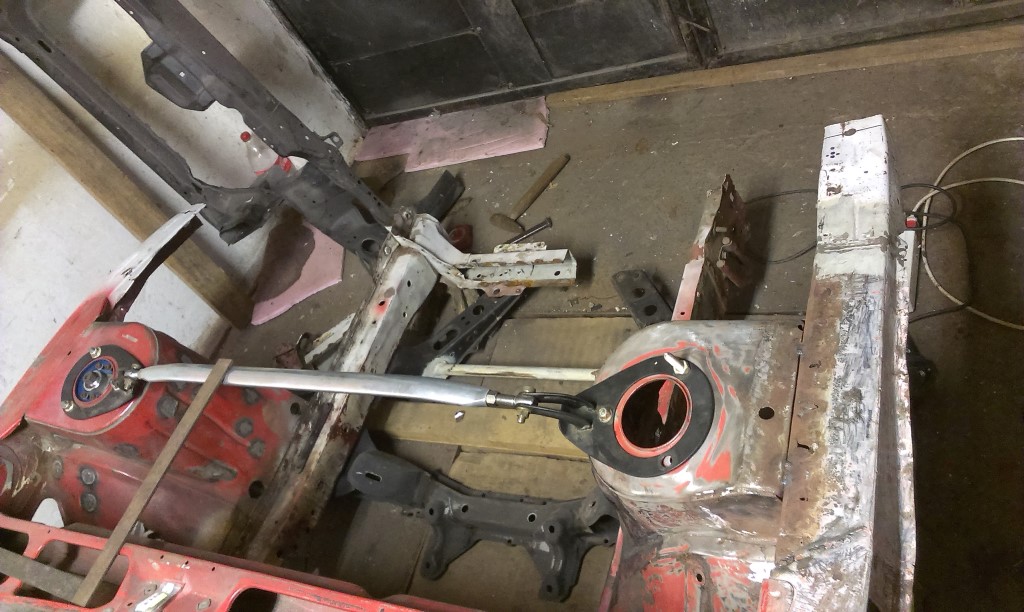

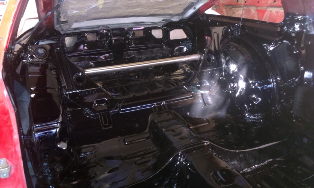

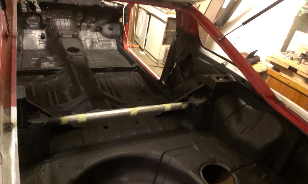

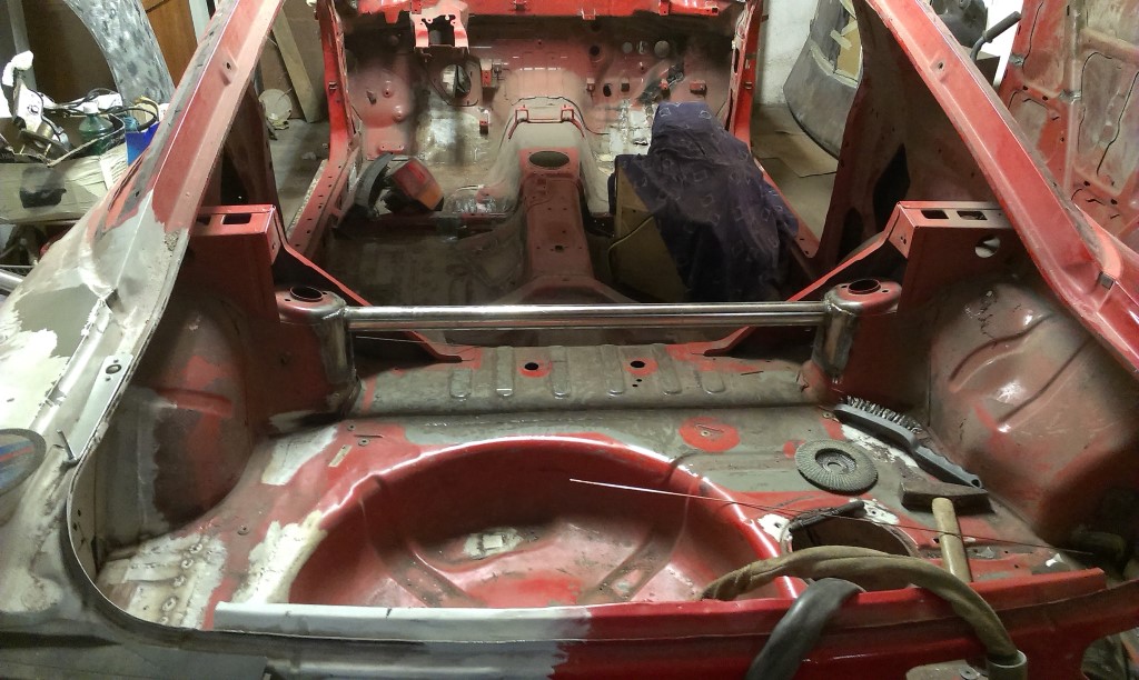

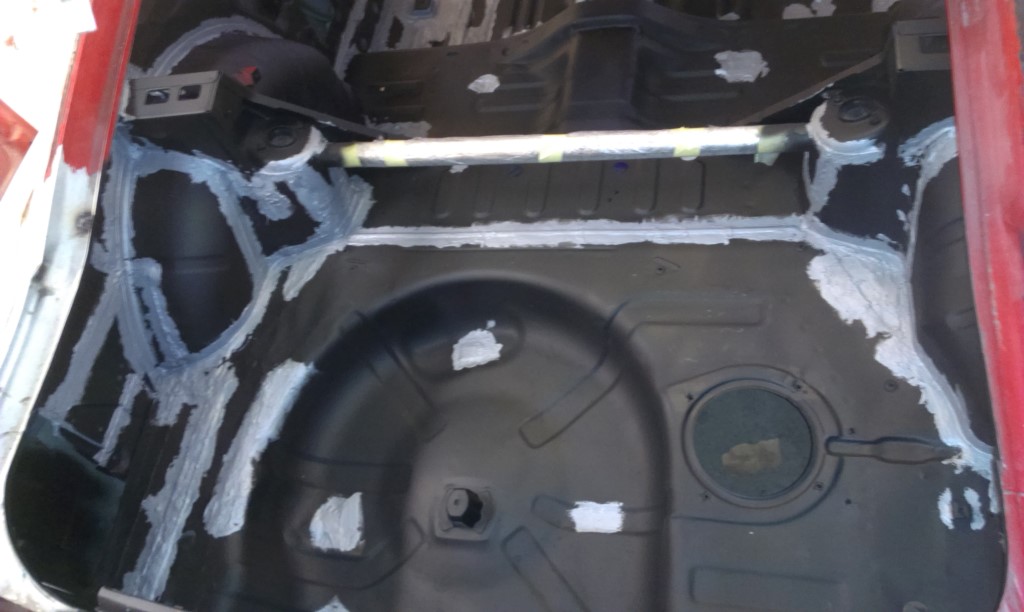

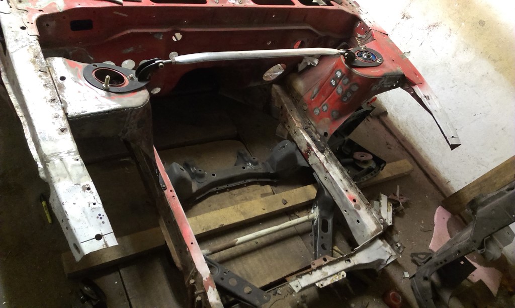

Welded rear upper suspension strut brace bar

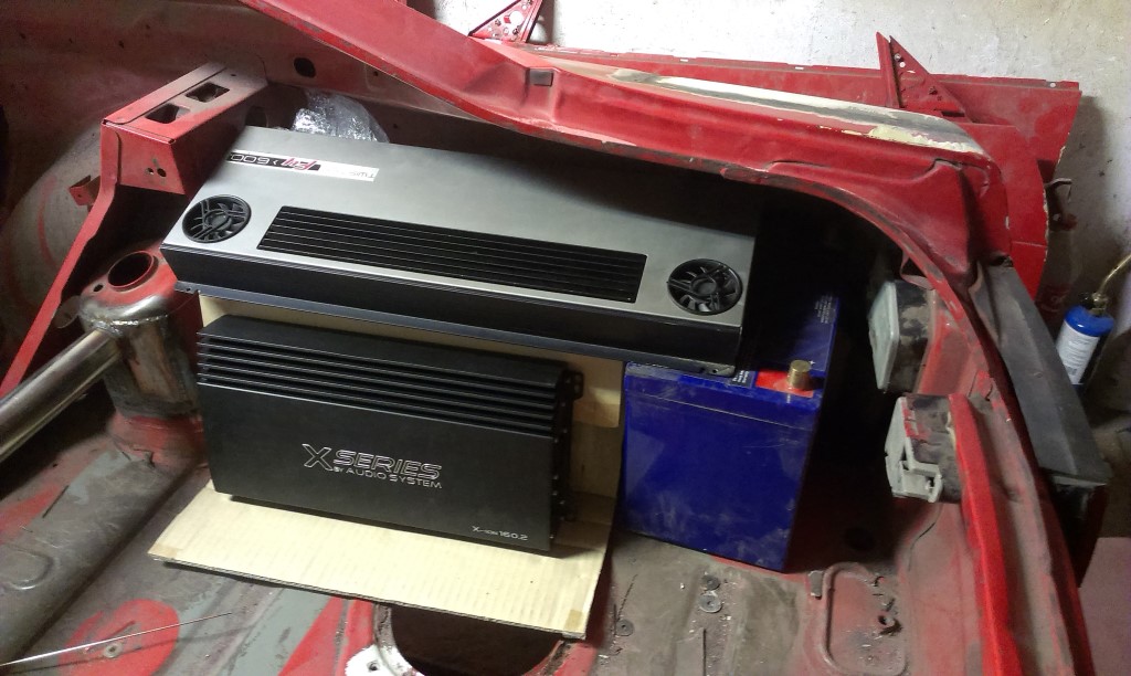

Battery holder

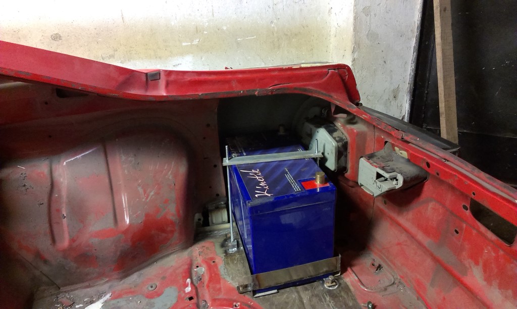

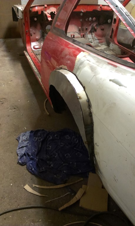

Old 07-14-2015, 03:20 PM   #73
TSSS22
Join Date: Feb 2014
Location: Slovakia
Posts: 83

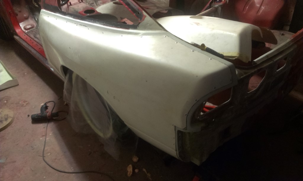

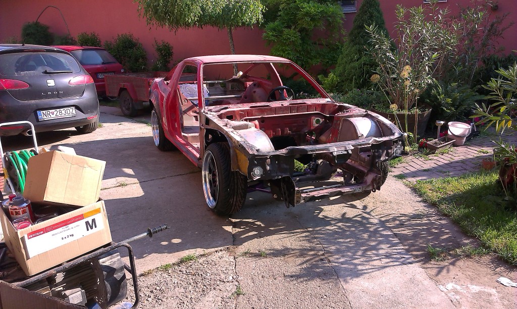

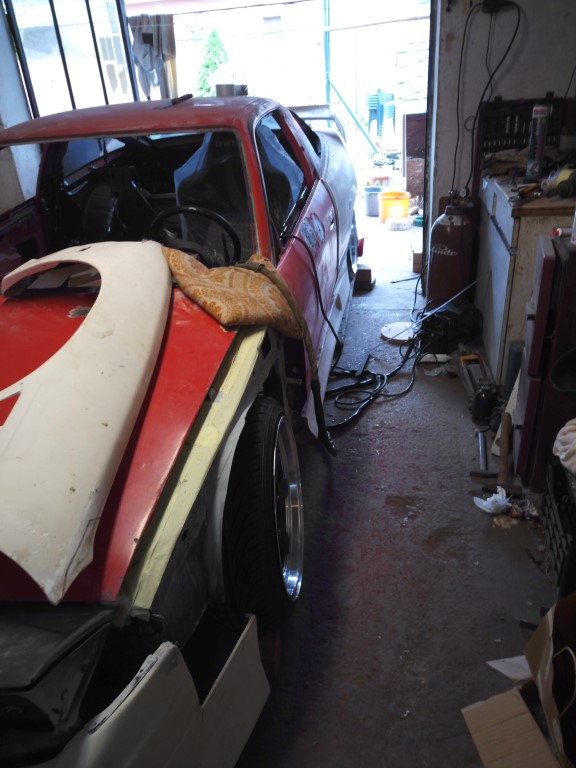

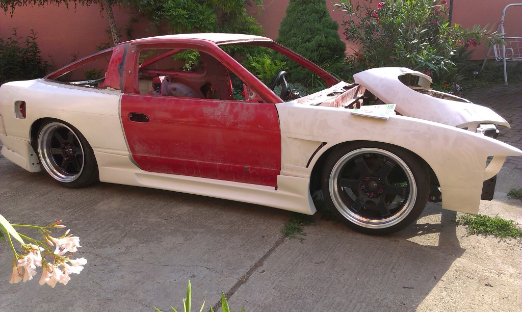

Ok so there is the pictures of actual progress and works.

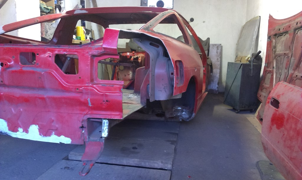

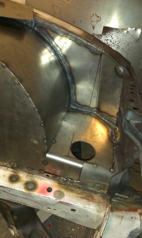

Rear inner fenders...

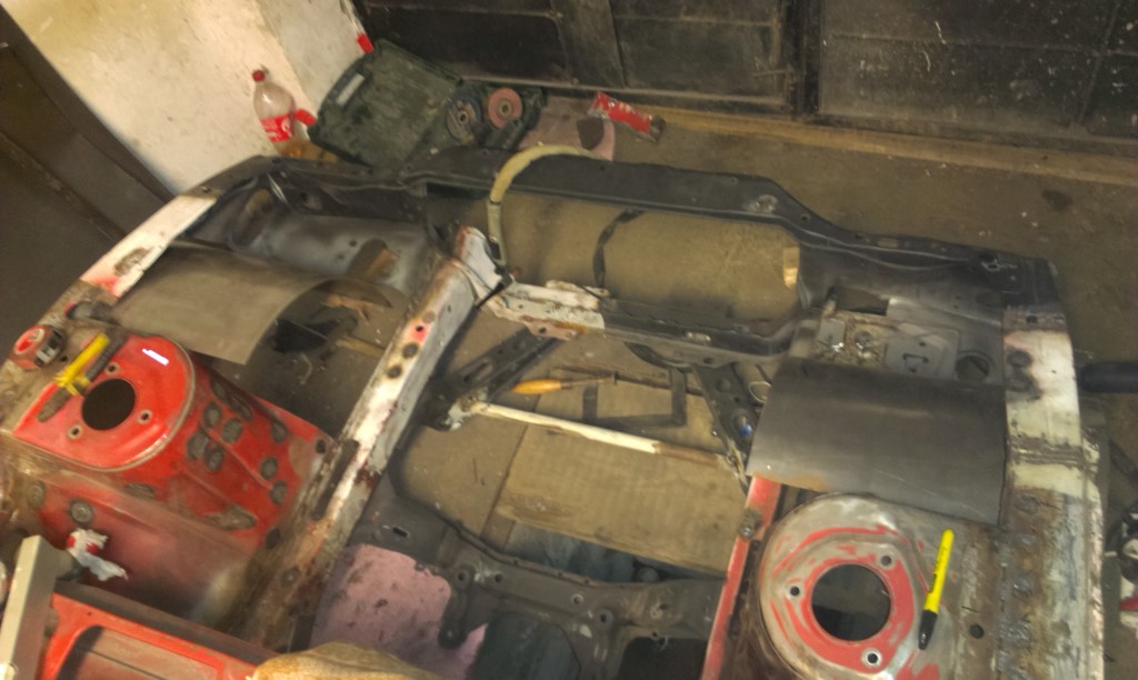

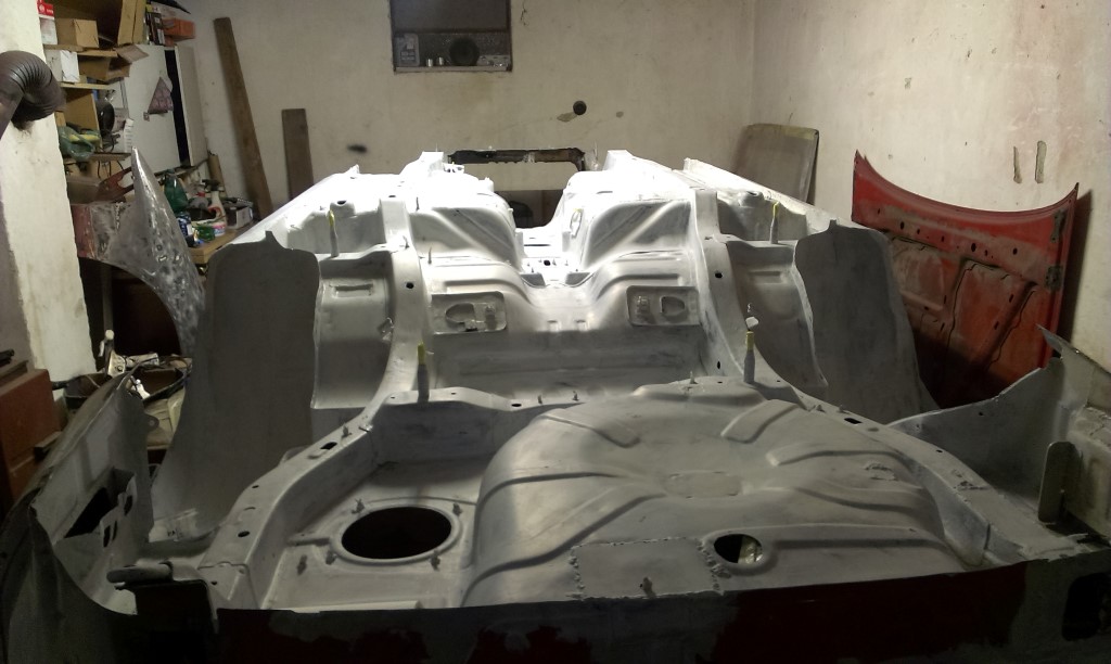

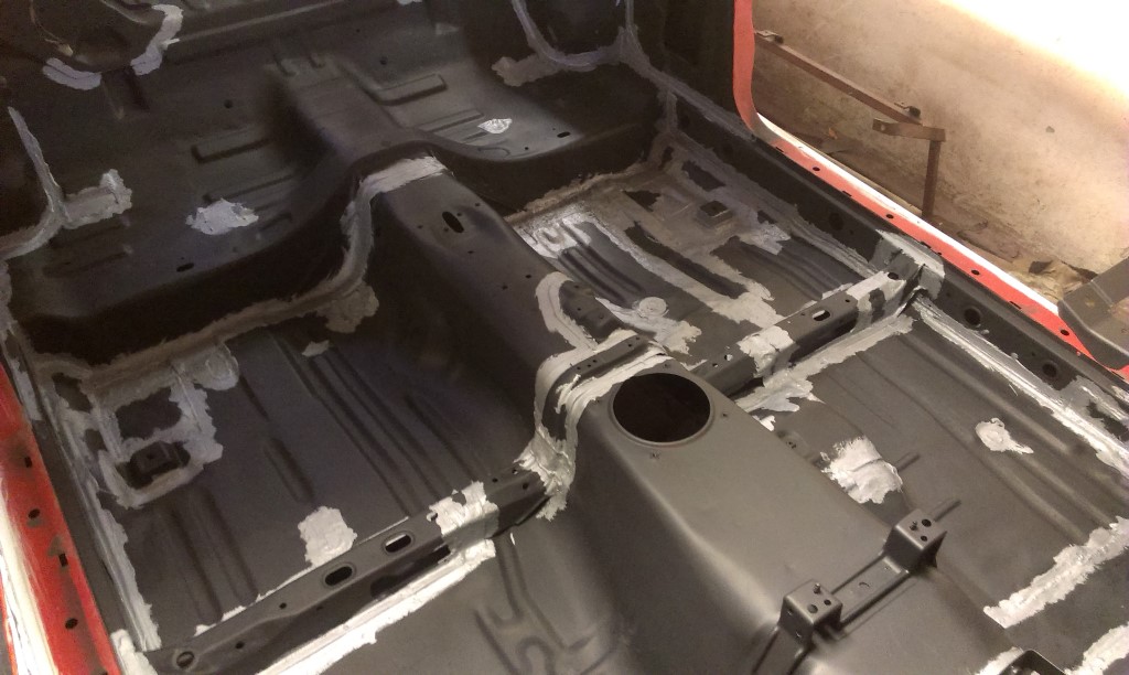

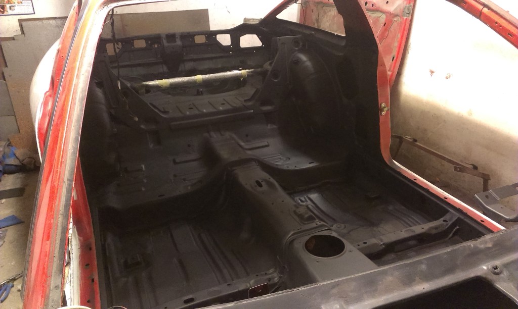

Bottom of the body is finished
Suspension - ON.
Wheels - ON.

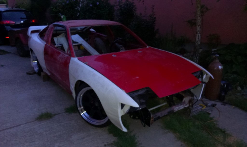

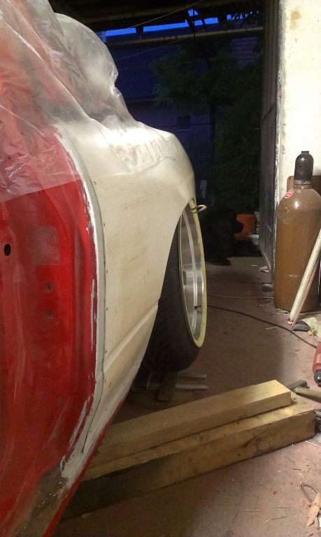

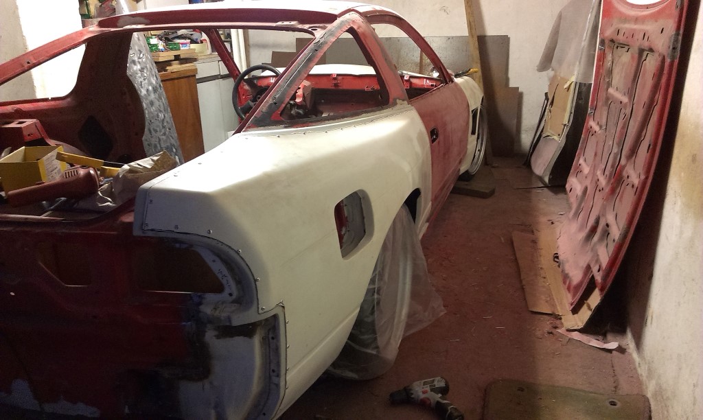

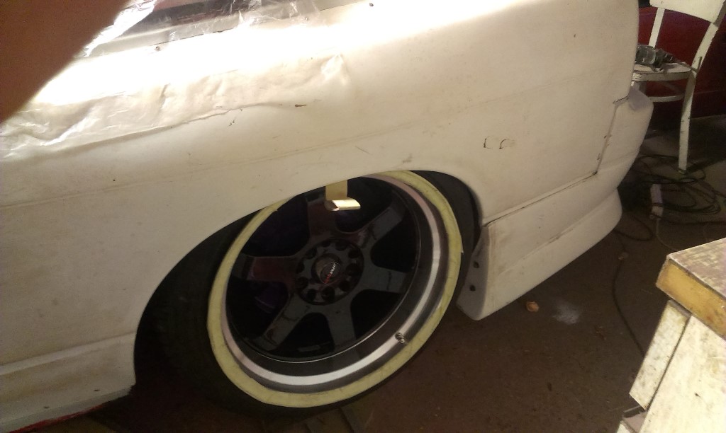

Rear +50mm(maybe more) Fenders - In Progress.

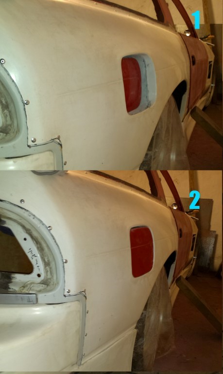

Old 07-15-2015, 10:02 PM   #74
Almighty So
Almighty So's Avatar
Join Date: Sep 2014
Location: CHICAGO
Posts: 1,809
talk about an update. unbelievable work.

Old 07-18-2015, 02:29 AM   #76
TSSS22
Join Date: Feb 2014
Location: Slovakia
Posts: 83
i vote gas door pushed out
Thanks, guys. I vote pushed out door too, its easier to finish and cleaner.

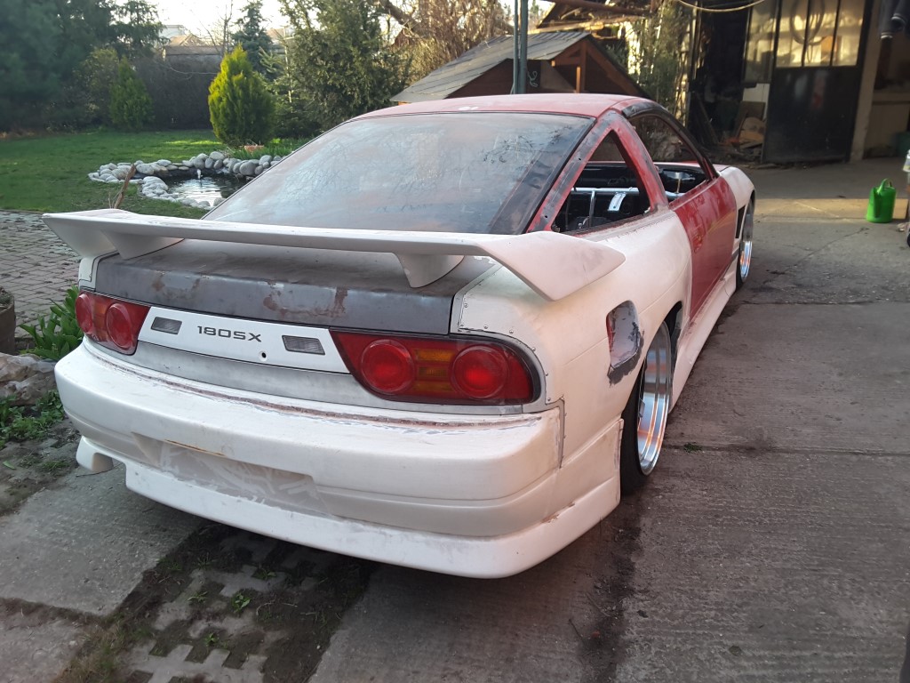

The 326 power wing is fitted
The exhaust
Testing the fitment

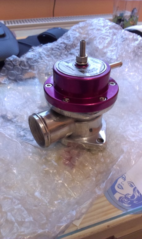

New BOV from NGR Performance

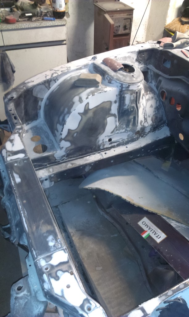

Old 12-31-2015, 08:21 AM   #77
TSSS22
Join Date: Feb 2014
Location: Slovakia
Posts: 83

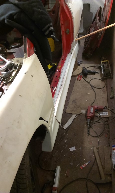

Hi I am back with new pictures

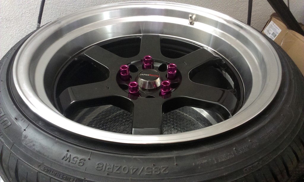

Last pic on these wheels now

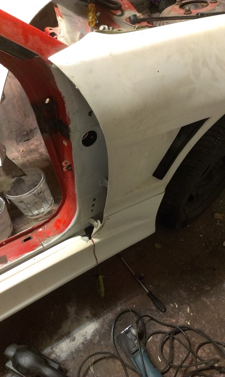

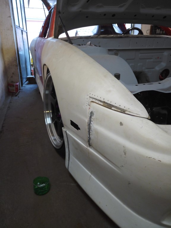

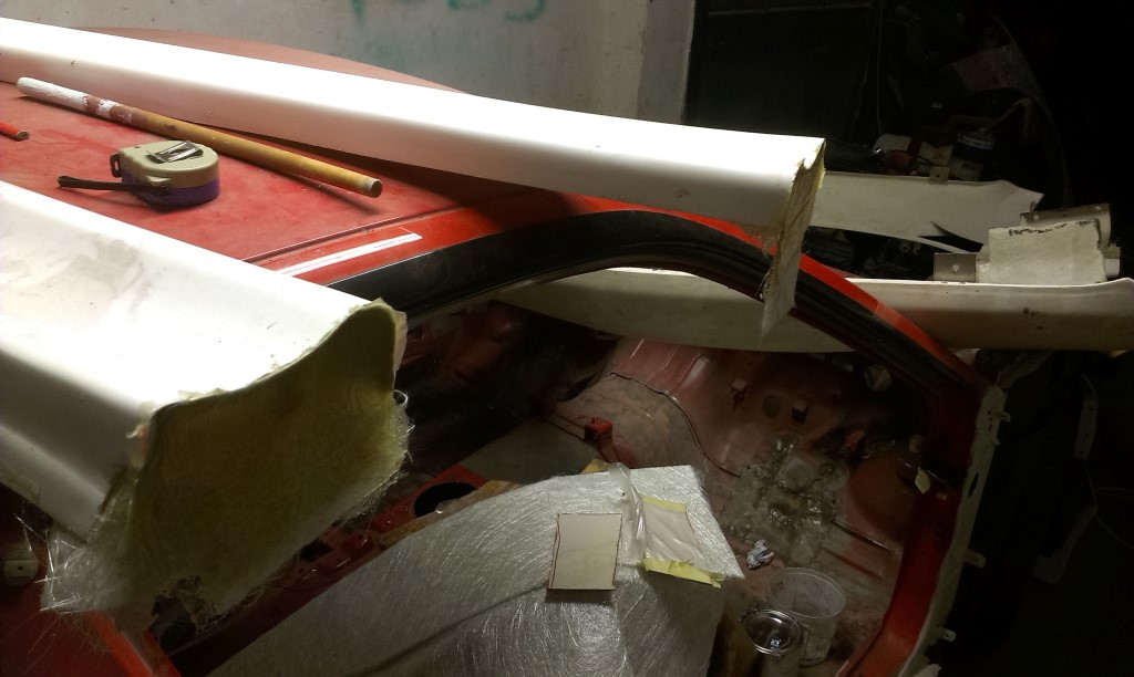

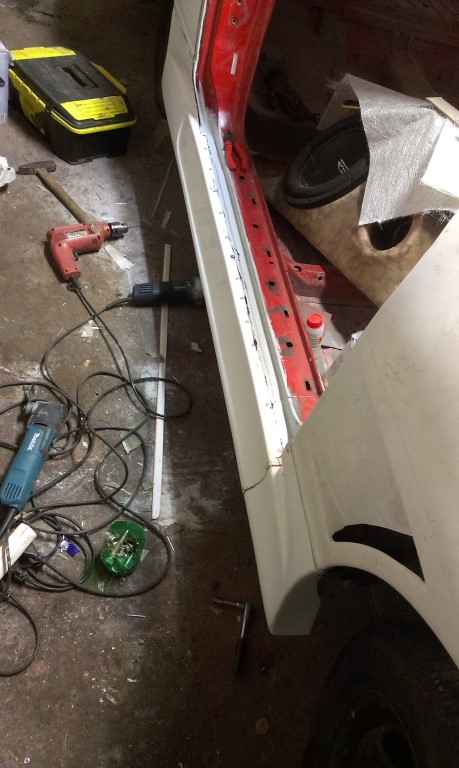

Fitting the sideskirts

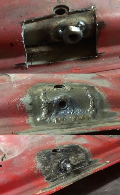

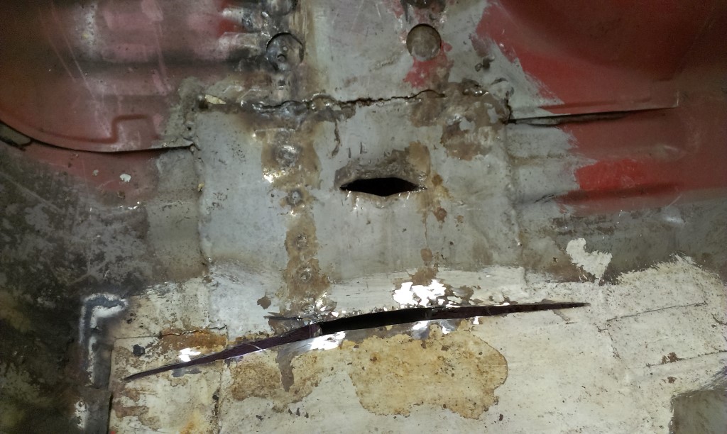

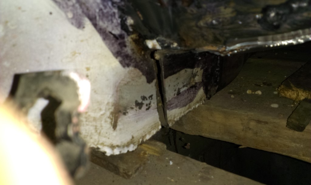

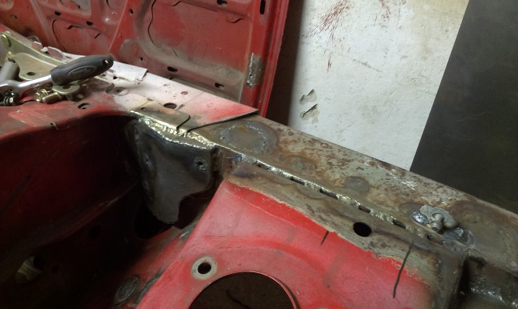

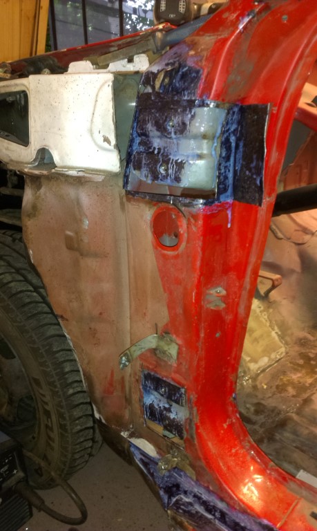

I found lot of rust on the door mounting points...

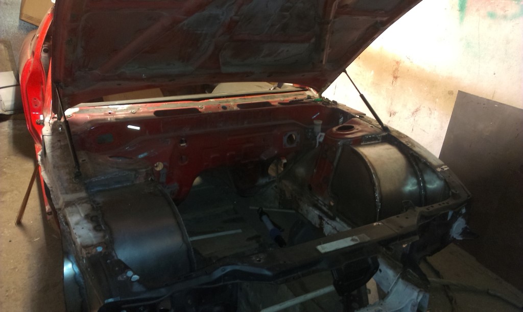

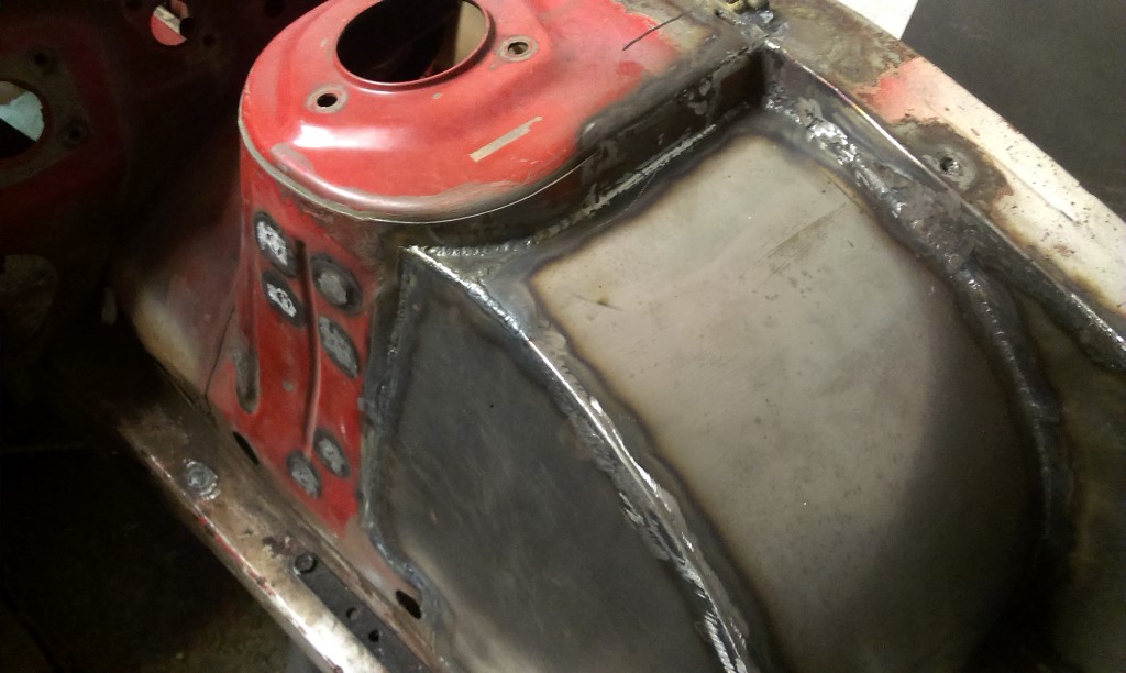

Last weldings in enginebay
I cut side skirts to two parts for better manipulation with front fender. Now I can take down the front fenders with this small part of sideskirt without drilling down the rivets.
Black base coat in enginebay
The real petrolheads have christmastreeholder like this

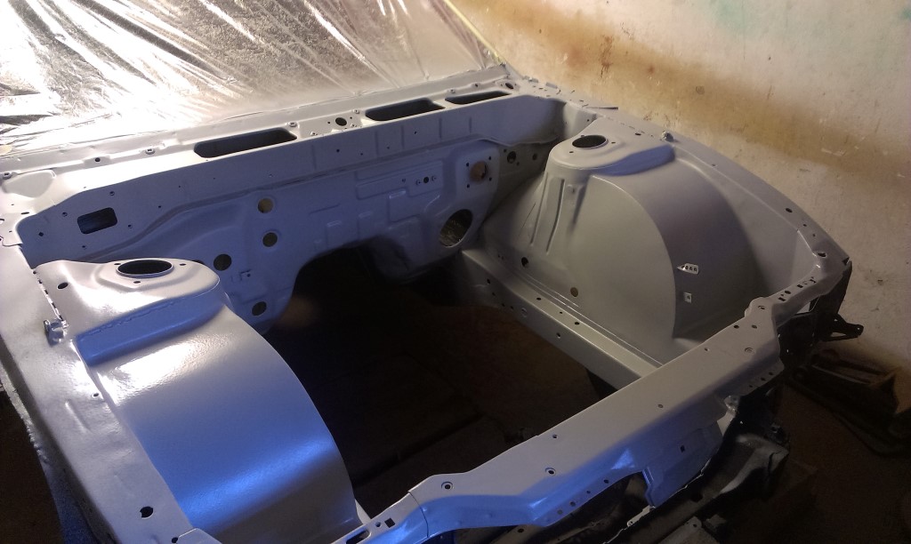

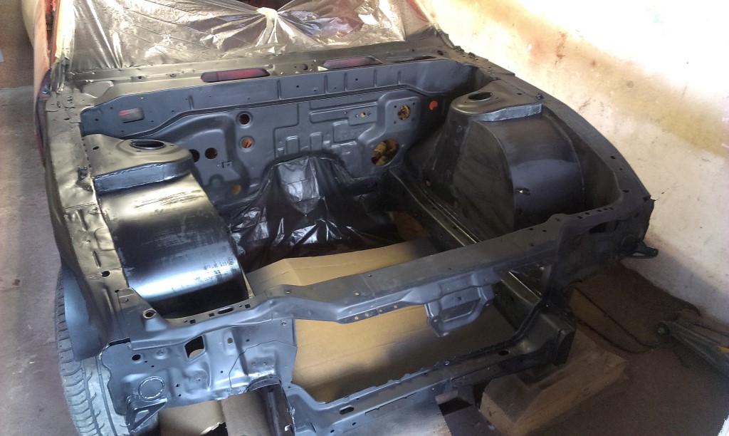

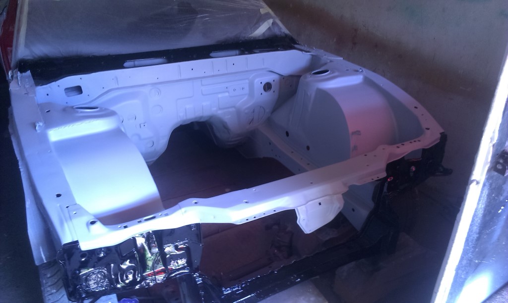

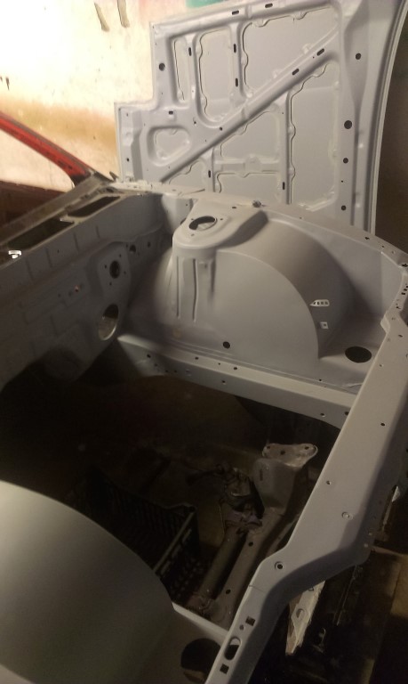

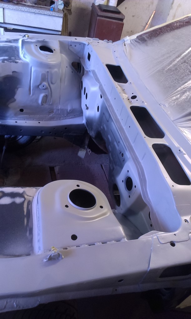

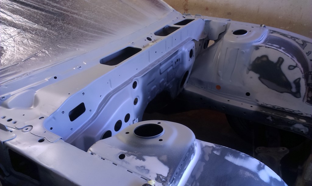

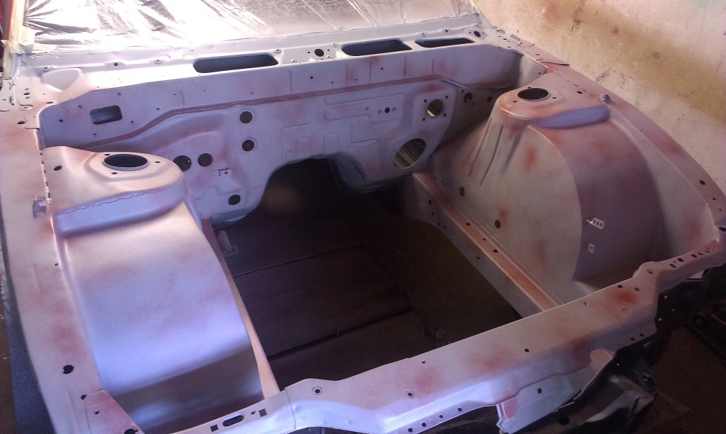

After spending a lot of hours working on enginebay, is ready to paint

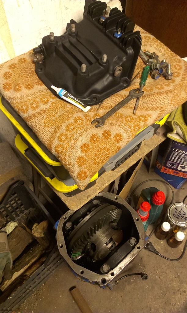

I need output shafts for my vlsd to finish it.

Painting the interior done:

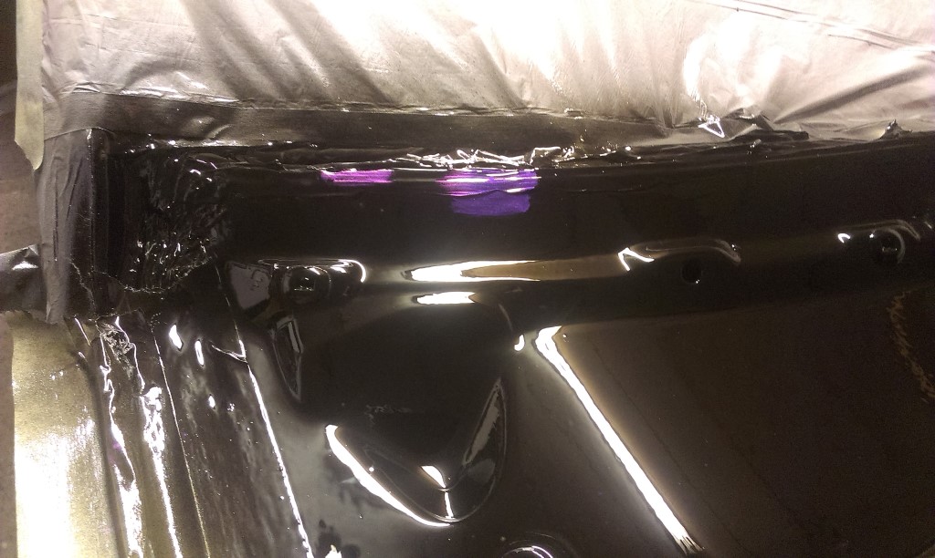

Old 10-05-2016, 02:50 PM   #83
TSSS22
Join Date: Feb 2014
Location: Slovakia
Posts: 83
Originally Posted by BryanS14 View Post
Any updates on this thing?
Hi, yes of course, sorry for late update. Freshly I have Instagram https://www.instagram.com/nissan_200sx_rs13/
and you can follow the build on facebook too https://www.facebook.com/szabolcs.szamel
Turning to the build, the works are going very slow but its not new. I continued the process in enginebay. I used lot of putty and sprayputty for clean finish....
I think I found the best color for enginebay, black base and some layers of purple custom painting pearls. The right side of testline.

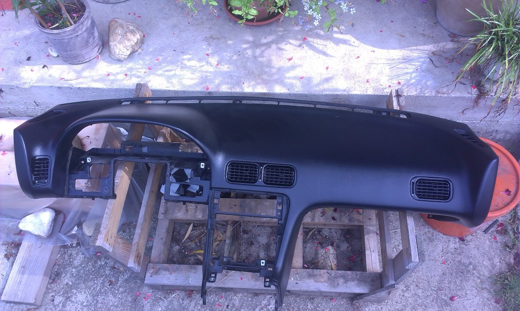

I found the really good condition dashboard

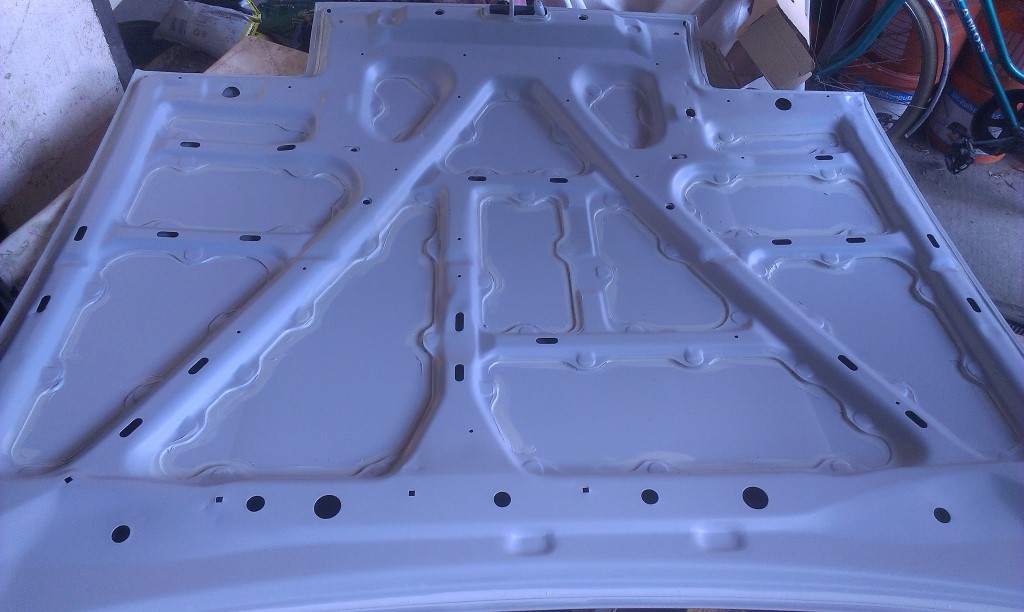

and prepared the hood underside for painting, basecoat with seam sealer.

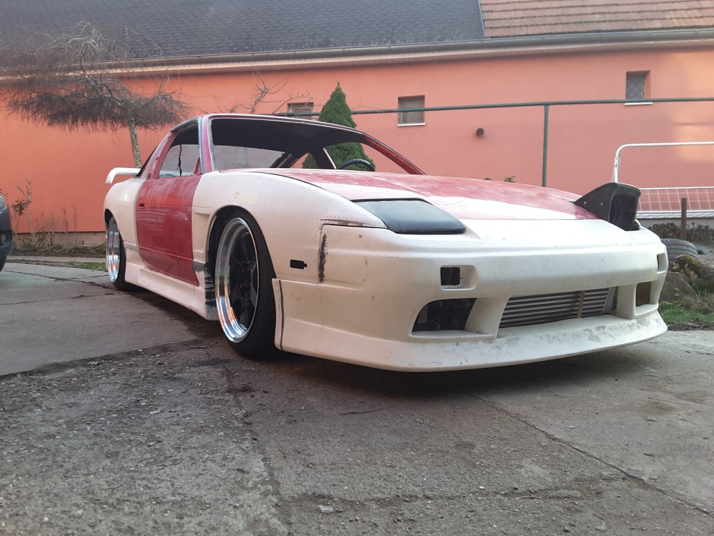

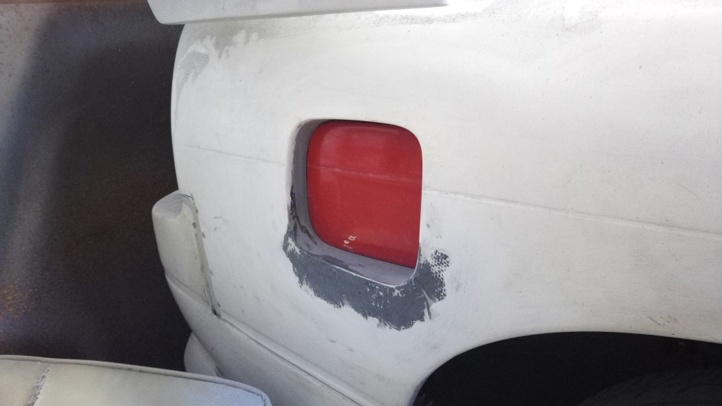

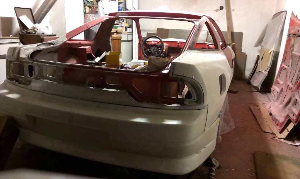

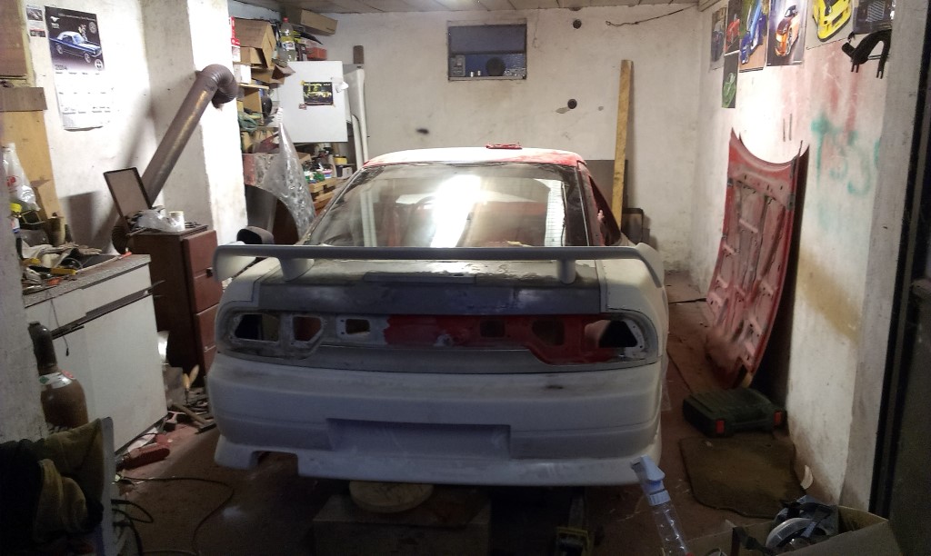

s13
Hi, I am back with new pics and infos about the project. Its not dead, just I dont have time to write the new post... With my girlfriend we buy new dailycar: BMW E46 323i sedan, yea its not only my decision. She love the cars also, and She like to drive something nice with correct power specs and I like to buy RWD so this is the result. I worked on car, new polyurethane front bushings, changed steering rack - the old is leaking, exhaust system from 330i - need to little weld for the best fit, and modded muffler (sounds really good ) and some little mods like angeleyes, autodimming mirror, bluetoothmod for oem HU.

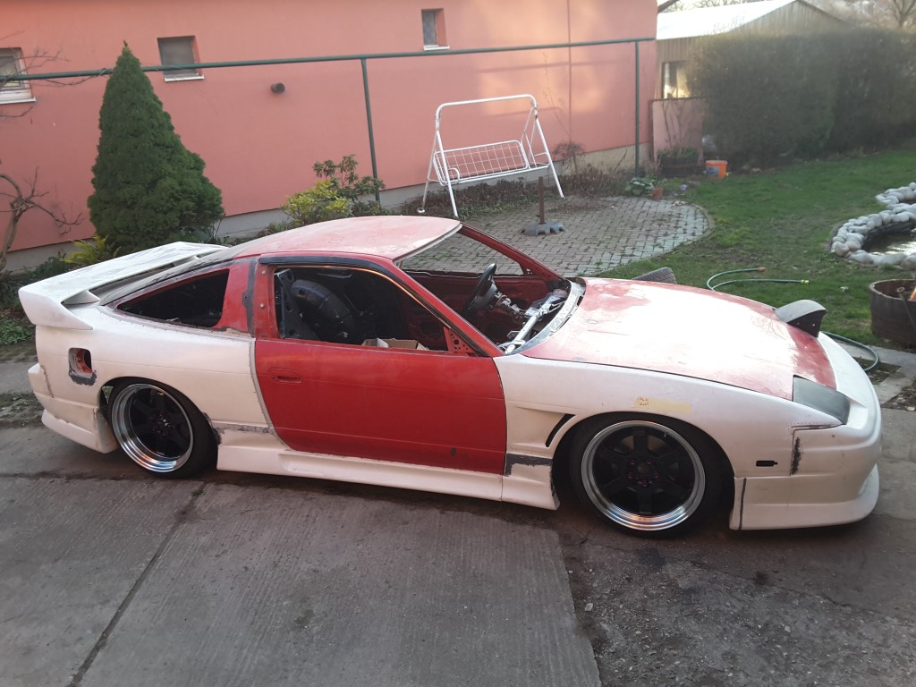

Ok, so whats up with the s13 you ask...

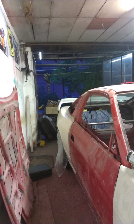

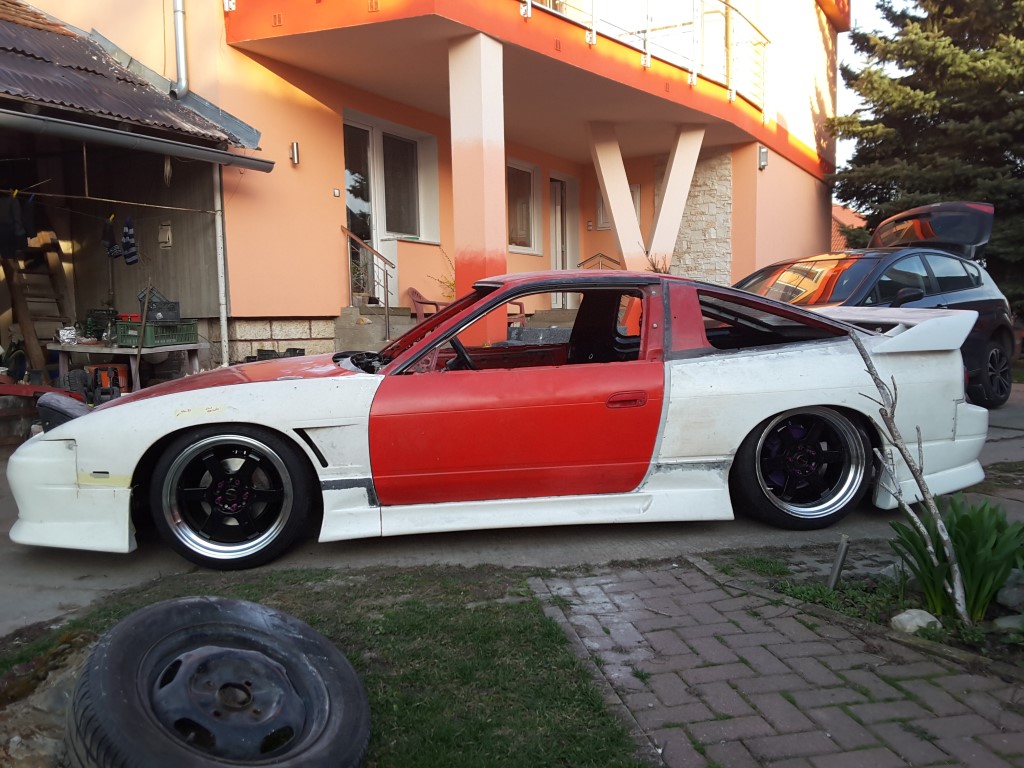

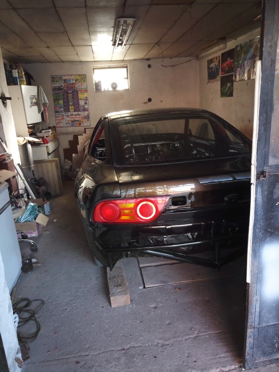

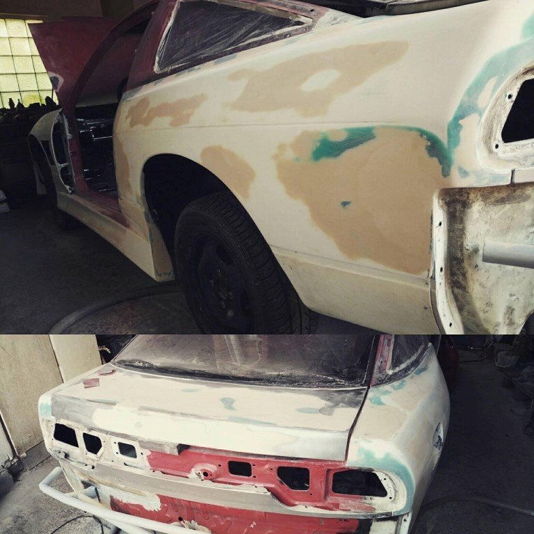

At the moment the car is in the paintshop

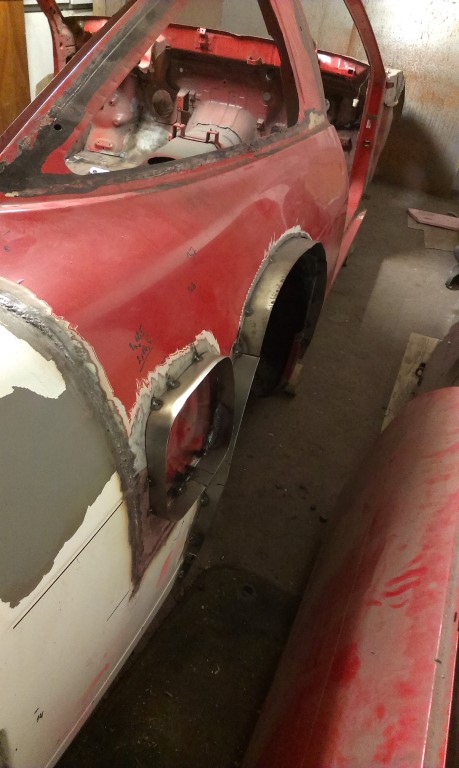

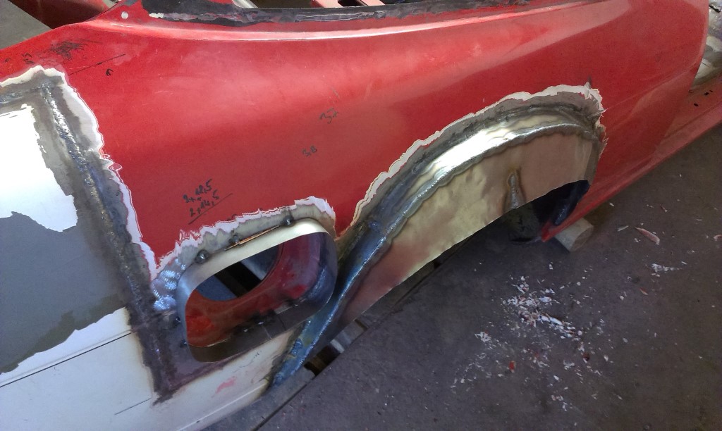

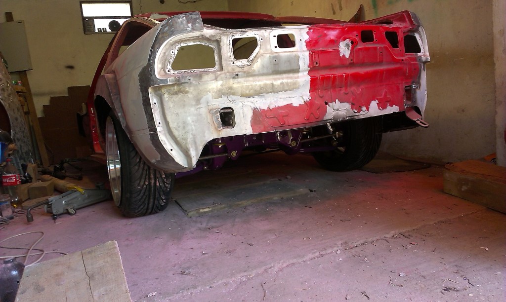

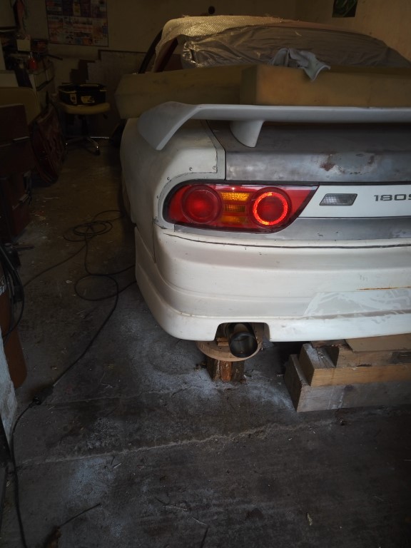

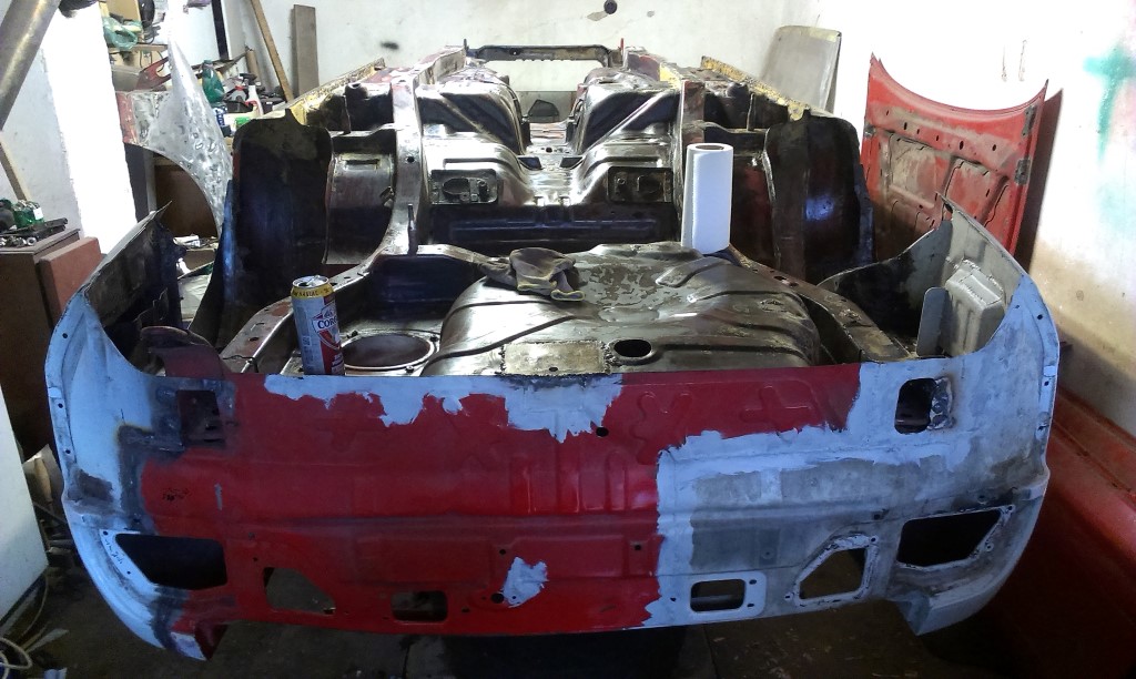

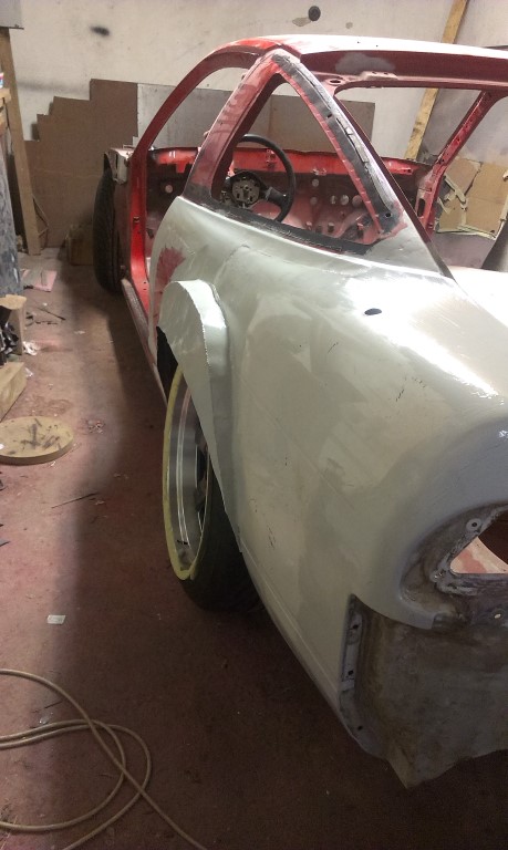

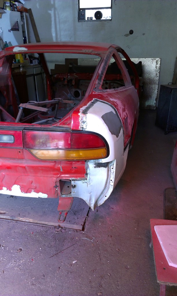

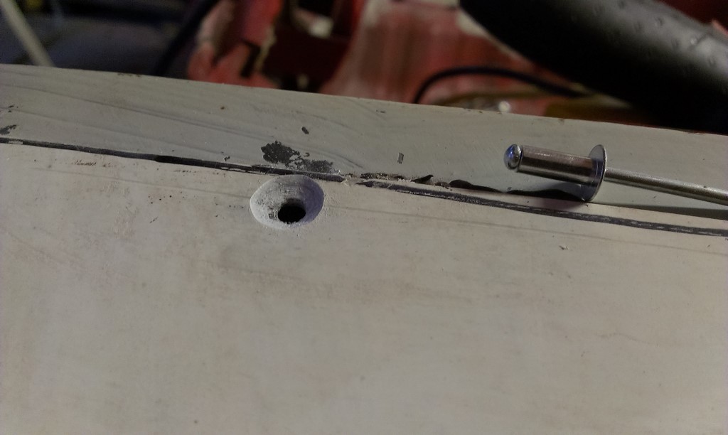

But I have a lot of work with her before current pos. I finished the gasdoor

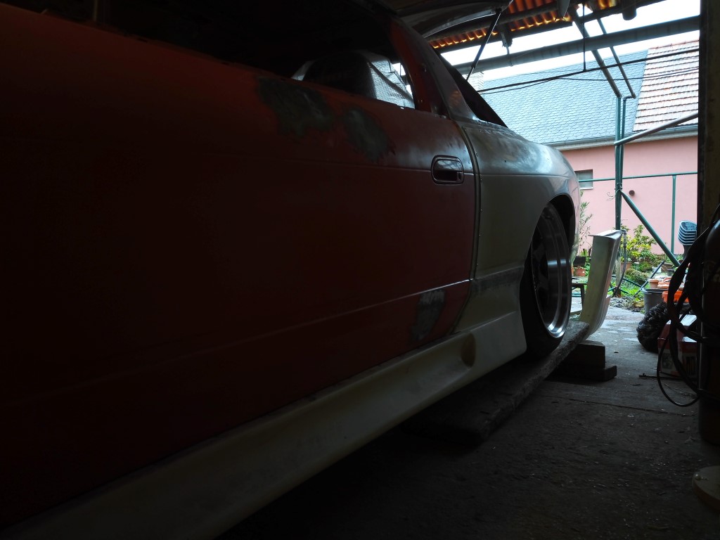

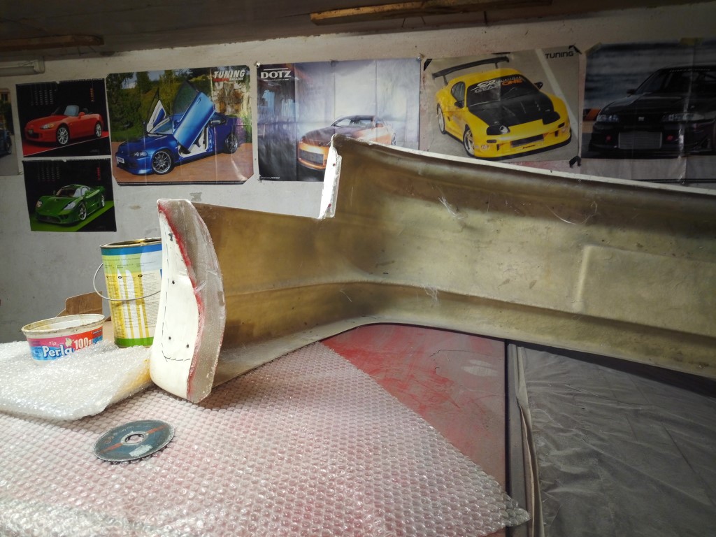

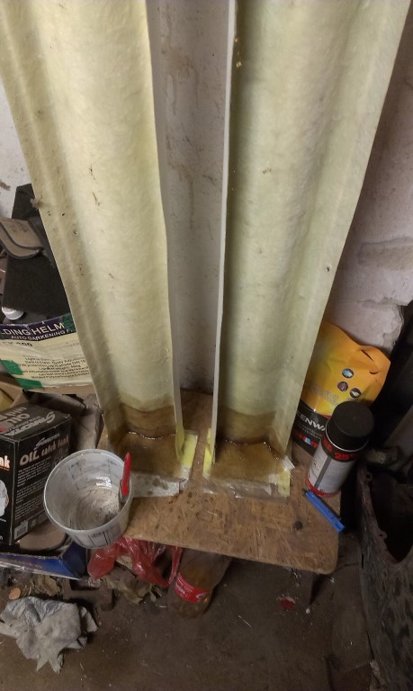

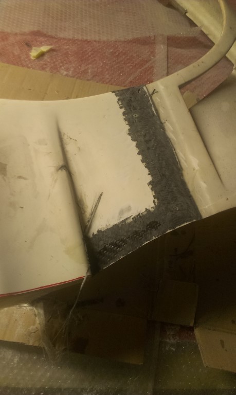

repaired all fiberglass body parts because they are terrible there is some pics

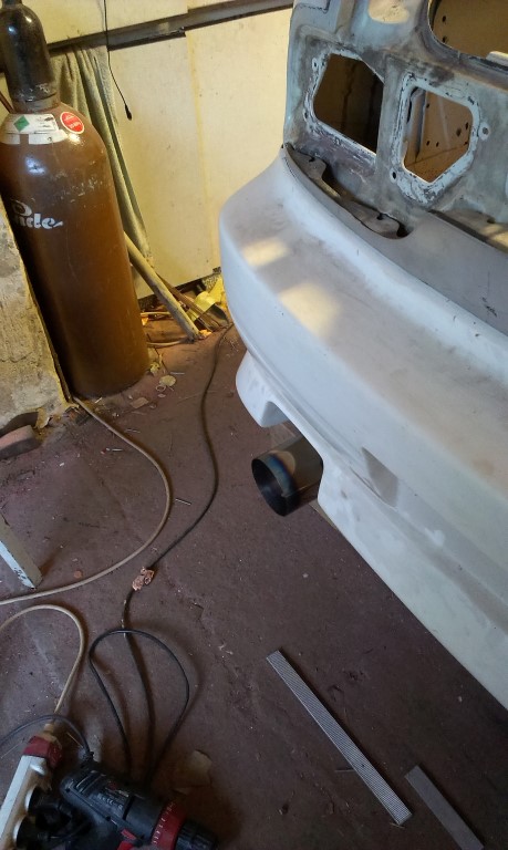

testing the exhaust position...

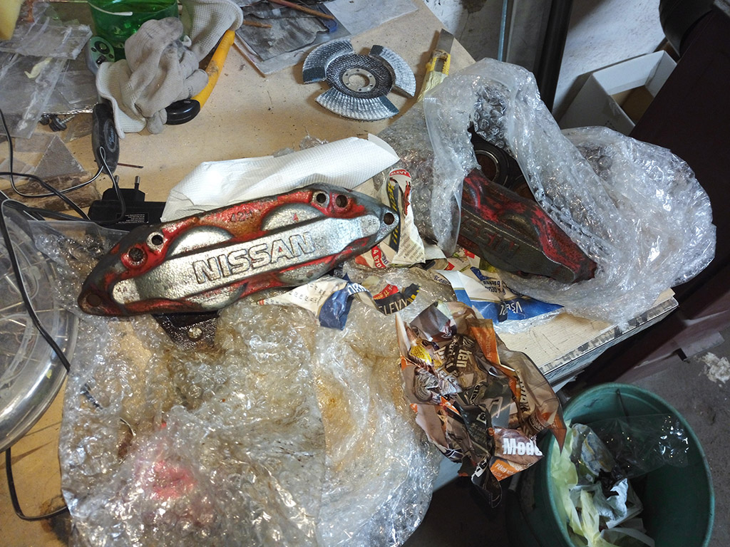

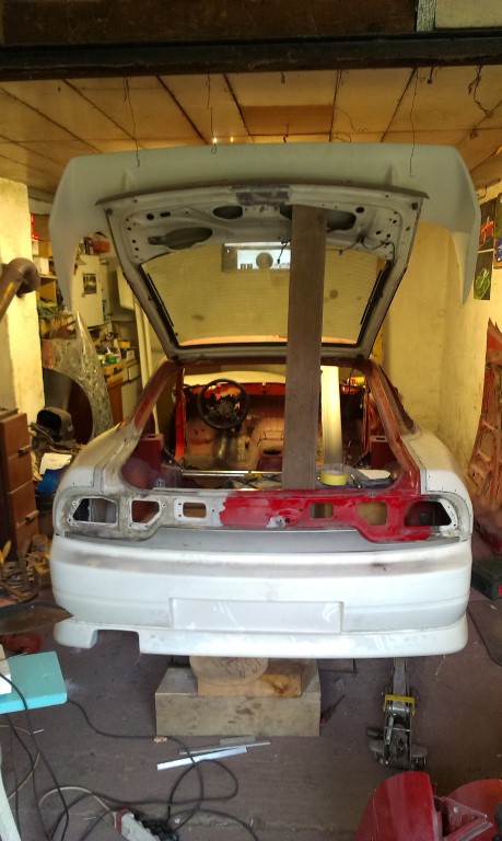

and I bought brake calpiers from 300zx

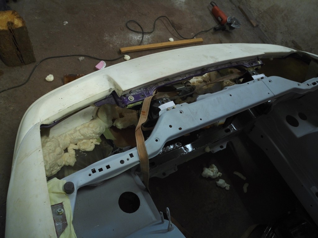

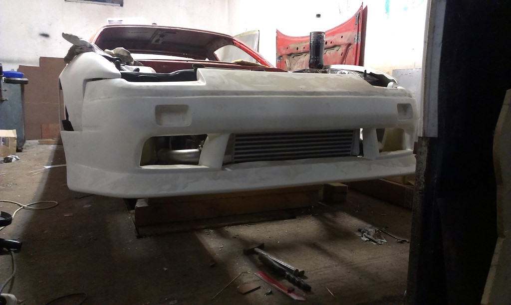

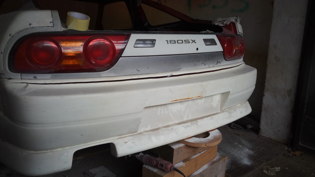

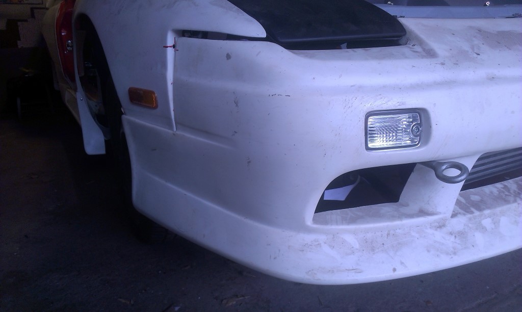

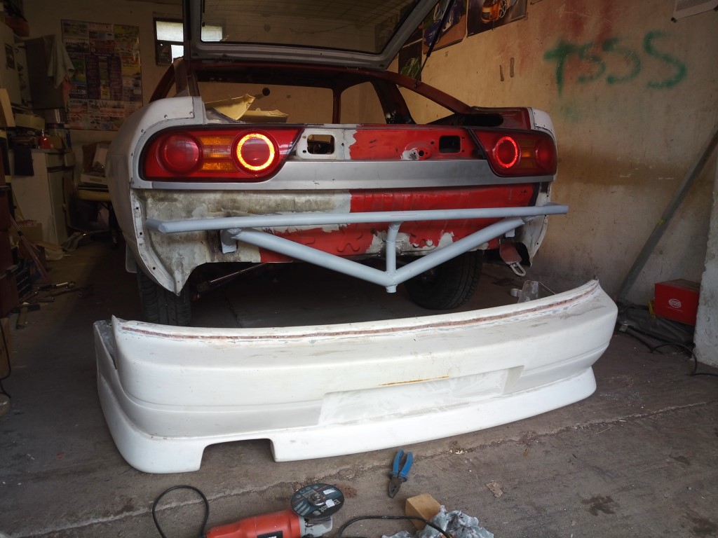

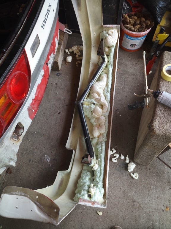

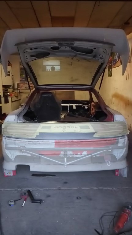

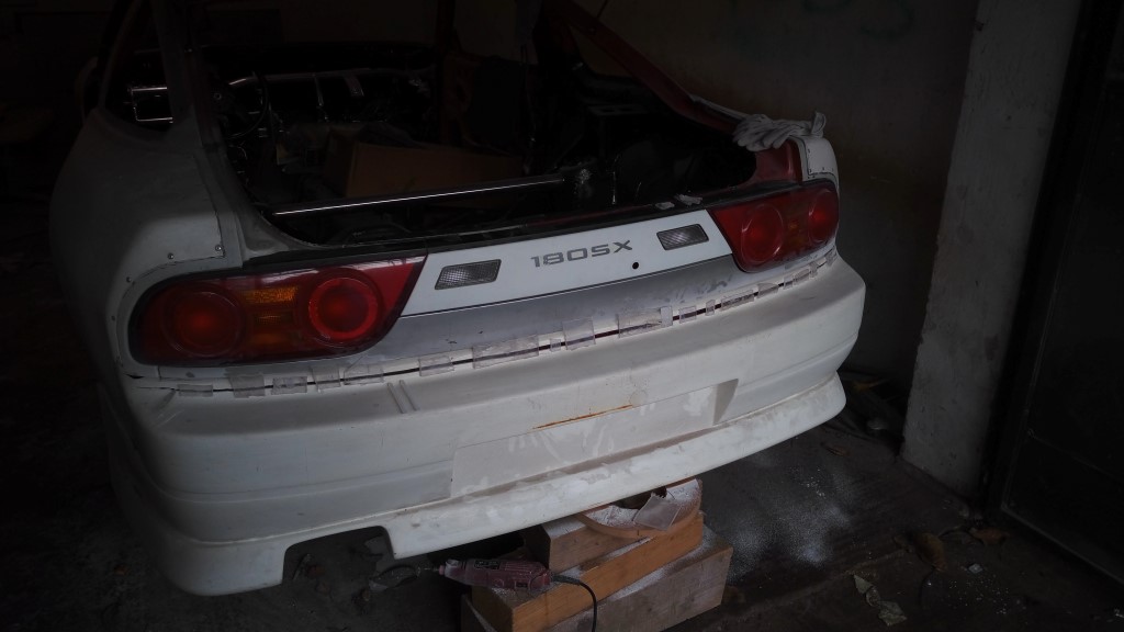

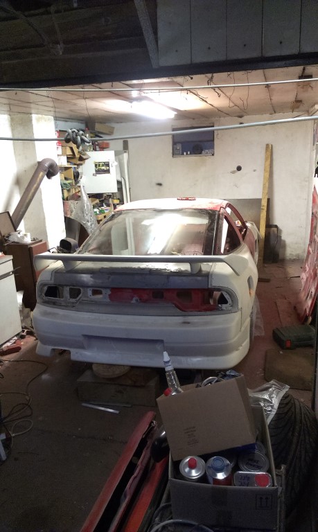

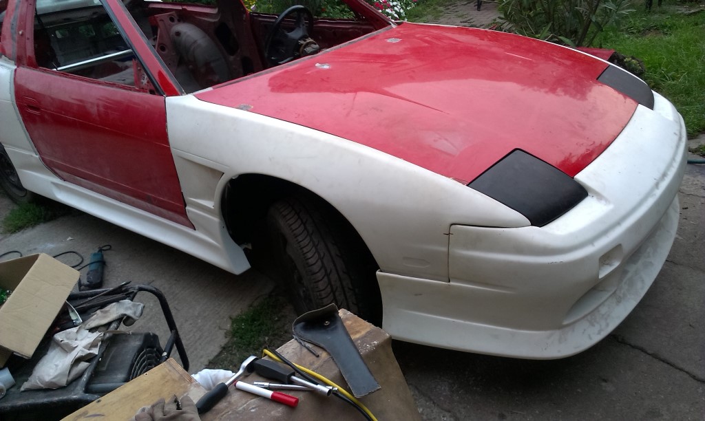

made bashbar and use foam for best fitment of the rear bumper
and then put everything together

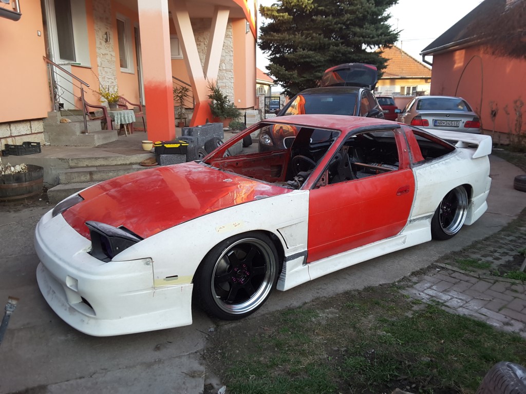

Chill out! I bougth spacers: 20mmfront and 60mm rear
And one spy photo
BTW I fixed all of the old links for photos

Ratpack_Chad is a jewel in the roughRatpack_Chad is a jewel in the roughRatpack_Chad is a jewel in the roughRatpack_Chad is a jewel in the roughRatpack_Chad is a jewel in the roughRatpack_Chad is a jewel in the roughRatpack_Chad is a jewel in the rough
Thats actually a really cool idea with the foam inside the bumper, once you cut away the excess it probably a perfect fit. Great work!

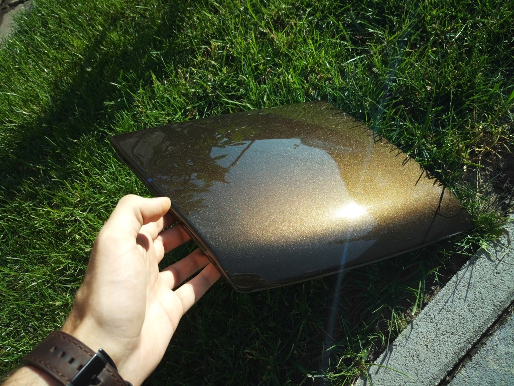

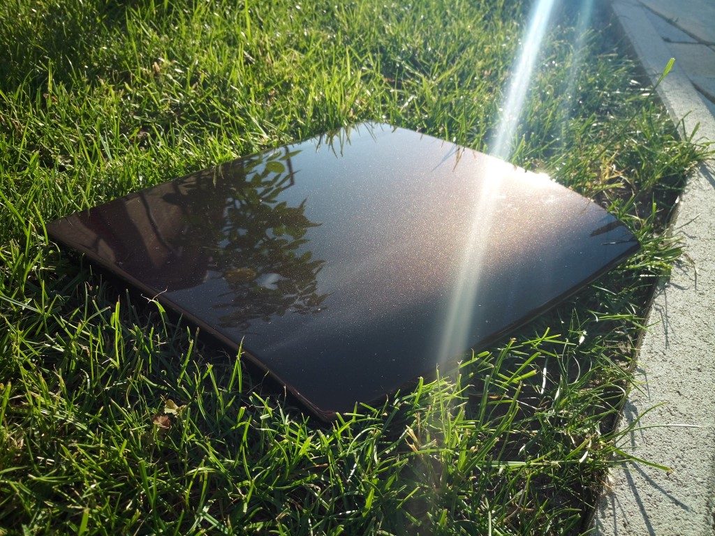

Thanks guys The paintjob is done, I am preparing it for cavity protection wax.
