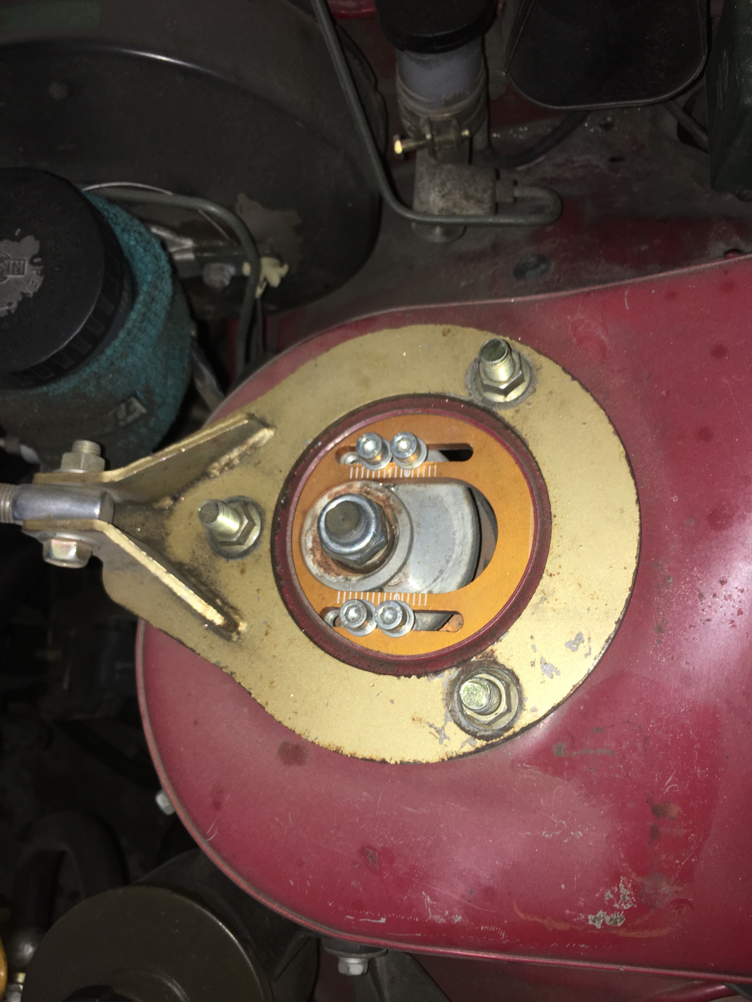

Hey I have what I believe are br Coilovers in the front and I’m not sure if their able to adjust the dampening can someone confirm this for me. Thanks!

If they're a inverted coilover, then the adjustment knob would be underneath the C/O's body.(where it mounts to the knuckle)

When in terms of shocks/dampers (pay attention to that word).........the term you are looking for is damping adjustment.
Sorry. I see people use that term all the time and it errkss the shit out of me lol
Check on the markings on the coils. The RAM series coils (inverted) have bottom mount adjustment as mentioned above. You are already underneath, look for identifying marks/labels,etc, unless the shock is so worn out and none of that is there......In which case, you need better pics to help us determine what you have
