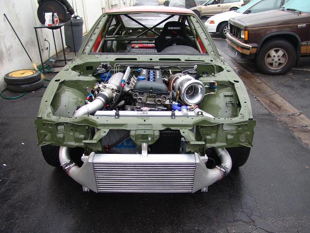

So I've had my car in a "completed" stage for awhile now, but I think I'd like to give some notes of my path I took to build the car and what I'm still working on.
Started about 2004-5?, Altamont was the shit.
My first S13. Gutted, VLSD, Short Shifter. Very fun car, ended up getting in a head on with an Alpha Romeo while being retarded on public roads, so I started my track car build at this point.
2006, Thunderhilll, Grip and Slip. SR20, Coilovers, Gutted, sick old school TE37's, all linkage and brakes. I did most of the work on this shell myself, and it showed. I didn't have the skills at the time and the car looked like shit.
In 2007 I was cruising zilvia and I came up on a really nice shell for sale. Paint, Wide Body, CF doors, crazy cage, prepped for fuel cell + more. I estimated the total cost he invested into what I purchased and it ended up being about 12k in parts + labor. I got it for $1700+ a S13 I was dailying at the time (bought that for $1k.)

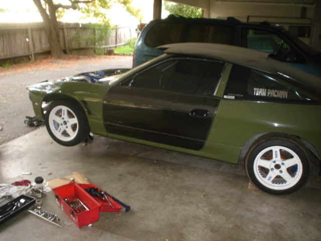

Here are a couple of pics from when the previous owner built it up. It was his "freeway car," huge top mount Sr, Z32 tranny. LOTS of money into this car originally. All new fuel lines, brake lines, rhyno lining, brand new from nissan OEM bumpers, 180sx glass, ect. When I picked it up in LA I threw my suspension on it and just towed it home.
Swapped my SR and all my suspension from my other car over and sold that shell.
At this point I was running out of money so the car sat for a few months. Eventually I took it down to Luke at Blu808. He was working at BR Racing at the time as well as having his own shop. We both had an agreement that to keep cost down he could take his time, and the car sat down there for a long time.

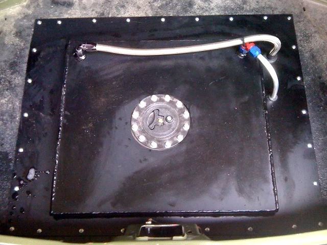

Luke hooked it up with a seriously legit fuel system. I'm running a summit racing fuel cell with 8an Lines to a low pressure, high volume Holley fuel pump that pumps into a custom Blu808 fuel surge, then to the high pressure external pump, to the rail then back.
At first the fuel system was perfect, but it definitely became a sort of headache. I started to have a lot of fuel cut issues. I wasn't sure exactly what was going on, was the fuel just running low? Was the low pressure pump not large enough? Ignition system? Ended up being a clogged fuel filter. The foam baffling in the cell started to break down and clog the filter. I replaced the foam and the element and it ran find for a couple of track days but then started to give me trouble again. Ended up just taking the foam out, running a aeromotive filter and replacing the low pressure pump (I think some foam got into the pump and ruined it). 2 track days into that set up and everything is perfect.
Since late '09 I've been hitting an event or 2 every month. Motor was stock basically. T25, stock internals with rocker arm stoppers and that's about it. I don't care what anyone tells you, you need power to drift. I had the car dyno tuned because I was running 440cc injectors at stock boost and it put down 212 at the wheels.
I've now upgraded the motor quite a bit. S15 GT28R, 600cc injectors, Tomei metal HG, ARP studs, powered by max high mount intercooler, Hallman manual boost controller and a tune with a simple SAFC Neo. Running it at 1.2 bar it put down 282whp.
The car is a serious animal with this amount of power. Very consistent and I can roll through 4th gear turn 1 at Thill.
Plan for the upcoming year, kit (which I already have, and will post updates), full ProAm season, ASB.

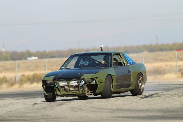

Got back from Bob's Donuts Black Friday track event at Buttonwillow. Car drove great! The power band is so usable and has enough top end to roll through 4th gear with the proper entry speed.
Towards the end of the day the turbo started backing off the manifold so I stopped driving one session early. Turbo locking tabs are SO FAIL. I have to take the whole turbo set up off to get them off. I'm just going to run standard nuts with lock washers, at least I can replace them if they fall off. I can't get at the angle necessary to unbend the tabs for those.

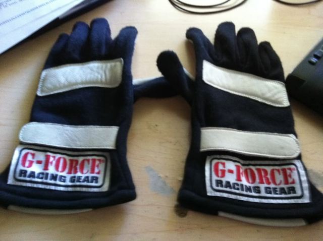

Also I really wanted to get some racing gloves after I almost crashed on the skidpad last summer. My hands were all gross and sweaty and I lost the wheel and almost ended up in the wall.
At first I thought they were to small but they are absolutely perfect. Match my harnesses.

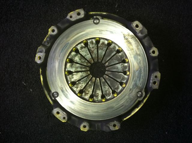

Took the car over to my buddy Kia at TD Garage today to rip apart the clutch and see if I could find anything obvious. Only think that I could see were heat marks.
Everything appeared to be installed correctly, no preload hydraulically, everything tight ect.
Sent ACT the information and well see what they come back with tomorrow.

Ok got the clutch back in the car. Flywheel resurfacing went well. Turns out the flywheel was slightly warped on the pressure plate mounting surface.
Kia's a boss and stayed up till 2am helping me put the clutch in. For some reason my transmission doesn't like to go back in once its out. There isn't enough clearance between the firewall and the motor. Had to disconnect the sway bar, motor mounts, exhaust, and jack up on the motor to tilt it. After a lot of swear words we got it in.
The clutch still grabs high. I think it needs bleeding.

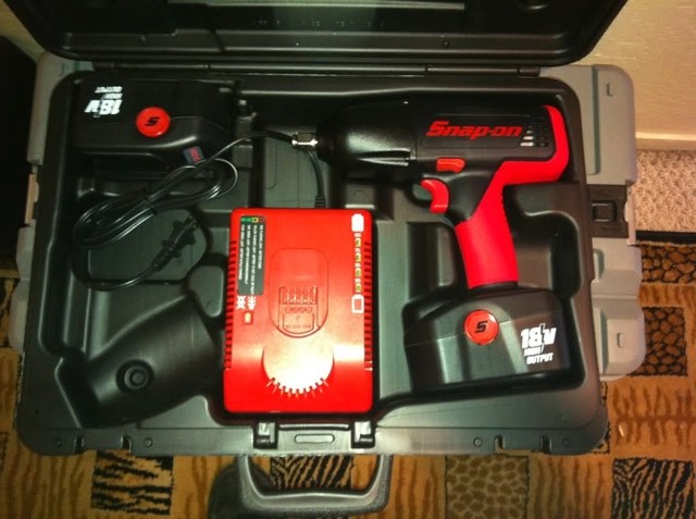

Snap-on electric impact. Wanted one forever. 650ft lbs of breaking strength. Life changing tool.

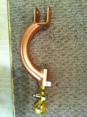

S14 is starting to look awesome. Got the rear fenders rolled (need to do more), coilovers, 5 lug, brakes. Still needs a lot of tweaking to get those huge wheels in there just right. Better pics soon.
Got my new coils for the S13. The quality is crazy good.

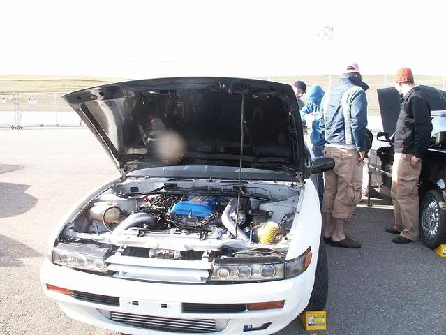

9/11/11
Originally Posted by Limitless Motorsports,Sep 10 2011, 10:19 AM
tomei pan don't crack like a greddy do!
*edit also i forgot matt stripped his greddy pan
Both of these are good reasons...
Now...in another part of the jungle.
Oil Pan Install....Check
Coilover install....Check
Drifting tomorrow..... Hopefully. Lot's of stuff to dial in. Car is totally different now.
Limitless event was serious business. Ran really well, lots of track time, good times with good friends.
I stayed up till 1am putting the new coils on and fitting them. Ended up having to run a 5mm spacer in the front to clear coils as these are a little bulkier that my KTS. Eyeballed camber, loaded it up and here is the result.
Car felt unbelievably good. So much smoother with the new coils. I can stay in the throttle much longer and it pulls extremely quickly through the corners.

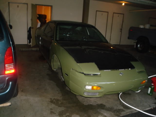

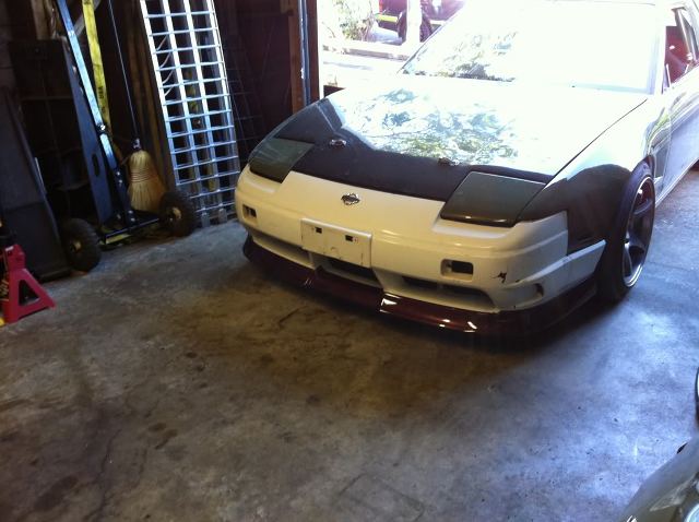

Worked on both cars a little today. Got my Kouki lights test fitted.
I also need more wheels. Using my drift spares for my S14 isn't really working out.
I fitted the S14 a bit more, still need a roll in the front and desperately need an alignment.
Tore the S13 apart. Sent the knuckles to PBM for angle mods. Should be back in a couple of week. Also will be installing my power FC soon so I'm going to need to hit the dyno again.
Yay projects!
MOAR PIZX
More pics from the Limitless event.

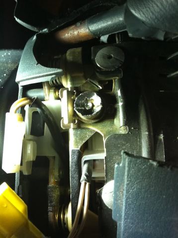

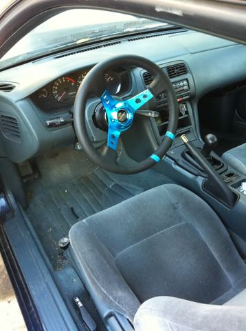

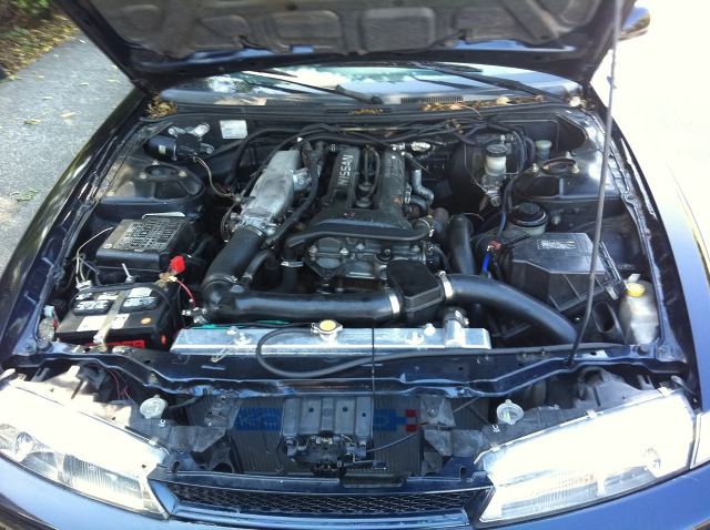

Been a tough couple of weeks working on the cars. I've been doing project after project and nothing has gone smoothly.

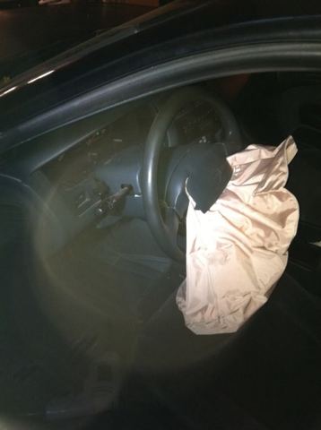

Started putting the new PS rack in the S14. Such a nightmare. I was having an unbelievable amount of trouble getting the steering shaft off of the rack. Took me over an hour. Finally got that off and couldn't get the high pressure line to line up correctly to thread in. I ended up ripping it out and purchasing a new braided line rather than all that OEM crap.
Also getting the outer tie rods out of the knuckle was impossible.
I ended up having to rip the entire corner off to get it in a press. Took a full 150 tons to get it out.
No I wasn't in an accident, this was just 1 wayward attempt to get the steering wheel off. I thought I might be able to go through the air bag.
Also tried drilling out the OEM tamper proof bolts. I was trying to do this in a hurry to get to Sonoma Drift today, but it didn't pan out.
I did get it off eventually and got the new NRG Steering wheel package in there. I really like this wheel and blue is awesome.
Overall a horrible few weeks. Once that new line comes in I'll be able to finish it up hopefully. Still have to install the new PS pump and tie rods from the race car.

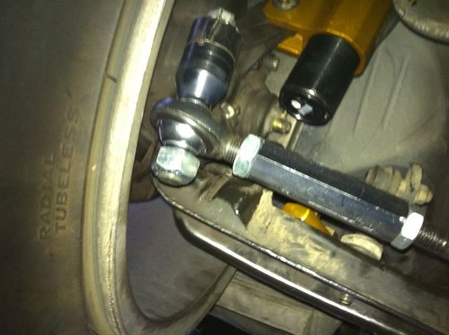

9/30/11
Angle?! PBM Knuckles mean business.

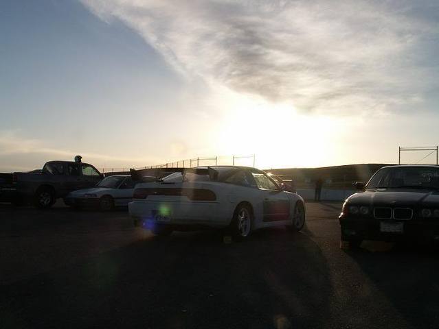

Also, I know I've said it before, but the S14 should be making it's debut at Sonoma tomorrow. Rolled all the fenders more, hit it with a hammer a lot, new tie rods, just gotta button up a couple of things and I'll see how it goes.

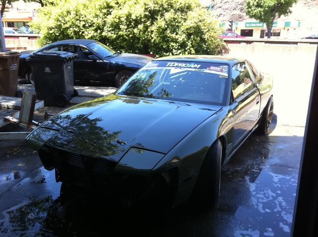

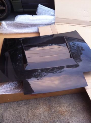

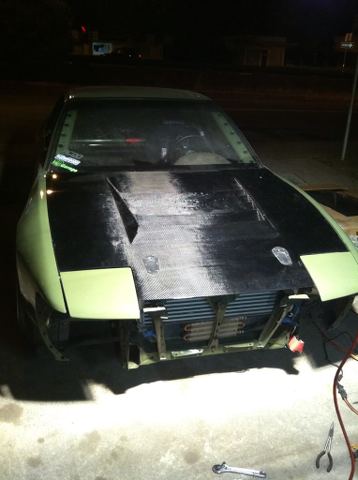

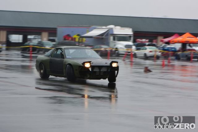

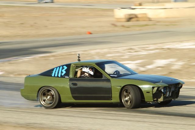

Lots of little updates. I took the s14 out for its first official skid pad day. Car did awesome even with just a eyeball alignment. The fan wiring failed so I wired it directly to the battery.
Also got my new hood in for the s13.
Got it installed with aerocatch hood pins. Fitment is a b+. probably not as good as my
Seibon.

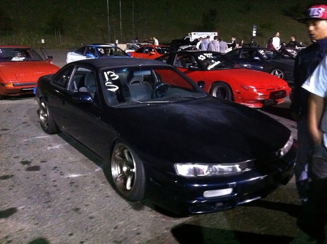

Some pics of the S14 from Sonoma Drift.
LOTS MORE COMING SOON!!
