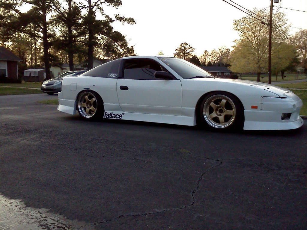

Heres a pic of the car as it sits now

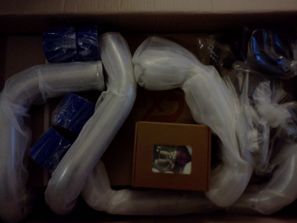

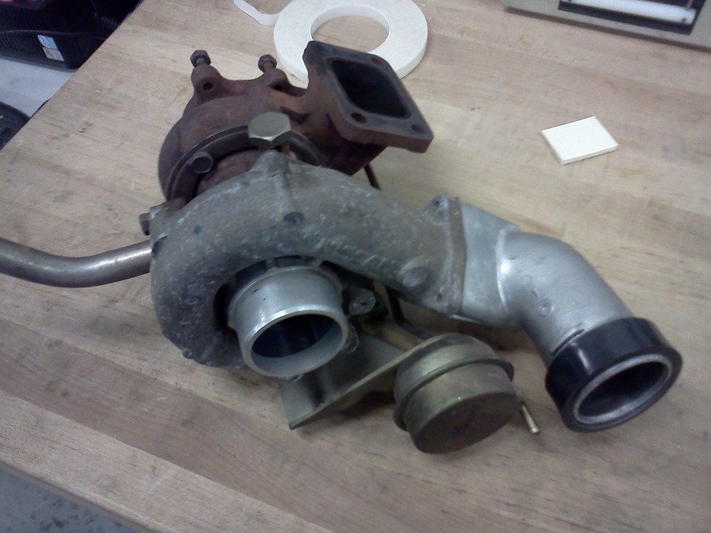

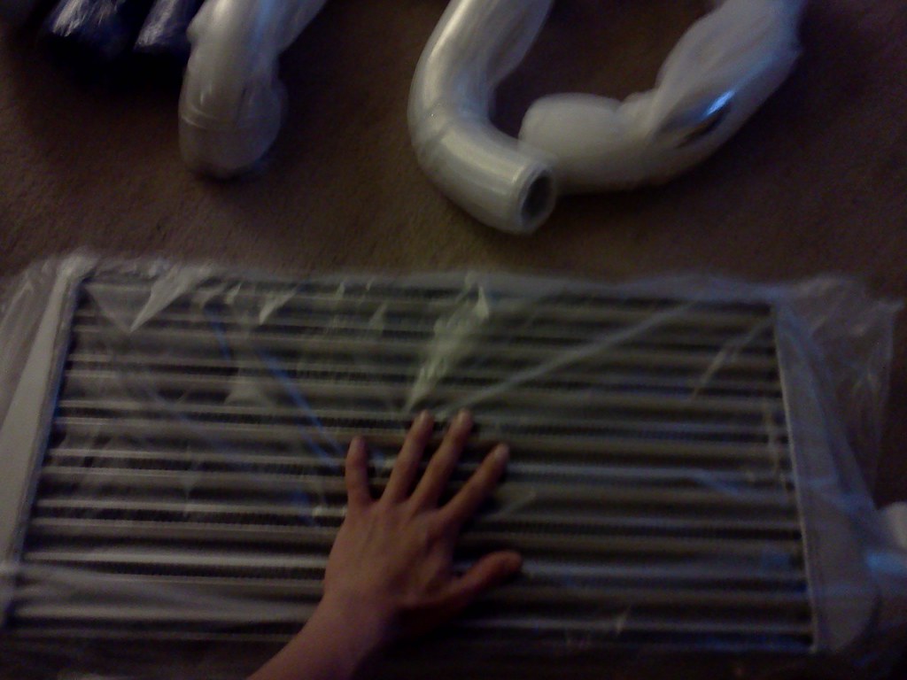

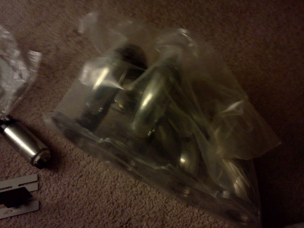

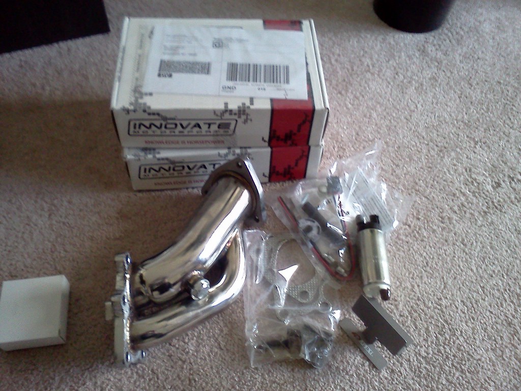

![]() megan track coils, catback, stut bars, sway bars, upper and lower control arms. All my turbo parts are slowly coming in heres some pics of parts and progress so far t28 of rb25 ![]() manifold ![]() Gauges, dump tube, walbro 255 ![]() cxracing fmic and piping ![]() ![]() |

Those innovate products wont let you down! I have the wideband and turbotimer in one unit and its awesome. How much was that FMIC?

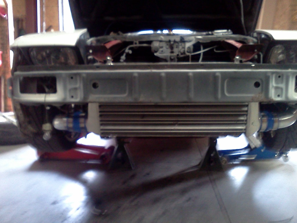

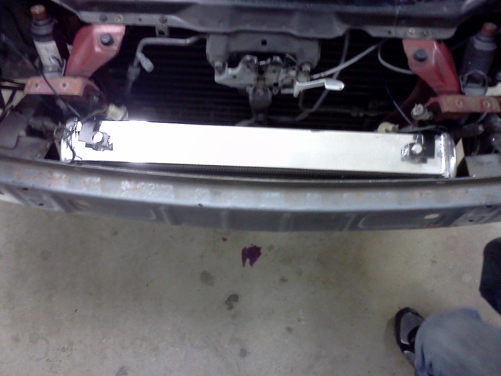

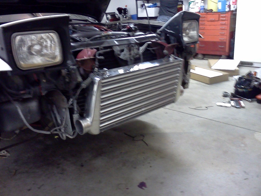

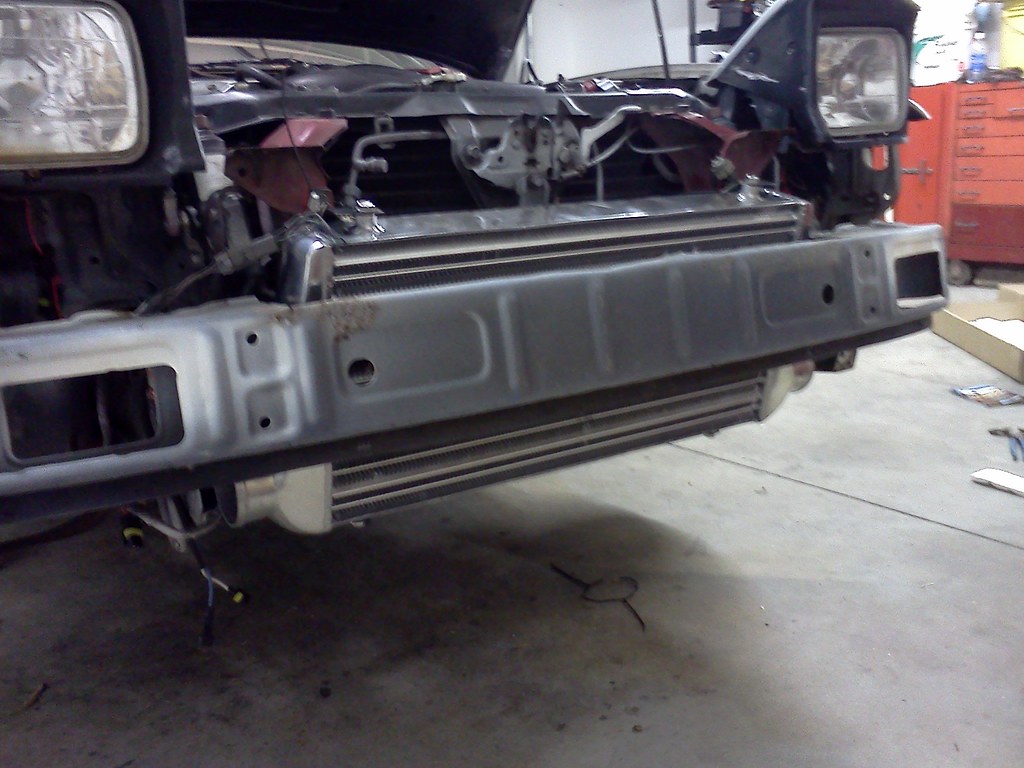

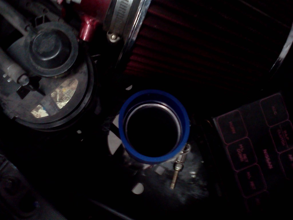

Mounted fmic

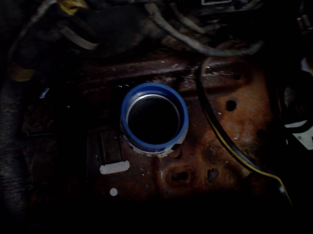

![]() Cutting bumper support to fit fmic ![]() Pretty damn close fit ![]() ![]() Cut holes and ran the intercooler piping for test fit ![]() ![]() had to rear mount battery for cold side ![]() |

My whole setup as of now is t28 rb25 turbo, fmic, sr20 370cc injectors, walbro fuel pump, and if it ever gets here apexi neo to tune adjust my a/f. My goal for now is 220-230 whp till i can build the bottom end.

Posts: 461
Oh and fmic was only like 200 shipped
it fits great to going to have the cut and weld the hot side bc its made for sr but bc im doin bottom mount setup i think ill only have to make one cut and weld |

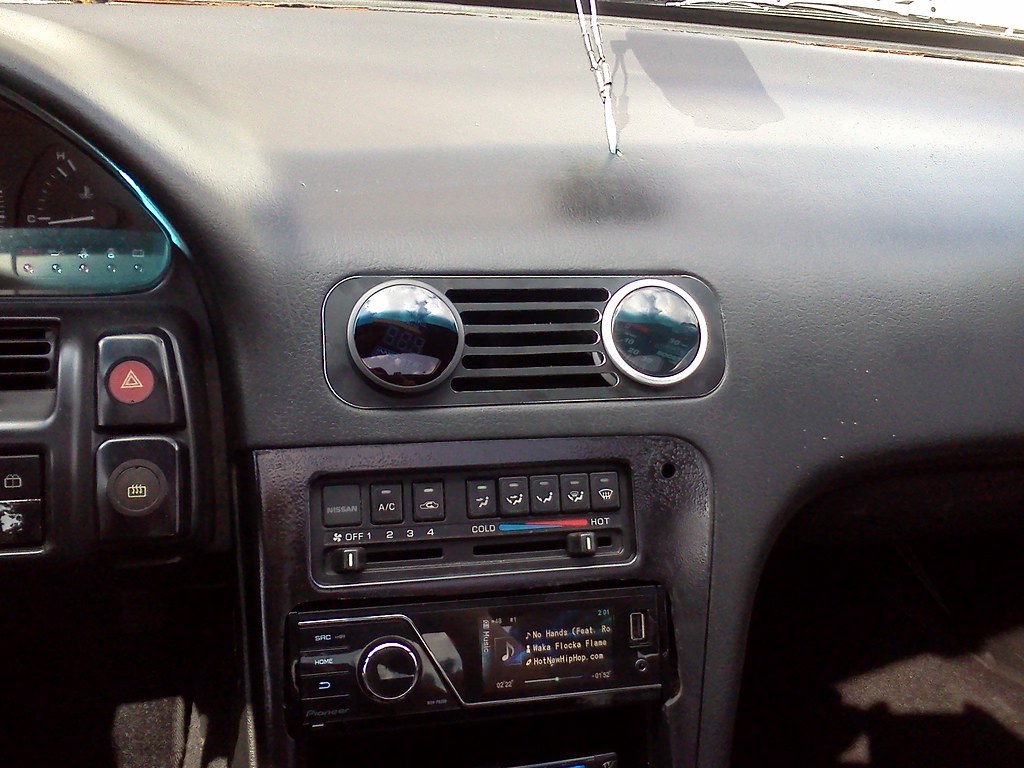

That sucks bro! pm me if you want one of those for your gauges my boy makes them and the fit like a glove. he can make it with a center vent like mine or for 3 gauges w no vent

You should consider just using an SR T28 and other T2 based turbos. The turbo and turbo elbow will not fit right without modification to the manifold and turbo elbow. Although, I'm interested on the outcome should you stick with your current setup. GL!

^ Thanks man. I wanted the sr t28 but for lack of funding i went with the rb. Yeah i can already tell that im goin to have some fun fitting every thing correctly. Im definately goin to have to clock the turbo bc oil feed is on the side and not the top
and ordered some reducers yesterday bc of how the hot pipe runs to the elbow. Its definately not been a weekend project hahaha. I just hope its ready for IA atl ![]() |

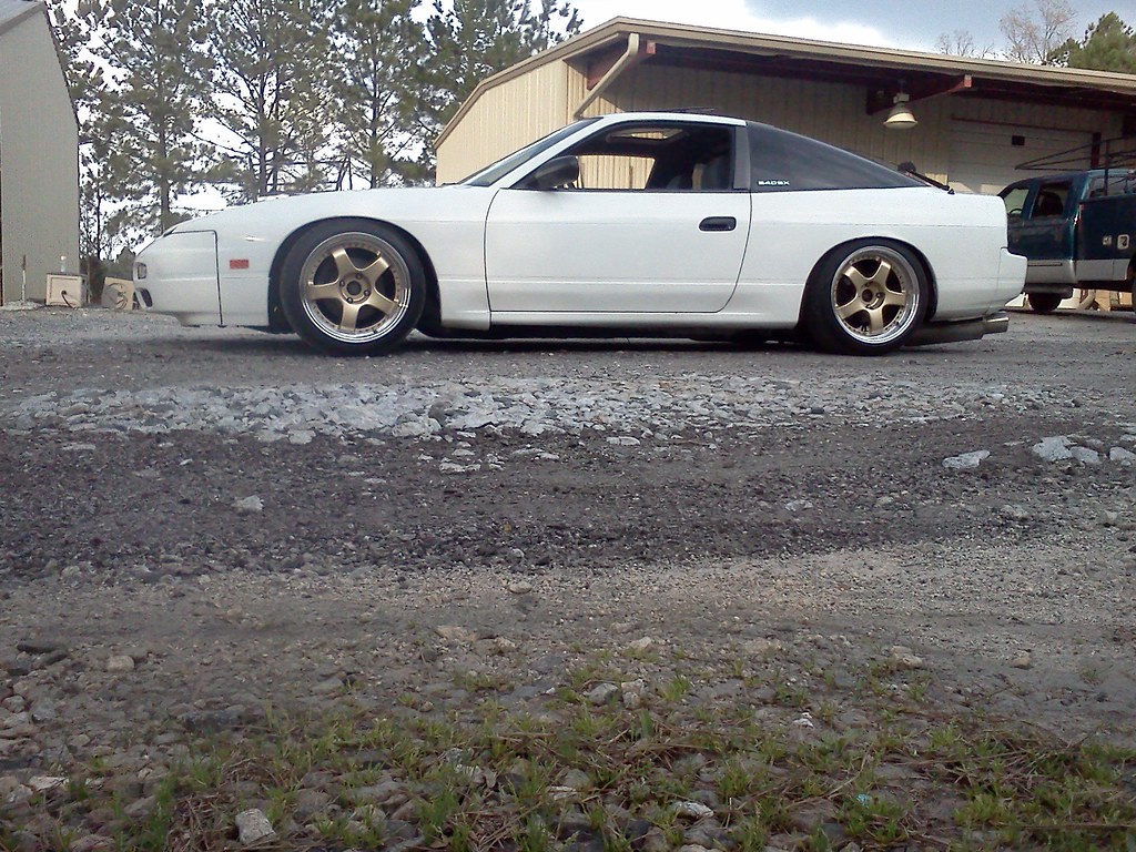

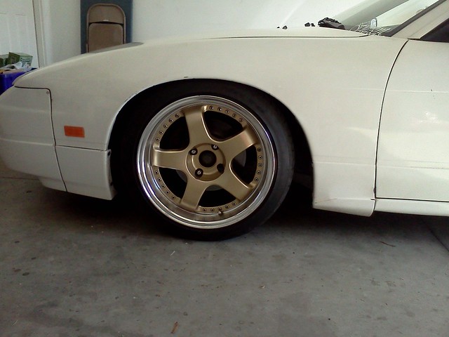

Maxed out front coils today, put 8mm spacers in rear, and got all my turbo electronics functioning - Apexi neo hks turbo timer innovate wideband and boost heres pics
![]() ![]() Front wheel ![]() rear super flush ![]() Last edited by c_mancuyas8; 03-27-2011 at 11:59 PM.. |
