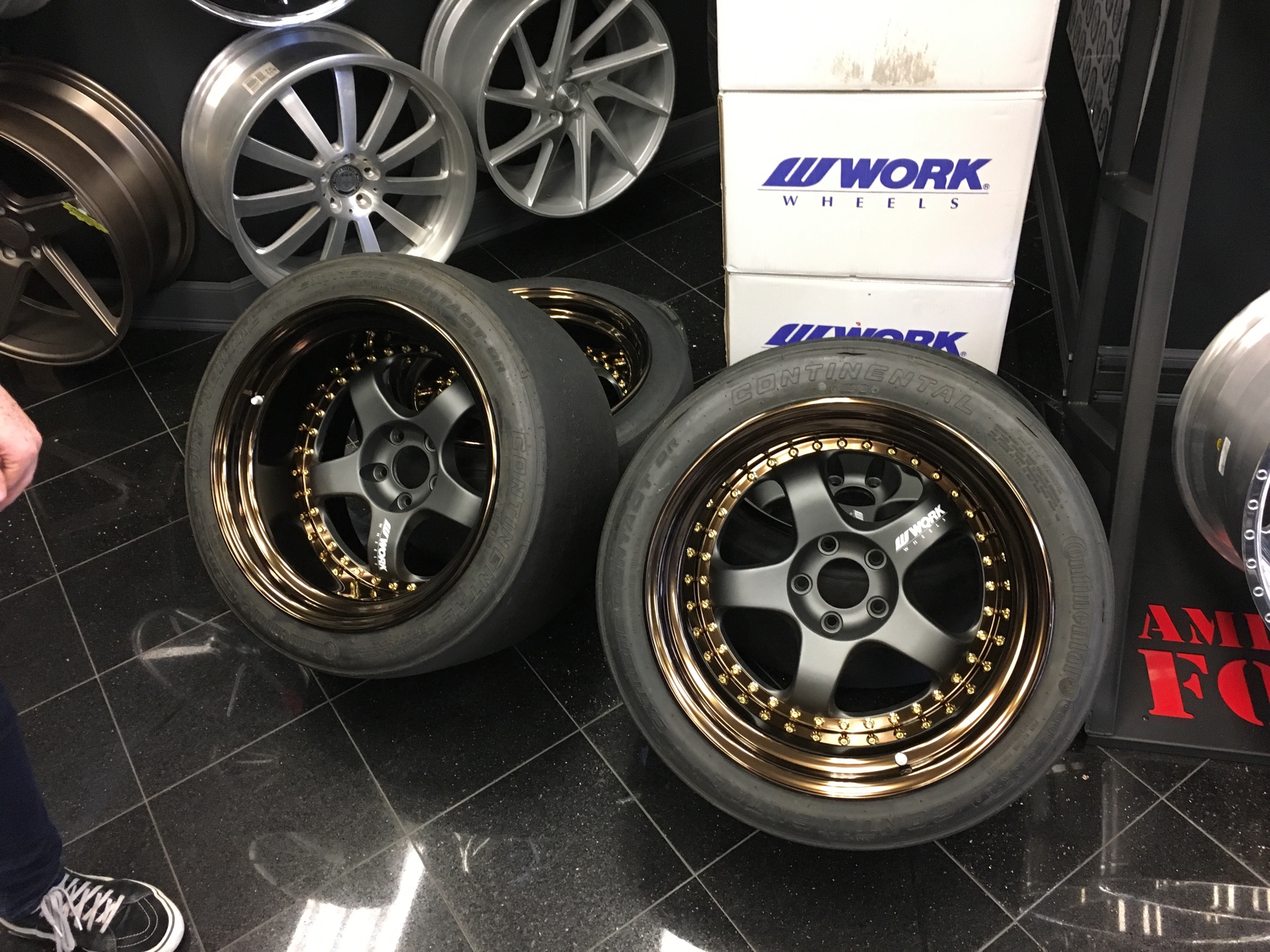

Received my blitz back from threepiece. They're now 17x9.5 +26 and 17x10.5 +26, one of the issues I'm running into is I have Z32 brakes, which cause the fronts not to clear the calipers. Any suggestions on what size spacer to run? I would be running stock front fenders, but I have no issues with rolling/pulling or even running larger fenders.
As for the rears they fit with no issues really, but the lip of the inner barrel is very very very close to rubbing the inner fender well. I'm sure I'll need to run a rear spacer also, but still don't know what size either. Any suggestion on what size tires I should be able to run with my stock fenders? I have no issues pulling and rolling them! Everyone I talk to keeps suggesting 235/40 for the rears but in not trying to stretch my tires. Pics for the people! ![]() ![]() ![]() ![]() Last edited by drfftn; 09-21-2017 at 09:37 AM.. |

255F & 285R minimum, can probably get a 305 wide tire on the back.
Spoke design effects brake caliper clearance more than raw offset numbers. Use the smallest spacer you need to create clearance, a 5mm or 10mm should be plenty. Z32 calipers aren't exactly huge. |

Thank you for your suggestion! I failed to mention that the set up is going on a 550+whp ls3 s13. I was thinking of doing 255/40/17 for the front and 285/40/17 for the rears. Cannot find any tires that are 295 in 17's that aren't slicks. |
