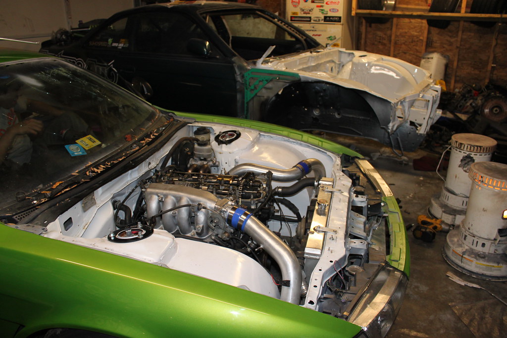

Razmus car is almost complete. I had to share this picture of the white engine bays next to each other.

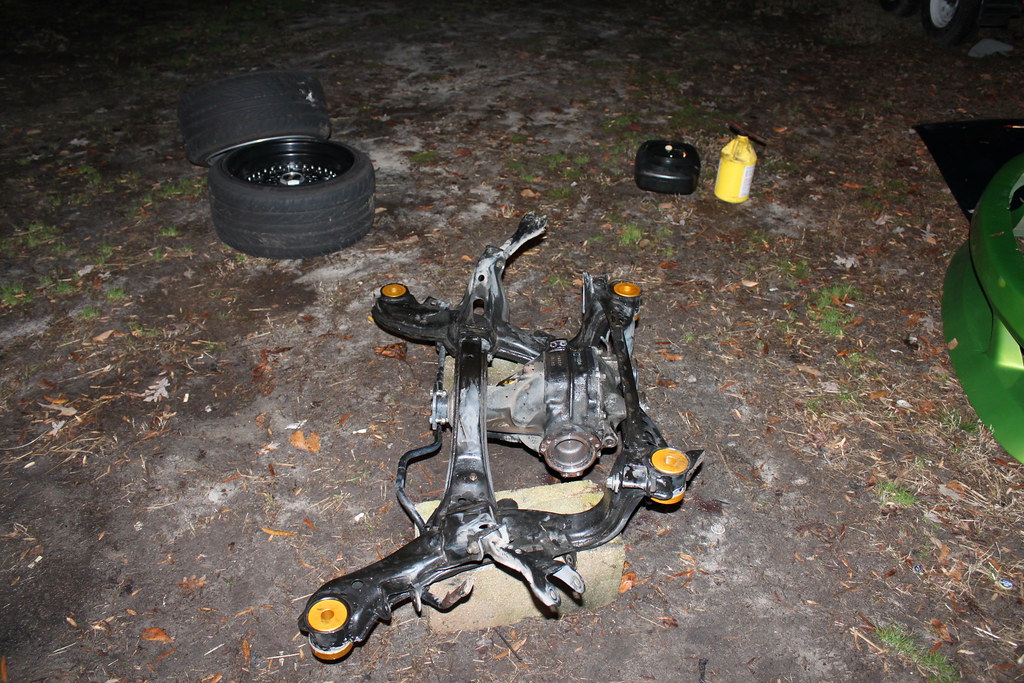

I will have a ton more pictures of the susppension mods that will be going on this car. Im pretty sure a handful off people are doing what we are about to do.
Subframe with PBM solid yanks

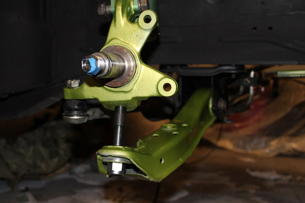

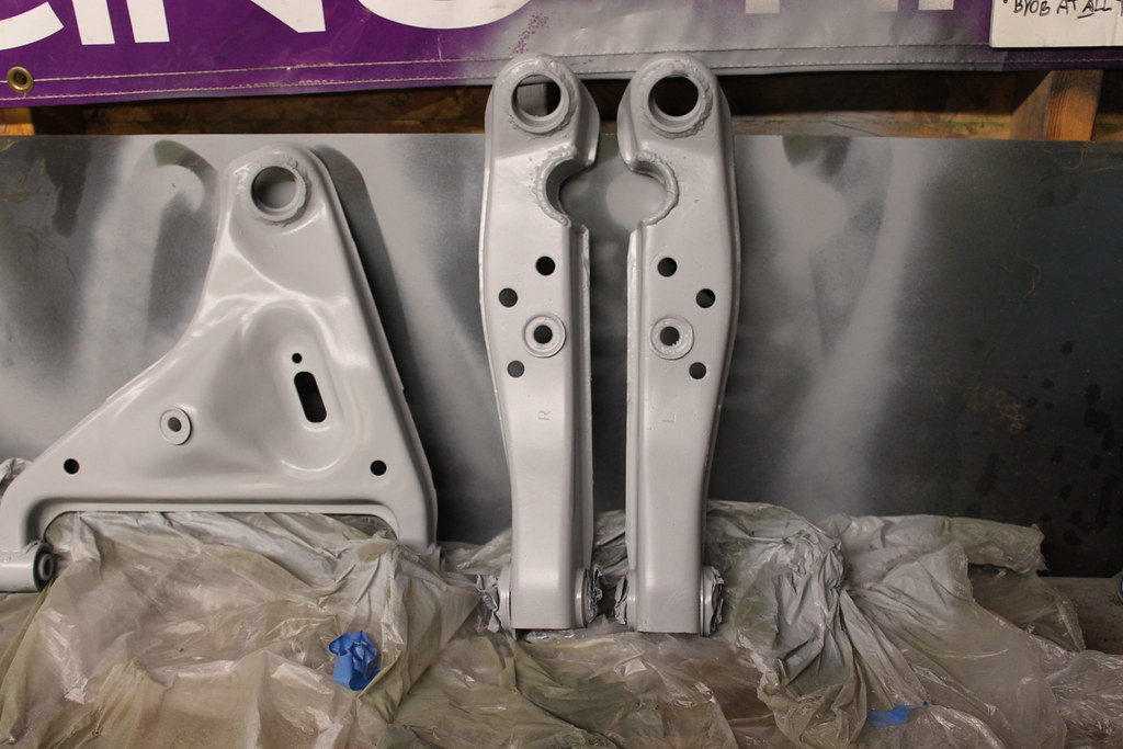

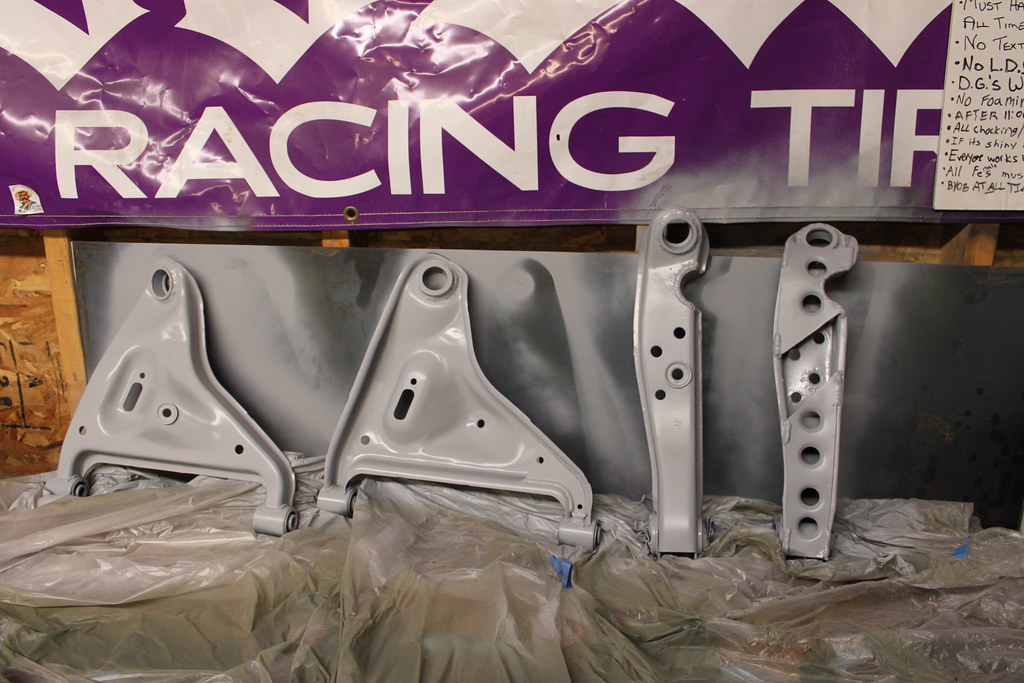

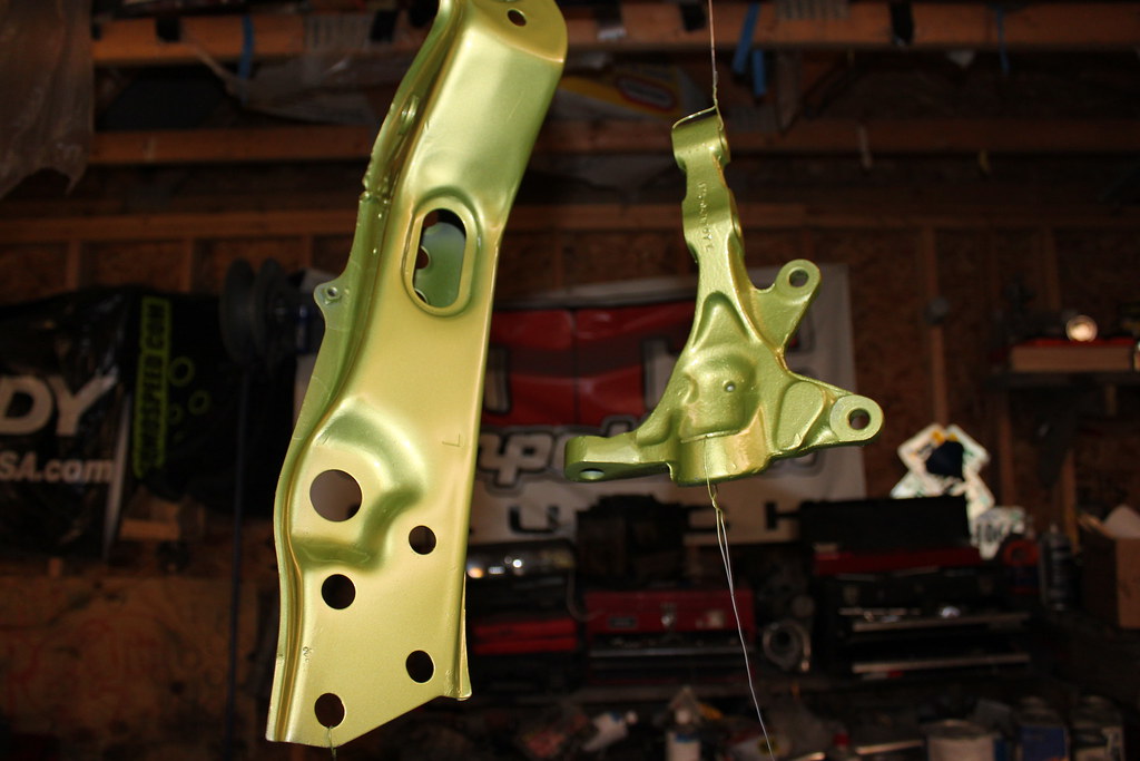

SUSPENSION:
Got the lower control arms done. They received a momo ball housing, boxing in, and notching. We are hoping for more than 55* off angle at full lock. Right now with my knuckles we are at 51* at full steering lock.

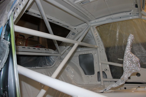

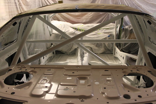

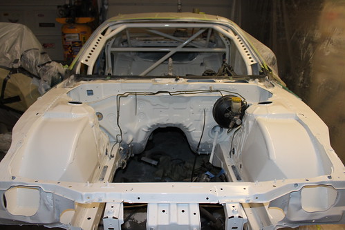

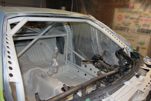

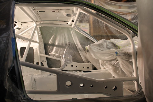

S.knoop and razmus prepped the interior yesterday until about midnight so i could shoot the cockpit.

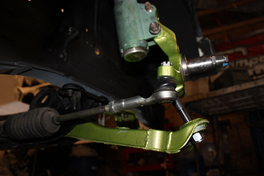

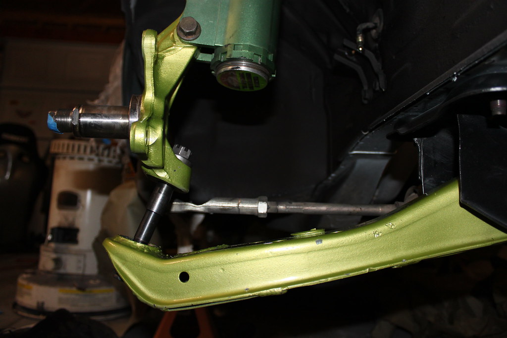

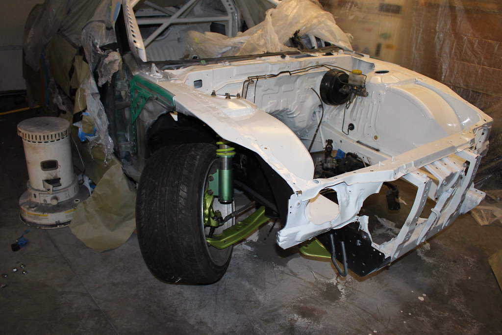

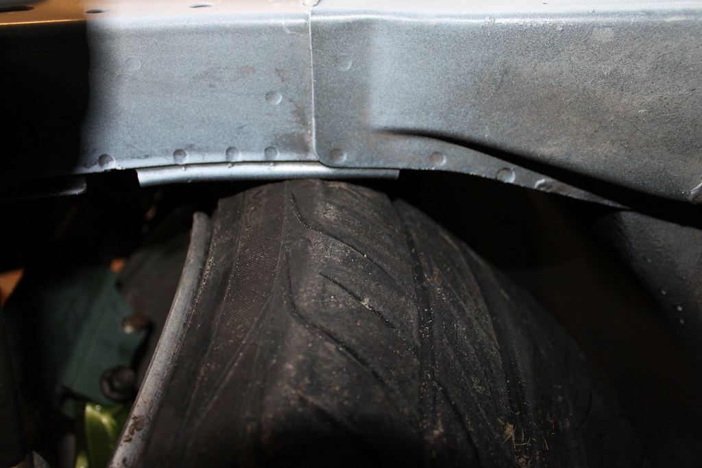

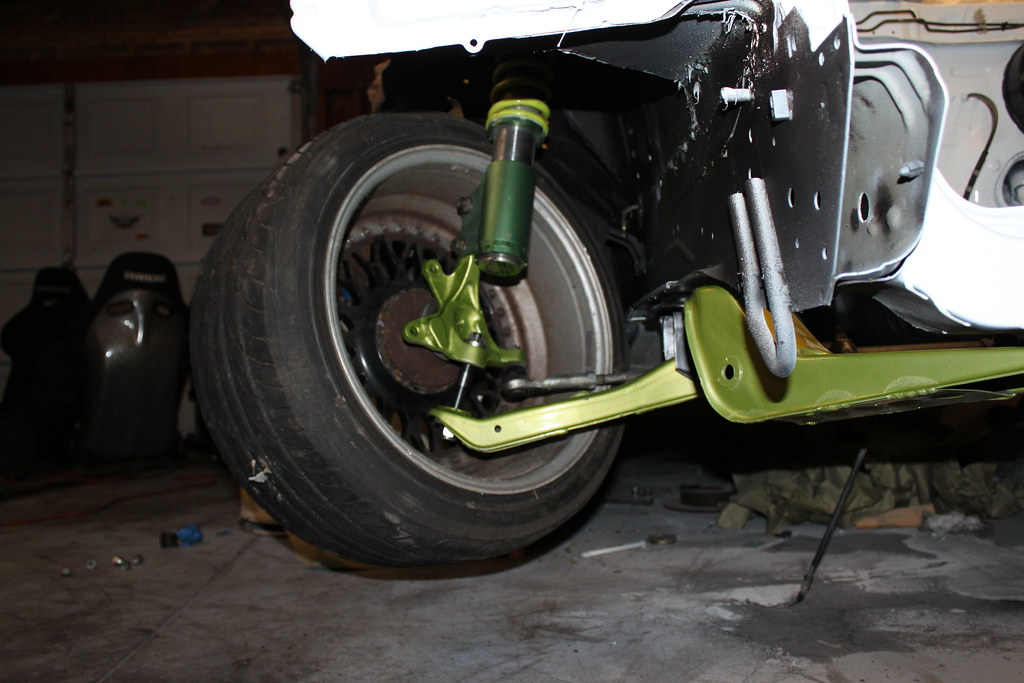

modded s14 RE_spec super angle knuckles with modded lower control arms to hopefully correct the suspension geometry of a lowered 240.
Everything on this picture is not fully bolted down and missing a few bushings and spacers for the GM ball joint. We will get the car on the ground this weekend.....
We still need to mod the tierod pick up. We plan to use another spherical bearing with a bolt to lower the tierod parallel to the lower control arm.

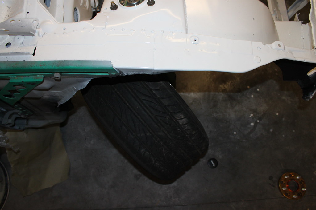

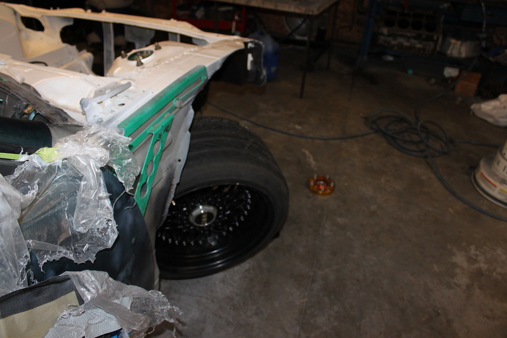

BBS SHOTS. Nothing has been bolted down yet. I took these pics to see what other mods need to be done to pull this off. These are picks at full lock. Well not really beacause these wheel are gianourmous. I still had about another 3/4's on the tie rod to steering rack travel.
