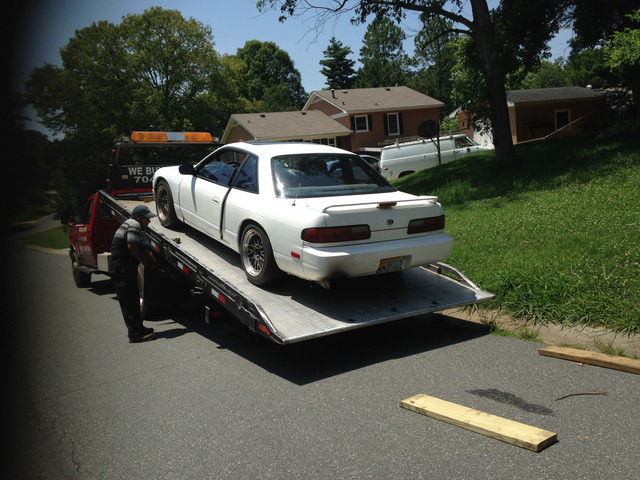

I picked up this coupe after moving to Charlotte NC and selling my fastback to my roommate. It had a blown ka and it was a bit dirty but I felt like it was the best base I could find locally for what would eventually be my DD.
Enter 1993 Coupe.
I didnt keep the xxr's or the Tein basics that were on it.
