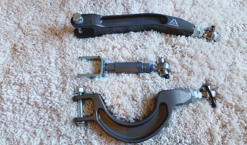

Bought Voodoo13 RUCA, Rear Toe Arms and Rear Traction Rods. Love how light these are. I originally was planning on buying Powered by Max arms but watched a video showing how heavy they were and decided to opt out. Then I found out about this company.

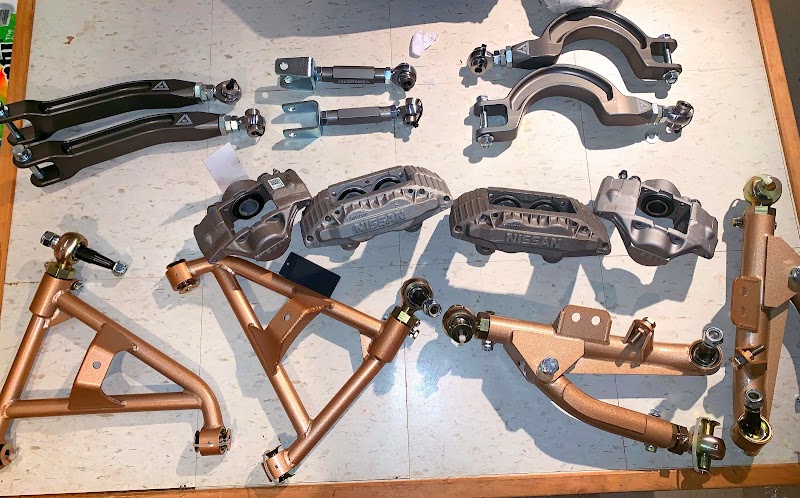

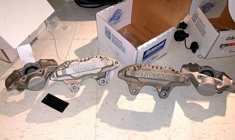

Then I decided to get Z32 Calipers. I've always had stock calipers with autozone cheap brakes and rotors. Braking with those on the car with a RB20 was sometimes a nightmare. This upgrade was much needed. Not sure what color I want to paint them. Thinking Gold or a Dark grey. Originally wanted to go with Red but I think thats overkill. Idk.
Took a picture of all the parts I had at that time

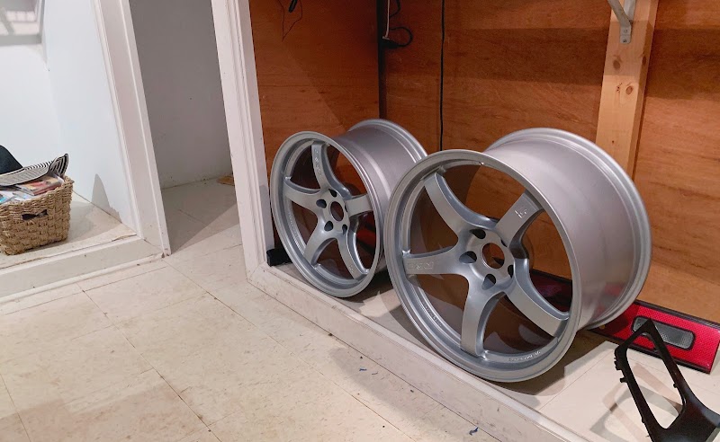

Thennn I finally bought me some new wheels. Gram Lights 57CR
Rears are 18x10.5 +12
Fronts are 17x9 +12
As you can see I got them in different colors. I ordered them both gloss black but Mackin Industries messed up and gave me my front pair in gun blue. Thankfully I was planning on getting them Powder Coated.
Originally I wanted Advan TC3's however they only run in 18's. I only run 17/18. I looked at other 5 spoke wheels such as Work T5R, Mesiter S1R and Enkei's new PF05 but I liked the Gram LIghts 57CR the most because they looked very similar to the TC's.
So I sent them out to get stirpped and powder coated.
Now I've been tempted to paint the "rays" and "57" black but I think I might cheat with a Die Cut sticker if I give a company the dimensions or I might just leave them as is. We will See.

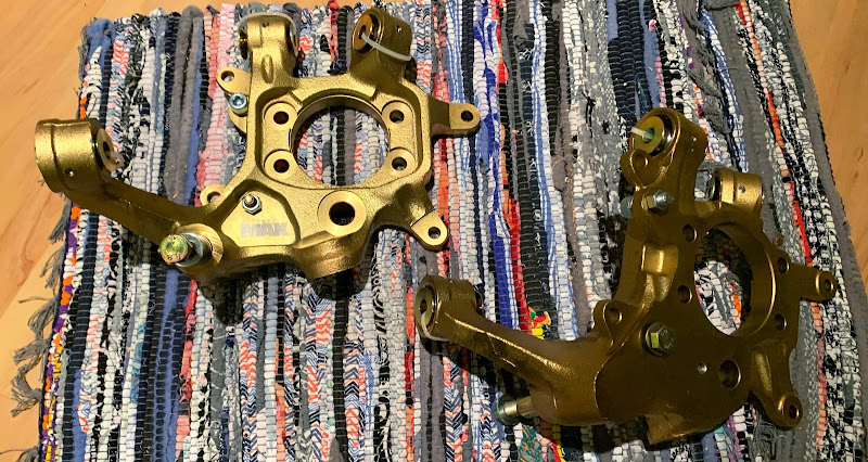

Lastly for this update I bought PBM Drop Knuckles.
