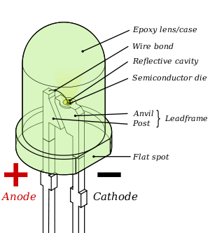

If you sand down the dome of the LED so it's flat it should disperse the light a lot more.. Sanding the exterior in general will help do the same thing.. Just make sure you don't sand to far that you hit the bond wire and/or the die..
(picture to show what to avoid breaking)
