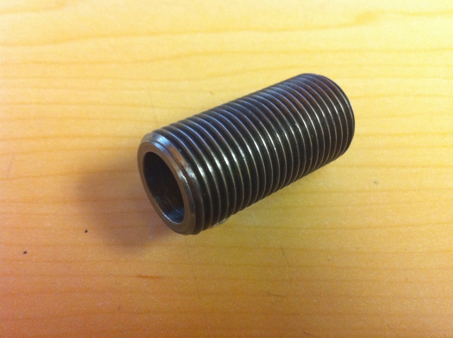

TBH I don't have any data at all anymore, it was all deleted - however I don't really remember if I had the same issue with a hood or not. Next event I'm definitely going to try to run a hood with the rear spaced up, though I will say when I was cruising around town with a hood and bumper I was having an issue for sure. An oil cooler was another thing I was thinking of, if I remember correctly the stock "oil cooler" runs under the block or something crazy. I think that deleting it will make a huge difference if I run an aftermarket one. Thanks for the suggestion!! |

Sounds like you've got a plan though, try out different things under the same or similar conditions and see what they do. Each setup is a little bit different, so what works for some may not work as well or at all for you and visa versa. Also, change one thing at a time if you can - some people get caught up changing 2 or 3 things at once, and then you never really know what 'fixed' the problem. Here's a random picture from the net that shows the oil cooler block and oil filter pretty well: (Intake manifold was removed) To eliminate the cooler, you can more or less just loop the water line into the block without ever going through the cooler assembly - from there you can run a sandwich plate or whatever to run the external cooler. If you want to eliminate the cooler assembly entirely (worthwhile, IMO) then you'll need to find a pass through stud for the oil outlet in the block. IIRC, it's a 3/4-16 Thread, and needs to be approximately 1" long with ~12-13mm hole (1/2") through the center. There's a ford part number that fits the bill - it's E8ZZ-6890-A, or you can make your own like I did: ![]() If you've got access to a lathe or similar, making your own is trivial, I bought a 12" long threaded rod and had it all done for less than the cost of the ford part. |
