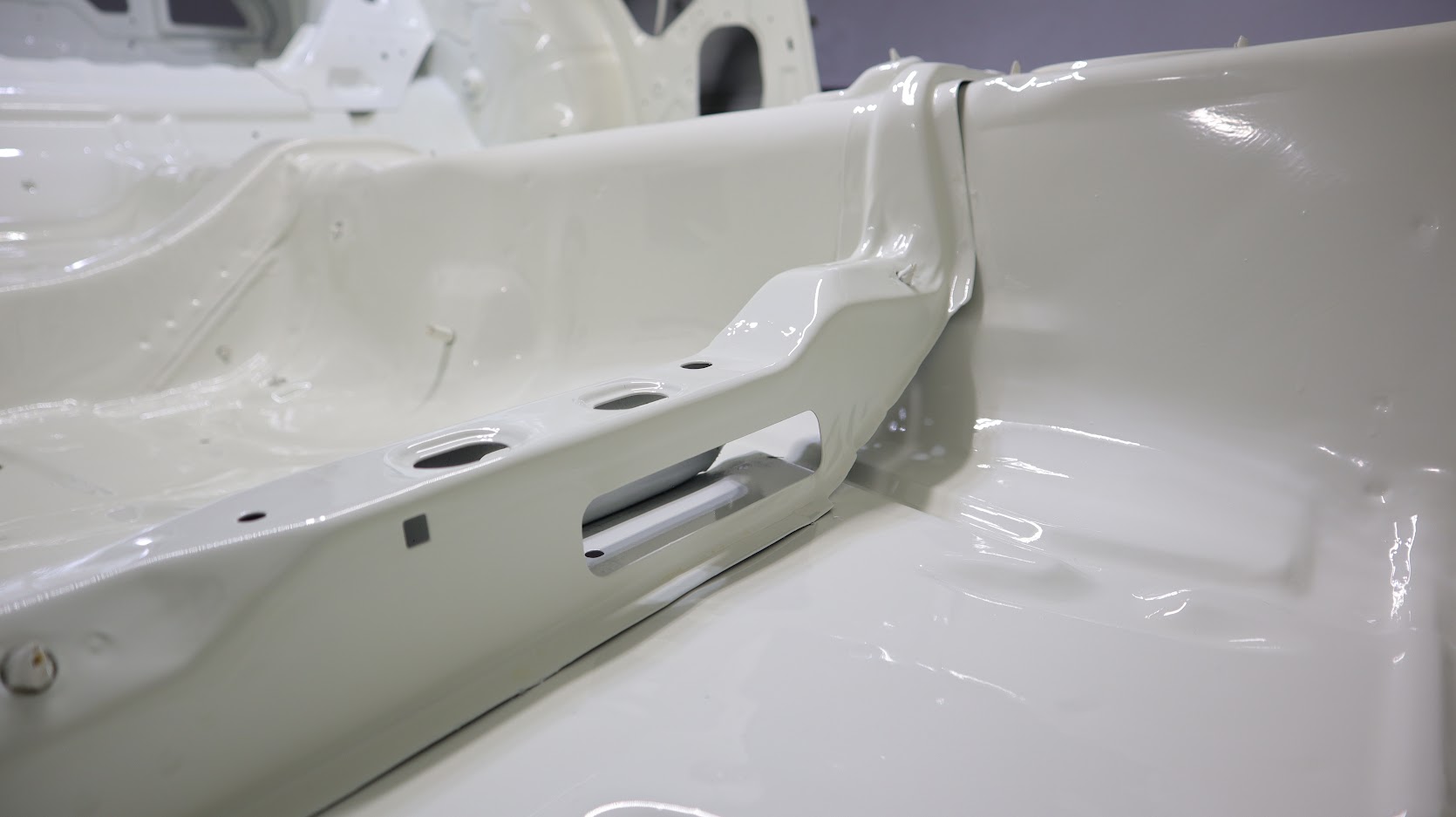

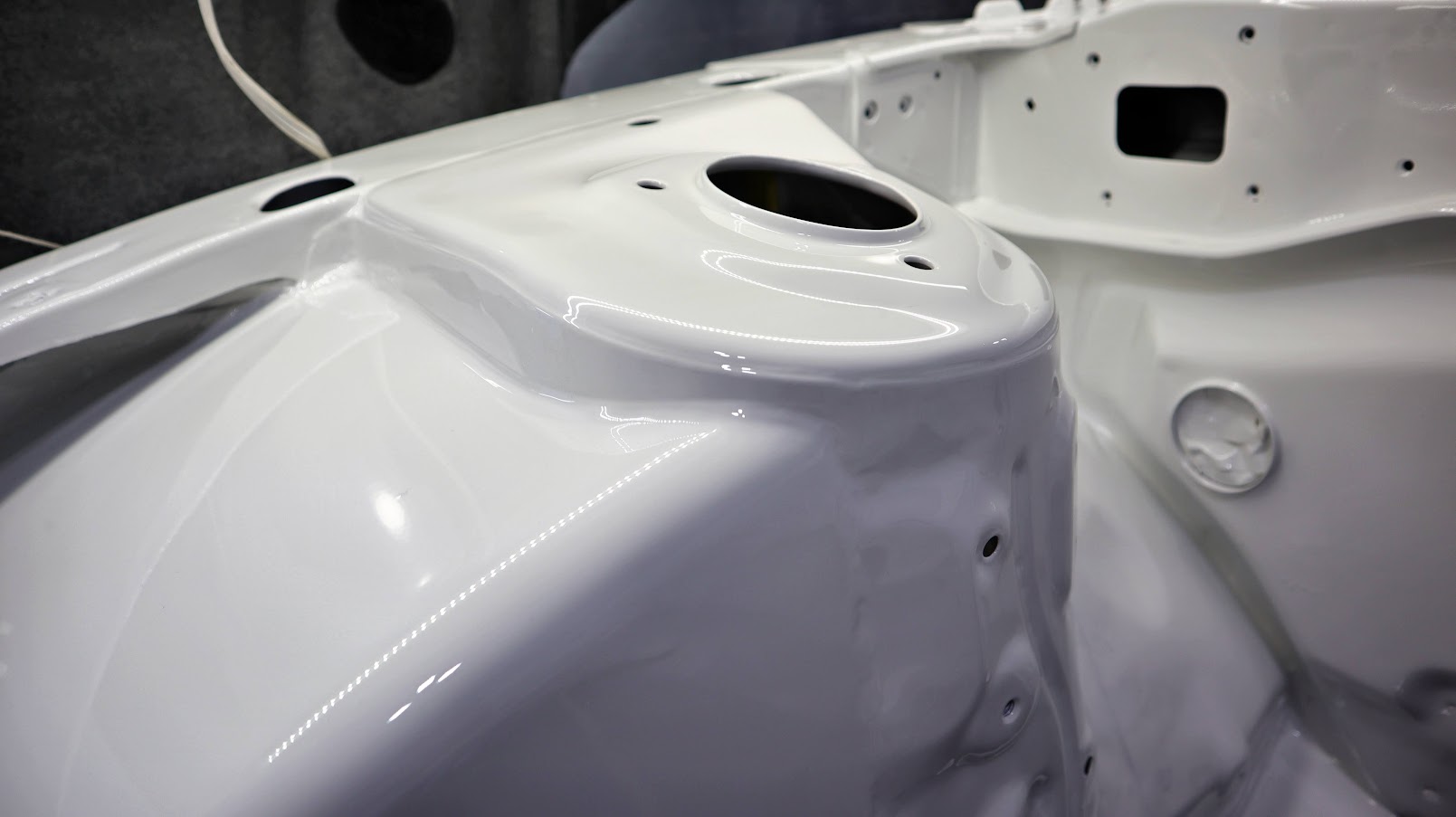

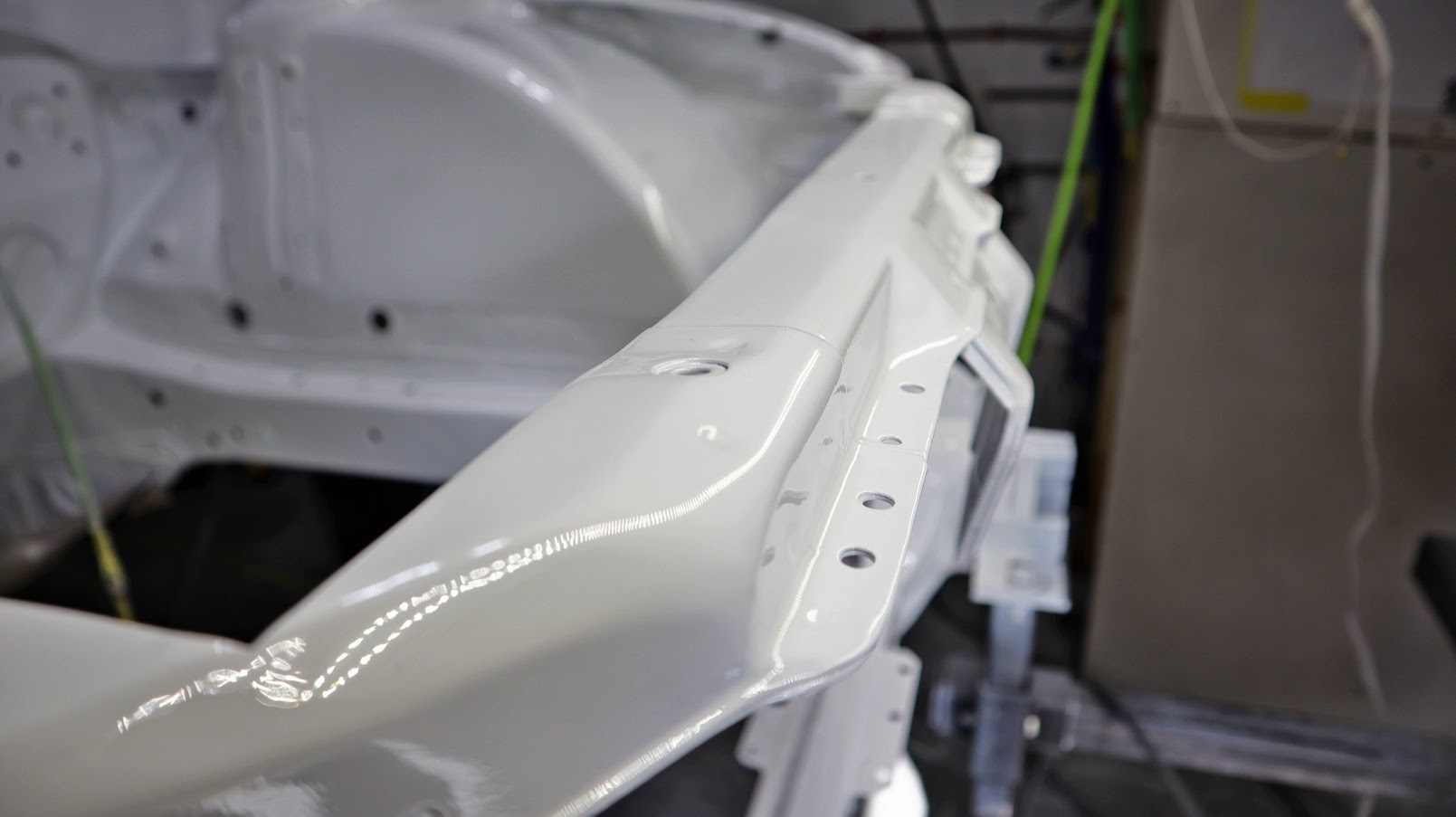

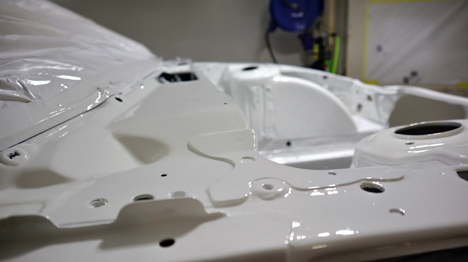

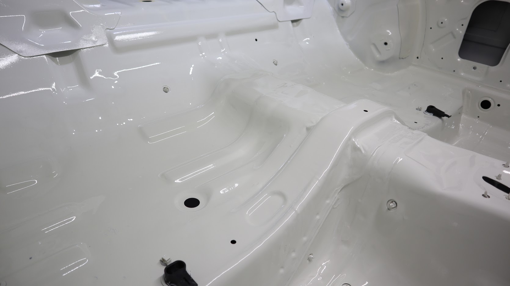

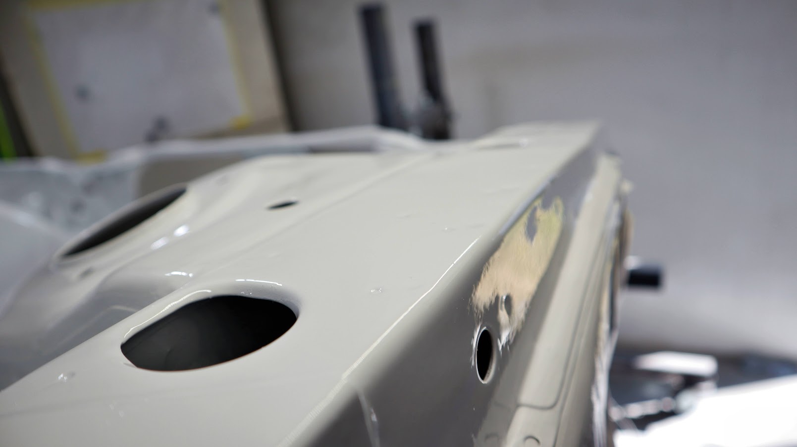

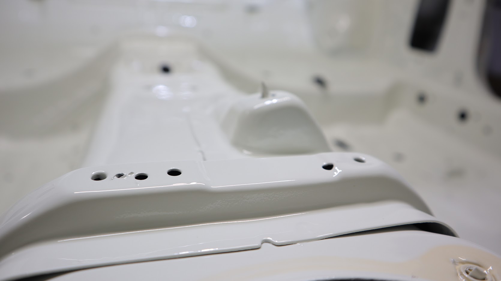

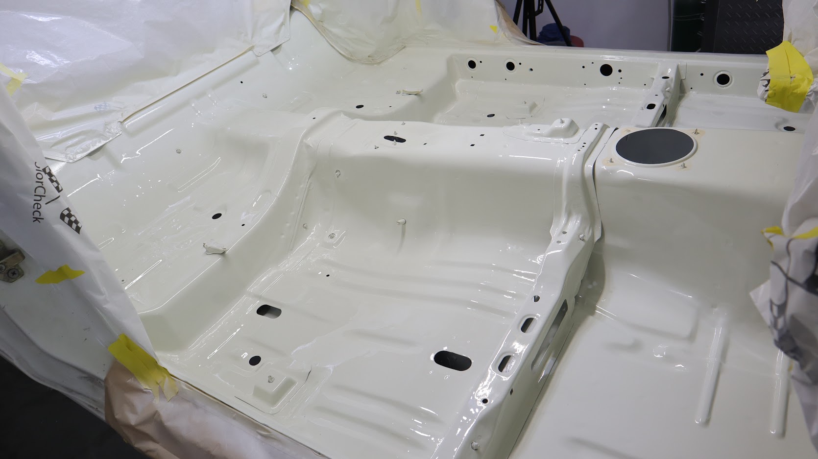

Hey, sorry about no updates. Been doing some side projects for some friends.

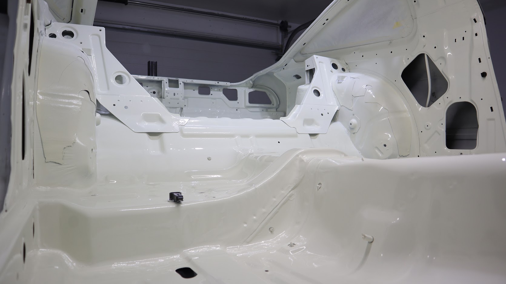

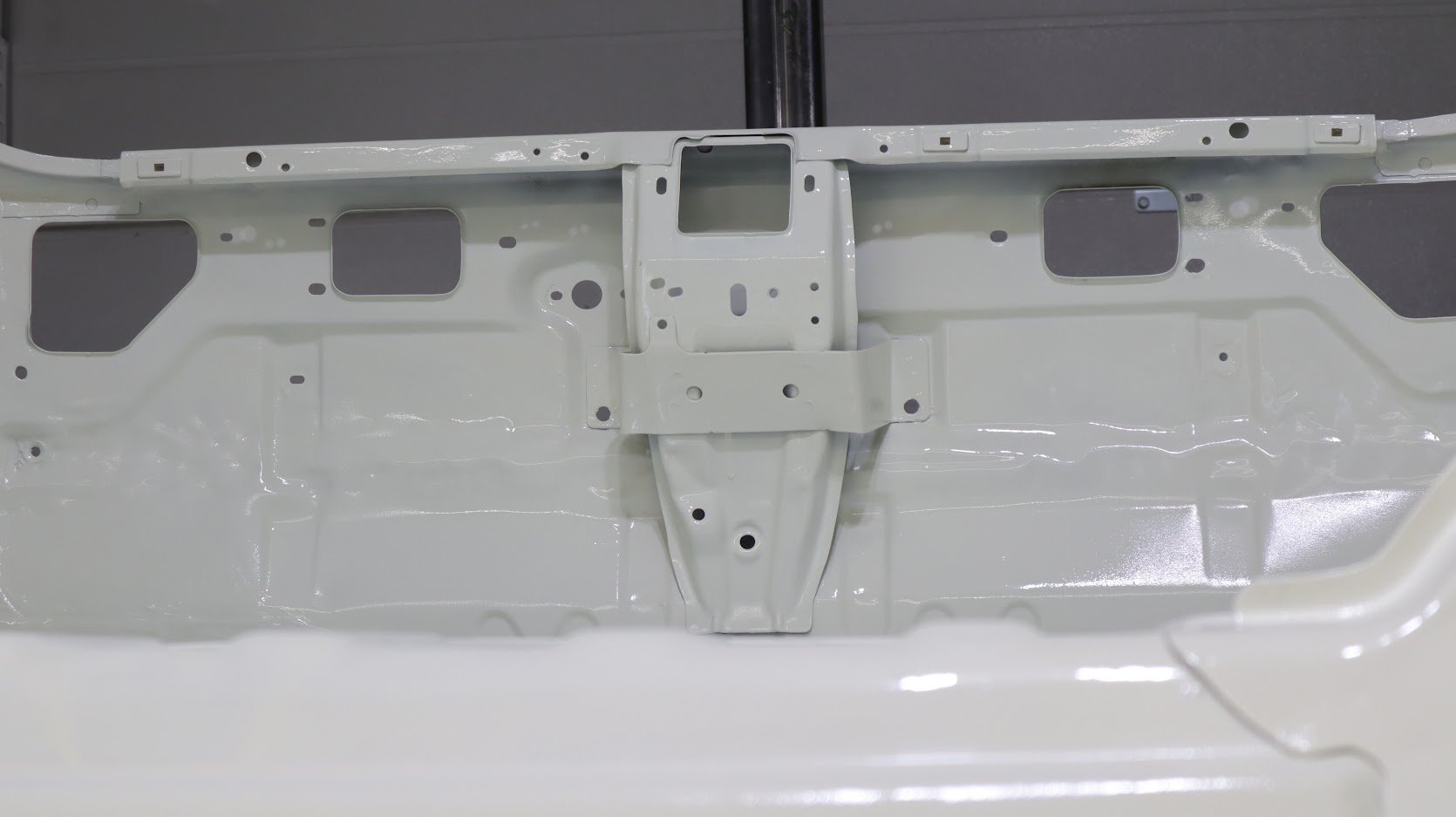

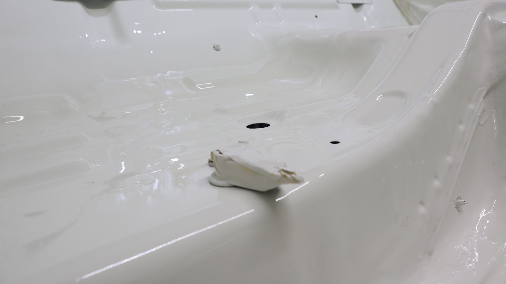

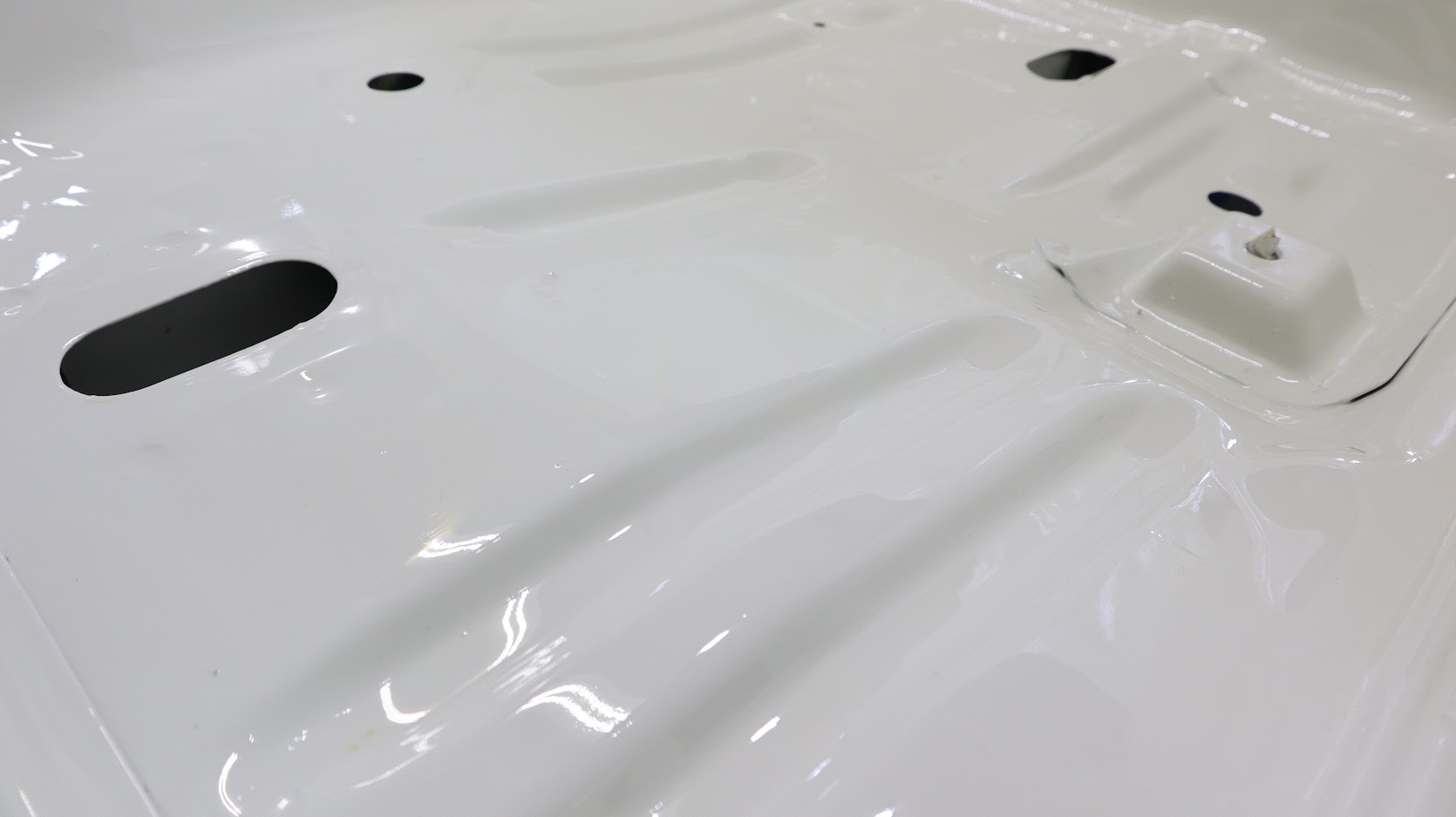

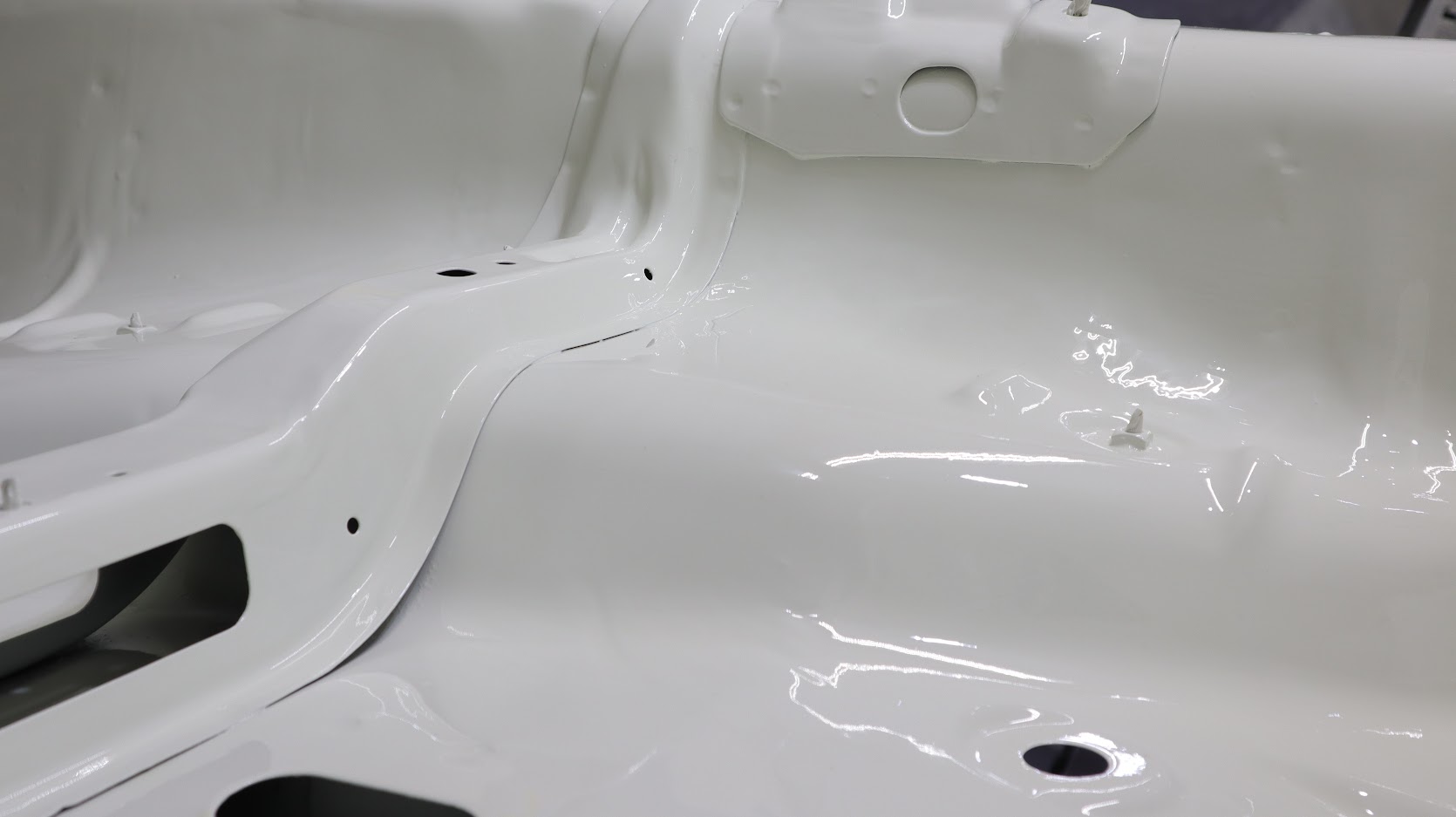

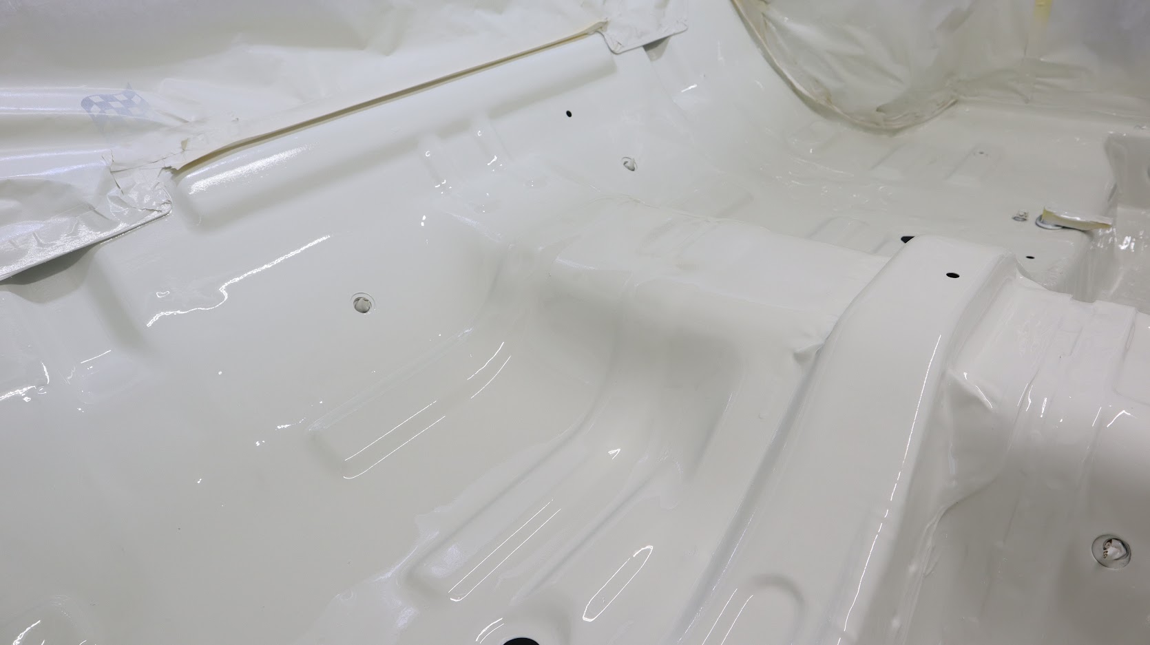

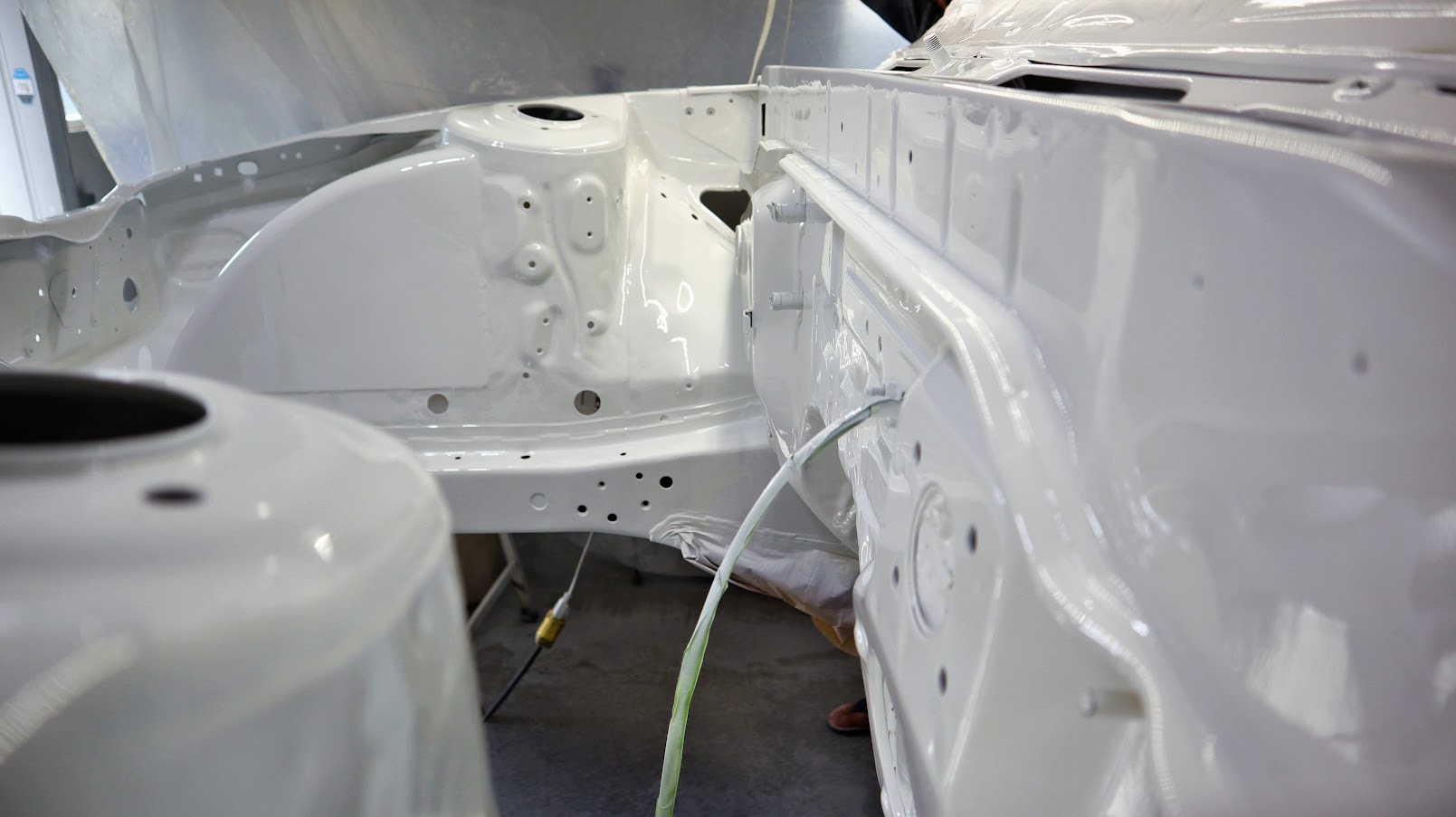

Anyhow, I finally painted inside my 240sx. I used 2 stage paint, so that means a white base coat followed by a quality clear coat. My favorite part is where there is seam sealer but it's smooth. ( all bottom panels have been stitched with 1 inch beads by the way ) All this won't really matter anyways because it will be cover in Dyna mat and full interior. Also you can see in the first pic why it's masked off. I originally painted the rear section of the car and all sections above, allowed that to dry over a week and then masked that all off and just focused on the front half of the 240sx. This allows me to put down some nice coats without having to reach so far and potentially touch the wet paint, it also keeps the fumes down. Enjoy these photos...

That looks fantastic.

Not even the factory looks that good. So clean!!!

That looks beautiful.

Thanks guys!
Spooled240 , I stitched the front end of my chassis and all bottom panels been stitched with each other and stitched to the side panels.

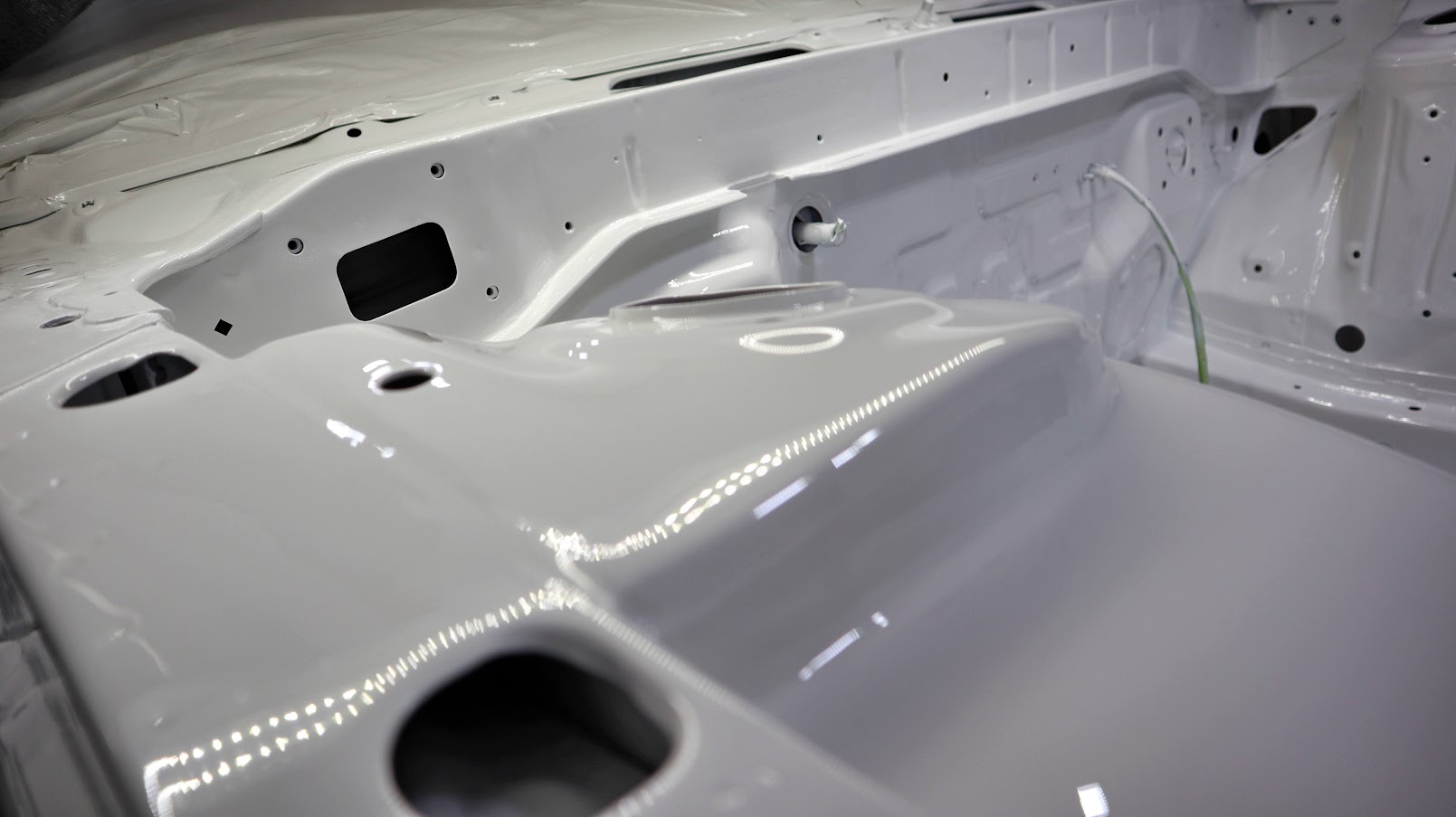

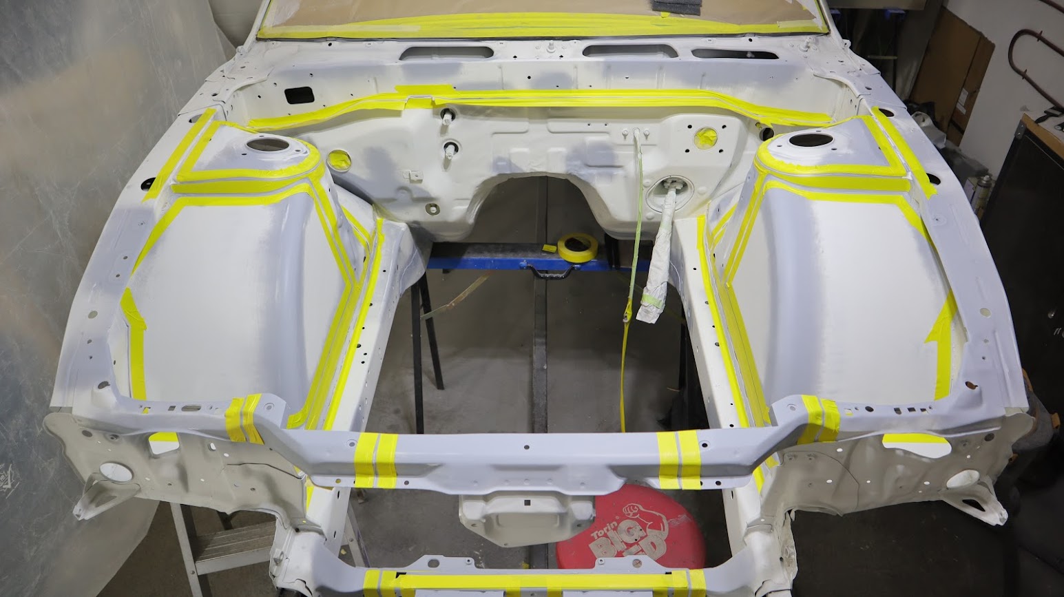

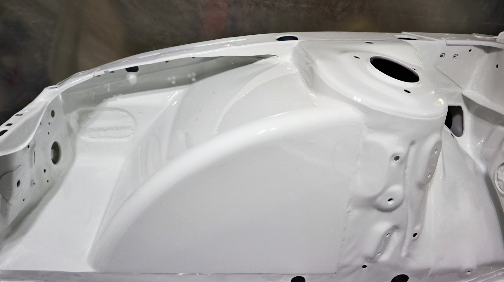

koukis13 is a jewel in the roughkoukis13 is a jewel in the roughkoukis13 is a jewel in the roughkoukis13 is a jewel in the roughkoukis13 is a jewel in the roughkoukis13 is a jewel in the roughkoukis13 is a jewel in the rough

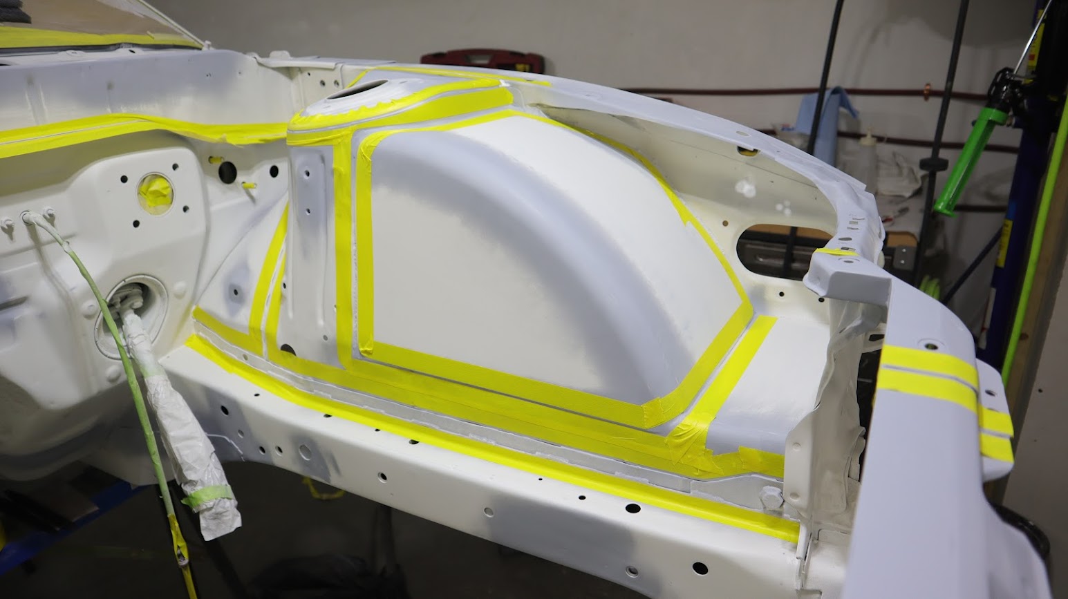

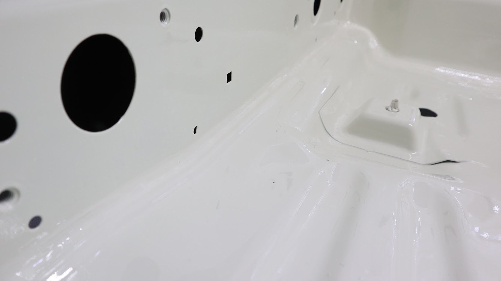

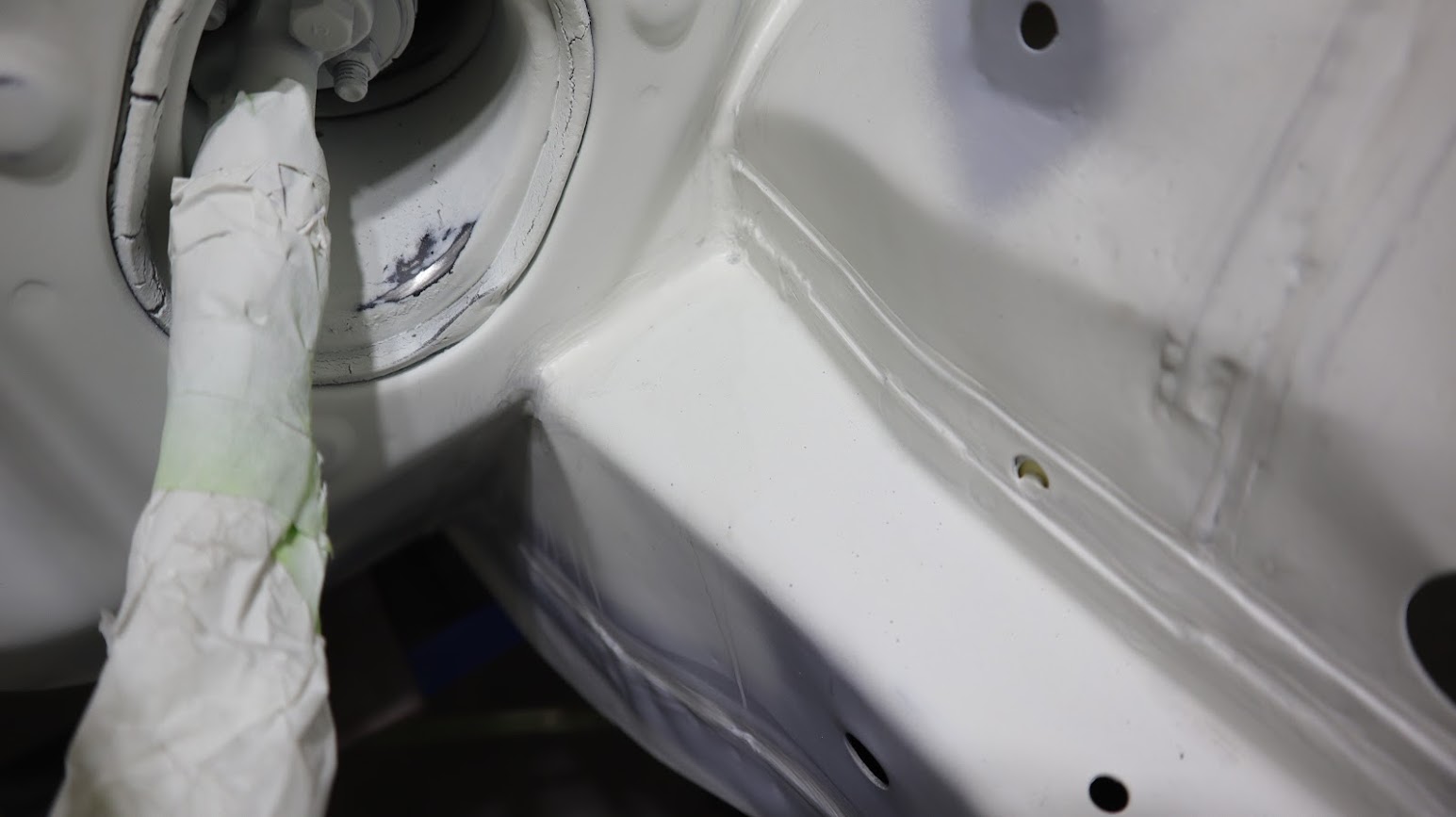

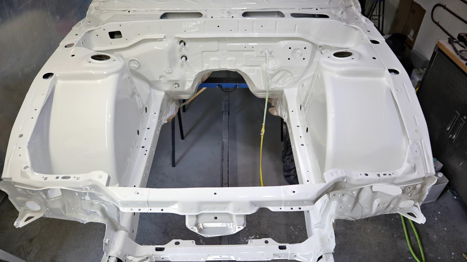

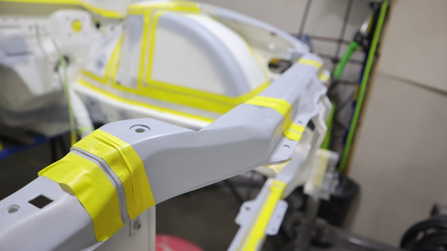

Hey Guys, I'm still alive. Just took a long break from the 240 as summer was pretty hot and busy. But, I'm back at her again. Pretty much used 3M sanding guide coat on the entire engine bay, blocked everything smooth, wipe it down with wax and grease remover. Started masking everything for seam sealer. Also there is these two gaps at the top of the frame rails in the engine bay, I think Nissan really fucked this up. The gap allows water to go inside the frame rails and rust it over time. Especially on the Driver side, Brake fluid will drip in there and started deteriorating the paint which allows water to start rusting metal. So, I SUGGEST YOU ALL GET SOME SEAM SEALER AND PLUG THAT BITCH UP.

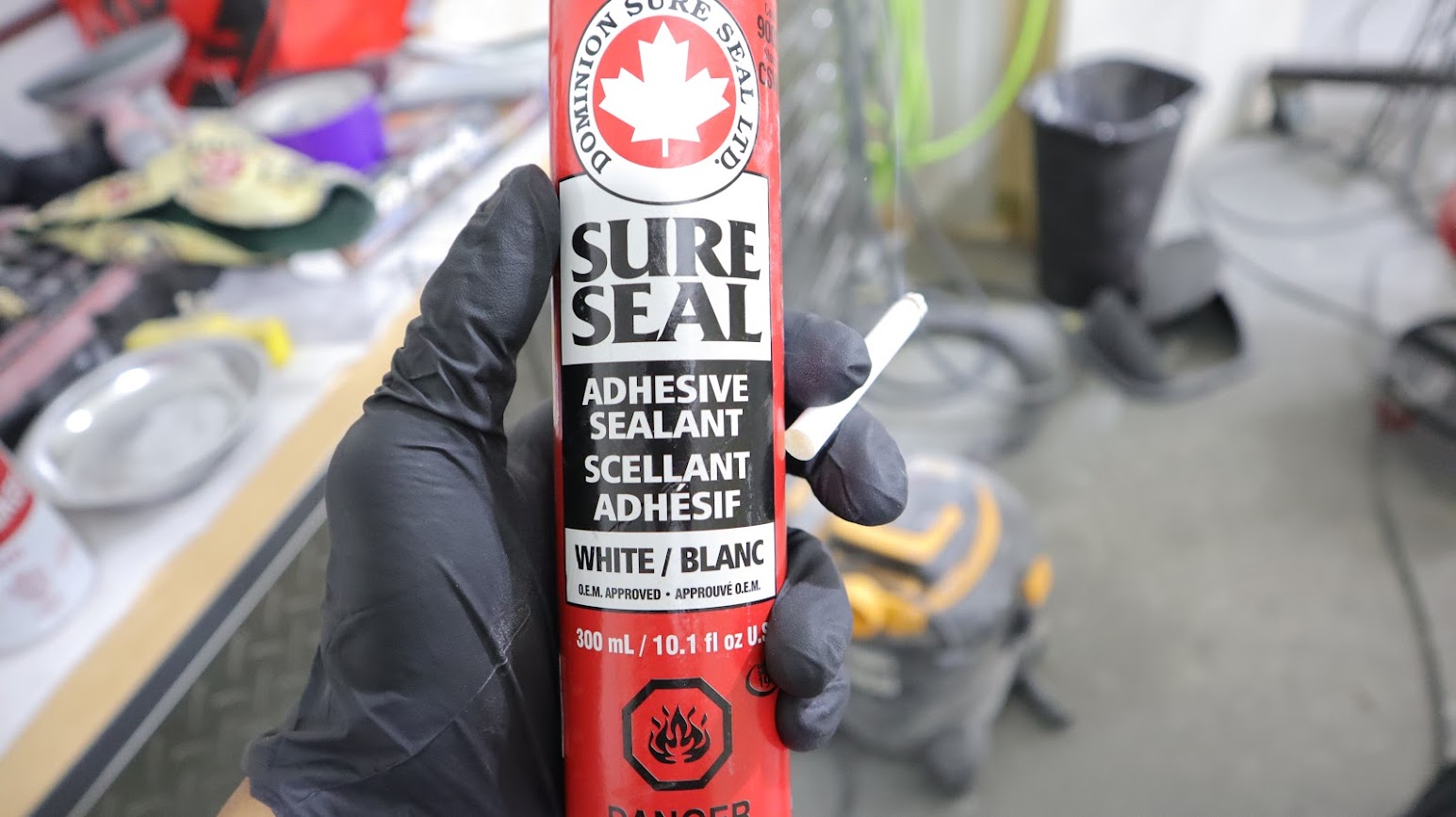

Very nice work here! I like the picture of you holding sealant with a flammable symbol and a cigarette in the same hand lol.
It's more exciting when I'm smoking and pouring paint thinner.

Okay guys... So Exactly 1 Year ago, I made all the fab work for the front tubs... The proper preparation got it to where it is now... Painted my engine bay in a Toyota Super White II . By the way, the front end has been stitched, most of them all under the body out of sight.

Great work! Looking forward to see the rest

Such gloss! That is a fantastic looking bay there sir. Well the entire chassis actually hah. What are your plans for the car? I see you mentioned 2JZ, but is this thing going to be a nice weekend kinda vehicle or?

Most likely going 2JZ and yea, this will be a spring - fall daily!
