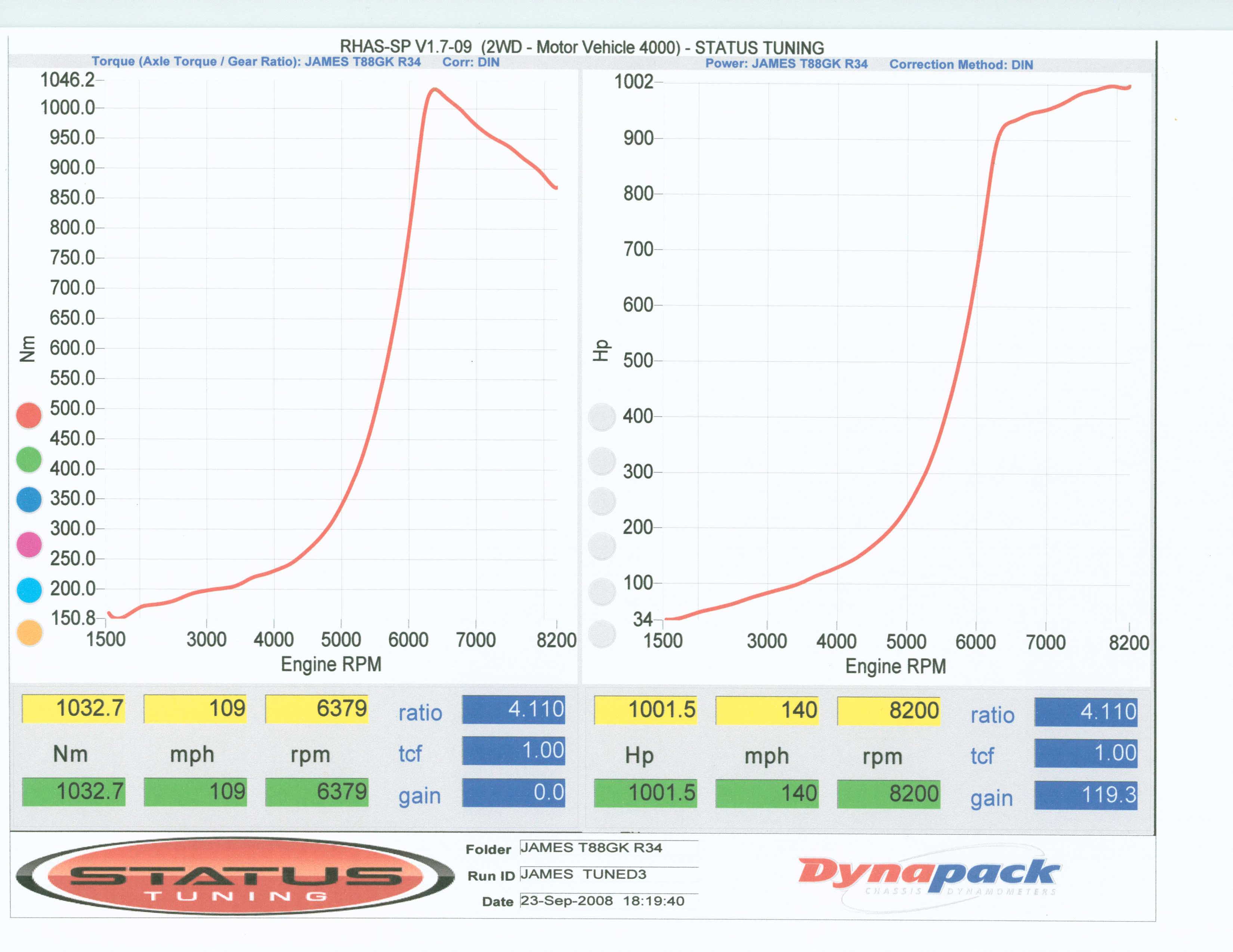

For a simple setup Power FC always. I Dont know why people bash it so much it works its efficient, they even have D jetro option map sensor, iat, and if you get a maf ecu depending on how you wire the harness its plug and play with the exception of wiring in a iat map, again Djetro only.
Haltech plug and plays for rbs are not as good as people say they are especially for the price. AEM v1 is trash my tuner calls AEM EMS minus the new infinity Almost engine management....
track cars with aim dashs cool as switch panels data logging etc aem, haltech, motec, all the way, cars that are driven everyday that want to keep all the stock components and still have fun you cant beat power fc with the fc datalogit....
tell these tuners that run there cars hard that power fc is too old and not cutting it
feed rx7 still uses power fc granted the T04z was ditched for a GCG unit
http://www.youtube.com/watch?v=ZZ3Ms2JLh_4
"PFC cant handle high hp applications"
http://www.sau.com.au/forums/topic/2...-18cm-monster/
