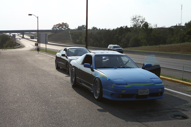

So at the beginning of the month, I decided to drive both the cars that I own (with my brother and his GF driving the other car -my Integra) back to Ontario, Canada instead of shipping them back since it was going to be 1K, each car and I couldnt load up my stuff in them if I shipped them.
I said screw it and decided to take the risk of driving my 240 that had less than 300miles on the engine and a minty fresh new paint job. What's the worst that could happen right?
What I failed to realize was just how hot the desert was at this time of year and not having AC in either cars was bad but there was much worse to come.
We left LA at 6am in the morning and got a good run outside the city heading towards Arizona on the 40 east. Things were all fine and dandy. This is the first gas station we stopped at.

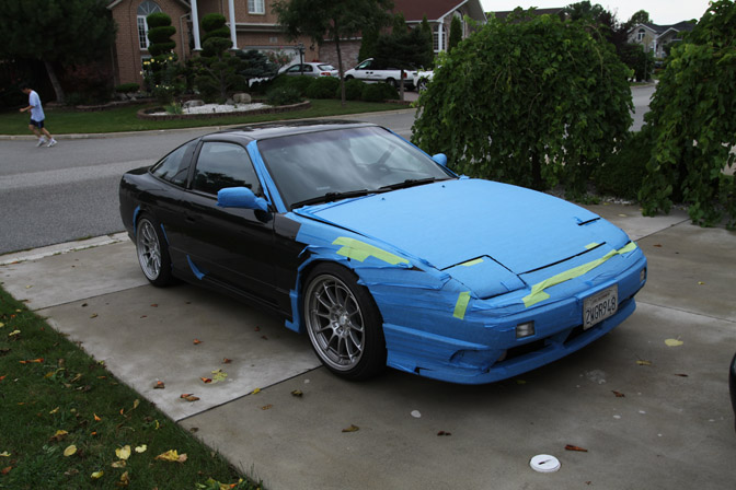

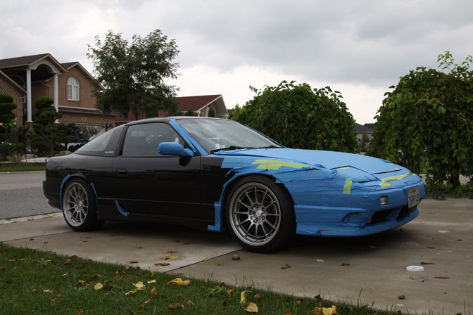

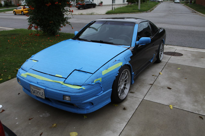

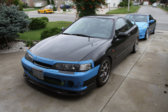

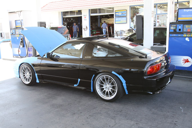

I taped the entire front end up in hopes of avoiding any serious chips. Ofcourse this drew plenty of attention from the general public. I must have been asked whats the tape for about 40 times on this trip. At every gas
station at least two people would ask me that.

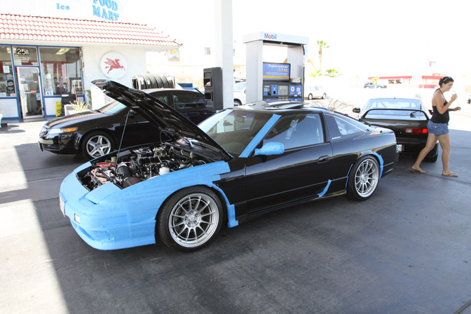

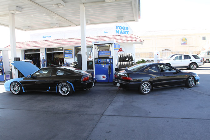

When I was inside the gas station I asked the attendant how hot it would get and he laughed. "Boy, its gonna get past 124 today." I though, shit not good. The last thing I need is a torture test on this car but there was no turning back now.
At around 2pm it scorching hot, my balls are past the point where they are sticking to my leg, I'm dying of heat but that's not my main concern. I am watching the engine temps on my OBDII reader like a hawk and not liking what I see. They are a steady 220-224deg F for the majority of the time. Unfortunately, we get into some hill climbs and I watch it rise even further, 226, 228, 230... I had spoken to the GM techs and they said the engine can run up to temps of 240deg F so while I am still ok, its getting close.

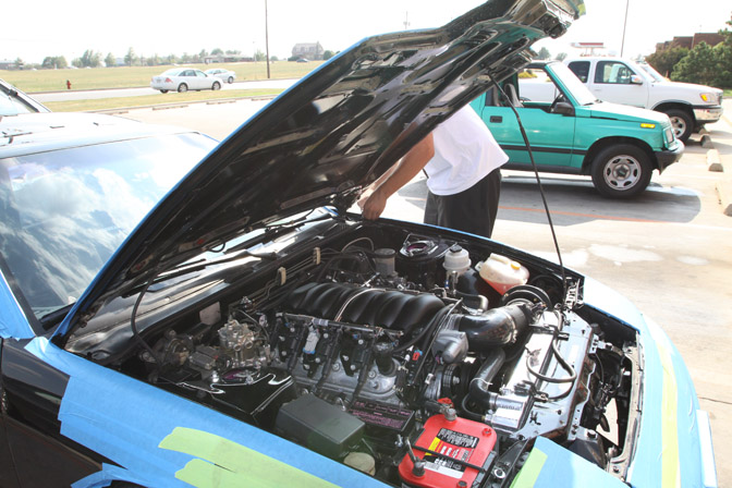

Then climbing up a rather steep hill I suddenly lose all power and pull off onto the side of the road. SHIT, what the hell happened? I jump into diagnostic mode and the first thing I check is fuel pressure. Nothing. Ok we got a failed fuel pump, Im fucked time to call a tow. Before I do so, I sit around and talk to my brother what the options are. About 15mins goes by and just for kicks I go to see if for some miraculous reason the pump works.
Holy shit it works! I fire up the car and start driving away, my brother hi beams me. Now what! I stop, shut off the car run back to him. The Integra wont start now!! I laugh in rage and tell him to jump out. I get behind the wheel start rolling the car backwards and bump the K20 engine to life.
At this point you know whats going to happen. I go to start the 240 and yep, fuel pressure is 0 again. We sit around for another 25min letting the car cool while the integra idles, rad fans a blazing. Finally it starts and off we go.

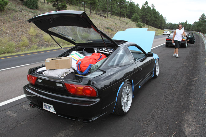

Another 3 hours go by and the car seems to be driving fine, we've cleared the ridiculously hot desert and are nearing flagstaff, AZ, its still hot but by now its 5pm and starting to cool off. Just when I think things are going my way the car dies again and Im forced to pull off.

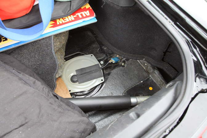

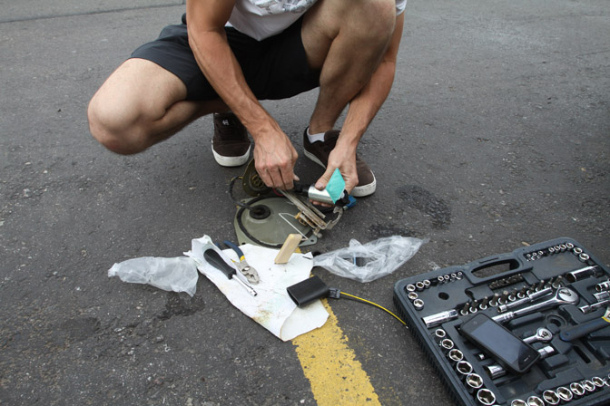

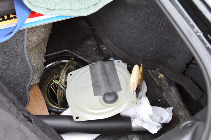

This time I rip apart the trunk to get to the fuel pump and see what the hell is up. As soon as I touch the fuel pump assembly I feel how bloody hot it is! Something can't be right but my mind is wandering and I really don't think about the root of the problem too much, I concentrate on how the hell we are going to make it another 2 days of driving with a car in this state.
As the car cools off, I call the NAPA in flagstaff which is 10 miles away about a stock fuel pump, they have one in stock thankfully. Im almost out of gas so we need to stop soon anyways.
We roll off at the first sign of fuel pressure and I cross my fingers hoping to make it to flagstaff.

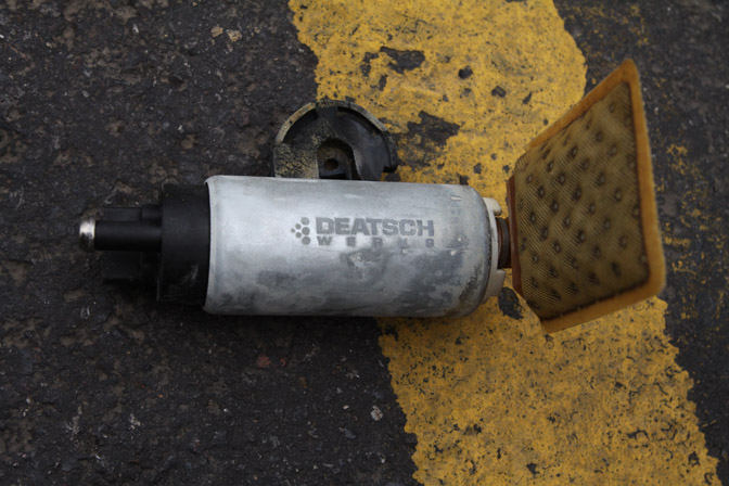

When we get to NAPA, I rip apart the fuel pump assembly which thankfully is super easy to get at. When Im pulling off the fuel hose, theres still some pressure and the gas sprays out a bit. Its SUPER hot and so is the tank assembly, thats when I begin to realize the problem.
Because the catalytic converter on the right bank of the engine is about 4-inches from the fuel lines, it must have been heating up the fuel on both feed and return sides obviously. If it weren't 120degs out and I wasnt driving for 8 hours straight then it wouldnt be a problem but due to those reasons the fuel was slowly getting hotter and hotter in turn the fuel pump was heating up and eventually it would cease to operate. Once I let it cool down then it would work. To make matters worse running on an close to empty tank would speed the process up. Hence why the car was dying only when the gas tank was near empty.
I pulled the poor overheated Deatschwerks pump out and it looked like hell.
In went the NAPA pump which I figured would suffice in flow as long as I didn't get into it.

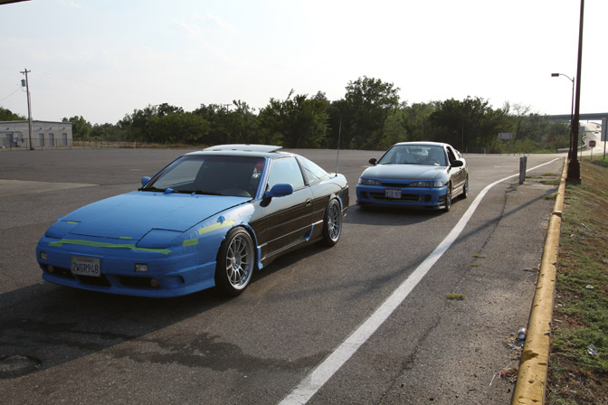

We drove for the next 7 hours until we hit Amarillo, Texas. Once night fall came the car ran flawlessly further proving that the fuel heating up due to the hot temps was the problem. I dont have any photos from that night because as you can imagine all I wanted to do was sleep and forget the day ever happened.
Leaving Amarillo around 1pm we had hoped to have beat the hottest part of the day, which wasnt the case but at least we had about 3-4 hours of hot temperature driving then it would start to cool off.
At this point the drive got somewhat uneventful, it was much flatter so there were no hills to worry about. However, the temperature was still a worrying 100degs but we continued to soldier on.

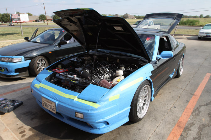

About 5 hours into the drive I thought, wow theres a strong side wind because I can feel the car pulsating a bit, you know that feeling when a strong wind feels like it almost slows the car down well this began to happen. About 10 minutes later I thought, ok somethings wrong its getting worse and I pulled off at the next gas station. Before that, I saw a rainbow...uh huh.
Sure enough, the fuel was super hot again and I think the NAPA pump was dropping its pumping capacity resulting in uneven engine operation. I decided we needed to do everything possible to try to get rid of the heat under the hood. This time a trip to autozone netted some washers and longer screws.
Off came the hood and in went the washers.
A sizeable stack indeed. I was hoping this plus me running with the heat on would help a bit and it did. If you've ever driven in 100deg weather with your heater blowing you can agree that when I say I was really starting to regret making this journey and hating life.
But the engine temps stayed around 210-214 so it was worth it in my mind. For the next 5-6 hours, I dont really remember the car ran just fine. We stopped at a gas station where I snapped some shots. I was really hoping to document this trip better but with all that was going on my camera was the last thing on my mind.

I had water wetter, proper ducting, even wrapped all the fuel lines in heat shielding material. Trust me I prepped this car for the trip.
I would have never experienced this problem if I hadnt been driving for 8 hours. I made sure to drive the car for 2+ hrs in Cali before I left and it ran perfect.
With that amount of operation time, plus the stupid hot temps, the fuel had no chance of cooling off. I talked to Deatschwerks and they told me that a good amount of the fuel is being returned to the tank during cruising and very little of it is actually being used hence why this became such a problem.
Most people dont drive their swapped V8 240s this long or have cats so I dont think its an issue for 90% of the cars out there but if you are doing this swap with cats then consider these problems.
As for what Ill be doing with the system, it will get a OE Corvette style filter/regulator and installing it at the back of the car so there will only be one feed line running to the front. Ill be tackling that job early October when I get back from LA.
I also have a fuel pressure problem right now so the car isnt running right at full throttle, it just bogs out. The small Earls fuel filter that Im using seems to be the culprit as I cleaned it out and it seemed to have worked but the problem is back again so I have some more diagnosis to do to figure out the exact problem.
