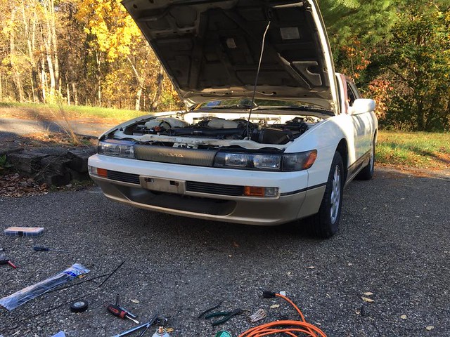

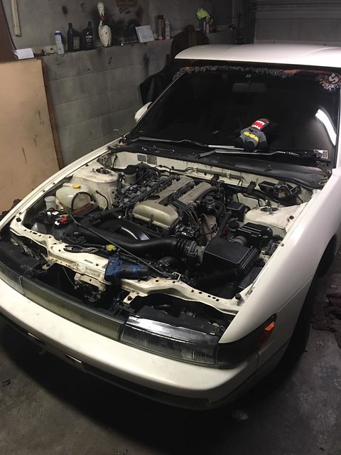

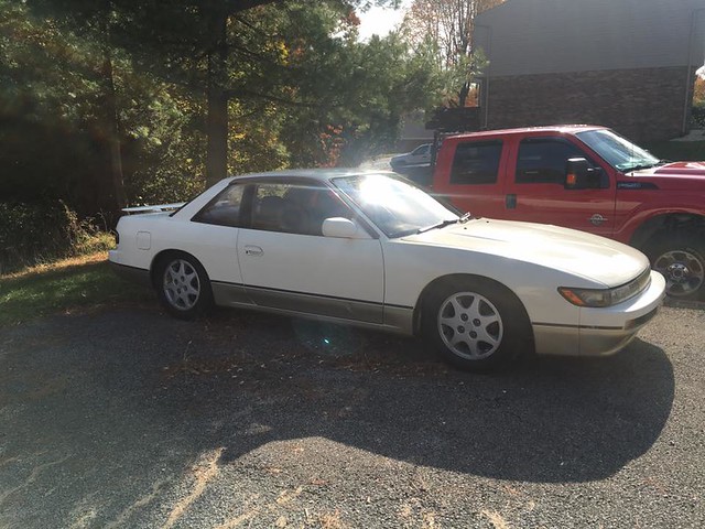

well lets try and get this one to work! Recently picked up a 91 silvia sr20de auto car with 67km (41k miles)
pulled my rb25 and full suspenions and brakes from my s13 vert, and sold the shell!
mods to rb
series 2 untouched motor
greddy t-belt, oem oil and water pump
freddy intake w/ q45 throttle body
ls2 truck coil conversion
wiring specialties pro harness
zero lift mount kit
driveshaft shop 1 piece
syco turbo elbow and downpipe

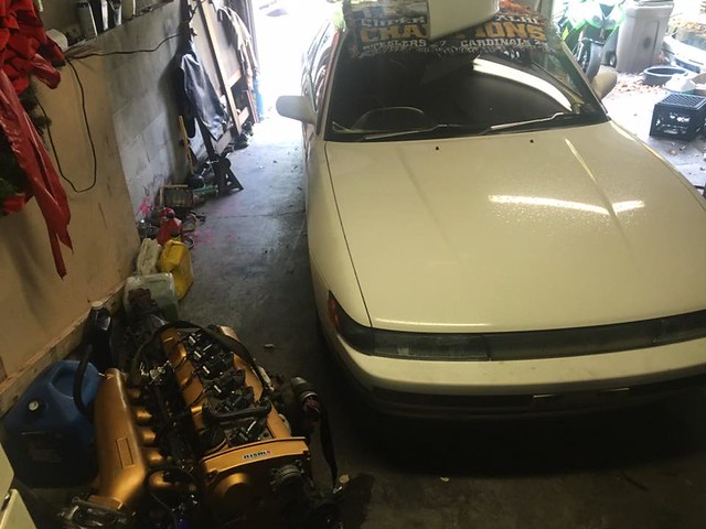

currently pulling the sr out of the silvia!
now for pics!

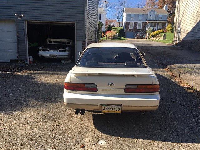

yes thats an oem aero bumper sitting on the vert
installed my bricks and my half and half turn signals!

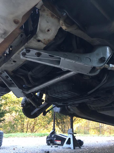

ISR pro coils, tension rods, and nismo power brace installed, had to wait til 1/4's got rolled before i could swap subframes, 5 lug and z brakes

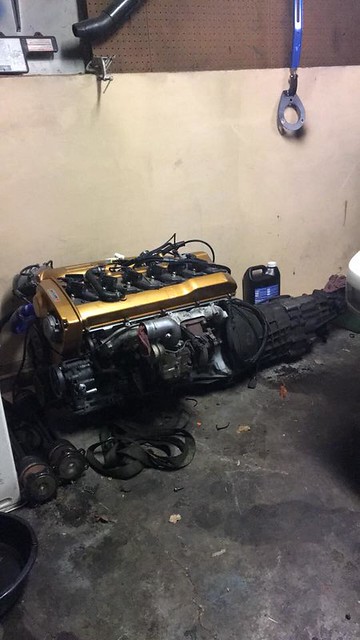

rb awaiting new home

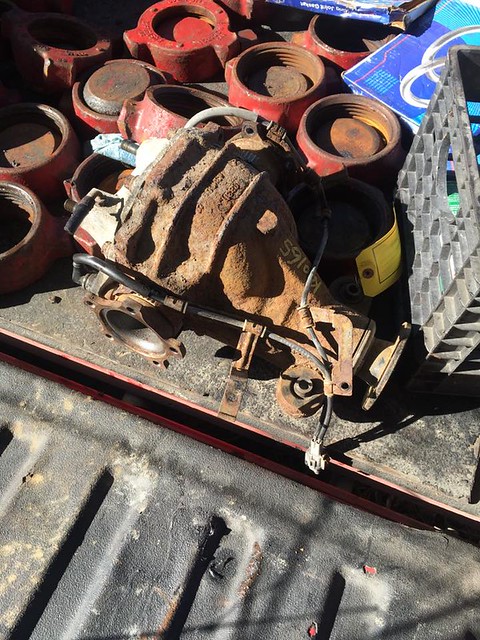

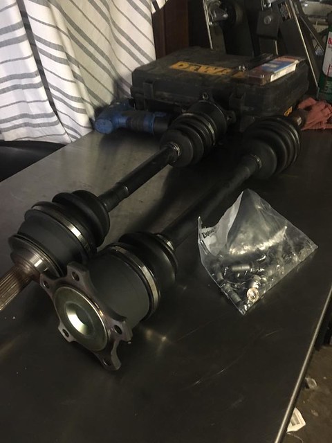

picked up a q45 diff and j30 axles instead of running a welded diff on this car

Easier to find for one, two I got this 97 q45 22k mile diff for cheap, 3rd I wanted the 3.69 gears for when I go big turbo, plan was todo big turbo over winter on my vert, but since I bought the Silvia instead I'm going to go all out and fully build a spare rb25, so for now I'm just swapping the stock rb25 set up into the Silvia
The diff just needs a good cleaning and paint/undercoating to it

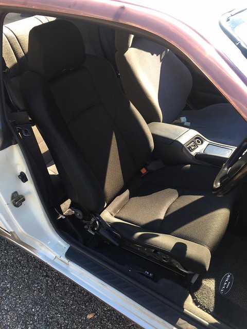

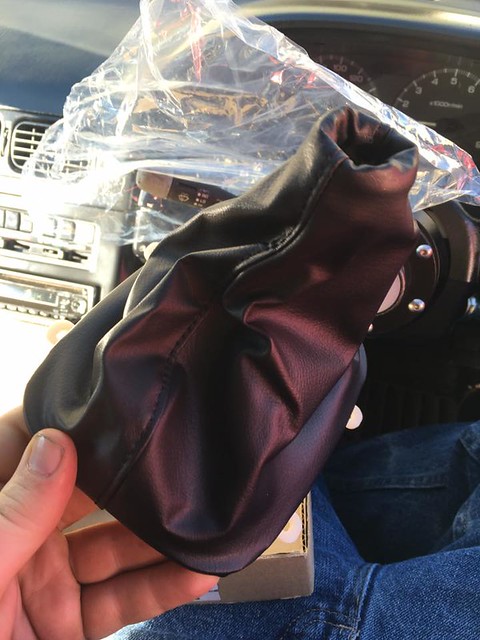

Some more pics, first day I had it I installed one of my 350z seats in, they are now both in and quick release steering wheel is also installed
Brand new Oem shift boot

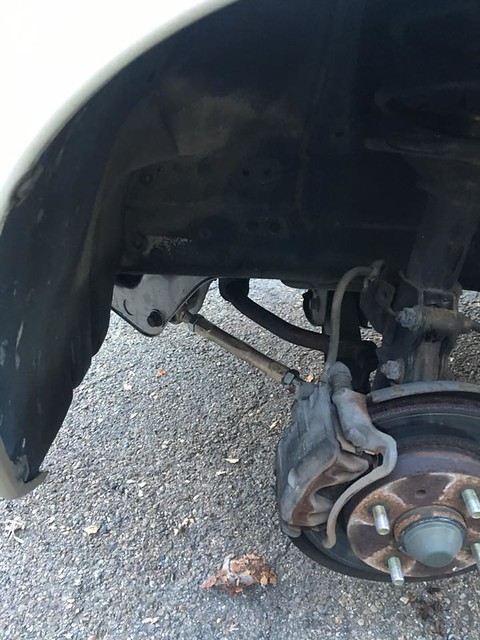

Nismo power brace, isr pro tension rods and energy suspension bushings installed on the front, haven't swapped in my loaded subframe yet with isr pro arms, pbm solid subframe riser bushings and energy suspension bushing kit and z brakes with 5 lug and z ebrakes
Still waiting to swap the front z32 30mm calipers and 5 lug hubs

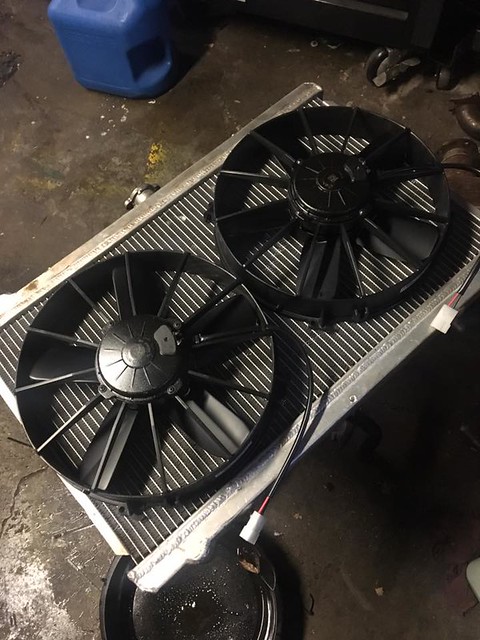

Spal 1650 cfm pusher fans, I ran clutch fan on vert but I'm not cutting up the core support on the Silvia so high powered e fans will work

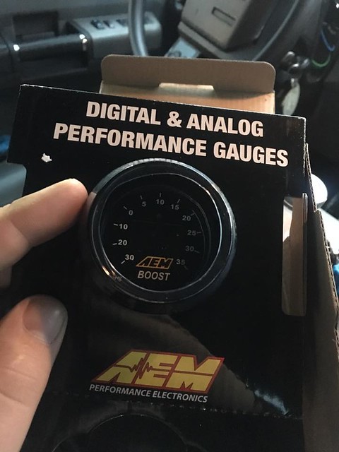

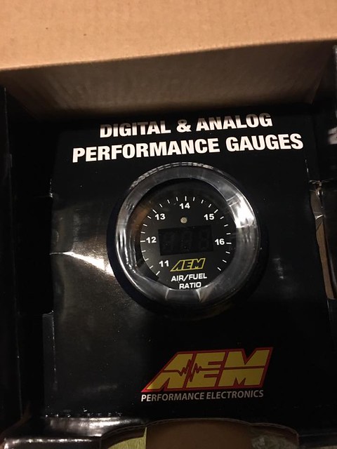

Aem electronic boost gauge, ran a cheap glow shift before

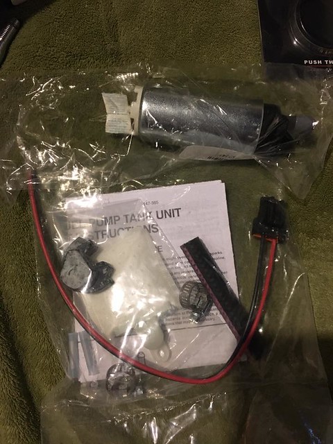

Waiting on enjuku to send me my aem uego wideband, solid diff bushings, walbro 255, isr rb25 short shifter, and few other things,

Any modifications to fit the z seats?

It was very very simple, take the s and z seats and drill out spot welds on the two front brackets and the inner rear bracket, bolt the s brackets in car, line up the z outside rear bracket, tac weld the s brackets to the z seat rails, pull seat out and weld up completely, you'll have to make a 1" spacer for the front outside bracket

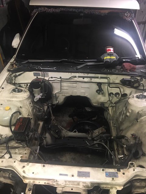

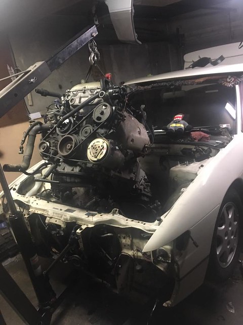

Well I got the sr yanked out, didn't take long, buyer came and picked up the sr, and many of my Black Friday parts have showed up!! Had to order ps lines mine got damaged pulling the sr out, but those should be here mid next week, and I ordered new wheels! Was an impulse buy but I ordered blitz 03's off of here!

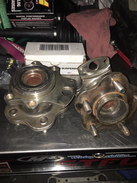

Picked up some low mileage z32 wheel bearings, I broke an axle end of last year, drove home 20 miles and trashed the bearing, welded diff got me home tho!
New aem wideband
Got the sr pulled!! So glad it's gone
Time to clean up the engine bay, drill the clutch mster out and get ready to swap in the Rb25

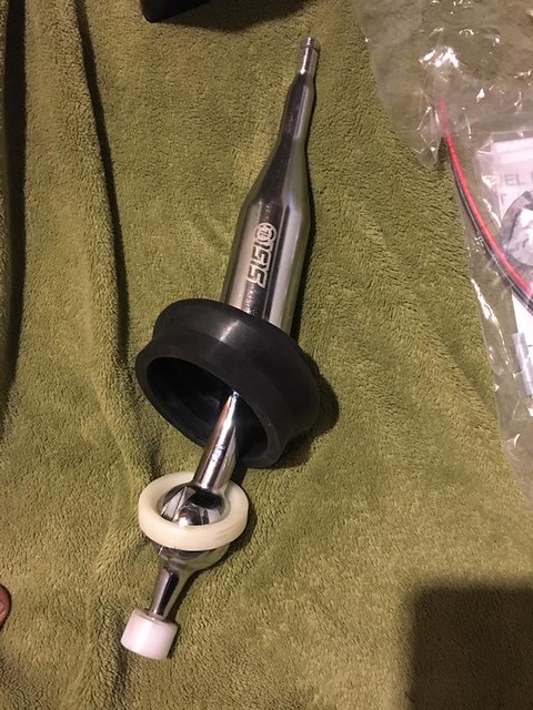

Isis short shifter, another Black Friday purchase

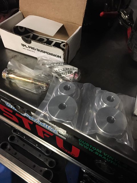

Solid diff bushings for the q45,

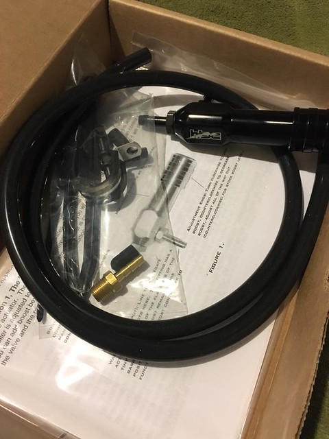

Hallman manual boost controller

Got the new walbro 255 installed

Finally got the subframe up and and test fit the rear, and bolted the front calipers on, realized I needed to run a spacer in the front, so I had to order 15mm bolt on spacers

Got the axles, diff cover, and z32 bearings off of a member on here,

Well not much of an update as I have been in Texas for the last month and a half, but I have ordered a few parts, one of my favorites is a set of mint oem rear 1/4 window louvers!! Didn't plan on buying them but it kinda just happened, and currently working out a deal for getting a complete forged Rb25 all brand new still in boxes, Manley rods, cp pistons, arp head and main studs, n1 oil pump, Rb25 block with crank, complete head, so basically order timing components, head gasket, cams, springs/retainers, and drop it all off at machine shop, but here are pics of the louvers

Well srt4 is sold!! So I have new plans for the Silvia! I'm pulling the motor back out and sending the whole car off to paint!!! Factory oem ivory white with Champagne gold metallic two tone, going to make the car look as if it just rolled off the showroom floor! Front brembos have been installed!
Brembos!
Finally cut the oem bumper for the intercooler
Ordered moldings from the dealer! All door moldings and both front and rear window trims
Than all the parts that showed up while in was in Texas
So motor is getting pulled out this weekend! Then sending the car off to paint!! I can't wait for it to be freshly painted!!!
