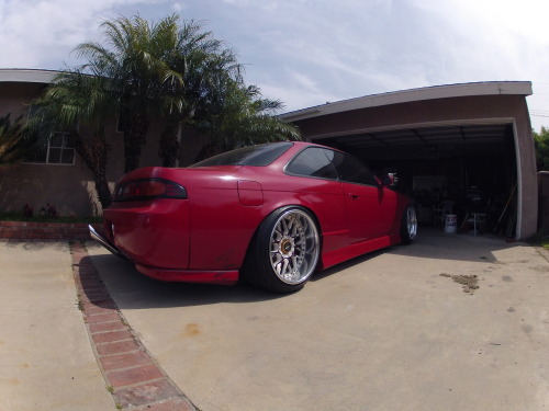

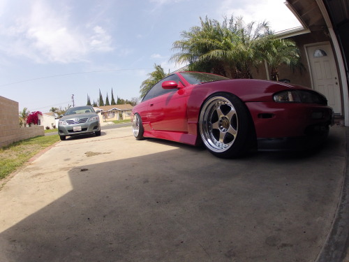

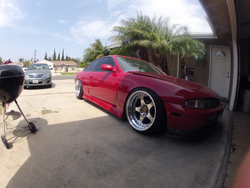

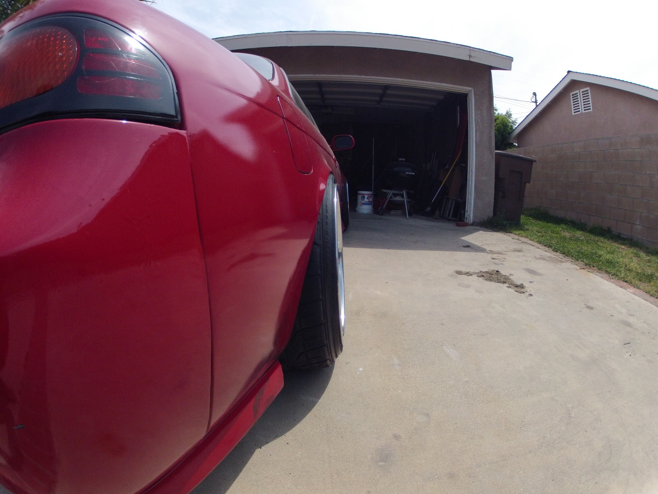

Originally Posted by evilpanamajack View Post
What about
Front 235/45
Rear 275/45
MORE SIDE WALL!!!!!!!
fronts will most likely rub...
this may or may not help but heres my old s14 setup...
front are 18x11 -3 and i was running 25mm extended flca's 235/40
rear are 18x12 +10 275/35
but like i said i couldnt go full lock with that tire
and ya stock body like a bawse
tumblr
brian310 is offline   Reply With Quote
