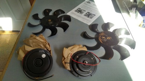

I spent most of the summer in the garage tracking down various issues the car somehow developed over the winter. I was having an issue with the alternator not chargine the battery. All signs pointed to a dead alternator, Which kind of pissed me off cause it's only about 4 years old and it's an Eagle Auto 160AMP modified alternator. I pulled the Fans,radiator out so i could get to the Alternator easier, once that was removed i decided to have to rebuilt, after it was rebuilt by a local shop for $40 i went and re-installed it, put everything back together, got the car up and running, and a little while later poof dead. Go back do some more tests, and think maybe its the battery (which was also less than a year old) Took that out had it tested, and it checked out fine, i went home and pulled the alternator off and had took it to the place that rebuilt it, checked out fine...awesome. So i knew it was somewhere in the wiring harness that went bad. Pulled out some FSM's and did some reading online, and then started to tare into the wiring, about 8" from the alternator i found two broken wires going to the alternator fixed the wiring and no more dead alternator/battery. But of course i would only figure that out after removing the fans/radiator TWICE! ugh... After fixing that, and letting the car warm up i noticed when the flex a lite fans turned on the one made a lot of noise, after listening to it for a little bit and watching it on turn on and turn off i discovered something happened to where the fan was separating from the motor. Here is a post i made regarding that issue. Quote:
After replacing the fans i installed everything all the way back over and let the car warm up this time good and quiet! I then Decided to take the car out for a quick spin around the block and the tune seemed to be all sorts of wacky, I'm putting the "blame" on a sensor or the shit ass wiring harness that is in the car for the issue. I also decided i wanted to do a battery cut off in the car, so i went ahead and picked up some 1-0 welding wire and made a new battery ground and hooked up the battery cut off switch i then fired up my AEM and made a few slight adjustments to get the car down to a local car show. Here are some pics from the Show. In Wisconsin we have a thing called "Hobbyist plates" it's a one time fee of $200 and your car is forever registered, as long as it is a modified car, and you have another car registered, Also the car can't be driving in January, which is one of our coldest months anyway. So on goes hobbyist plates, but not before getting rid of the ugly GREEN of the plates, We just wrapped the plate in White Vinyl and Black Vinyl over the numbers. So long SLOW I6 Plates. While getting ready to leave the show i noticed the brake lights were stuck on, AWESOME. upon further inspection i found some broken plastic pieces on the floor mat, sure enough the brake stopper broke off. So had to drive home with the brakes on. After making a quick fix with a plastic push pin from the trunk plastics (Ordered new stoppers from Nissan, but the truck the parts were on broke, and wouldn't be here till Monday, and i needed the car for a big event on Sunday, Just goes to show how much this car is cursed that even the truck the parts were on broke! ![]() Took the car to the Stance Wisconsin Modified Madness, had a great time with some good friends! But man you never notice how much of an "off white" the 89-90 White is compared to a WHITE car. My fiance Liz (who owns the car) wanted to make some stickers for the car for the show, since she has a sticker shop she made these up real quick.... After the show we had some dinenr with the people we went to the show with, and discovered the car had a brake like out.... LOL told you CURSED! After that the car home to sit in the garage, as the season is almost over, and we didn't do but maybe 100 miles in the car all year, and had nothing but little problems pop up. I'm sure we will do more work and a little more driving before the seasons done. After that we took a spin to our buddies house who just blew up his 500whp STI. here is some carnage pics of his car.
