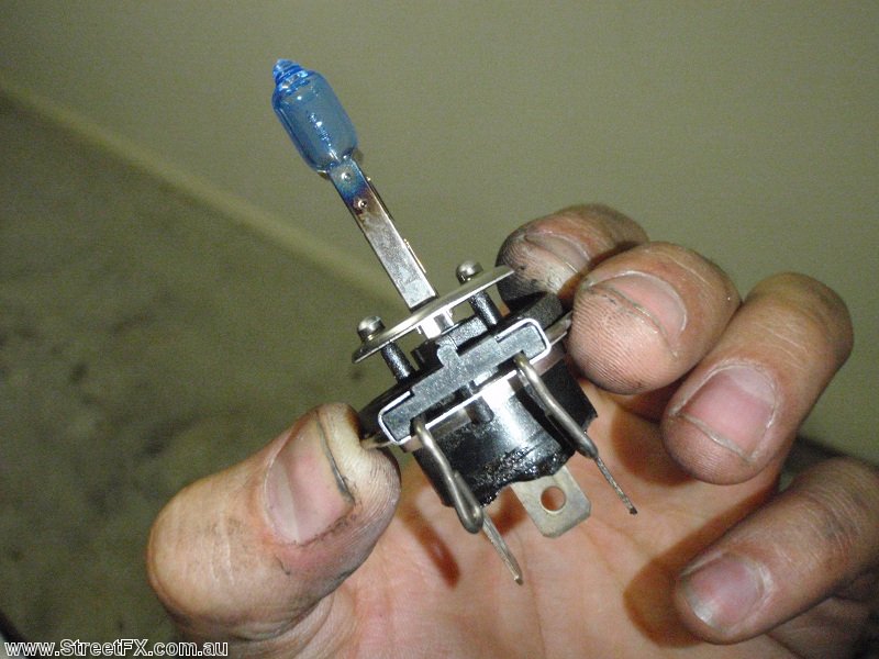

to fig outthis problem here you go your missing the black piece, its the bulb holder changes the 1 prong h1 into a 3 prong h1

if you go to the link on the bottom of the pic, they did an hid install so if you need help go there
