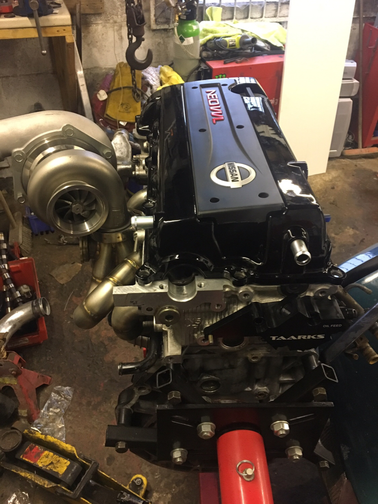

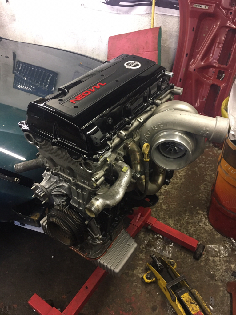

I am also building one of these engines, taking my time but nearly there. Inlet side still to get, wastegate and CAS to get and I should be fitting it.
jj205mi is offline   Reply With Quote
