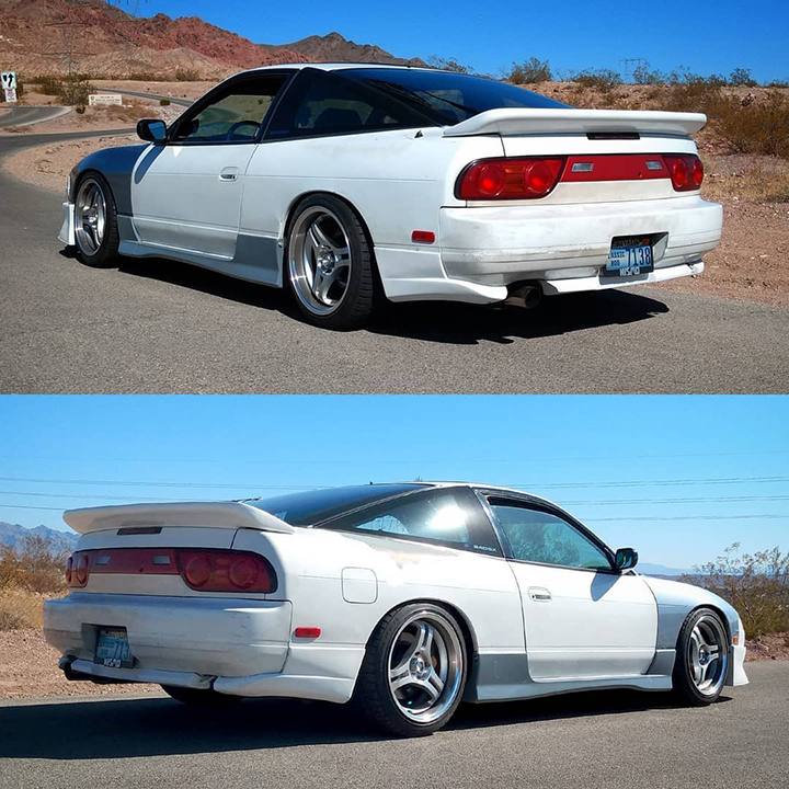

slowly going back to kouki aero for a while... made some updates to my V3 skirts and working on the front bumper right now (not on the car in these pics)...

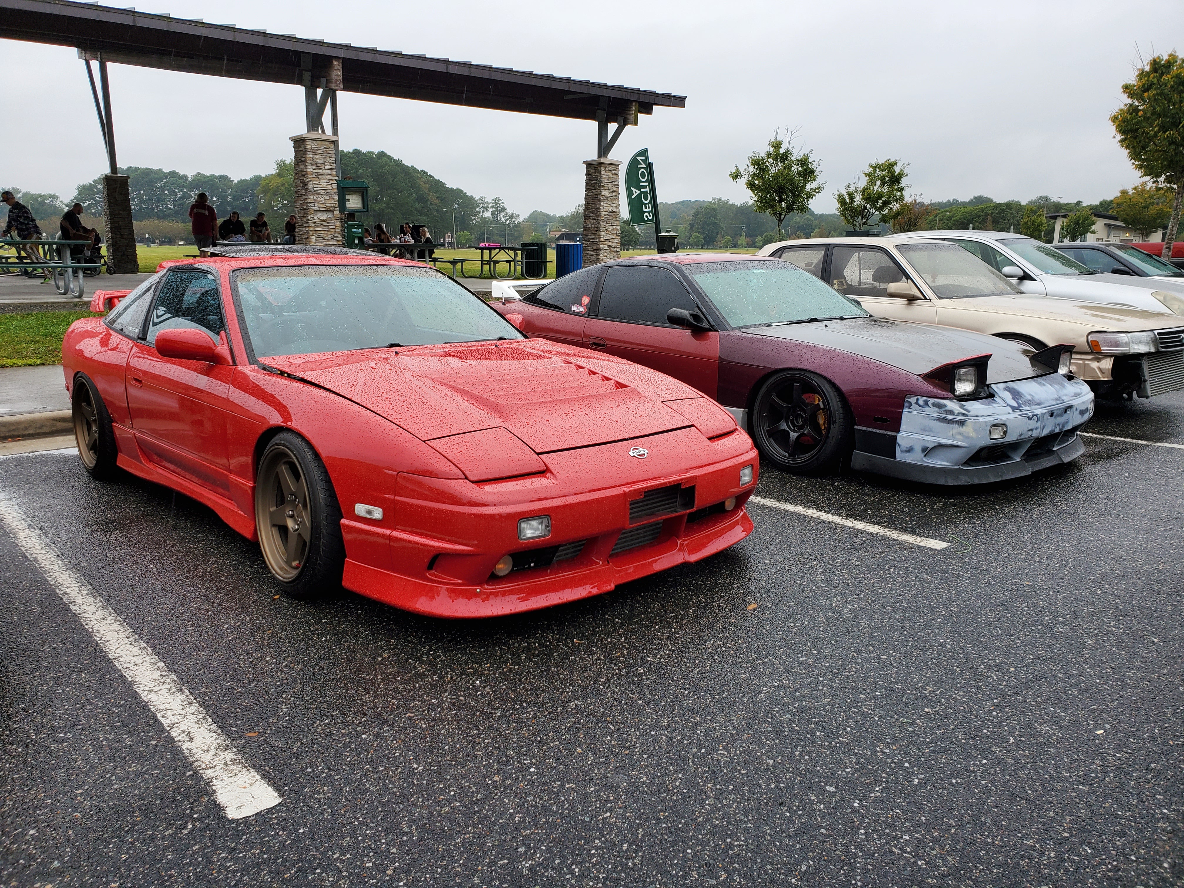

![]() ![]() alright lads, heres what my fitment looks like. I have not taken the bumper off to try and bend the retainer yet, but this is what i'm starting with. i almost just think i should have a crash bar made with support in the middle to pick it up a bit, i know street faction makes that option on their crash bars. the four bolts holding the bumper in the middle are pushed up as far as they can go |

When I line up pop-up fronts I usually start with the bumper to hood fitment, then the hood to fender fitment, and then headlight fitment last since they have the most adjustability. Good luck!

definitely bend the bracket upward and maybe inward a little bit. nothing major. also, you may want to invest in some autocollect storm upper bumper brackets and lower fender braces... they work wonders!

i had the auto collect bumper brackets but didnt like how the top of my bumper stuck out passed the fenders. i'm def going to bend the bracket a little and try and realign my front end. got the bumper support bushing things in my cart already, but apparently theres gonna be a black friday sale on nissanparts.cc so I'm gonna wait...might even feel frisky and buy the oem weather strips for the doors haha |

The rubber hood bumpers are adjustable, FYI. But if you need new, nissan parts cc has the whole kit.

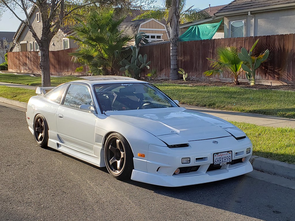

Just finished mine up not too long ago ![]()
