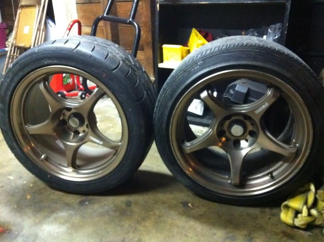

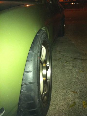

Got my new front wheels in. Went to 17x9 rather than 17x10 in front to get mad angle. I need new tires for the front, I won't be running 255's in front. Anyone interested in 255/40/17 RT615's brand new?
17x9 +15 w/ 255-45-17
17x10 +12 (w/ 5mm spacer, +7 effective) w/ 225/45/17

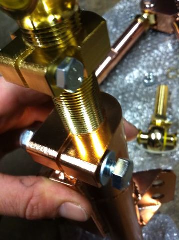

Going to be cutting it close for the Buttonwillow event on the 25th.

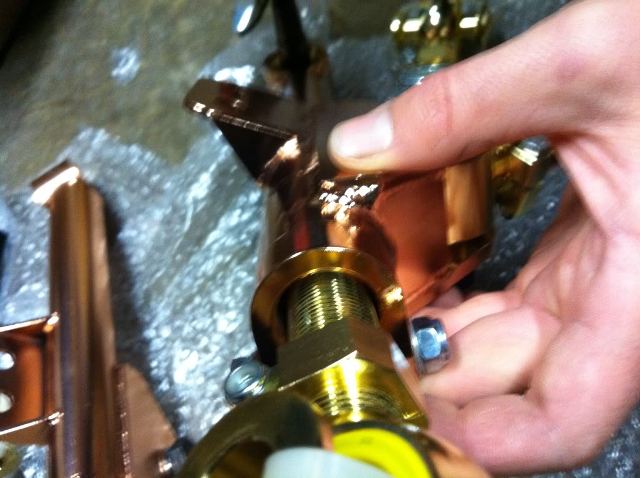

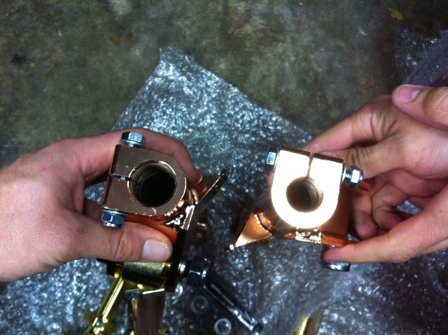

Got my PBM FLCA's in today. There must have been an error or something because it seems that none of the items really work together and that they are different sizes. Really disconcerting because I need them to work ASAP. I know PBM will sort it out, but it took over 2 months to get these and I'm afraid that I won't get them in time.
See the 2 arms are different sizes and the heim joints thread into one side but not the other. Fingers crossed that this gets sorted quickly.

facepalm! should've went spl until there was enough stock to deal with psm stuff.

SPL doesn't have LCAs. They sell NAMS arms.
Need help?

The PSM ones are better IMO. They move the TC rod mounting point in on the LCA so you can get more clearance and big angle. Lots of really nice design ideas with them, just need to get the hardware sorted out. Suck.
