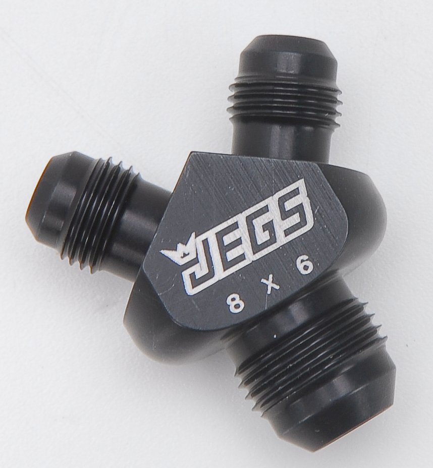

I have a S2 rb25
Valve cover has 2x welded -8 an male ends and the pcv welded shut (purchased off of another Zilvian) Oil catch can is a greddy, similar to the pic I am wondering if it would be possible to replace the drain plug on the bottom of the catch can with an -An fitting/line, run the line to an -AN "Y" fitting connecting the oil drain from top mount turbo to block, and the oil catch to the block as well (creating a constant circulation of whatever blow by oil is collected). Would this set up form a sufficient vent for crank case pressure? Pic of a Y I would use (not exact size) ![]() If this is not a good idea, any other ideas would be appreciated. Just remember PCV is welded shut on the cover. |

With the pcv plugged use the Y to connect the two top valve cover ports to one line and attach it to the catch can. Then from the other port in the catch can connect it to a vacuum only source, that never sees boost, so either your exhaust or your intake pipe after the Maf and before the turbo.
This will release the pressure but also put a vacuum on the crack case to help seal your rings. |
