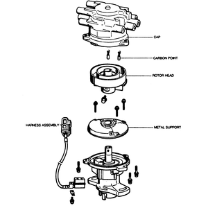

1) The distributor cap is held on by 2 spring clips. (refer to this 240 diagram if you have to) Release them with a screwdriver and lift the cap straight up and off, with the wires attached.
