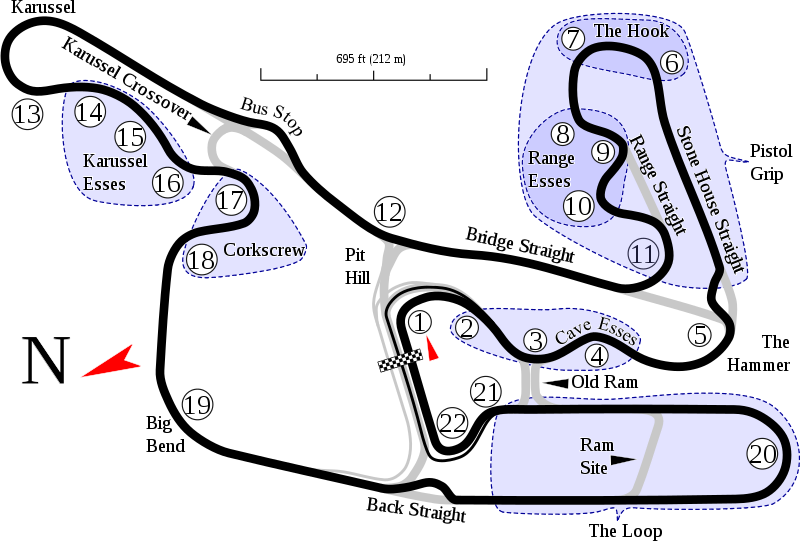

Its kinda hard to spectate the Ram Site, but its where alot of people go the shakedown the car because its more-or-less simple and a little room for error over some other parts of Summit Point Motorsports. Alot easier then Trigger Course (Uses Pistol Grip and Cave Esses for non Summit Point people reading) which I dislike highly.
Should've gone on Bridge course! I love the flow of the track and since I didn't have a car there I was taking some photos. Dammit, I though PBM would have been alot better then the Circuit Sports stuff I always see. |

I wouldve but it was getting late in the afternoon by the time i felt the car could handle it. i didnt have enough grip with the 245/40 contis at 25psi i was running. then tires happened, then the wall ALMOST happened when my rack burped.
i didnt sleep the night before and i was zombie mode as it was. i was awake purely on adrenaline. so i couldnt stop. i couldnt see out of my windshield after the rack incident to. i was just too fucking tired. ive been working non stop on this thing for 3 months. and i started after i got home from a 9 month deployment. im burnt out! i pulled the car out of the trailor and into the barn. a few days before the next event i will get the bugs worked out and run the next event like this. THEN ill tear down, paint it, and finish the front end. i need to spend some quality time with the wifey. ps. best place to spectate ram site is above the classroom on the top balcony. thats where my buddies were watchin me |
