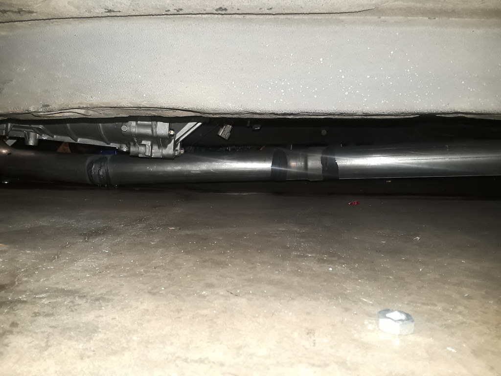

For people wondering, here's a shot of the cd009 mated to a 1j with collins kit, in a s13
It's a little big.

Does that trans hang below frame rails or is it the angle of the picture?

About 2" below the rails, yea.
Sketch.

I have a similar setup( collins bolt on with a 2J). That angle makes it look worse than it is. I'm more worried about the oil pan so I'm getting this....

The trans hangs about 2" lower than the frame rails, I'll take a pic that shows it tonight.
It's funny that my oil pan is above the front cross memeber on mine.

Old 03-22-2018, 02:41 PM   #568
di-devol
Join Date: Jun 2010
Location: Woodinville
Posts: 1,412
di-devol will become famous soon enoughdi-devol will become famous soon enoughdi-devol will become famous soon enoughdi-devol will become famous soon enough
Never mind the exhaust, but here is a good shot of how low it hangs. Again, this is 1jz-cd with the collins kit in an s13

HypnoFish
Join Date: Jan 2012
Location: MI
Posts: 183
HypnoFish is an unknown quantity at this point
Man that sits low.
Im using all xcessive mounts and brackets and mine sits about an inch below the rails. using the Colins auto bell adpater kit.

Old 03-22-2018, 03:52 PM   #570
di-devol
Join Date: Jun 2010
Posts: 1,412
Originally Posted by HypnoFish View Post
Man that sits low.
The top of the trans is 1/8" shy of hitting the trans tunnel. It is as high as it can go. I don't know how anyone's is sitting higher?
