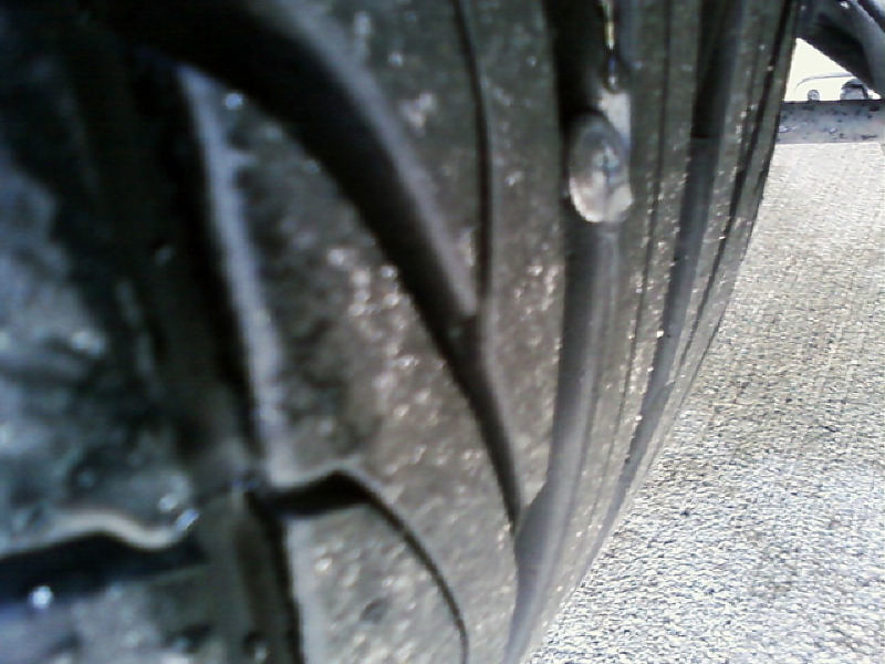

So I started the car yesterday to back it out to wash it, and heard a really loud squeal. Alternator belt- I was actually surprised it took that long to loosen up after breaking in. So I tightened up, feeling accomplished that my 240 issue for the day was behind me. I backed it out and started hosing it down, only to find this:
Fail! These tires have two tanks of gas on them, lol. Luckily, my friend that manages a Discount Tire said it can be fixed, so I'll take it in on my lunch today and get it taken care of- then I'll be back on the road tomorrow! So annoying, haha.I spent the rest of the afternoon washing the exterior and cleaning the interior out.

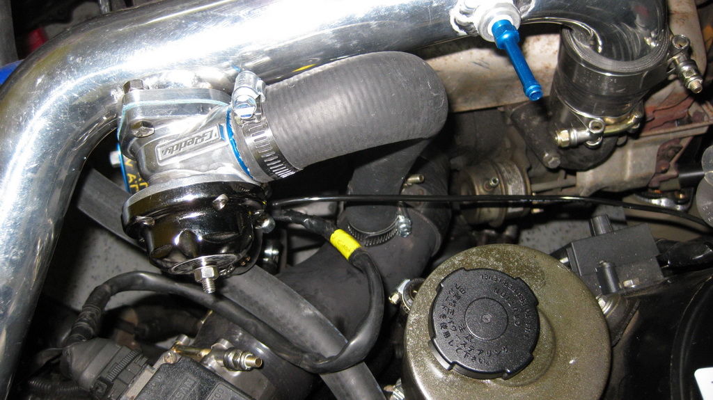

what type of hose did you end up getting for the recirculating valve?
dopplganger1 is offline   Reply With Quote
It's actually a Goodyear 1.25" flex radiator hose that I got from Summit. It isn't the prettiest, but it has a steel wire running through it to keep it from pinching/folding over on itself. It is bent pretty good in there and hasn't kinked at all. Props to Bumnah for the recommendation!

If you mount the BOV facing backwards, you may not have to run such a long recirculation line. And no worries on the hose recommendation. Whole point of figuring shit out is to share it with others.
That makes sense. Right now, both ports are facing the front of the car, so it bends in a U shape. It might be in some sort of crazy S shape if I mounted it the other way, but that might make it shorter/easier to work with for sure.
CamryOnBronze.com

Send a message via AIM to Bumnah
Have the intake tube modified to have the inlet sit like so:
