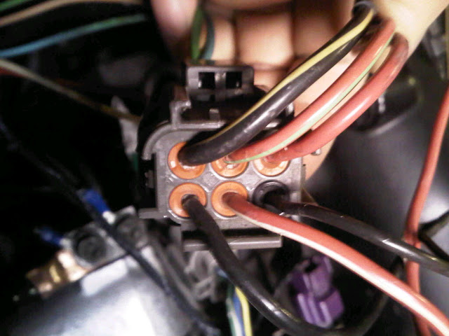

Hi Everyone,

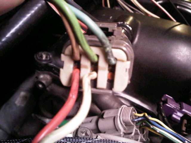

Can someone please take a look at my coilpack wiring harness and see if it looks good or not. Not getting spark to any of the coilpacks right now. Car was running before I started to clean up the wiring. Thinking that I might of messed up the wiring when I repinned it back. I compared it to the FSM, and it seems to look good, but just wanted at least a 2nd opinion. Thanks! Plug from ECU/Ignitor end ![]() Plug on Coilpack harness end ![]()

Coil harness is wrong... It should be from left to right looking at the back of the plug or just how you have it in the photo; Top row- black/yellow, black, red/white; Bottom row- thin black, red, red/green

Thanks for the reply. I'll give that a try and see if it helps. I originally hooked it up according to the FSM. So my original setup is: top, left to right [Br -> R] | [G -> R/G] | [L -> B/Y] bottom, left to right [R -> B (thin)] | [W -> R/W] | [* -> B] With your suggested wiring, it would be: top, left to right [Br -> R/W] | [G -> B] | [L -> B/Y] bottom, left to right [R -> R/G] | [W -> R] | [* -> B (thin)] This was the diagram I was going off of posted in another thread:

I'll double check for you with my coil harness plugged into the main.
Yes, how you have it is exactly how it should be. This was on my running car and I was using LSx coilpacks and everything worked great.

I rewired the coilpack harness to what jr_ss mentioned and still did not work. Car still cranks but wont turn over.
