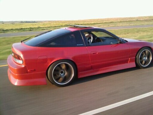

To start off i was looking to trade my GSXR 750 for a 240sx for almost 6 months. After a long search i found one in Kansas so off i went to pick up my car in August of last year. Took me and a friend 4 days to go from Arizona to Kansas and back mostly non stop driving other then gas and food.
What I found was a 1991 240sx hatch with a sr20det.
Mods list as the car came
Sr20det
Xs power FMIC
T28
GODSPEED coils
s14 seats
AIT body kt
First gen megan manifold
Greddy dump pipe
Tanabe down pipe
Egay Exhaust

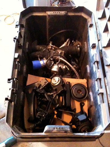

Parts bin with extra parts
As the car sat leaving Kansas
The first thing me and my friend did to the car.
Mount body kit because it was falling off all the way back from Kansas. We also noticed a crap load of leaks ie front main seal - trans - radiator. Plus the camber was fucked and we had to get that sorta fixed because i was going to use the car as a D/D for work.

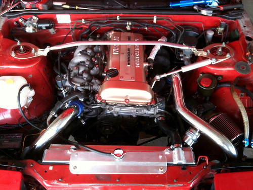

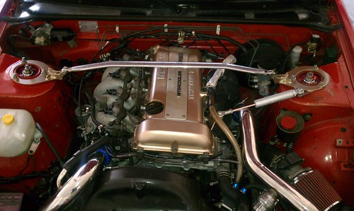

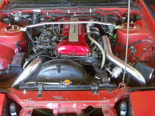

So after driving for a little over a month we decided to clean the engine bay up.
That lead to :
finding a power steering set up
relocating the boost solenoid
cleaning up the vacuum lines
hooking up my Boost gauge
Fix the Bat relocation kit that was really shitty
plus some other minor stuff

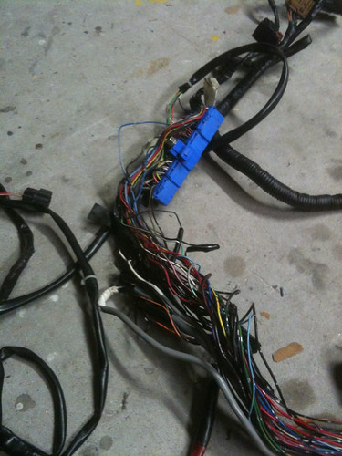

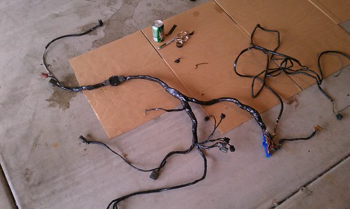

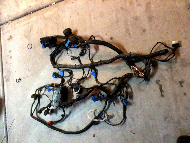

What i started with
one fucked up harness
What I ended up with after 3 weeks of work
A cleaned up harness

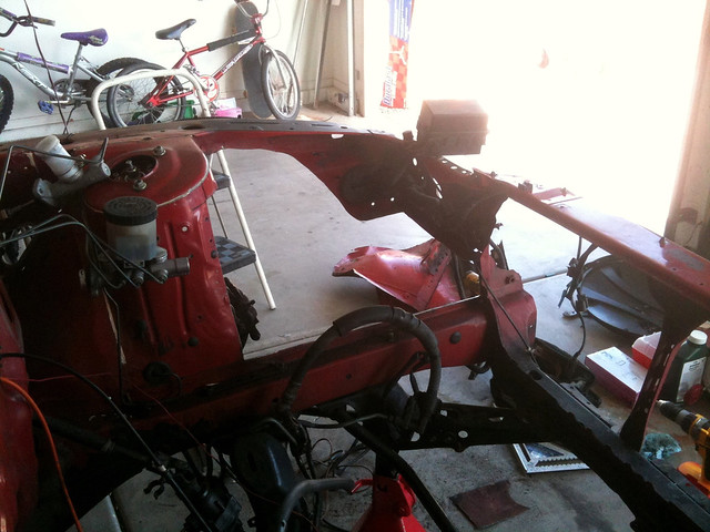

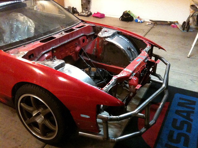

As the car was before everything below this picture started.

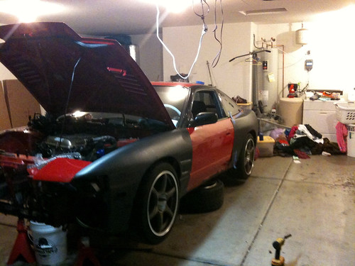

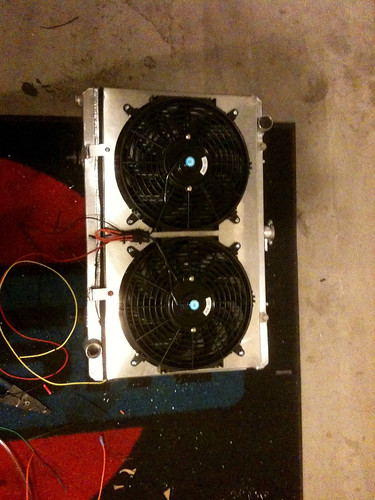

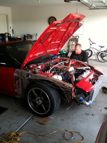

After about 6 more weeks of driving the car i decided to clean it up some more and install some trick machine fasteners - aluminum radiator - E-Fans - cooling panel - and a new radiator mount.

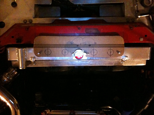

My friend made the cooling panel - radiator mount and the E-Fan shroud.
I didnt get a chance to drive it due to one of the E-Fans having a broken blade. Thanks to Enjuku for sending me a new one out with no real issue.

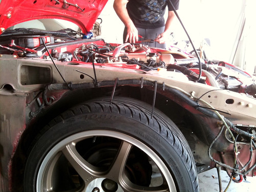

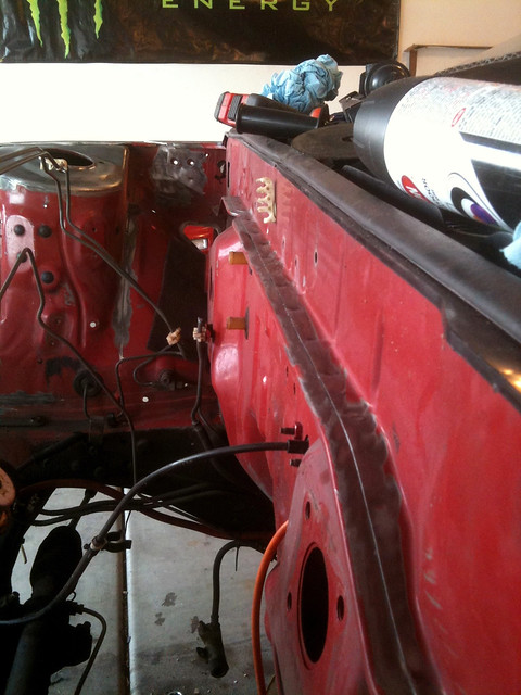

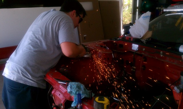

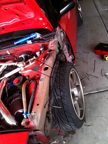

While waiting for the E-fan we decided to pull the fenders to do a wire harness tuck because i want to drop the car another 3'' and go with 40mm front over fenders and 50mm rear over fenders.
Us tucking the harnesses and bashing the seam line up.

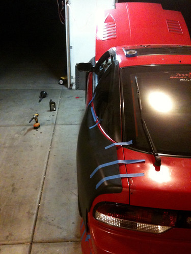

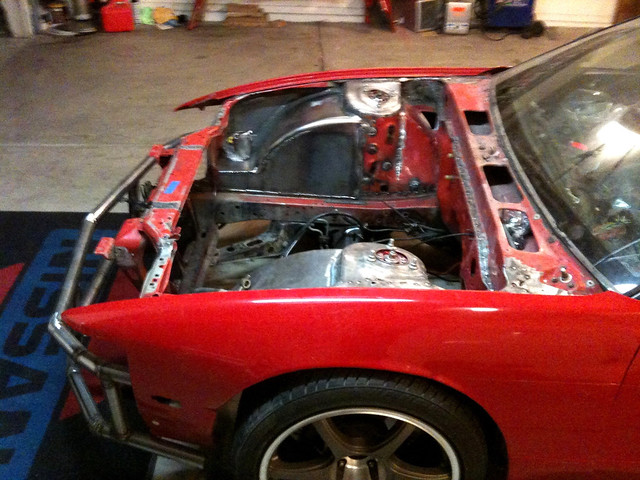

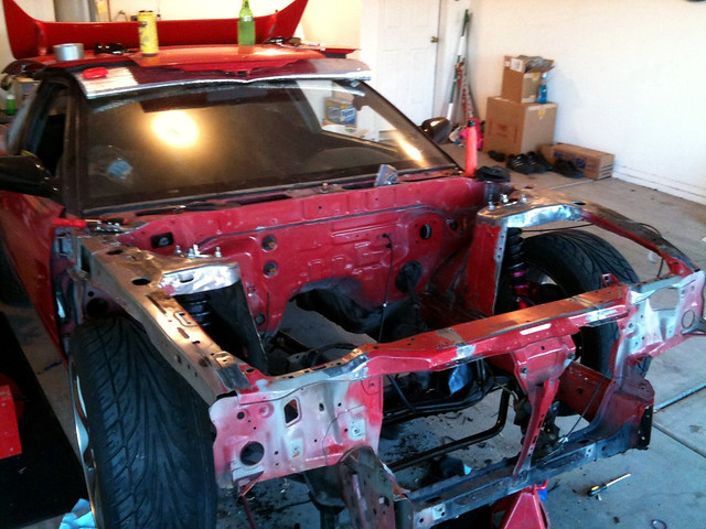

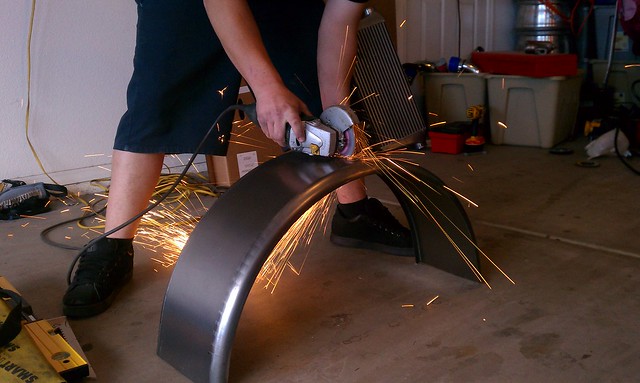

While we were tucking the harness we located some over fenders in california. So we went on a drive to get them. We couldn't really wait to test fit them.

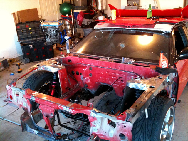

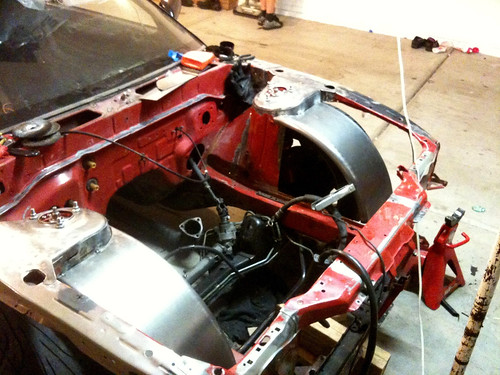

After the test fit we noticed there was still going to be a issue with the front and back rubbing. So we both said fuck it lets TUB and STITCH WELD the bitch.

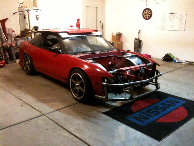

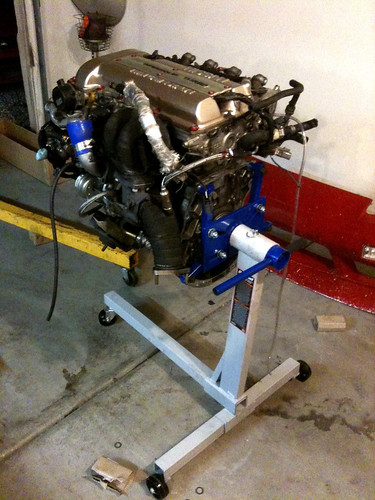

so the motor came out
And the Tubing began
Today we stripped most the glue joints and wire wheeled them for stitch welding.
Plans for tomorrow is to locate a boat trailer fender and get some sheet metal to fill in the wholes we have made.

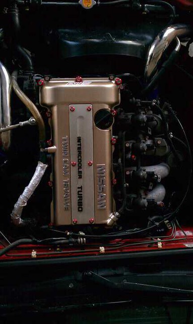

bro, severe overkill on the hot import nights dress up bolts on the coil pack cover.

Lol wait till you have a chance to see the motor up close. It is pure sex...

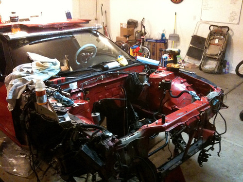

Update as of today
Ready for tubs and stitch welding

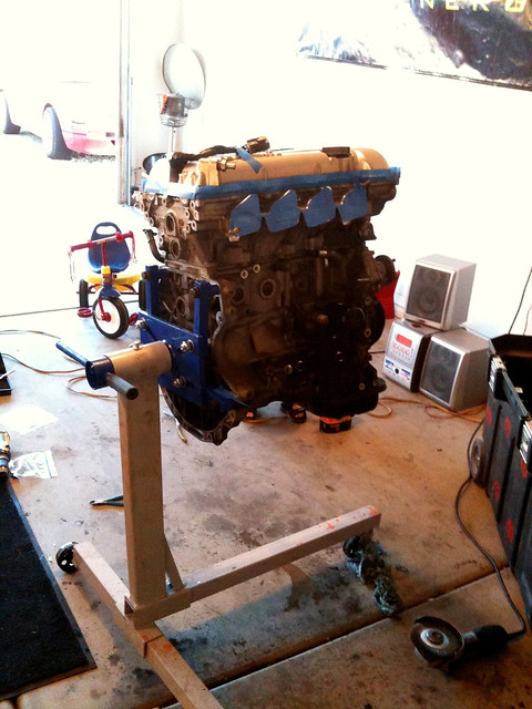

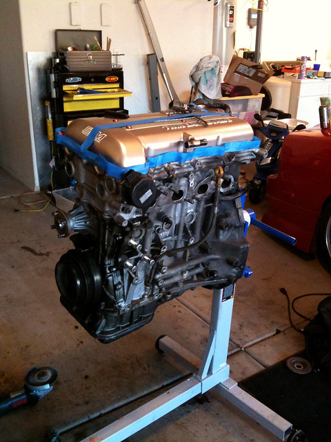

Stripped the motor down getting it ready for a good cleaning and paint...
Pulled the motor bay harness for the wire tuck ...
Starting the tubs tuesday and the stitch welding ... then time for paint.

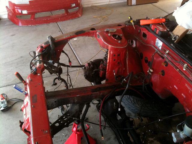

todays update

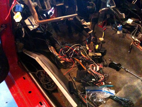

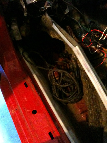

Pulled the dash to do a wire tuck and fix all the bull shit under it.
this s what was under the carpet
Started the tubs tonight but i need a better welder. Fucking flux core sucks ass.

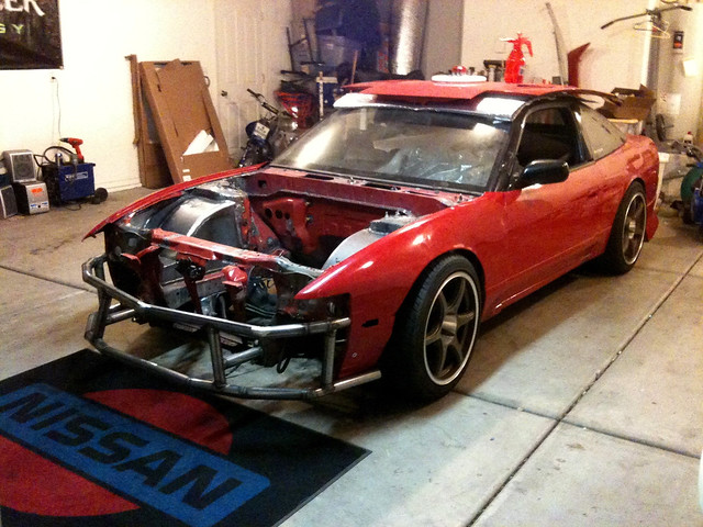

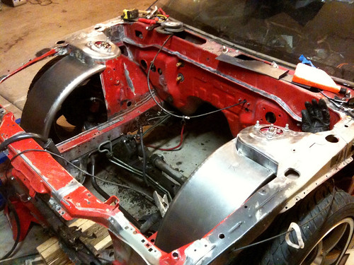

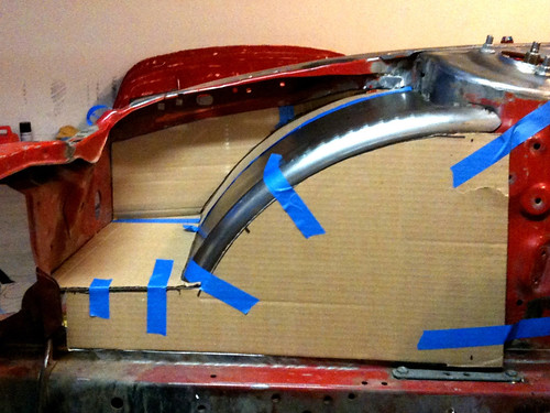

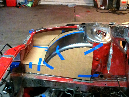

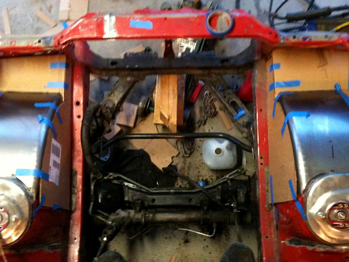

started the mock up of the tubs.

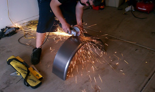

It started off as a daily car build but my friend wanted something a litle more so i talked him into the tubs and stitch weld. Got him talked into a cage but we have a time frame to follow. We have till october to finish the engine bay / motor / body work and paint. But after that im going to cage and do a full stitch weld on this bitch.
The tube are a 10'' single axle trailer fender i got local here for $25 i think. Thanks for the compliment.

finished up the tub templet's
Made some mounts for the front bash bar going to weld nuts on the back side so i can take it off when i need to.

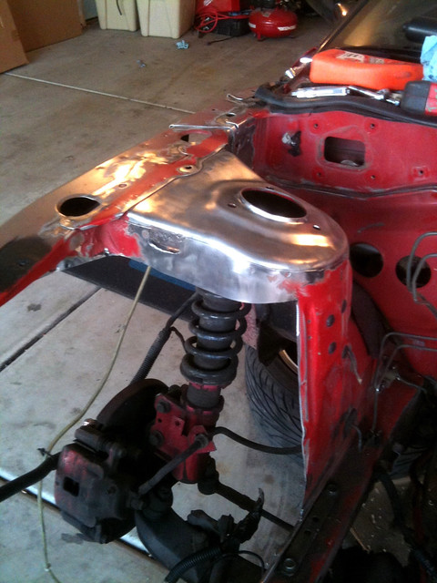

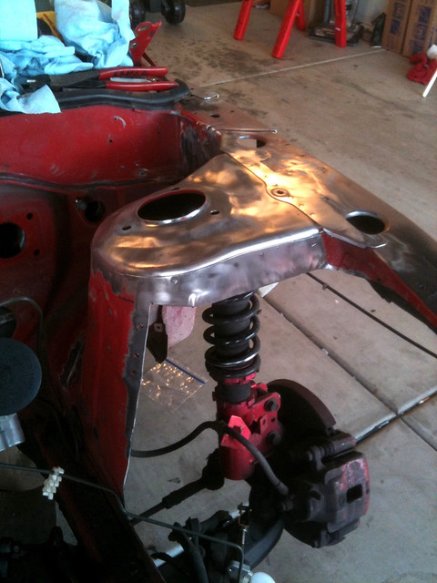

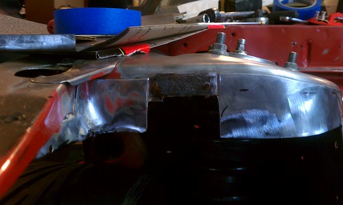

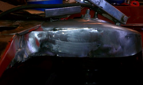

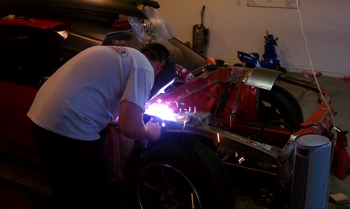

Got our hands on a welder and put the tubs in and fixed some rust spots
Had to fix a rust issue first

Got a ton of shit done
Put in tubs and seam welded them up
Stitch welded the bay
Built a snow plow bash bar
