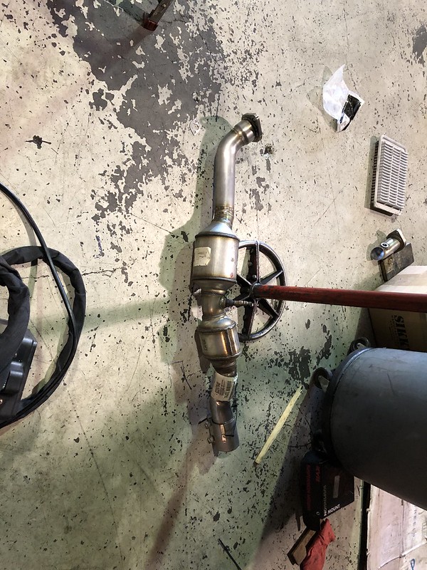

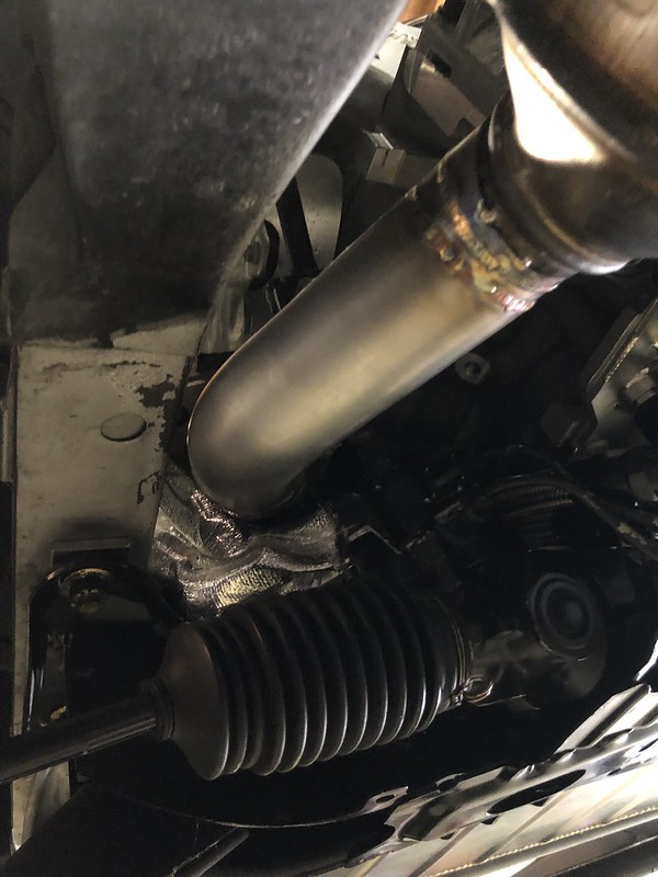

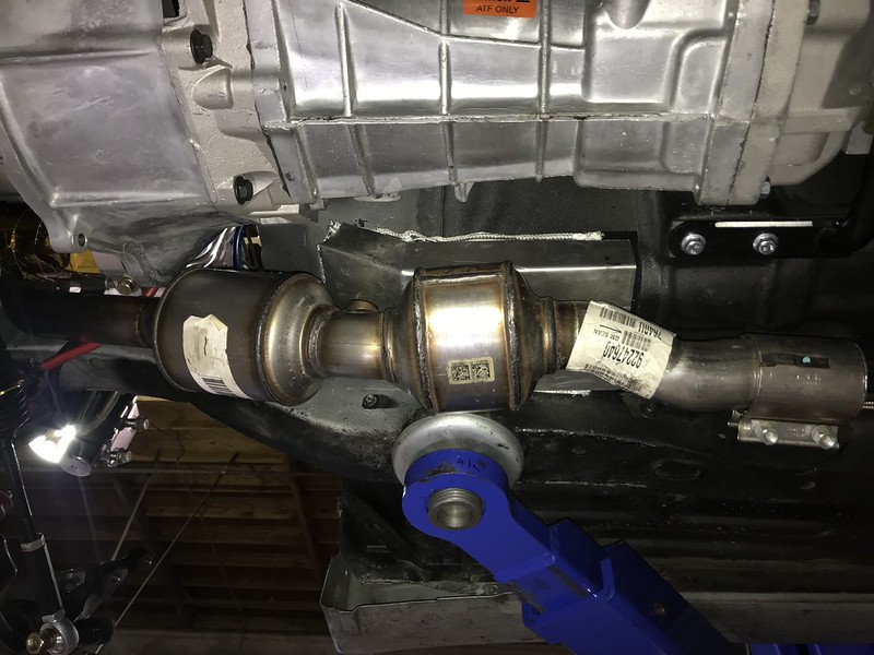

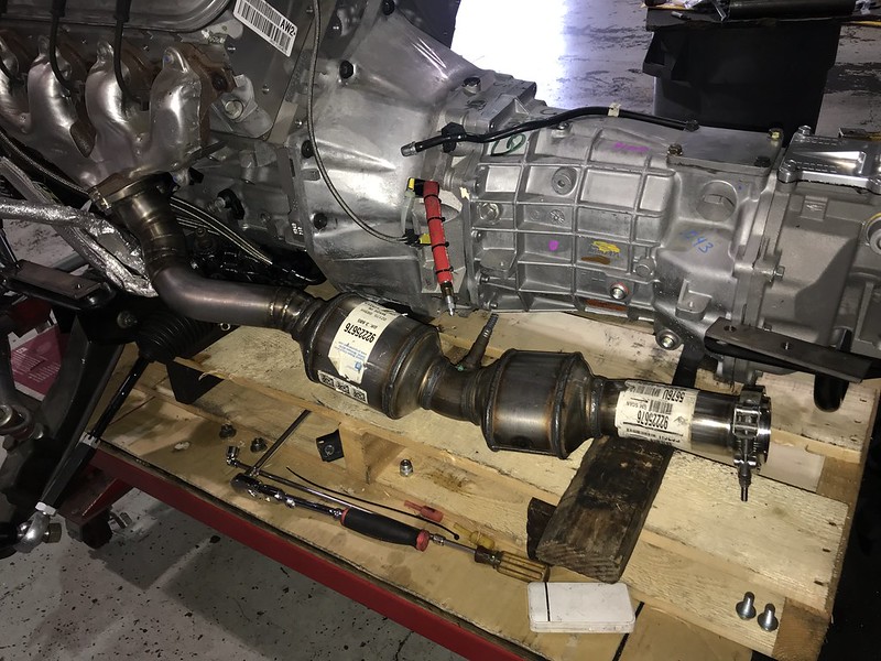

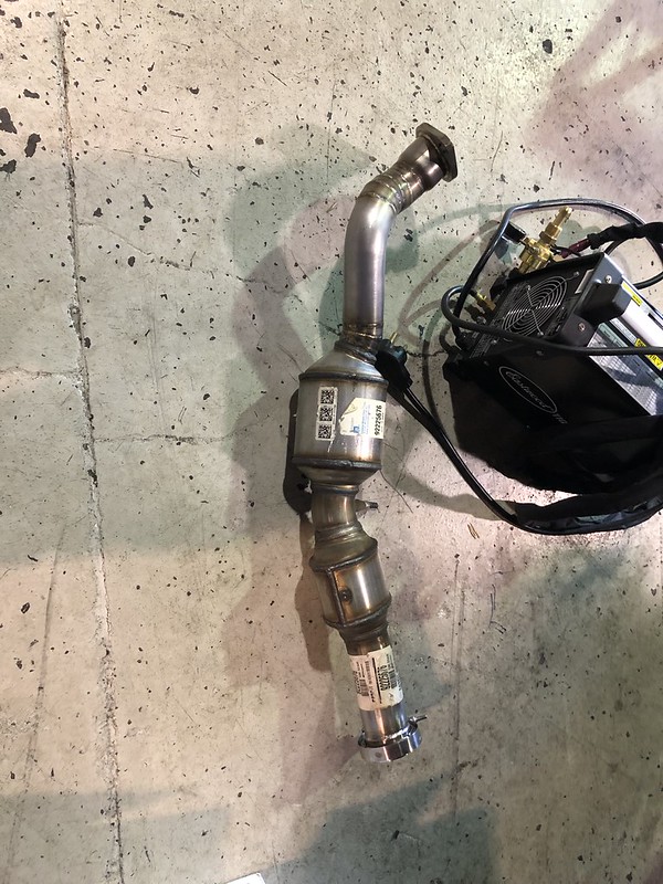

Well after 6 years since my last progress post, I am back at it. A marriage, a newborn and a house move put things on hold, but I am pushing to get my 240 back on the road this summer. I had to enlist the help of some friends, but will get this going again. We just mocked one of the most challenging tasks of getting the exhaust/cats routed between the frame and through the steering rack.
passsteeringrack by gnakata2007, on Flickr Passengersidecat by gnakata2007, on Flickr Driversidecat by gnakata2007, on FlickrThat's all for now, but I am excited to be moving forward again. Glenn

A little update.

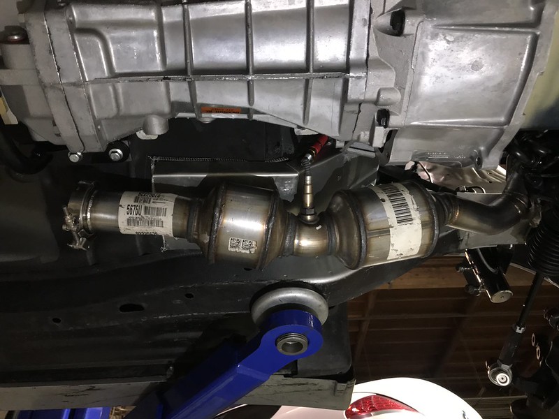

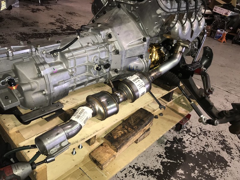

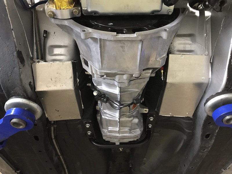

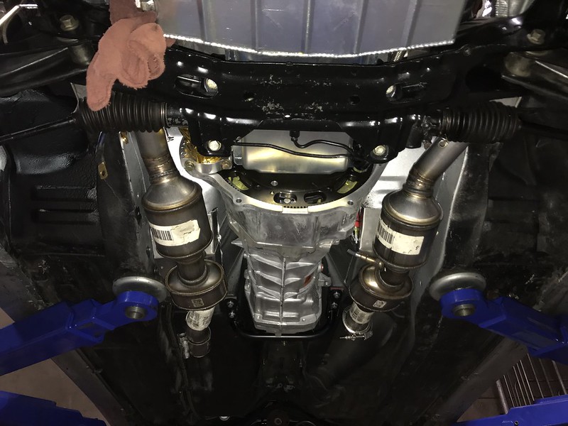

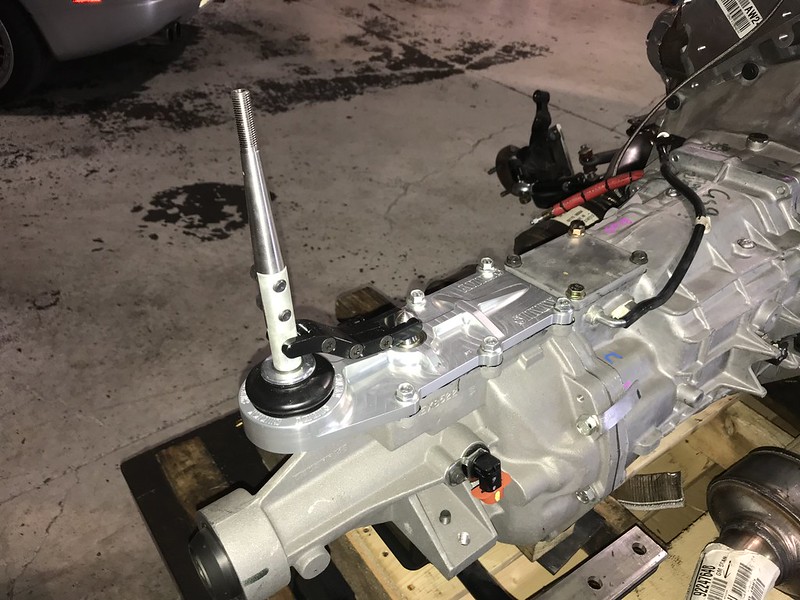

Here is the driver side exhaust with cat driversidecatattached by gnakata2007, on FlickrHere is the passenger side passengersidecatattached by gnakata2007, on FlickrHere are some heat shields on the frame rails right above where the cats sit. catheatshields by gnakata2007, on FlickrHere is how it looks with the engine in the car with the exhaust and cats bottomviewfromfront by gnakata2007, on Flickr Passengersidecatsideview by gnakata2007, on Flickr Driversidecatsideview by gnakata2007, on FlickrHere is the Sikky relocation shift on the T56 Magnum tranny. This positions the shifter exactly in the correct position as the Magnum tranny is 4 inches shorter than the standard T56 tranny siikkyrelocationshifter by gnakata2007, on Flickr
