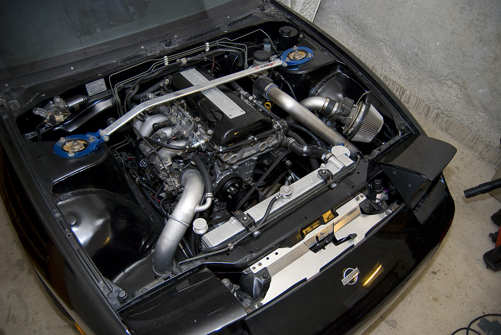

Originally Posted by Krusty_s13 View Post
I sanded mine down good. filled the holes i didnt need, cleaned it all, hit it with a sealer primer, sanded it again and shot it with a couple of coats of base and a couple of coats of clear. first time painting too. turned out pretty good.
only pic i have of the bay:
do it right and take everything out. painted brake lines and wiper motors are gross.
i hate to thread jack but where did you get that front bumper/lip? is it an oem bumper with an aftermarket lip? it flows sooo nice! also props on the color my hatch is a 90 and the same color!

Def is close to perfectionDef is close to perfectionDef is close to perfectionDef is close to perfectionDef is close to perfectionDef is close to perfectionDef is close to perfectionDef is close to perfectionDef is close to perfectionDef is close to perfectionDef is close to perfection
Pretty sure that's a stock pignose bumper without a stock lip like most people run.
looks like a xenon lip to me

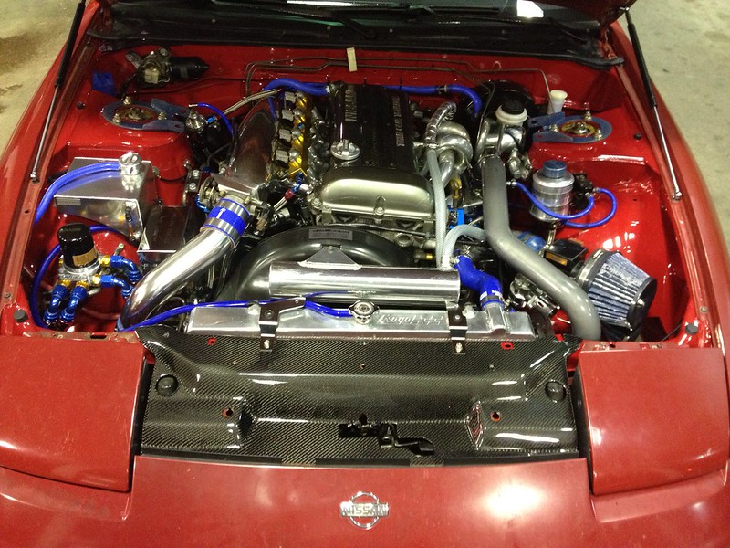

Andy and I did all of the prep in my engine bay... Clean, scuff, sand, fill etc... Then primer, then scuff, sand etc and another 2-3 coats of primer.... Total cost was about $150-200 for everything IIRC. Had the bay shot at Schaeffer's N. Lindbergh location with S14 Ultra Red (AJ4) & clear for another $250.
Result is very nice:
Coat #1 finished:
If you want good results, DO NOT use rattle can. Either source out a compressor and airbrush or have it professionally done. Don't forget to let it sit a few days, then put a good coat of wax on it before putting everything back together.
Coat #1 finished:
Get with Andy- For the right price, he may help you with the prep.
P.S. Next time, post in the right section... jackass
Mike
HOLY SHIT! that looks great. did you paint the engine bay before or after you sprayed the rest of the car??
Thanks dude! Rest of the car still needs to be done... so BEFORE lol
