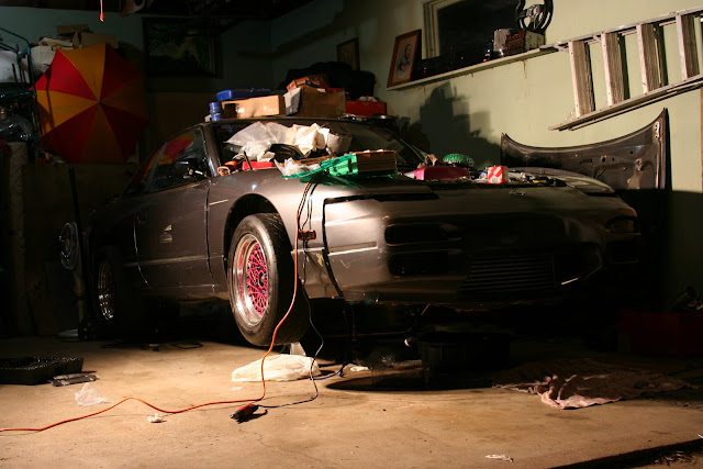

hmmm did some more work.
i blocked off some coolant ports and what not. Got all the heater hoses and what not hooked up. i blocked off the port on the engine block and started running the oil feed/return lines. took a pic of the new turbo ![]() got some parts laying around. the girlfriend assembled all the turbo and manifold/wastegate stuff. just waiting for my new exhaust manifold gasket from myJZswap.com then the turbo setup should be ready to go on for the last time. but had to do a mockup to see how it was gonna look. pic of the car in it's winter hiding spot.
