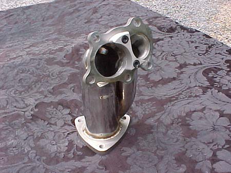

this is a s15 turbo, what advantage does the divider have? it doesn't look like it's completely sealed does it have to work with sometrhing like this? ![]() |

It's actually one or the other. If you have an O2 pipe like the one you linked to or the greddy O2 it won't work on the S15 turbo without modification because the cast-in divider will interfere with the divider on the O2 pipe. You're right when you say the S15 divider isn't completely sealed, it looks to me it's only meant to seperate airflow directly at the mouth of the turbine and wastegate discharge. That's where the turbulence would have the biggest effect anyways.
Cliff notes: If you have or want to upgrade to divided O2 pipe (like greddy) = get turbo without built in divider. If you have or want O2 pipe that isn't divided (like megan racing or stock) = get turbo with built in divider. |
