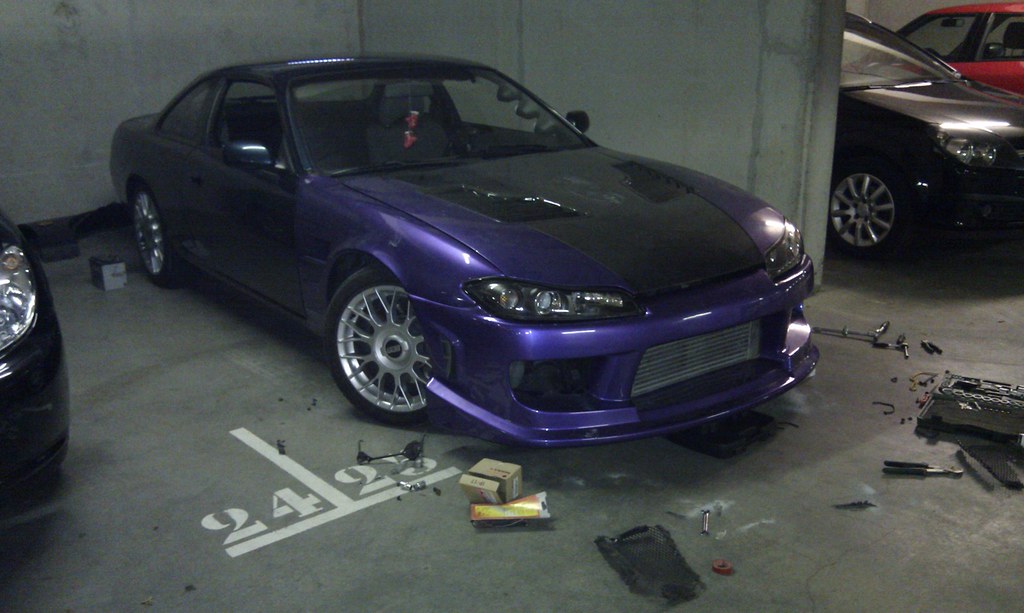

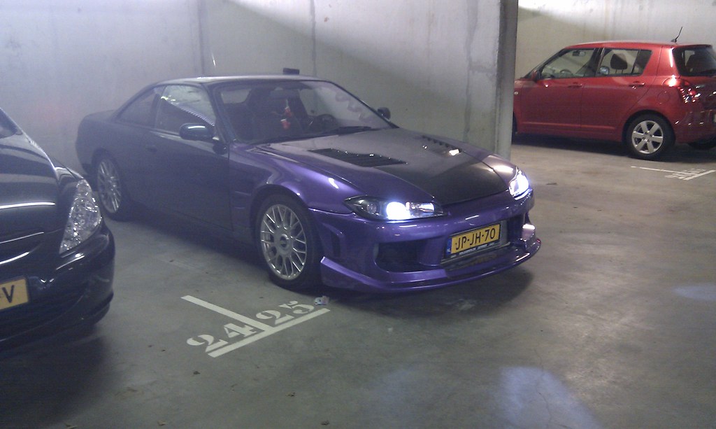

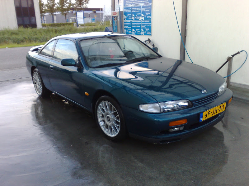

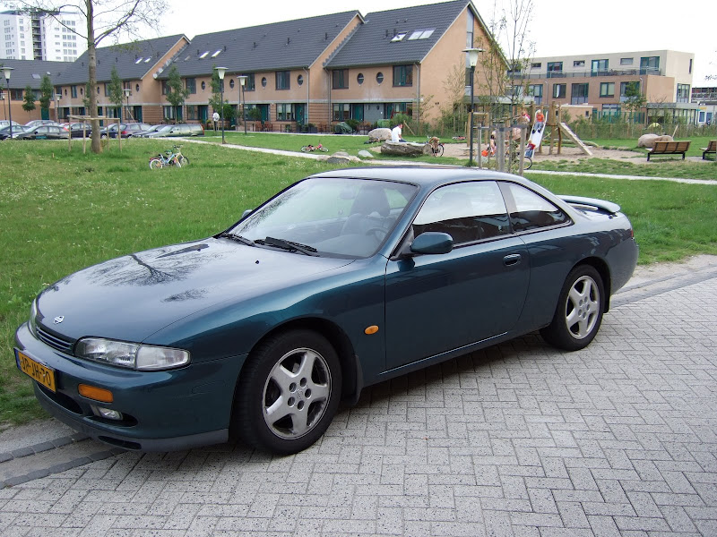

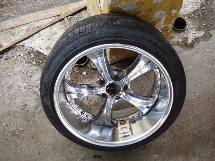

This is my car how I bought it 4 years ago. It's a 1996 Nissan 200SX S14 with a SR20DET. ![]() My first mods where some Sport Edition (German special edition) 17" BBS wheels: ![]() ![]() But I always liked the S15 front. Inspired by my brothers old S14.5 I decided to put on a S15 front as well. My brothers old car: ![]() First my spec list: Engine: - SR20DET - Apexi Power intake - Apexi Aluminium induction box - Apex FMIC - Invidia 3" downpipe - Mazworx 3" race cat - HKS 3" Silent HiPower cat-back Interior: - HKS Turbo Timer Type 1 - Blitz SBC DC boost controller - SLM oil temp meter - SLM oil pressure meter - SLM water temp meter Exterior: - DRFT S15 front bumper - Chargespeed S15 carbon vented motorkap - Origin Lab S14,5 +30mm front conversion fenders - Origin Lab Type 2 +50mm rear wide fenders - Nissan S15 koplampen with xenon - Vertex side skirts - Vertex rear bumper - Kouki wing spoiler - S14a rear lights - S14a trunk lid Suspension: - HSD HR coilovers (6 kg/8 kg) - Driftworks adjustable camber control arms - Driftworks adjustable toe control arms - Driftworks traction control arms - Driftworks adjustable tension rods - DB Power 315mm Big brake kit - SSR Vienna Courage 18x10 -14 (front) 18x11,5 +5 (rear) My wheels: ![]() ![]() ![]() Origin Lab Type 2 rear wide fenders: ![]() Last edited by JOeS; 04-13-2011 at 05:35 PM.. |

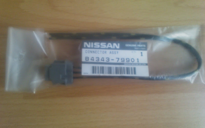

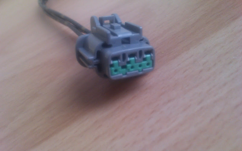

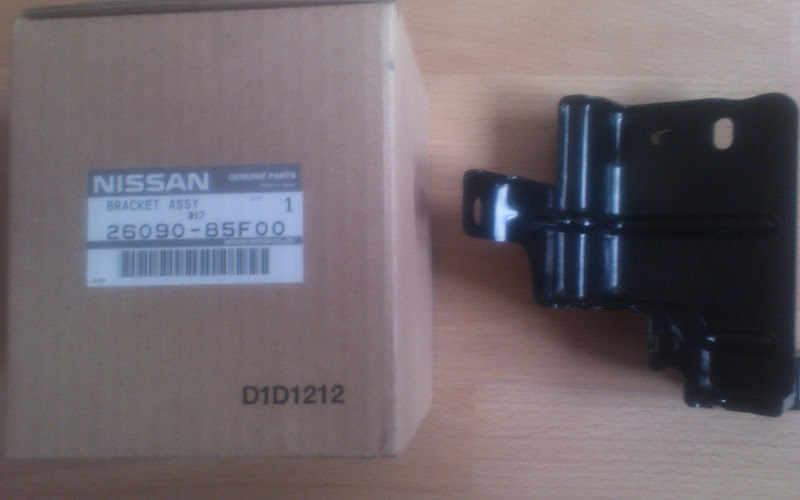

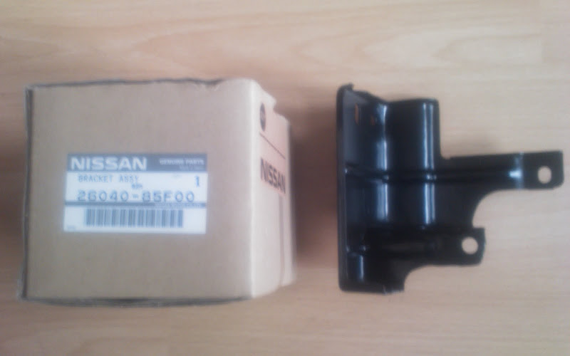

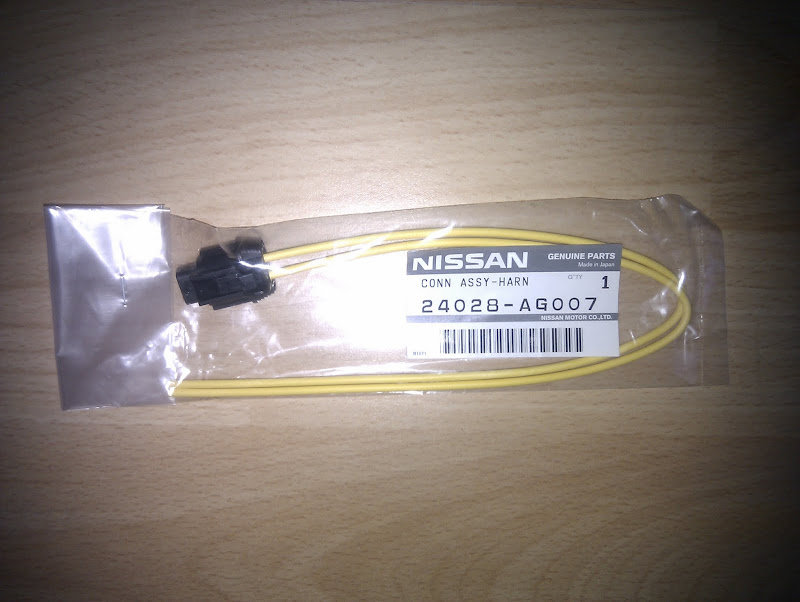

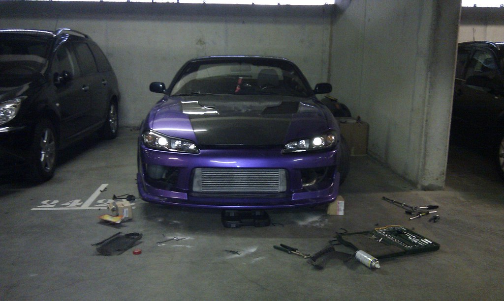

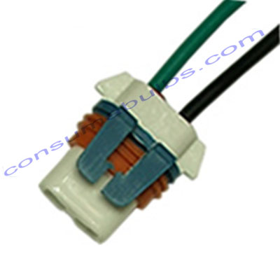

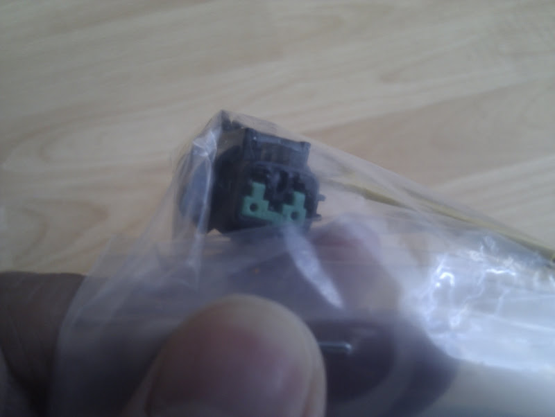

I bought some headlights but still needed to buy the mounting brackets and connector plugs. It took quite some time to find to correct ones. So here's a complete list with part numbers:
- 26090-85F00 - Left S15 headlight bracket - 26040-85F00 - Right S15 headlight bracket - 84343-79901 - blinker/parking light plugs (2x) - HB3 9005 plugs - High beam plugs (2x) - 24028-AG007 - low beam plugs (2X) -> These are actually the wrong ones. I should need an exact mirror image from these ones. So I just remove the ridges and the edges from the plugs. Then they slide right in. Perhaps the correct part number is B4342-79906. 26090-85F00 - Left S15 headlight bracket: ![]() - 26040-85F00 - Right S15 headlight bracket: ![]() 84343-79901 - blinker/pariking light plug: ![]() ![]() HB 9005 plug: ![]() 24028-AG007 - low beam plug: ![]() ![]() |

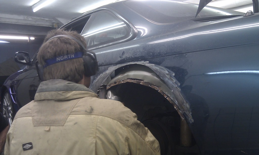

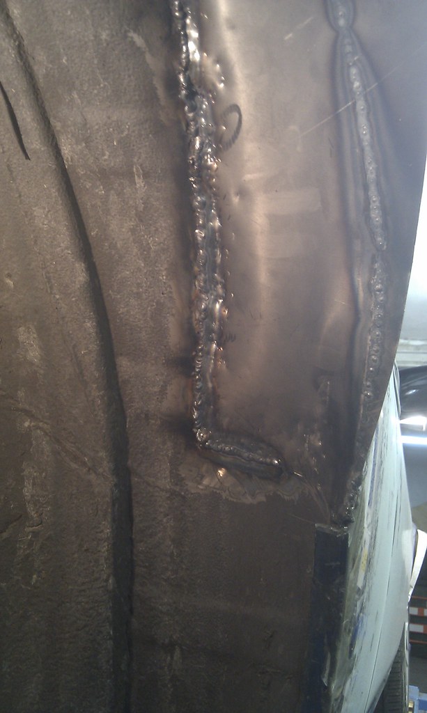

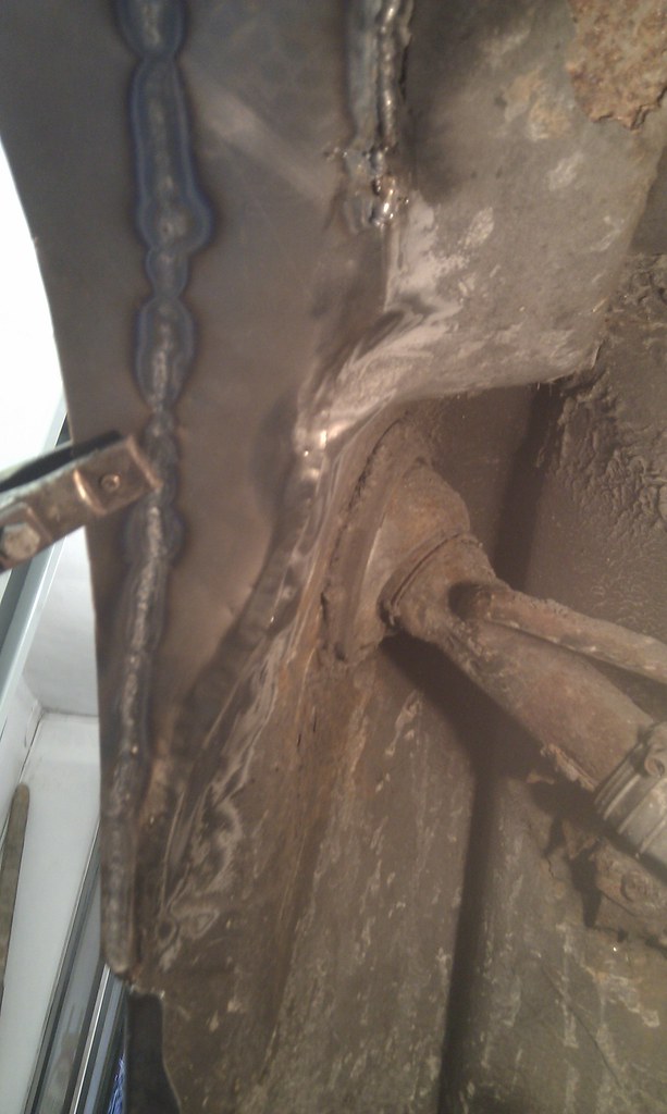

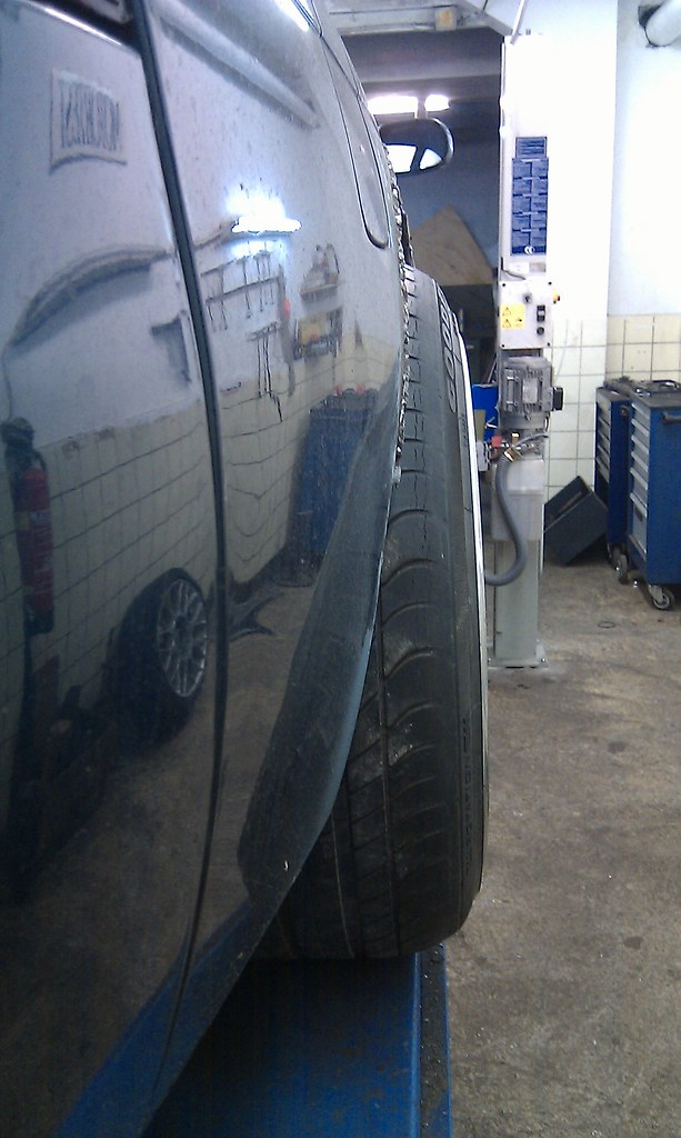

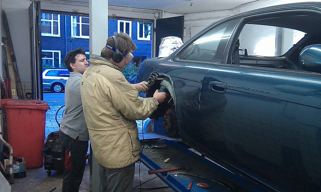

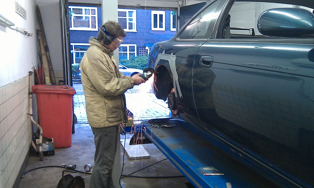

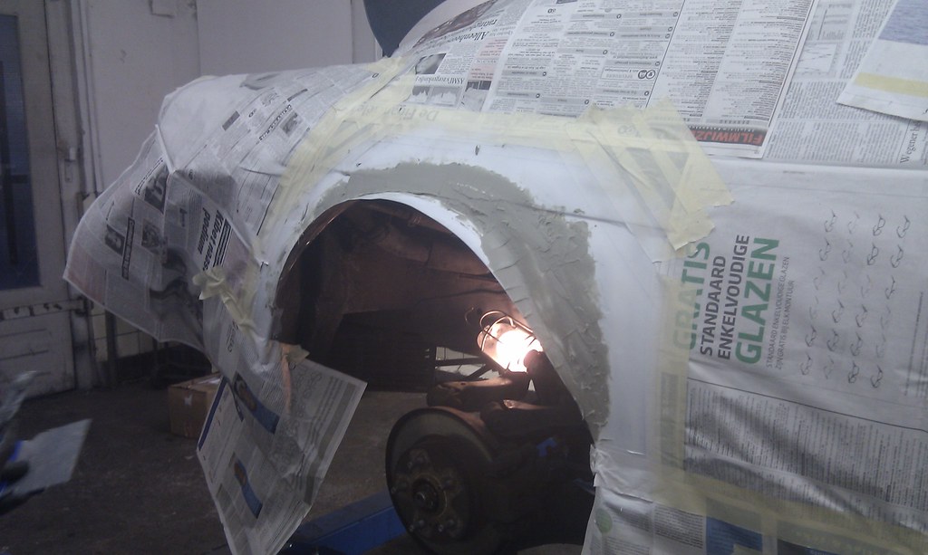

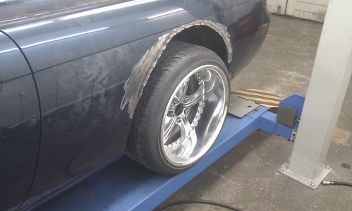

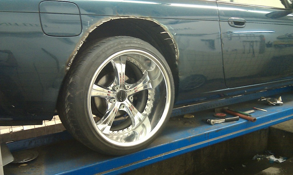

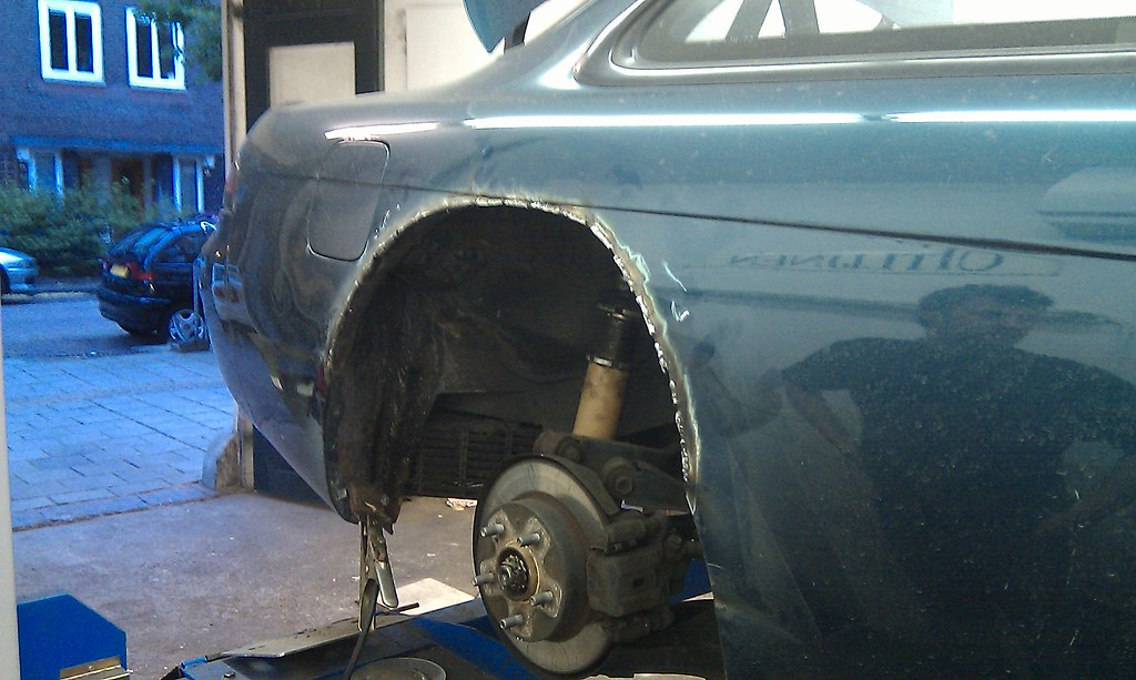

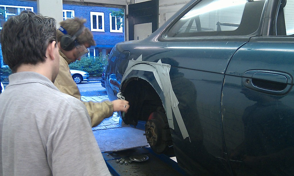

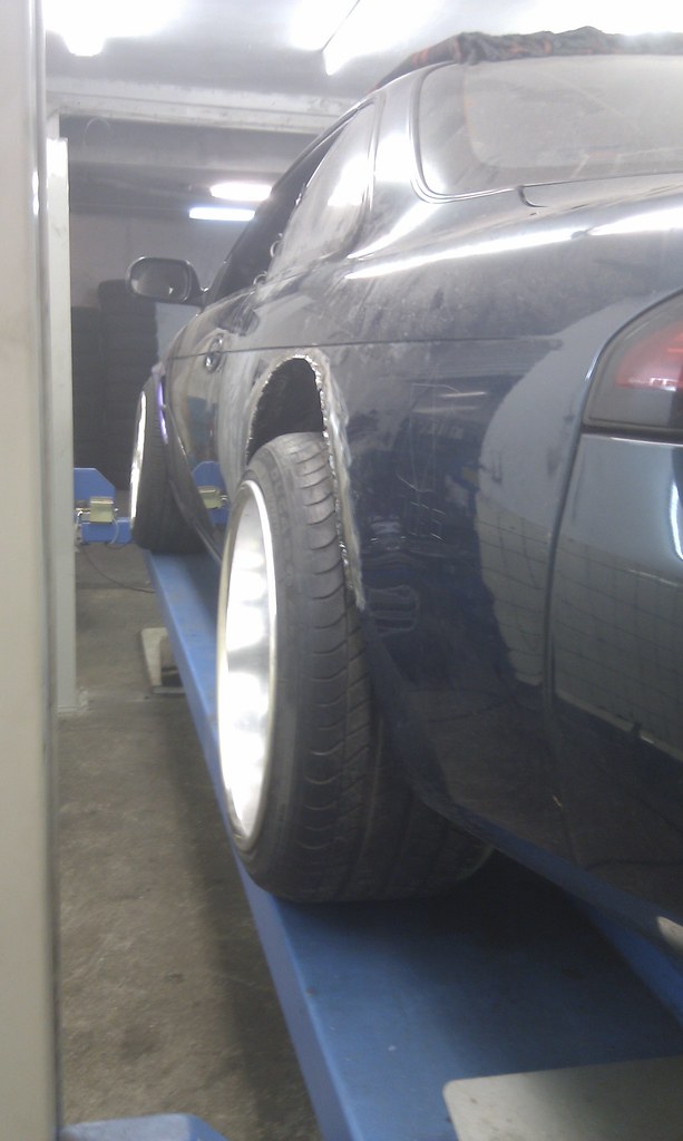

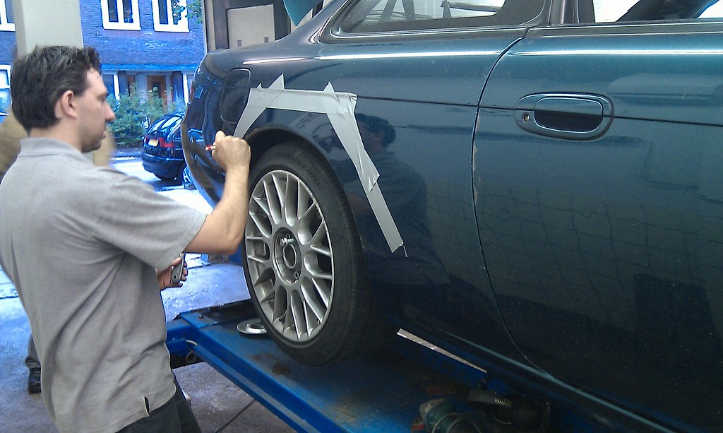

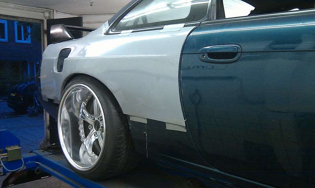

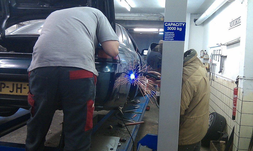

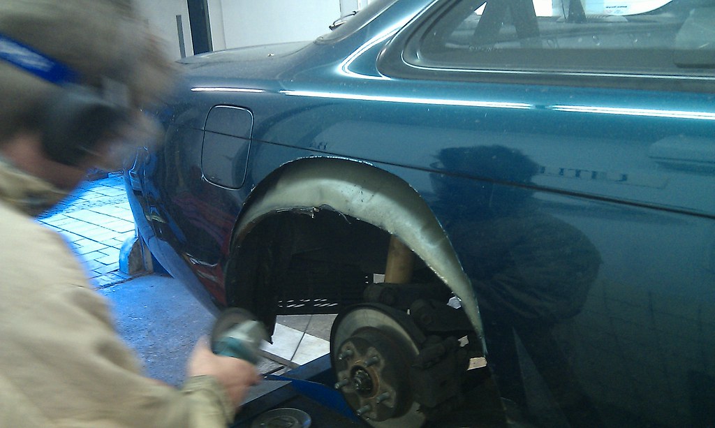

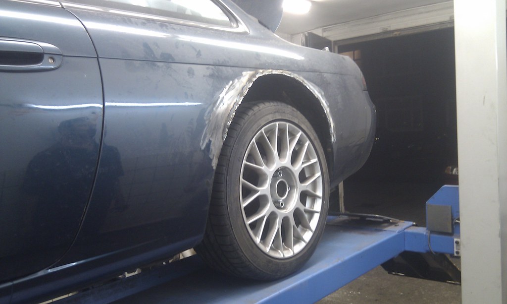

Two of my friends are going to do all the bodywork. First is to cut the rear fenders:
![]() ![]() ![]() ![]() Then weld it together: ![]() Nice result! ![]() Quick look how the rear wheel fits ![]() ![]() ![]() Quick look with the rear fender: ![]() Excellent fitment without spacer. ![]() ![]() |

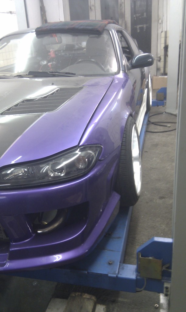

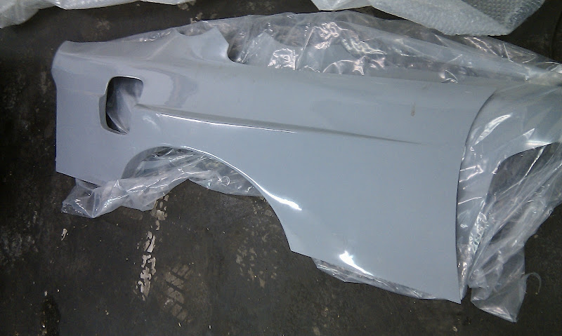

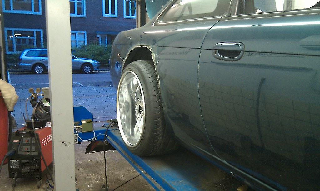

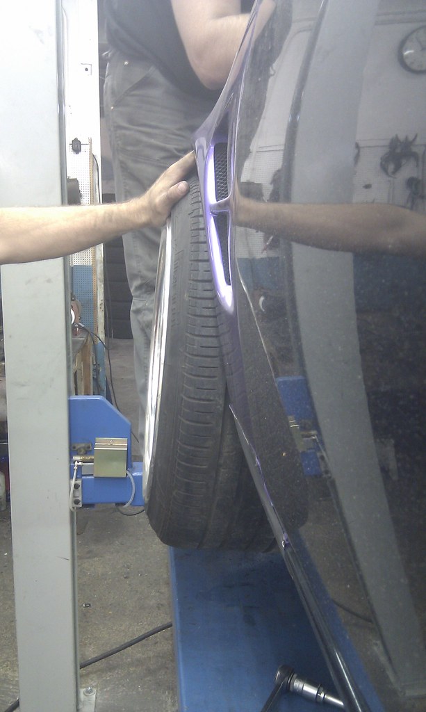

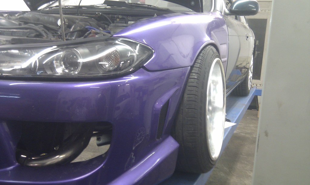

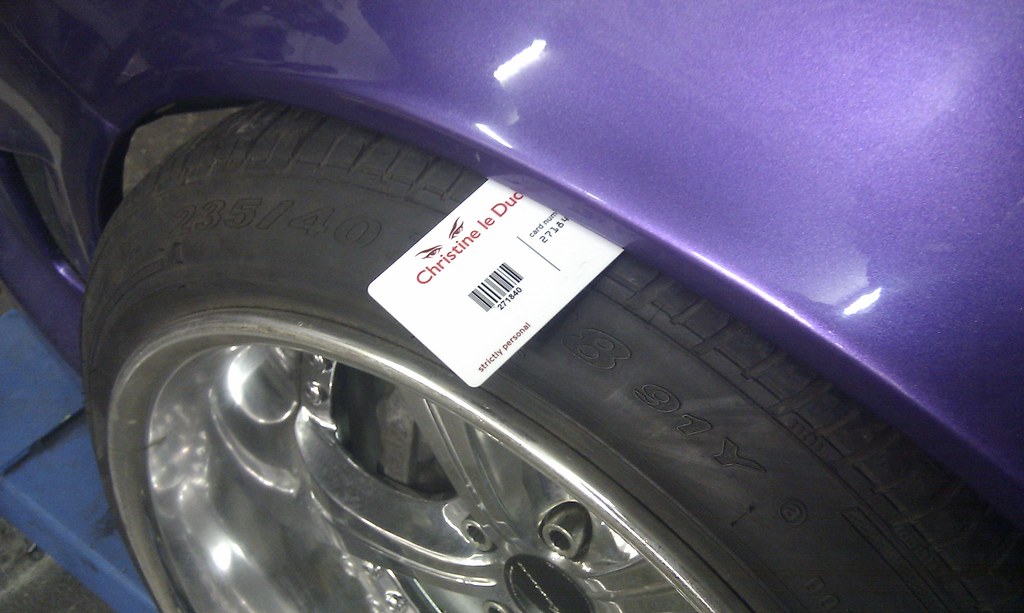

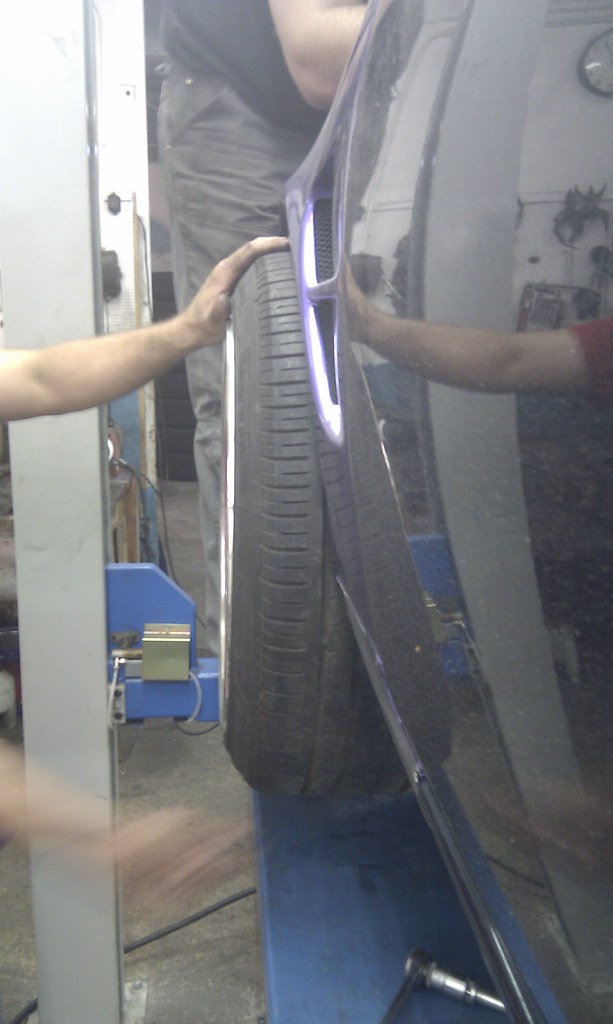

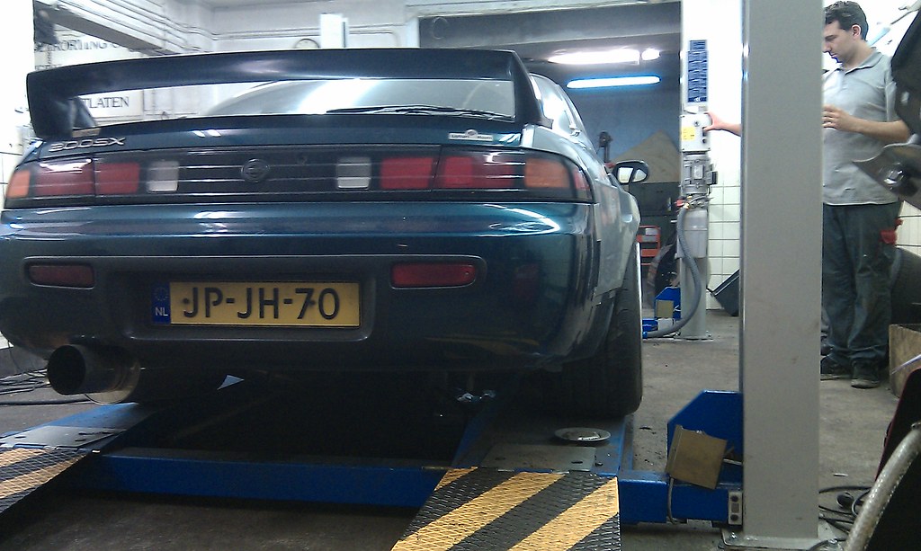

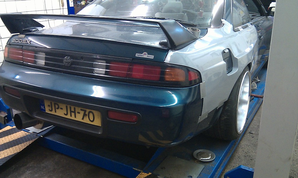

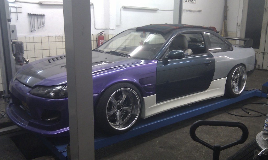

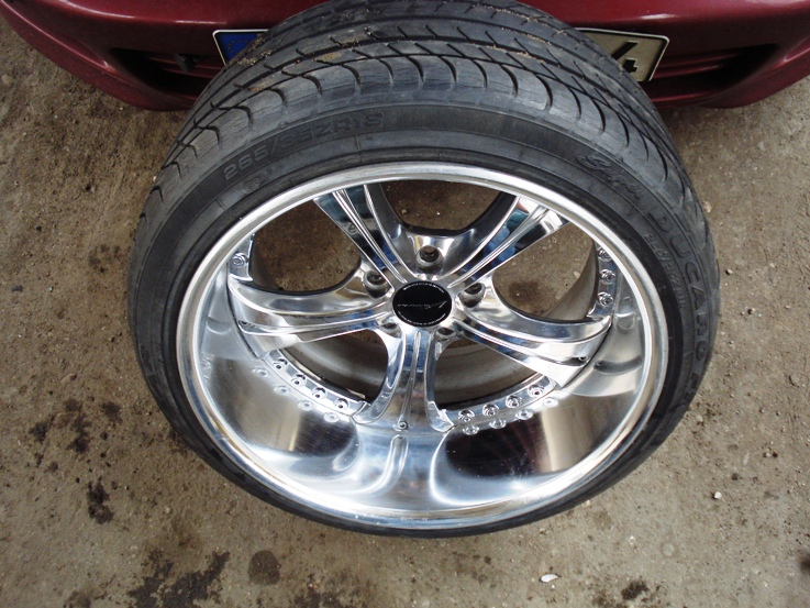

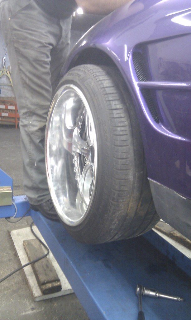

Some more work done to the right:
![]() And the left side: ![]() ![]() Inside of the right quarter: ![]() ![]() I had doubts that my fronts would fit and too bad they didn't: ![]() ![]() Max. camber: ![]() ![]() ![]() Test fitting of the rear wheel: ![]() ![]() With the side fender and kouki spoiler: ![]() ![]() |

Go down to a 225/35 in the front, notch top coilover hole for more camber, lower car more!
