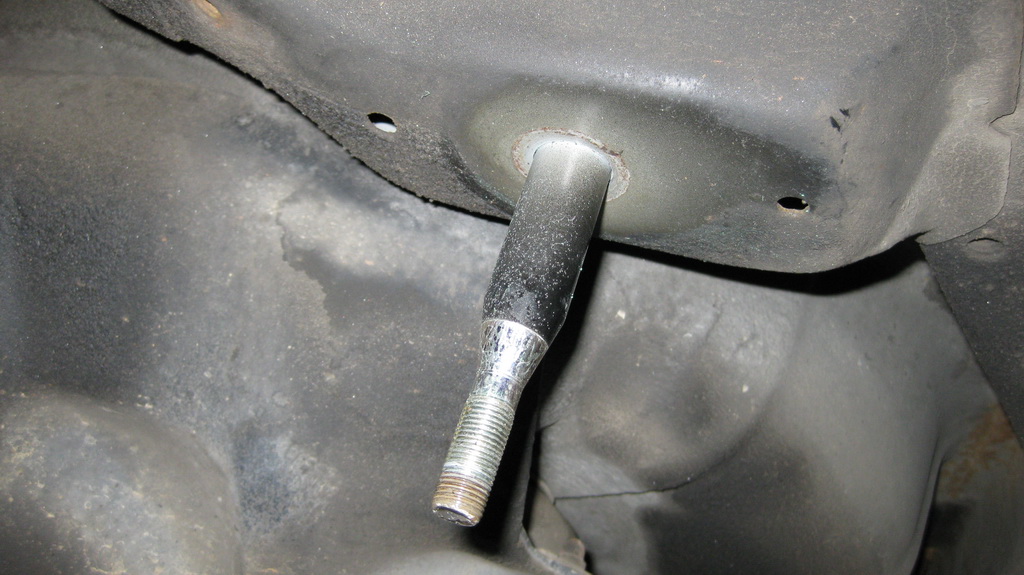

ok so after mnths of struggling with this. i got the stud from a part out.
yesterday i took it to this kick ass classic car restoration shop and got them to deal with it. 2 hours later i left with my baby back to normal.
for 1 that stud is a bitch to get out even with heating and pounding it took 1.25 hrs till it popped out and what he ended up doin was using an air chisel and beating away the head then putting a metal pipe over it and a bottle jack under it and beat the hell out of it till it popped.
yes it is just like a wheel stud but a hell of alot stronger. after that he cut the weld from the washer and the rail from the part i got and dropped it in welded and it was over.. FINALLY
Pics (in random order) for those who need reference :
Finished product !!
dfitzg is offline   Reply With Quote
