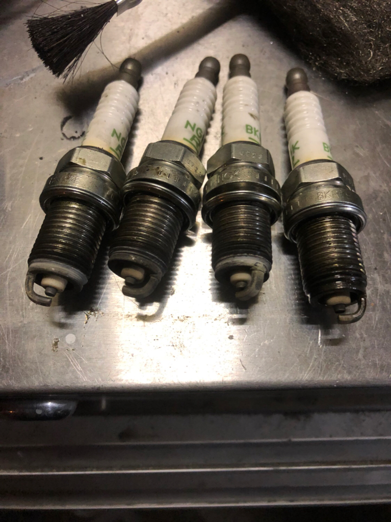

So my engines been acting up lately, trying to track down why it pops and breaks up under load. I just fixed my timing a few months ago since my intake cam was off a tooth. fixed it back to 11 links between cam timing marks. Fixed my lopey idle. Car ran great then started to feel like a fuel cut a month or two later or so under load. Thought plugs were fouled, swapped to new BKR7E’s. Plugs were actually showing lean conditions.
I have fresh 100 octane in the car almost every other day. So it can’t be bad gas. I am leaning towards failing fuel pump, walbro 255. it never broke up like this until recently, ambient temps have dropped tremendously though from 65-70 to 45-50’s, and again I did check if it was overboosting. I’ll be double checking my vacuum lines sometime this week and do an oil change as well. (VR1 race 10-30) will fix my AFR gauge to get proper numbers and going to check my coil pack ground and other engine harness grounds. Any input helps me heaps. I’ll double check my timing and plugs again.

Yeah I did test hits on my way to work on the highway this morning. 14lbs were good, 16-18 psi is where I start breaking up. So I’m going to turn wastegate down and grab a new boost gauge and set it to 10-12 lbs for the winter time.

Stock sr20 coils, grounds seemed good so far, to be honest I may be blowing out spark passed 14 lbs.

What is your gap? Close it up until it stops. Should be around .26-.28. Stock gap should be thrown out of the window on anything other than a stock setup. I second upgrading coils. Yes, the factory pieces work, however, they are now 20+yrs old.
